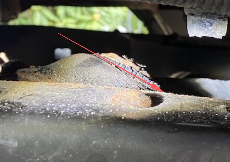

    Im going to be tackling new shocks soon and if I cut through the rubber piece like pictured this will allow the shock to come out? Thanks

    On a TN truck? Shouldn't be necessary. Just cut the top nut off with a Dremel cutoff wheel.
