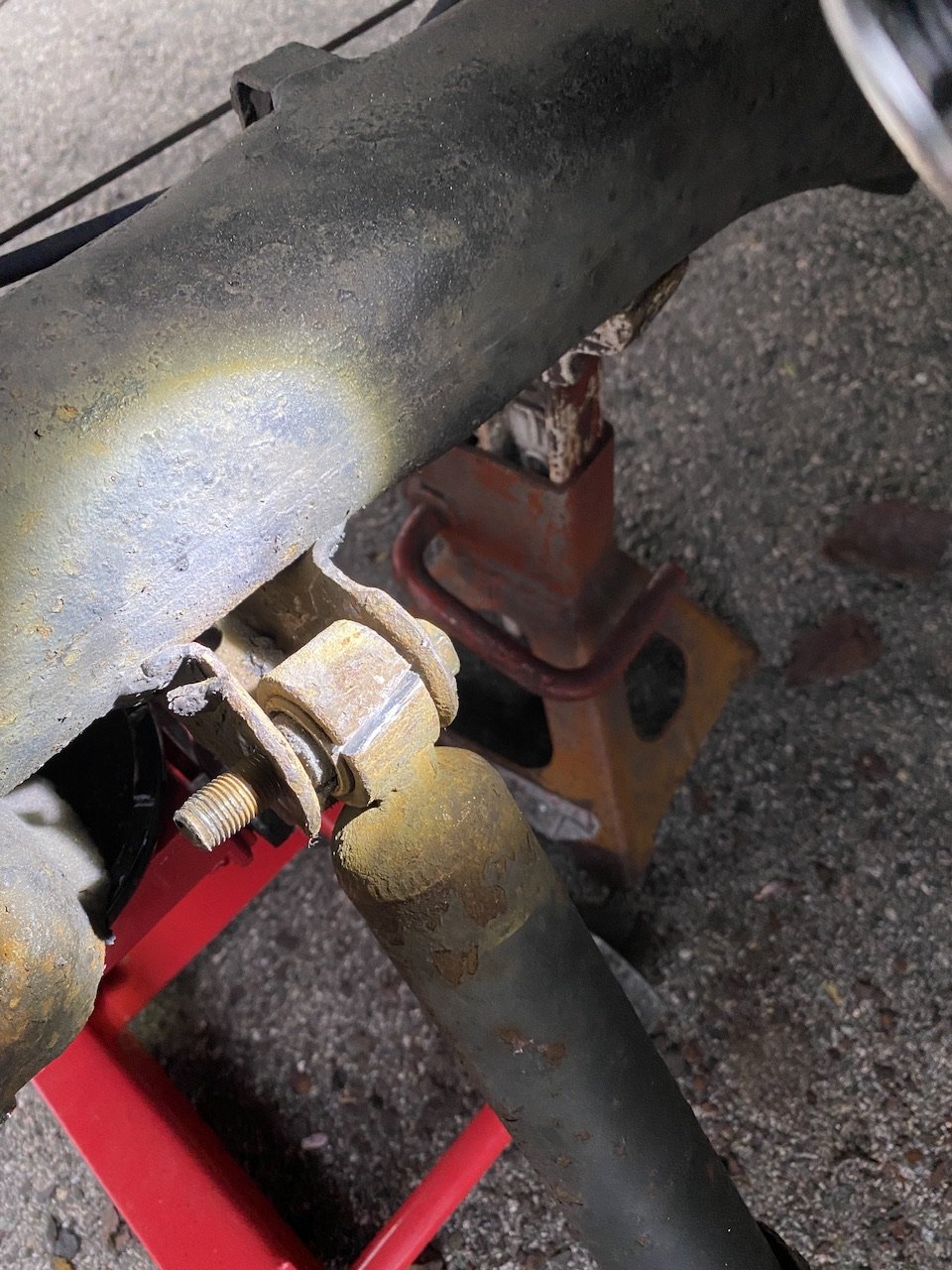

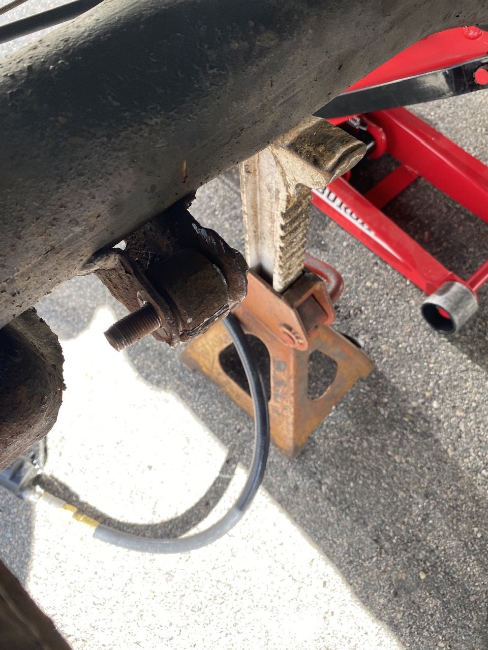

    Dude. Run your sawzall blade (hopefully one with finer teeth) right thru the rubber bushing, beneath that cup washer. It will even act as a guide for you.

    Looking at your picture, I'm pretty sure I was holding the Dremel on the inside position of the framerail and cutting along the post. I dunno, mine fit, and it's a normal sized Dremel. But there is a washer, you can cut however you like.

    We had to lift the bed to do my rear shocks when I lifted my truck, so we could get the sawzall in there :sawzall:

    Baby powder. Lots of baby powder. But won't work in CA, because prop 65, cancer causing ingredients.

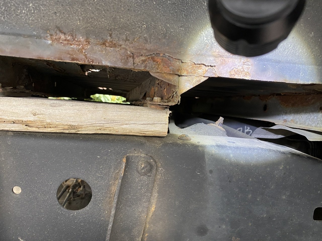

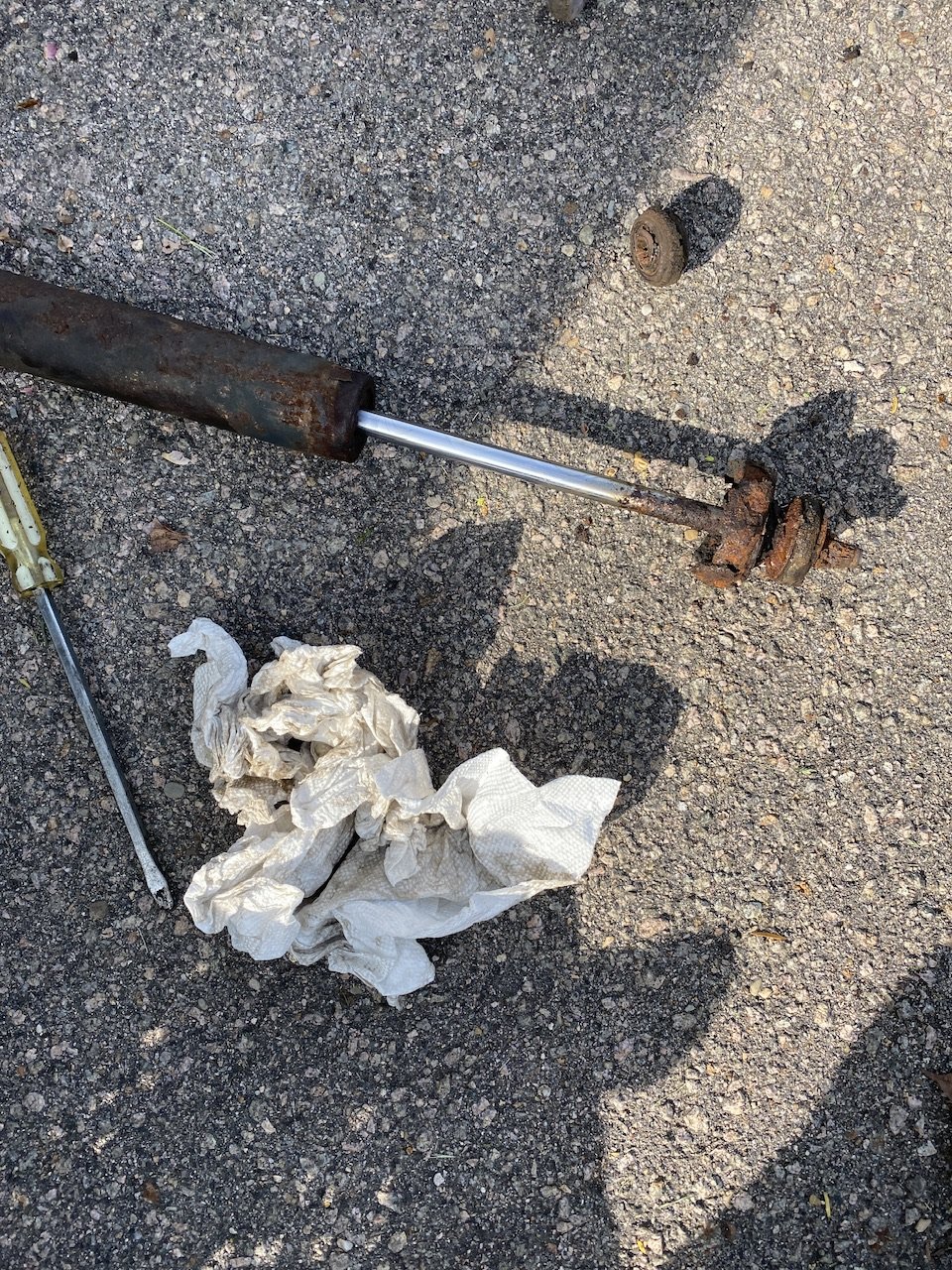

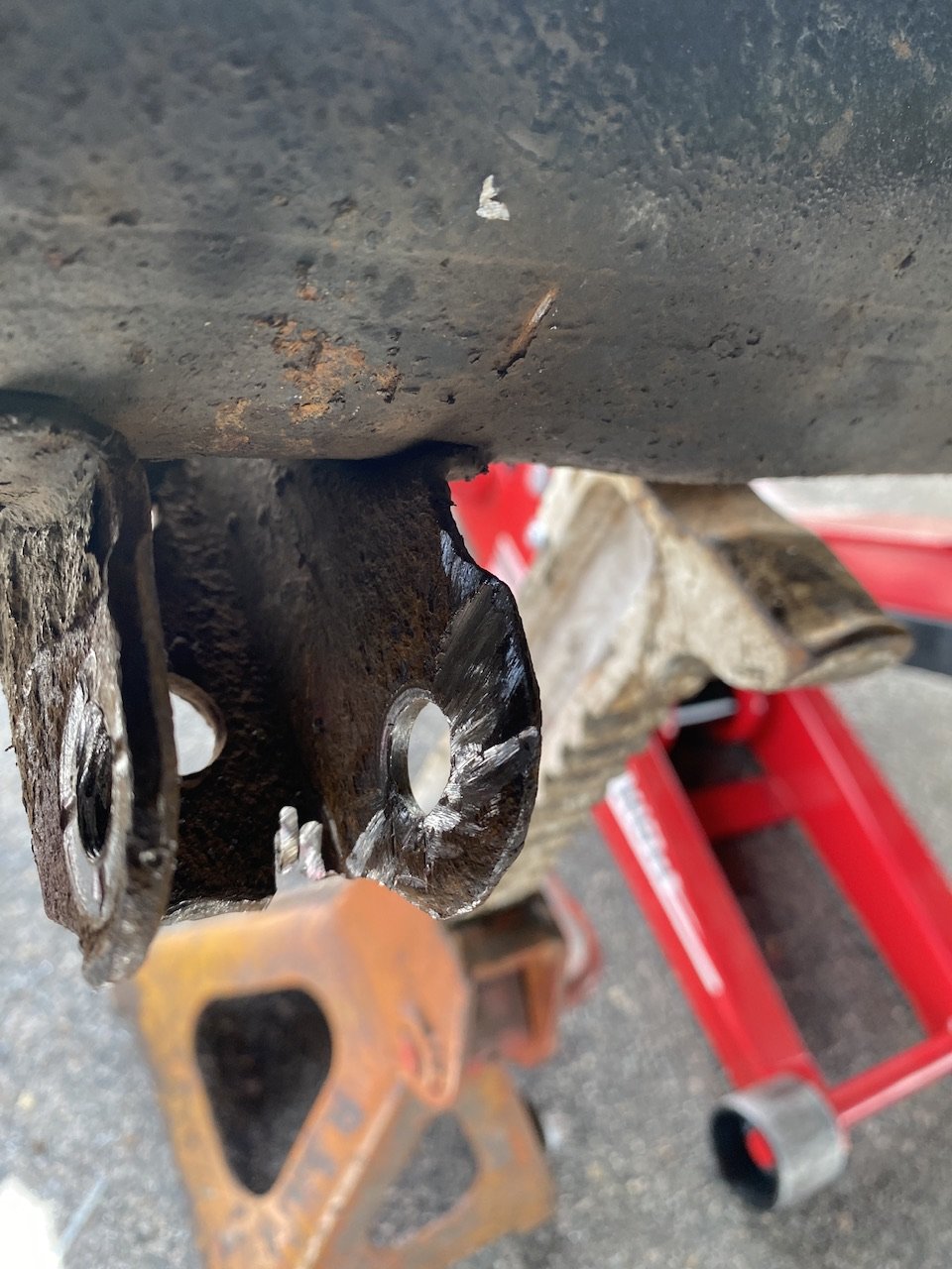

    Here’s the skinny…
    Able to get the left shock out and cut the right shock but the 17 mm shock bolt won’t spin out with an impact. Smoked the bushing inside instead. Now cutting and working on punching it out. Taking tomorrow off unfortunately to deal with this crap. :(

    02 Tundra AC SR5 V8 4x4
    The mauling has begun….

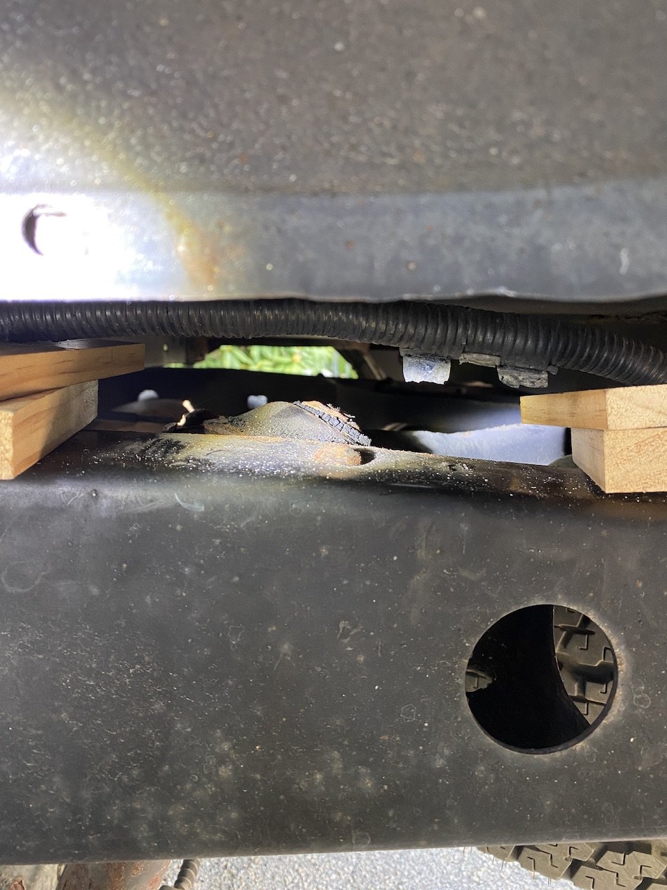

    North of Boston

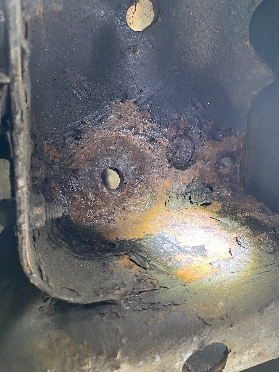

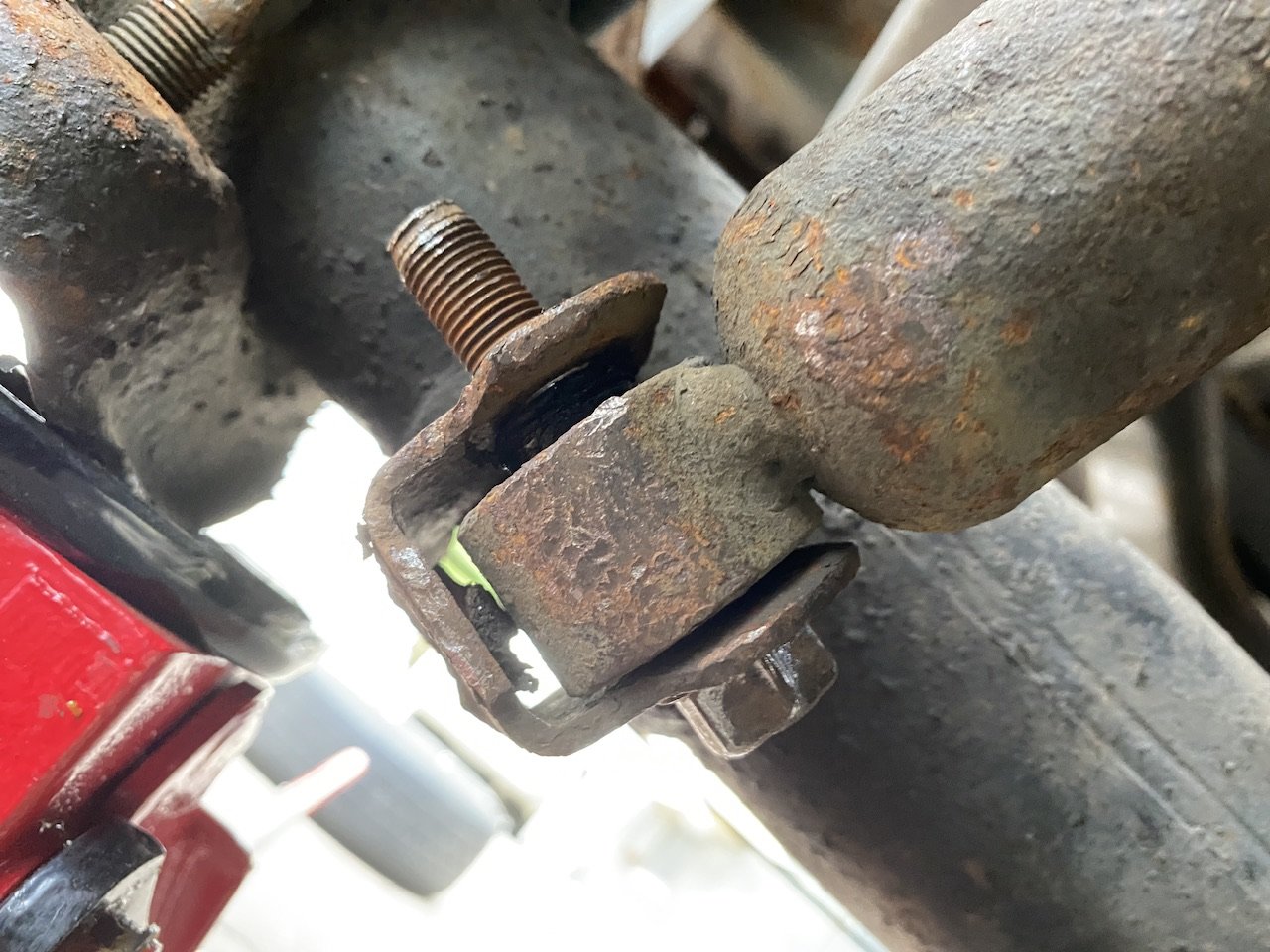

    Shocks are over-rated….

    2,797
    Dija
    The Lone Star State
    That axle looks nice

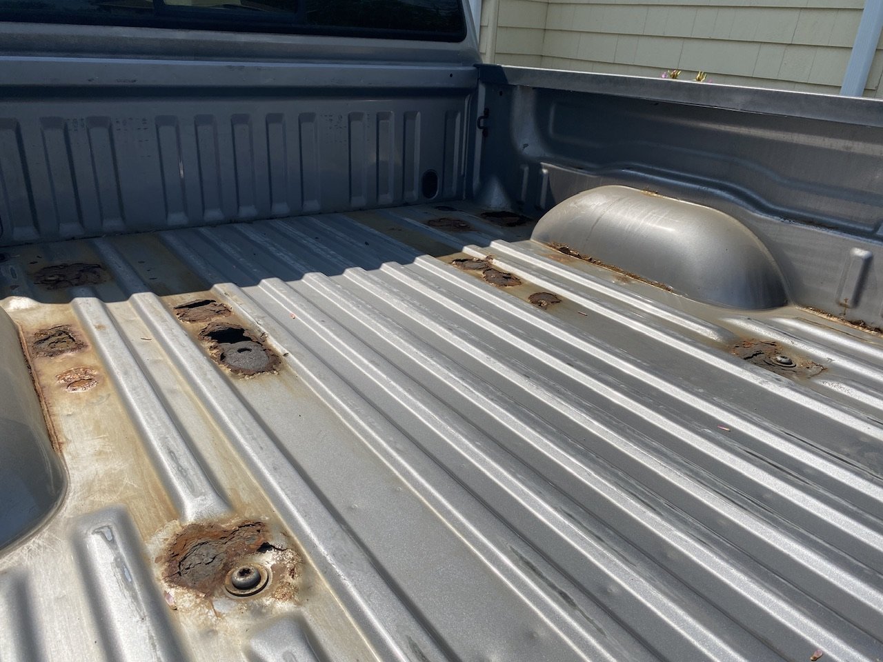

    '02 AC TRD

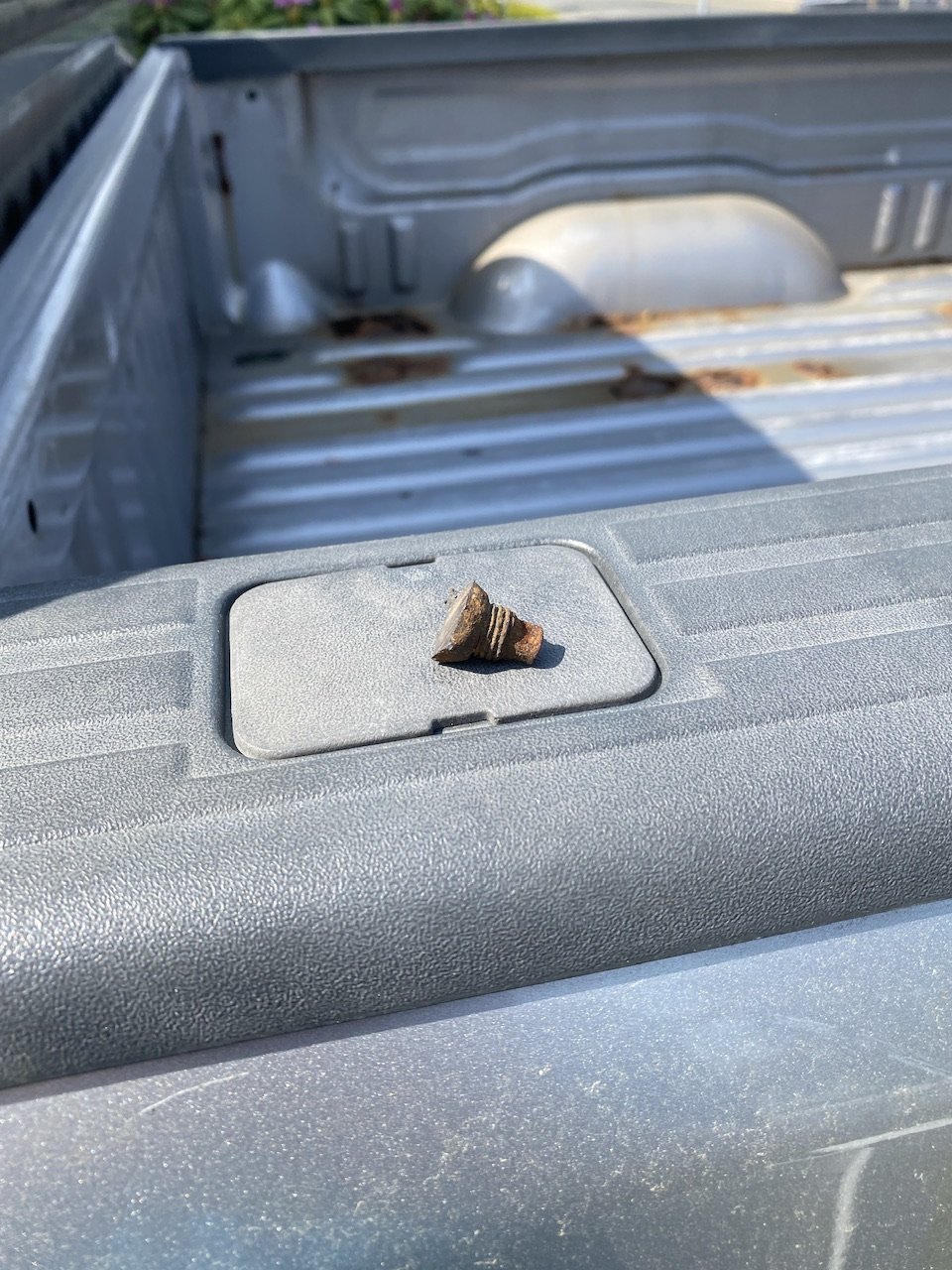

    Awful nice to have those handy skylights in the bed.

    North of Boston
    These?

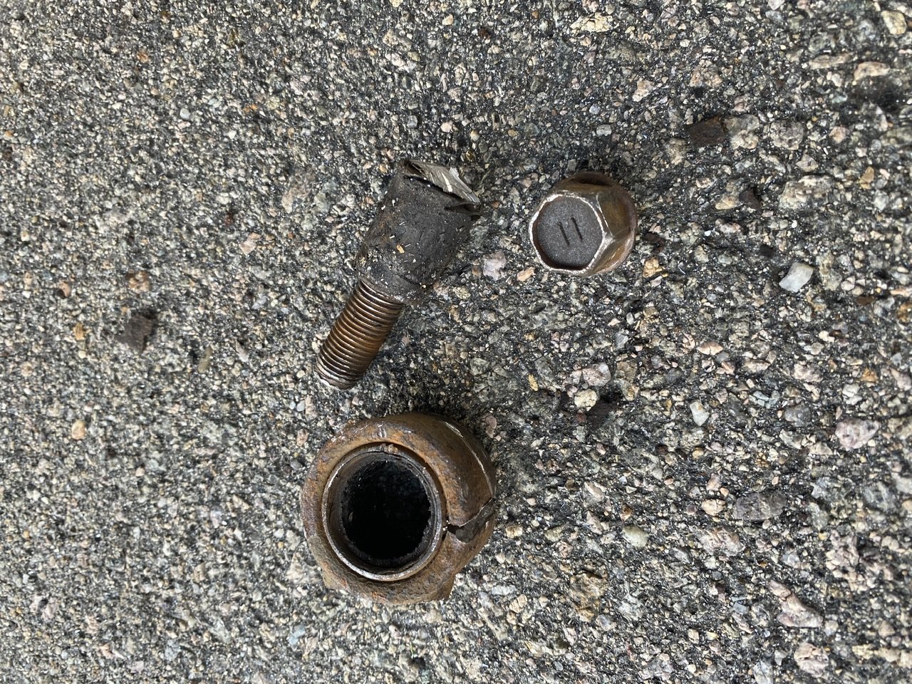

    @txagg , the metal sleeve shock bushing is stuck to the bolt and we broke it free but only by ripping it from the rubber bushing eyelet of the shock with the impact. Sucker is glued on there right.
    No, I just woke up. Gave up for the night. Tomorrow the whizzer comes out. Like a dremel on steroids.
    Mangling completed. Anyone want to buy my truck? :rofl:
    Note to self: change original shocks at shorter interval than 250k miles.
    FYI...my father did the mangling, not me. :rofl:(aren't I nice making an 85 year old man crawl underneath to do that, but he insisted)
    Next time, I'll buy some sharp cold chisels since his suck (all dull). At least with those I only need a partial mangling with the whizzer before chiseling the last 1/4 of the bolt to break it.
