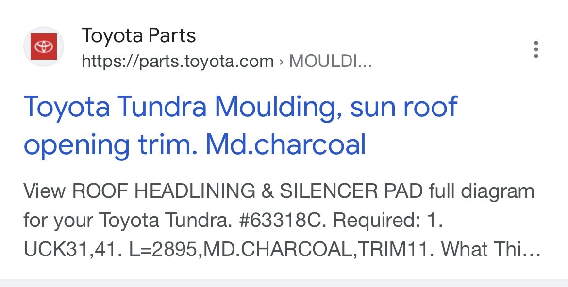

    I was drinking the koolaid until I ran across L=2895 for a particular piece of trim
    Since Toyota online is somewhat fubared, it won’t bring up that link to that part in case it explains J or L or meaning of 2895
    https://parts.toyota.com/p/Toyota__...NG-TRIM-MDCHARCOAL/63210164/633180C010B0.html

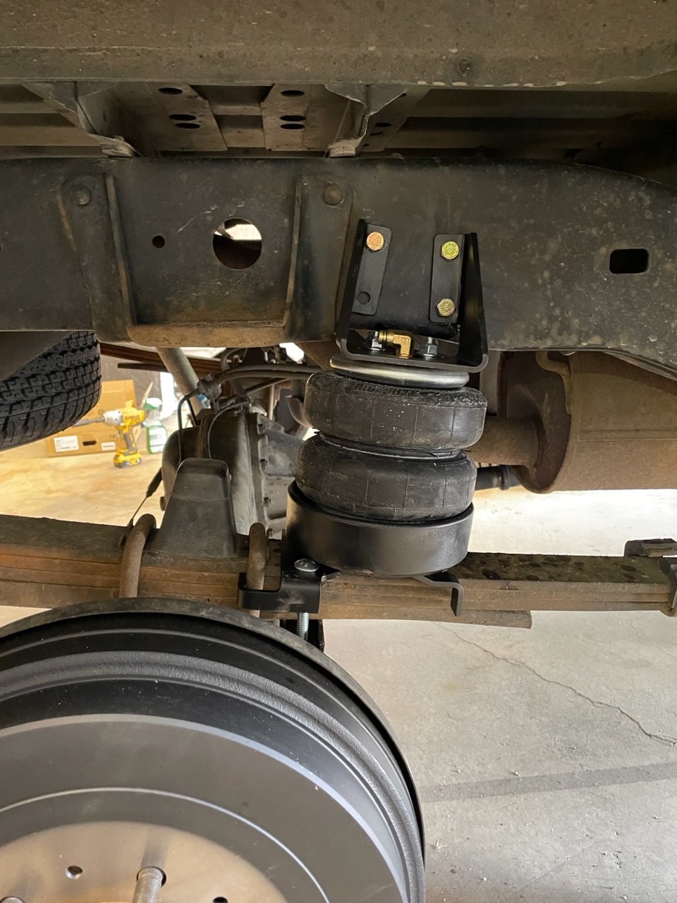

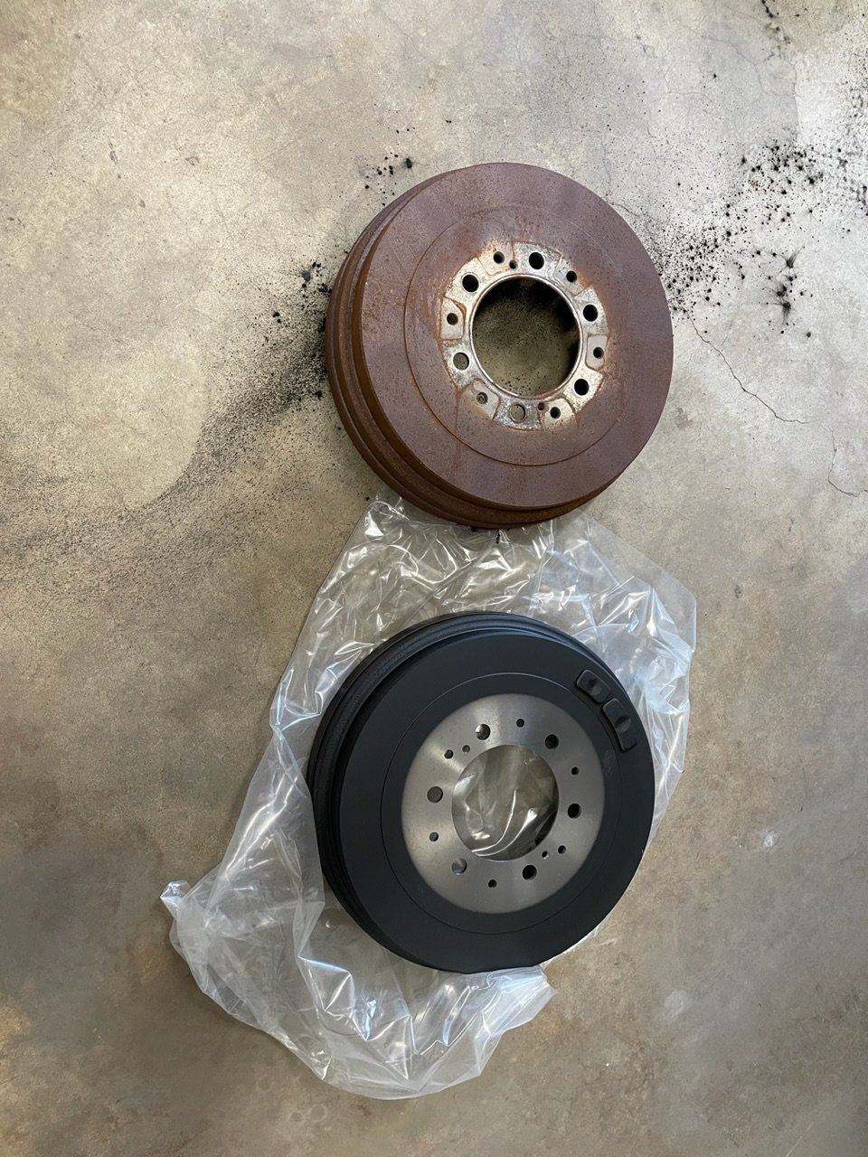

    Well. All done. Went fairly easy after I figured out where to mount everything. Ended up doing a 2 to 1 tee to fill the bags instead of nipples for each bag. Hope I don’t end up regretting it but should work fine. Going camping the end of this month so I’m excited to see how it tows.
    And what’s a pic without a nip slip…
    I also ditched the stupid Raybestos drums because they aren’t round and put the oem Toyota drums I’ve had for a few months sitting. I did notice that only one of the new drums had what appears to be weights? Assuming the other didn’t need it. Again I’ll have to see how she drives later today or tomorrow. The old rotors look super rusty because my truck sat a few hours in a flooded parking garage but they only have like 2,000 miles on them lolIMG_4917.jpg

    This is the #1 biggest mistake people make when running bags, and it will bite you in the ass. Good thing you have time to correct the problem before towing. Read from this reply onward to understand why it's a huge mistake and what happens when you do just that.

    Dammit! Never thought of that. Well here’s hoping I left enough slack to not use the tee. Guess I’ll have to revisit it tomorrow or this weekend. Thanks for the heads up and the extra work jk

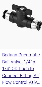

    You can keep the tee in place. You just need to add a stop of some sort to prevent air from entering the other bag.
    Maybe use a shutoff valve at the T itself, or if they make a T with shutoffs on either side. Something you can open to equally fill both bags, then shut off the line to one bag after.
    Possibly something like this, but don't buy this, I don't know it'll work. IIRC, last bags I ran were using 1/4" OD, but that was like 8 years ago now. This is pneumatic, press-in, but may not be appropriate. Again, you'd only need one valve total, installed somewhere between the tee and either the left or right bag.

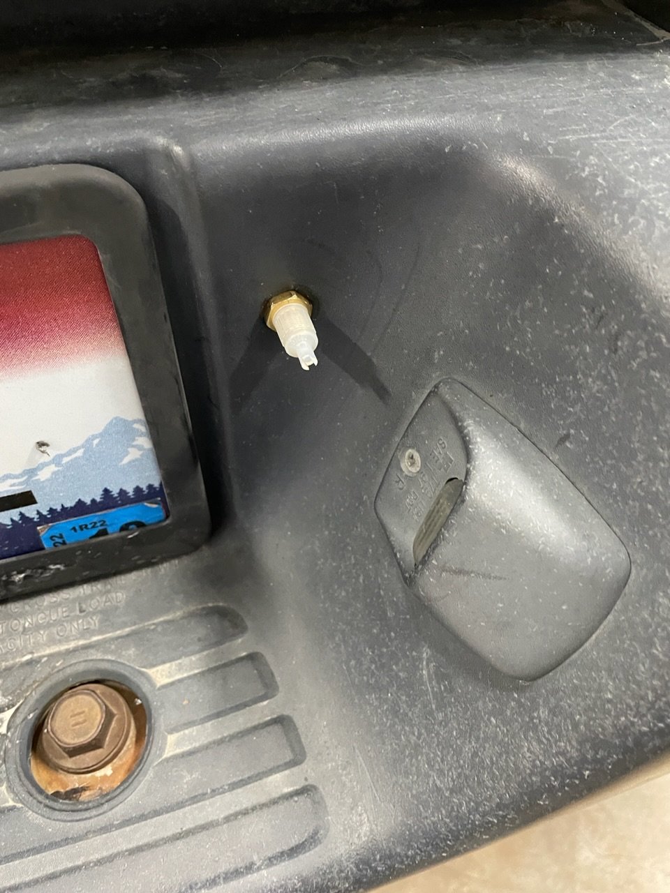

    Still catching up on posts, since ive been off the site a couple weeks but just say this post and thought id comment as i just flushed and bled my brakes with the motive power bleeder from Amazon.
    I ended up returning their "universal adapter" as it was leaking no matter what I tried and couldnt get passed 5 psi. I ended up going to a pick a part, took a MC press fitting cap and made my own adapter using that.
    Drilled a hole and ran some tubing in it and siliconed the cap shut so it couldnt let any air escape. Then used the j hooks to clamp it on with a metal piece i added on top and it worked perfectly! Ill take some pics of it if you like?

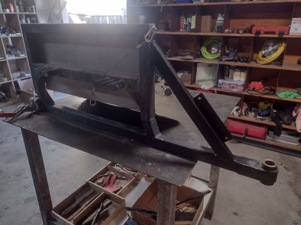

    Got new pads on the brakes, flushed and bled the brake and clutch fluid.
    Then welded up a bracket in the dead space on my swing out for a fire extinguisher mount.

    Hmm. I Guess I’ll try one of those. That’s a lot of fittings and chances for leaks so I’ll see how it holds up. I may end up just buying new tubing and running two new lines. Only 4 spots to leak that way. With this valve it would put me at 8

    6 places. You'd be cutting one line and inserting that fitting as seen in blue below, only an example. You only need one, on either leg of the T, as such, to prevent air passing between the bags. Open it during fill up, get things to the PSI you desire, then close the valve and you're running on an isolated system again.
    Really, you're just isolating each bag from one another, and as long as you install these press fittings properly, you won't leak. I use them for everything from water plumbing to airbags, and the only time I've seen leaks is because of stupid stuff, like failure to cut the tubing square or clean up the edges.

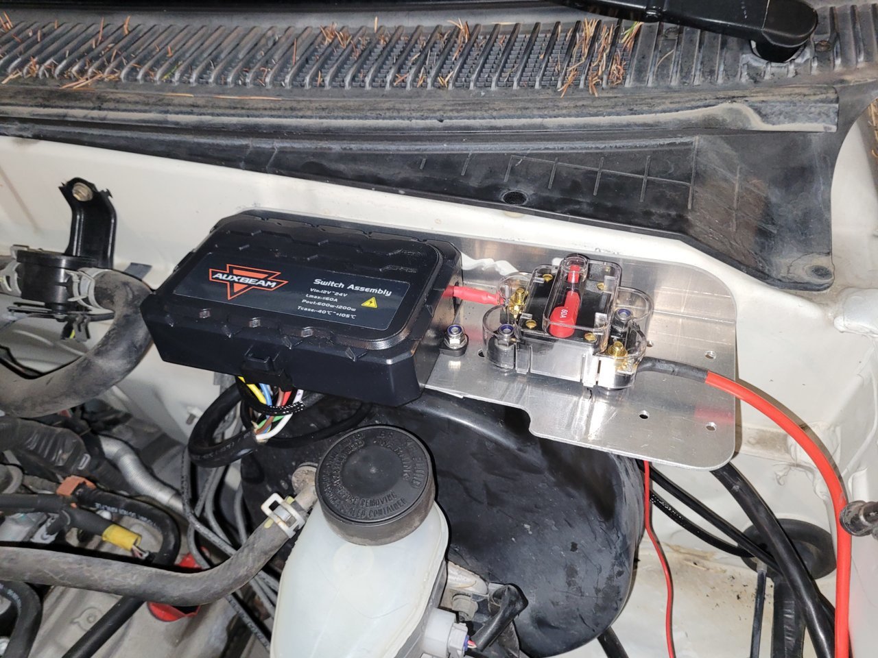

    Tagging @RUSTYNUTS
    Never heard back after I quoted. What parts did you use for this? Welded yourself or at a shop? Have any pics of it?
    RUSTYNUTS[QUOTED] likes this.

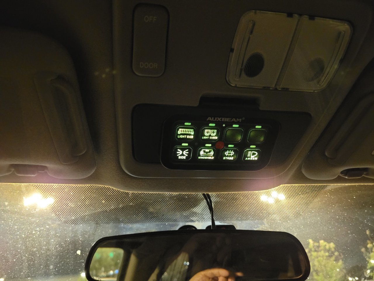

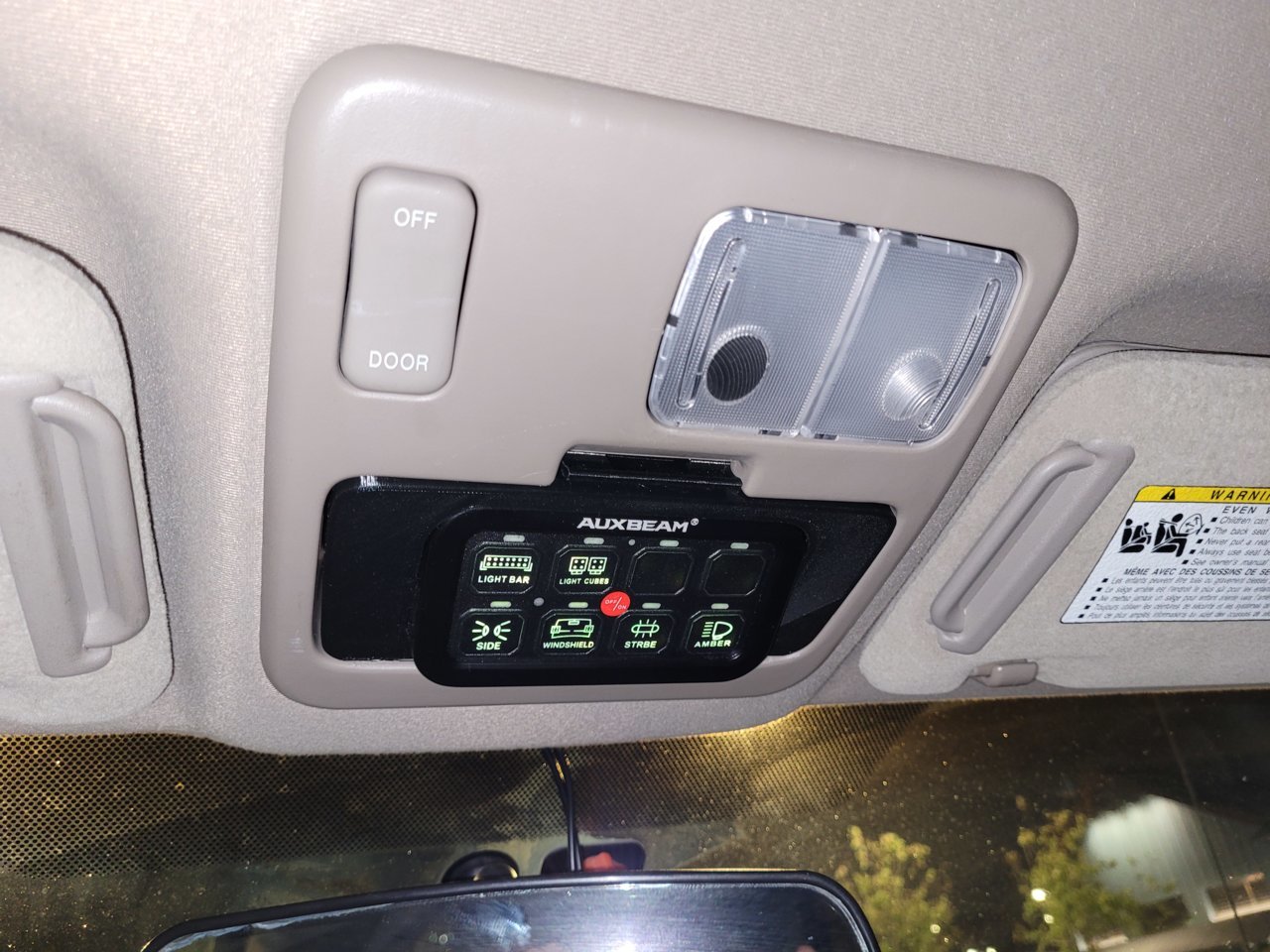

    Front Bilstein 6112 shocks & Bilstein springs. Rear Bilstein 5160 remote Reservoir shocks, Wheeler’s Off-road add-a-leafs. LED lighting. Pioneer Avic 7200NEX Nav Head unit. Borla cat back exhaust.
    I got my Auxbeam switch panel mounted and wired tonight. Just need to tidy some wiring under the hood and add my ditch lights.
    Love it!

    I remember the post, and fully intended to respond. My attention must've been diverted. I'm just going to blame prepping for the Sedona trip.
    So uh, I'll try to find the kit I bought, I believe it was a Ammozone purchase. Yes I did the welding myself. I can get you a couple pics tomorrow. Shit... just right now, thinking about getting under there and shooting pics, I remembered that I had broken an exhaust hanger bracket, and my pipe is being held up with a tie-down strap. Don't recall exactly how, just that it was done in a way that it won't burn/melt and fail. And apparently well enough to hold thru the whole trip and all the abuse while there. I apologize for the tangents, you just reminded me about that. I'll get a couple pics tho tomorrow and find the kit, possibly now. In the mean time, enjoy this clip of a truck running a course with its exhaust secured using only a nylon tie-down strap.
    https://youtu.be/NxBhp0fw1_0
    edit: that course is not nearly as basic as it appears on video. Soft volcanic rock-made sand, and full of bumps/whoops. If you watch closely, you can see the rear bucking violently a few times. Need more travel in my rear suspension evidently

    So, the listing is gone since I bought it a couple years ago, but this closely matches what I bought..
    https://www.ebay.com/itm/1450333576...uid=wWqxvA8JQ7y&widget_ver=artemis&media=COPY
    There is a better version similar to this that I wish I knew about when I bought it. The one in the link, as well as mine, have a single valve that opens and closes (simple butterfly valve just like on your intake manifold) When closed, the exhaust passes thru the 'other' side, which is just an open pipe into the muffler When you open the valve, it passes thru both, so half the exhaust is still muffled. On the better version, both pipes have a valve, and both operate on 1 motor and a shared shaft, but in opposing positions. So when a pipe opens, the other is sealed shut. Then upon opening the cutout, 100% of the exhaust will bypass the muffler.
