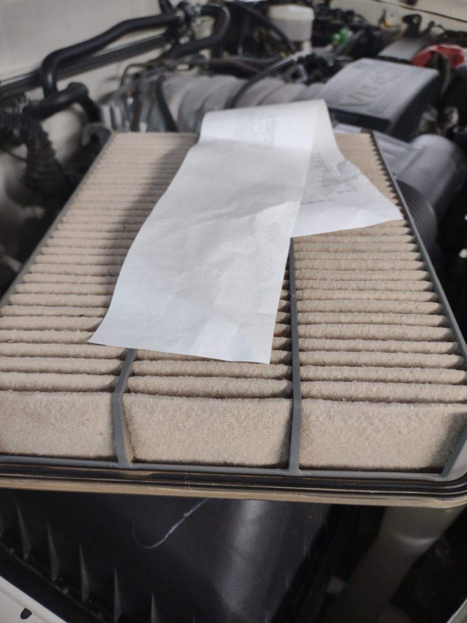

    Side note, I think I'll just buy a new air filter. This is pretty bad. White receipt for reference.

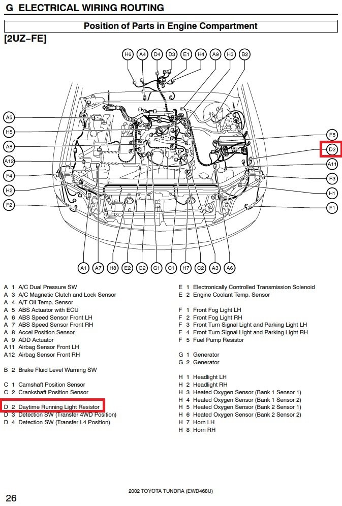

    Believe you're guess is correct about DRL resistor location and yes it was standard feature on V8 AC Limited according to 2002 brochure....optional on others.
    @Mr.bee , according to the 02 EWD the colors are W/Blk and W/Grn ??

    MAF would probably appreciate some TLC and new Air Filter

    yessir, probably shoulda just followed the wires. Sorry, but thanks.

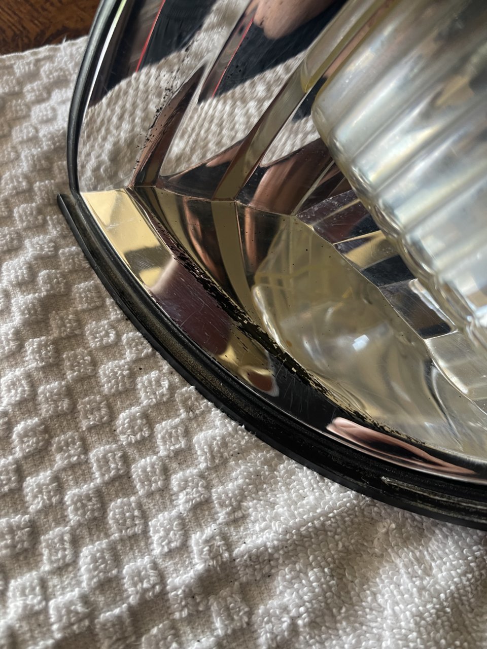

    and incase anyone gets to reglue their marker light lenses back on, dont use a damp towel on the chrome. Rubs right off.

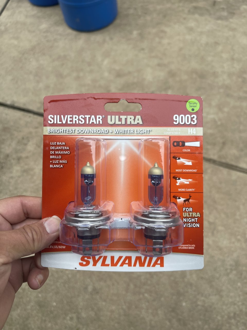

    Went ahead and skipped the regular bag & dbag lights. Full-on ultra dbag lights for the win. I think i might suck at adjusting em, so i'll fit in better.

    Downside of those lights is short life cycle despite the high price. I was lucky to get a year out of them. Light output was nice though.

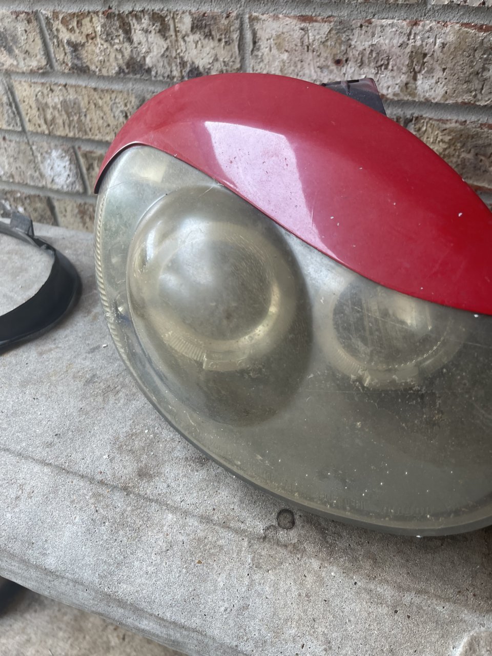

    I've got some we pulled off my buddies srt4, but i'm not sure if i can get em apart without destroying the projector lens housing. Been noodling this idea for a while, and it seems like the best bet is going to be to cut em out from the back or try to saw the assembly lens off.

    Pop the red part off. Bake the housing to remove the lens.

    Think 200* would hurt any of the other plastic or 'chrome'?

    I mean, typical baking temp is 250° - 275° at 5-7 minutes time. As long as you stick within that range, it should be safe. I always need to look the numbers up every time. YMMV, exercise your best judgment.
    I'm pretty sure @SouthPaw listed out his method used, and I think @TX-TRD1stGEN did also when he did his projectors a couple years back. In case you wanna get a 2nd/3rd opinion.
    Resealing is not hard once apart. If you have some RetroRubber, clean out the old channel, pull the stuff into a cord that seats in the channel to get it right. It doesn't need to fill to overflow, you just need a good bead in the channel before plopping the housing back in the oven, baking, then clamping it sealed.
    Just make sure you do all your test fitting, aiming and aligning before reinstalling the lens :D
