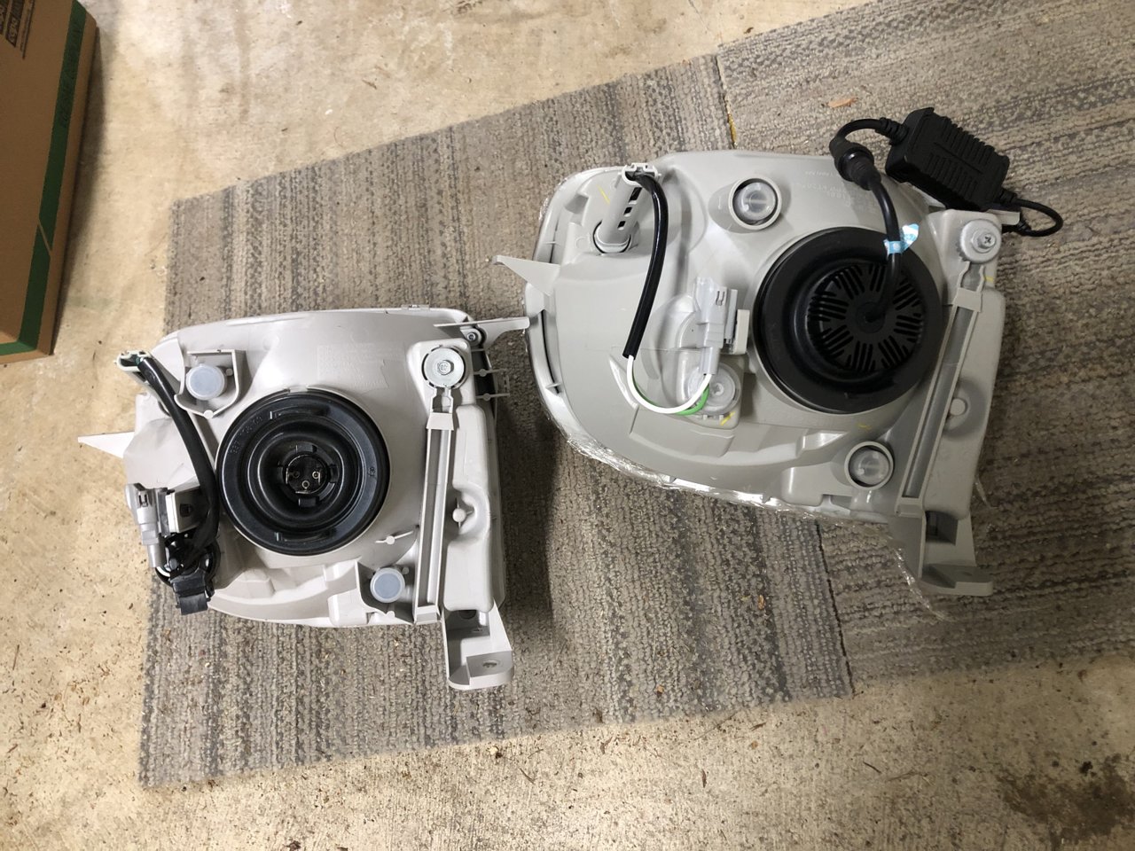

    I bought the BraveWAY bulbs, which are exactly the same as the CO bulbs, but 10% less cost. They clearly have the same warehouse supplier. You can save another 5%-10% if you buy the single bulbs intended for motorcycle. I contacted them directly - it's the exact same bulb, whether you buy the single pack or double pack.
    Directions HERE showing the irreversible damage you must make to the housings, along with instructions before the last 3 pics, and video of the process with a warning of one thing you can break HERE.
    I'll be curious to see if I have the blue/purple cutoff line with the BraveWAY bulbs. It's the one thing I haven't seen in online photos yet, from people who installed. It's possible this was improved more recently in the bulb design. Maybe they're using a better lens.
    Yes. Fan is an Achilles heel for lights. If the fan dies, the light won't be far behind. I bought fanless. PIC of what it looks like in the rear.
    One complaint I keep hearing about the mini-projectors though, the beam isn't wide enough, which seems to piss off people who drive on backroads etc. I guess the wider lens on the 3" projectors allows for a better cutoff and wider clean cast.
    This is what I did too. DEPO, TYC, and EagleEyes all make great housings. Get CAPA certified housings if you want some longevity. DEPO offers 5yr guarantee on their lens being clear and free of haze on their CAPA lights.

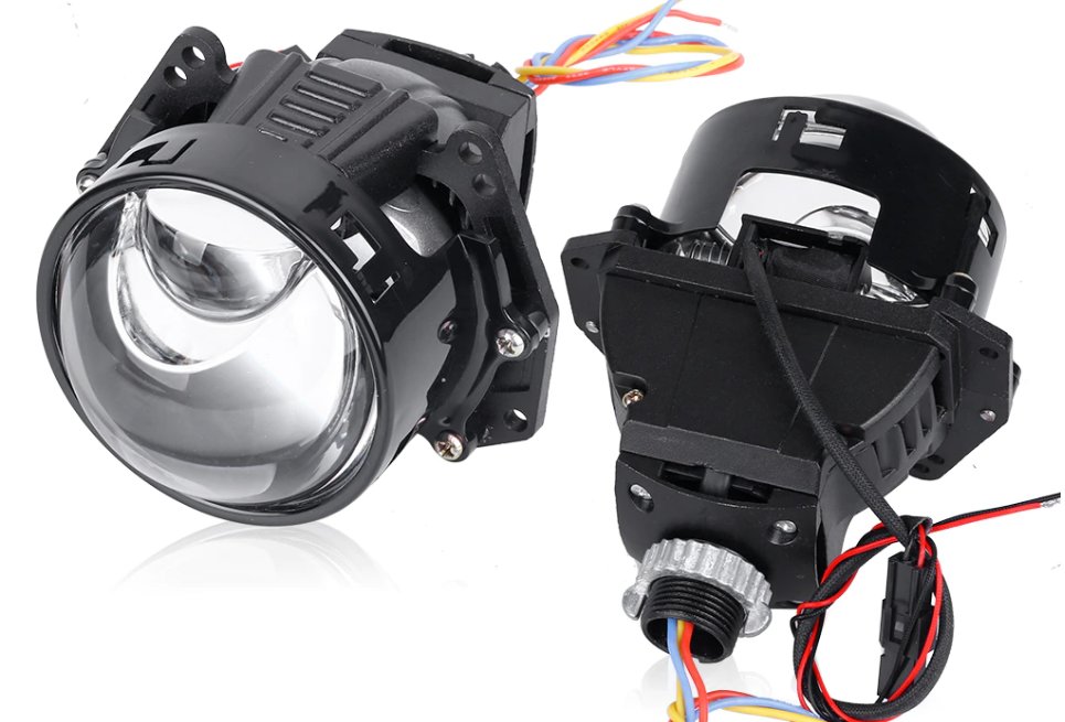

    I'd love a review on these. I'm very tempted by the Morimoto MLED and these look like the same thing.

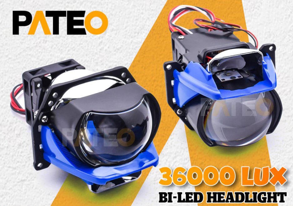

    Baked open some fleBay Chinesium fogs and threw some 2.5 bi-led projectors in them. Yes. I have a problem. LOL

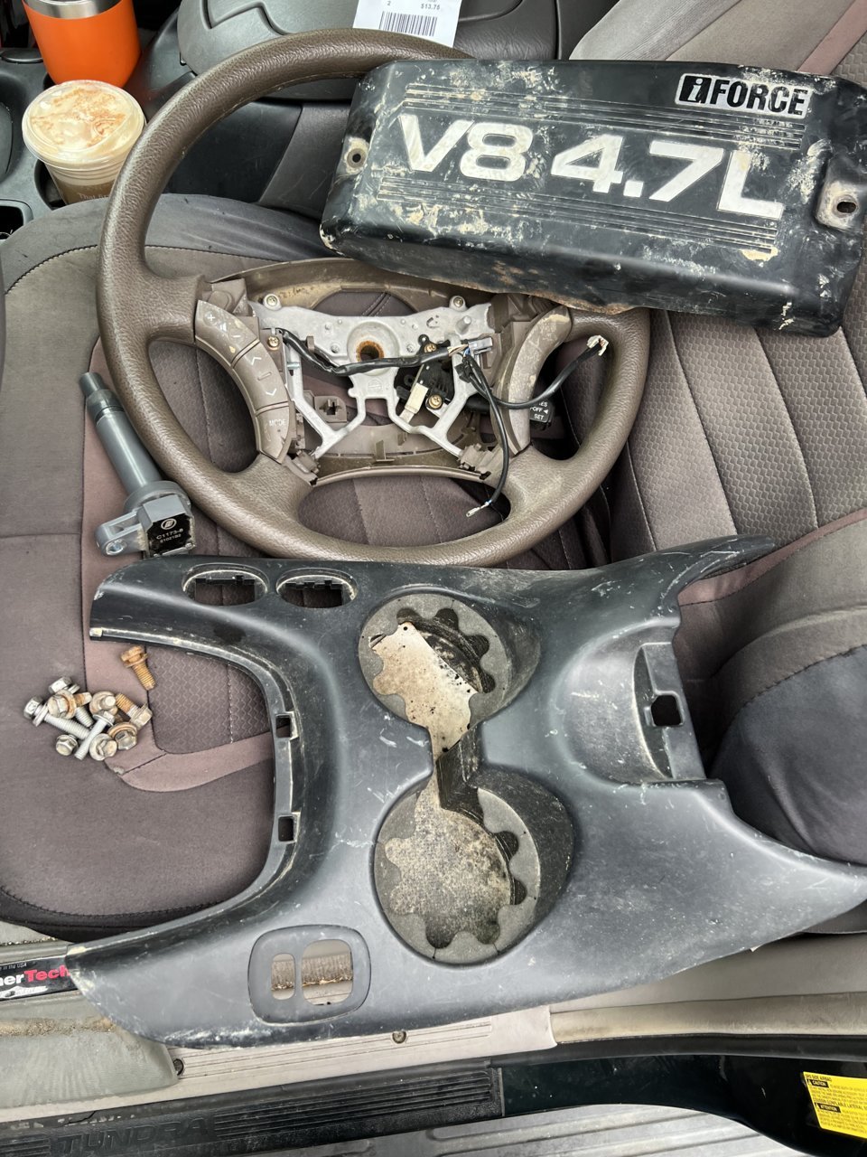

    I went prancing around 2 of my local junk yards after work, previous owner had installed one of those steering wheel knobs that’s ripped my steering wheel material all up. Found a loose ignition coil and some miscellaneous hardware I know I’m missing. Oh and a center console for me to mess with and practice vinyl wrapping: all in all I’d say not bad for $50 360674FE-53A7-4F22-B3A0-706D71E60166.jpg
    Best part was there was a taco truck parked outside the second one on the way back to the truck :D

    Random, generic, no-name coil? Sketch! :rofl:
    Foams in the center console are non-OEM, I just gave some freebies away on here. Make your life easier, separate the cup holder from below, it'll make cleanup easier.
    Don't lose the plastic inserts. Toyota discontinued the blanks for seat heaters, for example.
    Nice haul!

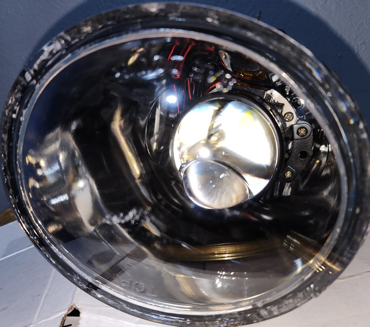

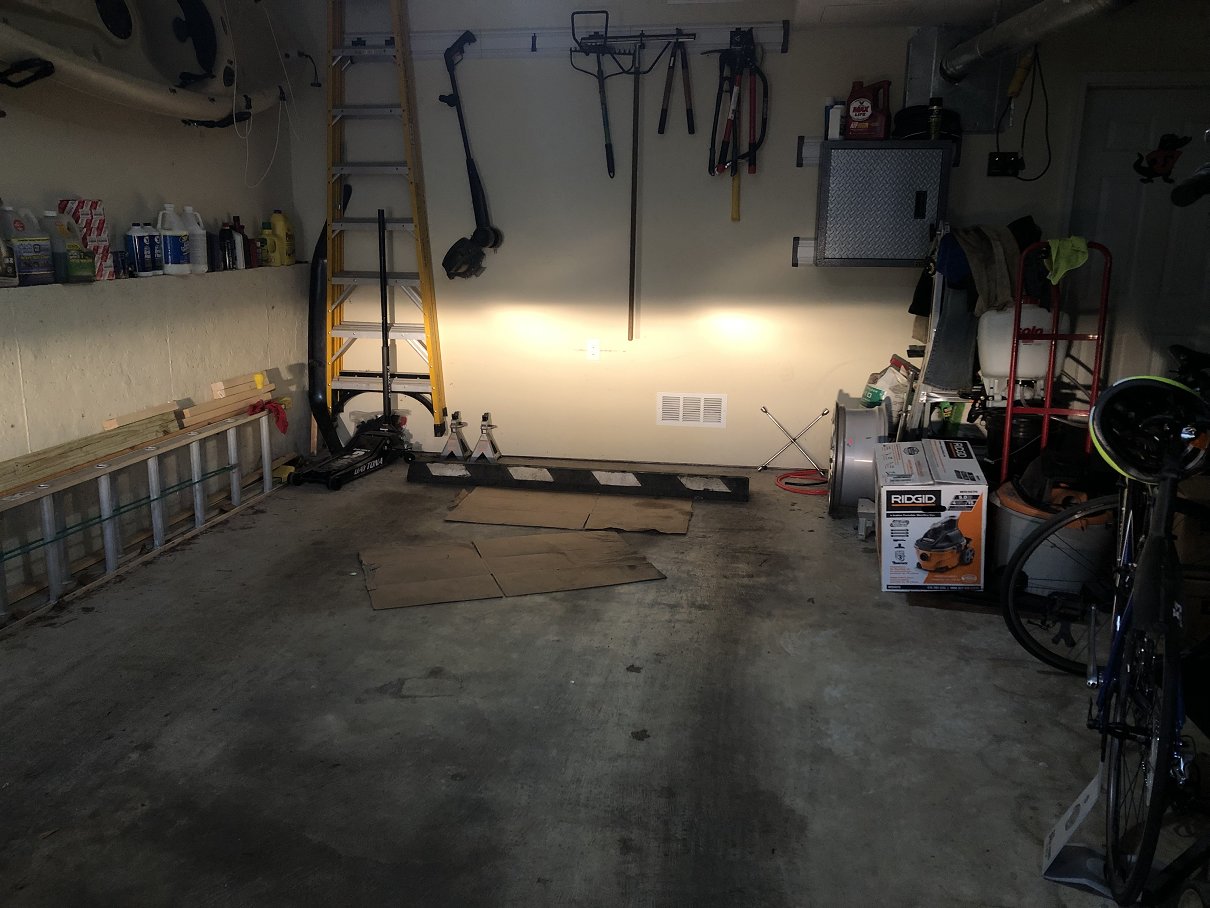

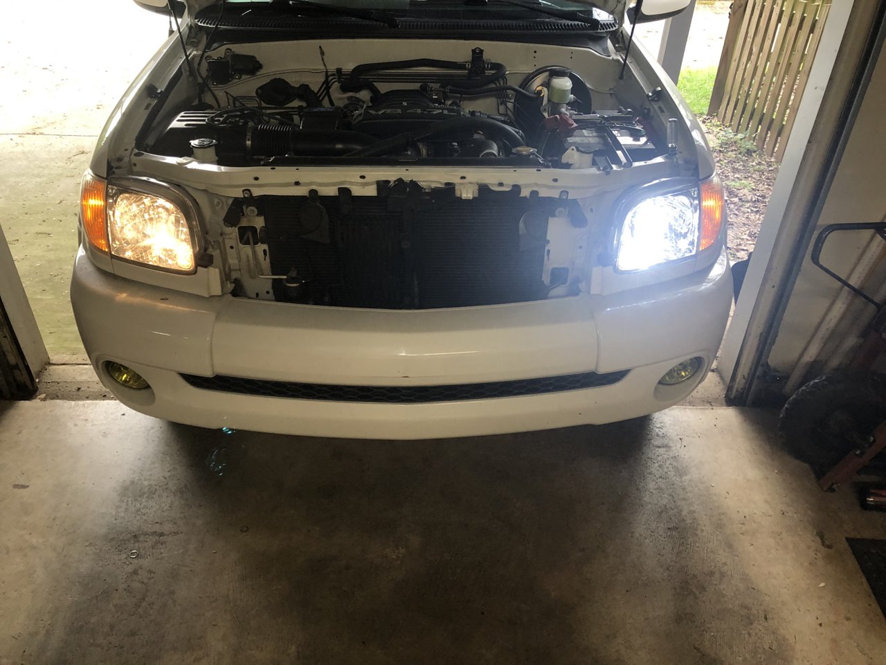

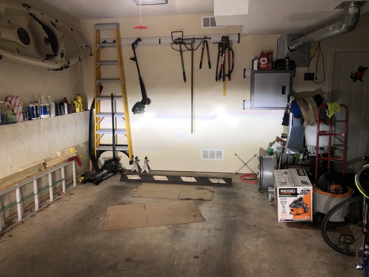

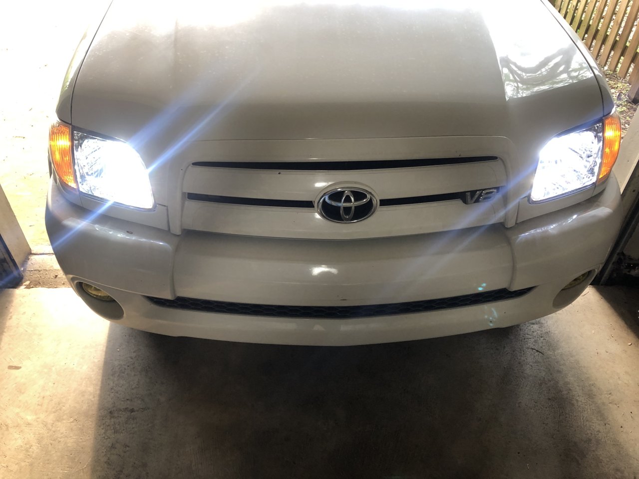

    Mini projectors installed. No night vision before/after shots, I gotta go with what I got, so basement garage it is.
    My new OEM housings weren't quite aimed perfect, but close, so I just marked the wall with where they were, then set the new ones to roughly the same.
    You have some ability to rotate the bulbs to fine-tune after you've tightened the heatsink down. I really need to secure the driver/ballast, probably I'll use HD velcro.
    Clearly they're not using the best lens, there's some abberation with purple/blue at cutoff. But the high beams are BRIGHT. I'd ballpark about 40% more light. And no resistor needed - fogs and headlights work - maybe because my AC truck has the little teardrop lights which put enough resistance on the circuit to keep things happy?
    Anyway, here's some shots. Y'all be the judge. Is it worth ~$240? I'll hafta drive at night to see how wide they cast, and how well they work with street signs and such. I also need to find a place to get them dialed in a little better, this was definitely a half-ass dial-in job, the ass-end of my truck was low on an incline.

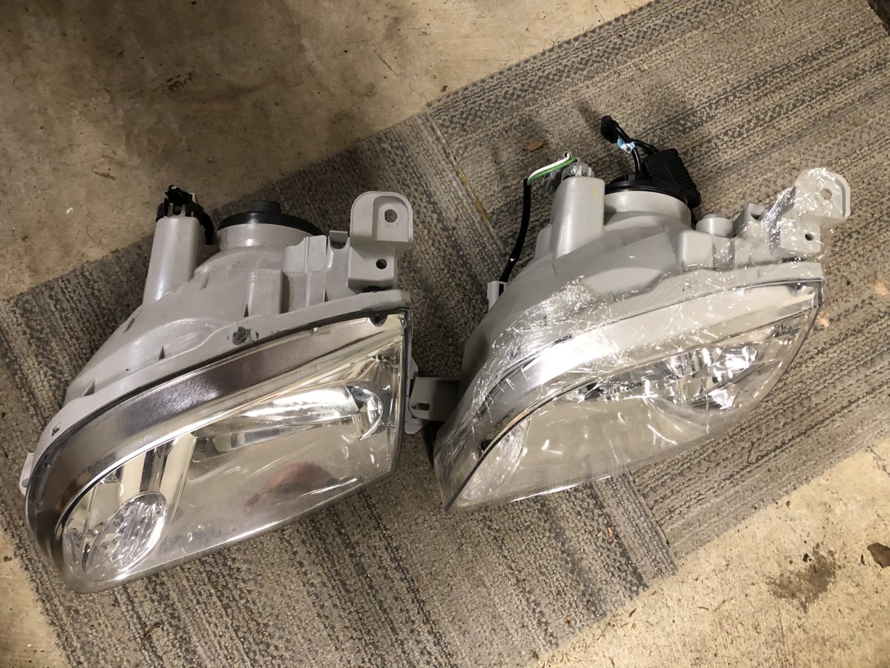

    Oh and if it's interesting, here are some comparison shots of the OEM and mini-projector side by side.
    And then some shots of the DEPO housing next to the OEM housing.
