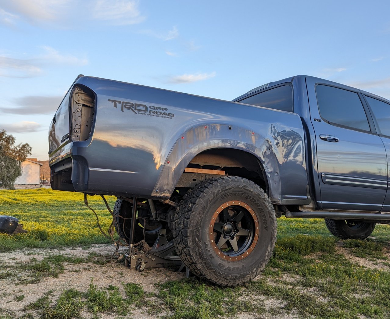

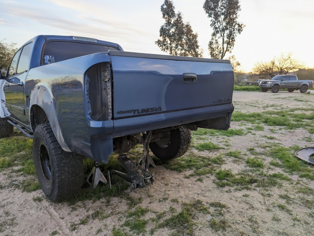

    Well, no one has bought the truck so we decided to install the rear fiberglass bedsides. Definitely going to ask like $2k more now because this shit ain't easy :rofl: I'll update once it's done. If it doesn't sell and we end up painting it, we may never sell it..

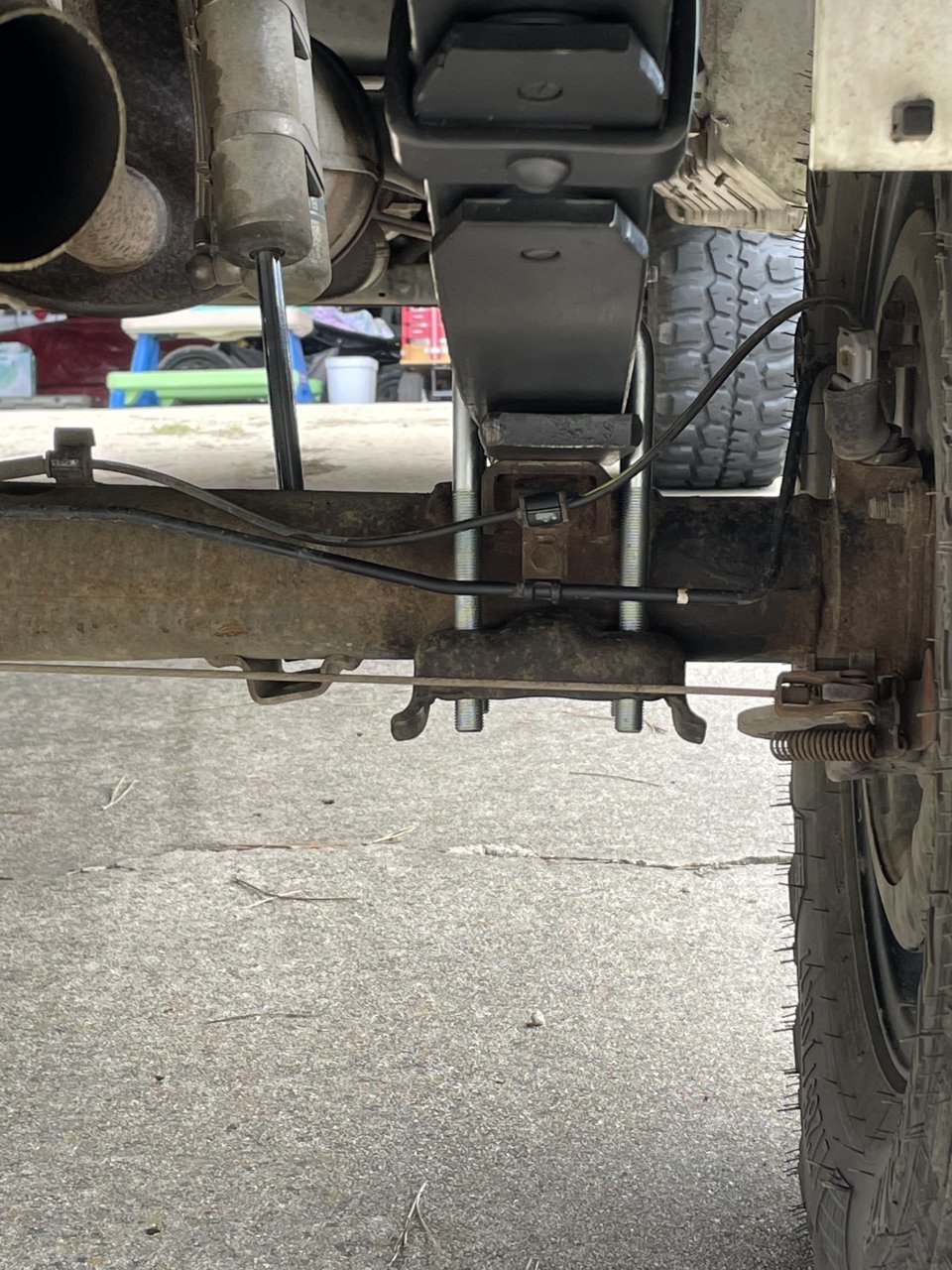

    Was checking on the rear leafs after driving on them for a bit and noticed the overload leaf had moved a bit
    Not sure if it’s a big deal but it bothers me. So next time I have time probably loosen up the u-bolts move it back into place and tighten up the center pin just a smidge. Overall these things ride great

    Time for the BFH

    It shouldn’t be that bad to get it straight, just do blows on opposite corners until it’s straight. Might as well wait until you retorque for mileage

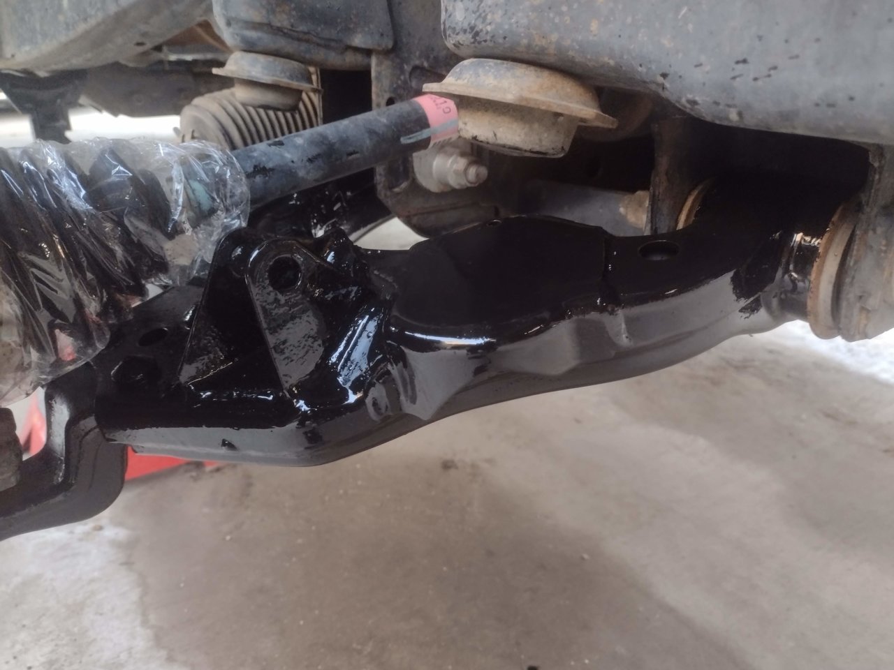

    Ive got some things ive done that im late on posting as well. A few weeks ago I bought some Bilstein 6112s and 5160s and installed those. Also painted my LCAs while I had the front suspension removed. Went camping last week and the suspension felt great. Probably no where near as smooth as Kings or the like on the washboard roads, but still a big improvement over the 5100s i had on there. I could definitely hit the washboards faster and felt quite a bit smoother. Also overall they felt great on the trails over some flexy spots. Nothing too crazy though on this trip. Heres some photos for ya guys

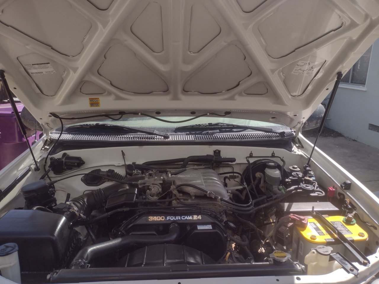

    Oh, also cleaned my engine bay after the trip cuz i had mud everywhere. Probably not going through mud for awhile if i can avoid it, haha. Took several hours to clean it all. But so much fun flying through wet dirt roads with tons of big puddles. I couldnt help myselfIMG_20230327_150315990_HDR.jpg

    For sure I’m just impatient and a slight perfectionist
