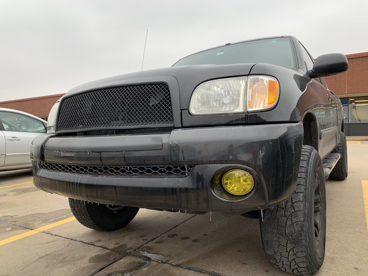

    5100’s at 5th notch, Add-a-leaf, diff drop.
    It’s cold and the trucks dirty, but I cleaned the fogs enough last weekend to add some Lamin-X film to them, but I need your headlights & corners.

    I might copy that grille when I lose these bumpers and build tube bumpers.

    Just be sure to plasti-dip it or paint it first, after about a year and a half whatever clear sealent they sprayed it with started giving it a burnt look. I just dipped it & called it good.

    I already have yellow bulbs in my fogs but I've just ordered the laminex yellow covers too.
