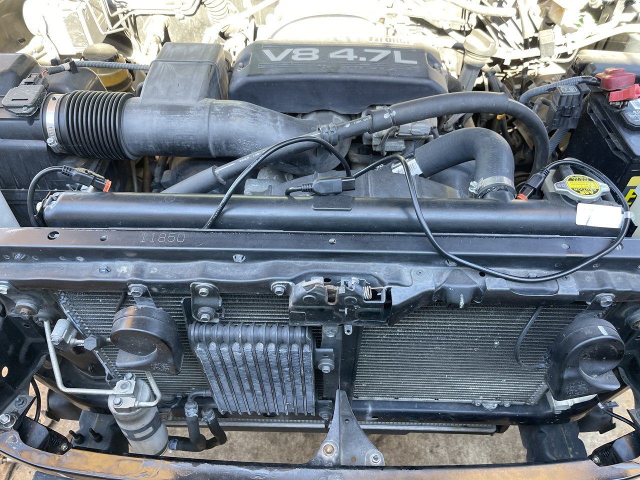

    I want to know what kind of retard was met with the problem of splitting a light circuit and decided that the center was where a single set of wires should be split from.
    fml thats grody.
    I cant run it under the fan and through the headlight holes for both sides. But i dont have the bottom of the fan shroud, so it cant be taut.
    i really dont like the look of connectors up front. Maybe tractor supply has the right grommets for a 3/4" hole.

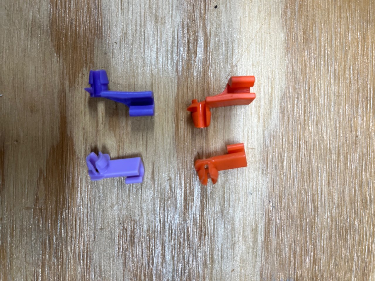

    New OEM tailgate handle with beefier 2nd gen orange and purple clips. Raining right now, so tomorrow I'll install it.

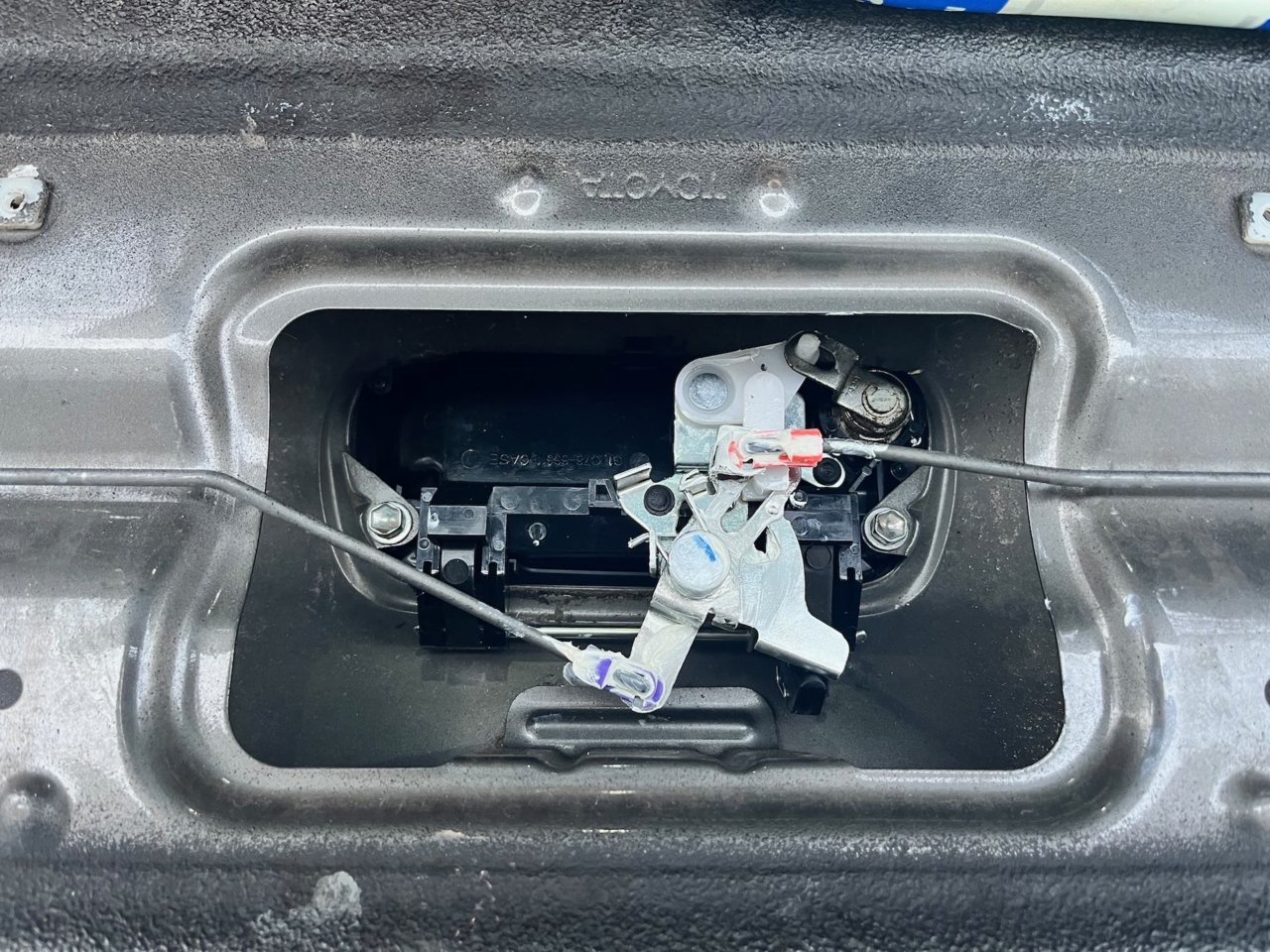

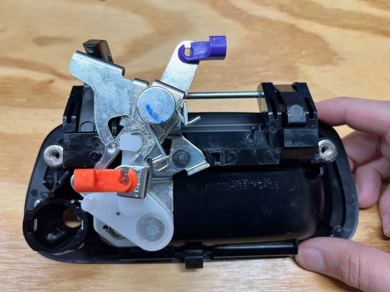

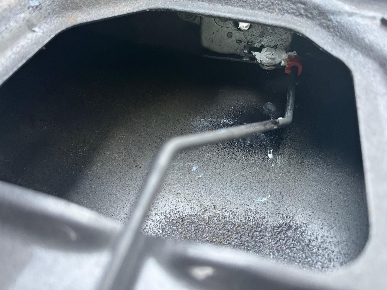

    New OEM tailgate handle. Beefy 2nd gen clips. White lithium grease on everything.

    Don't forget to spray some lube up into the internals if you didn't already :D

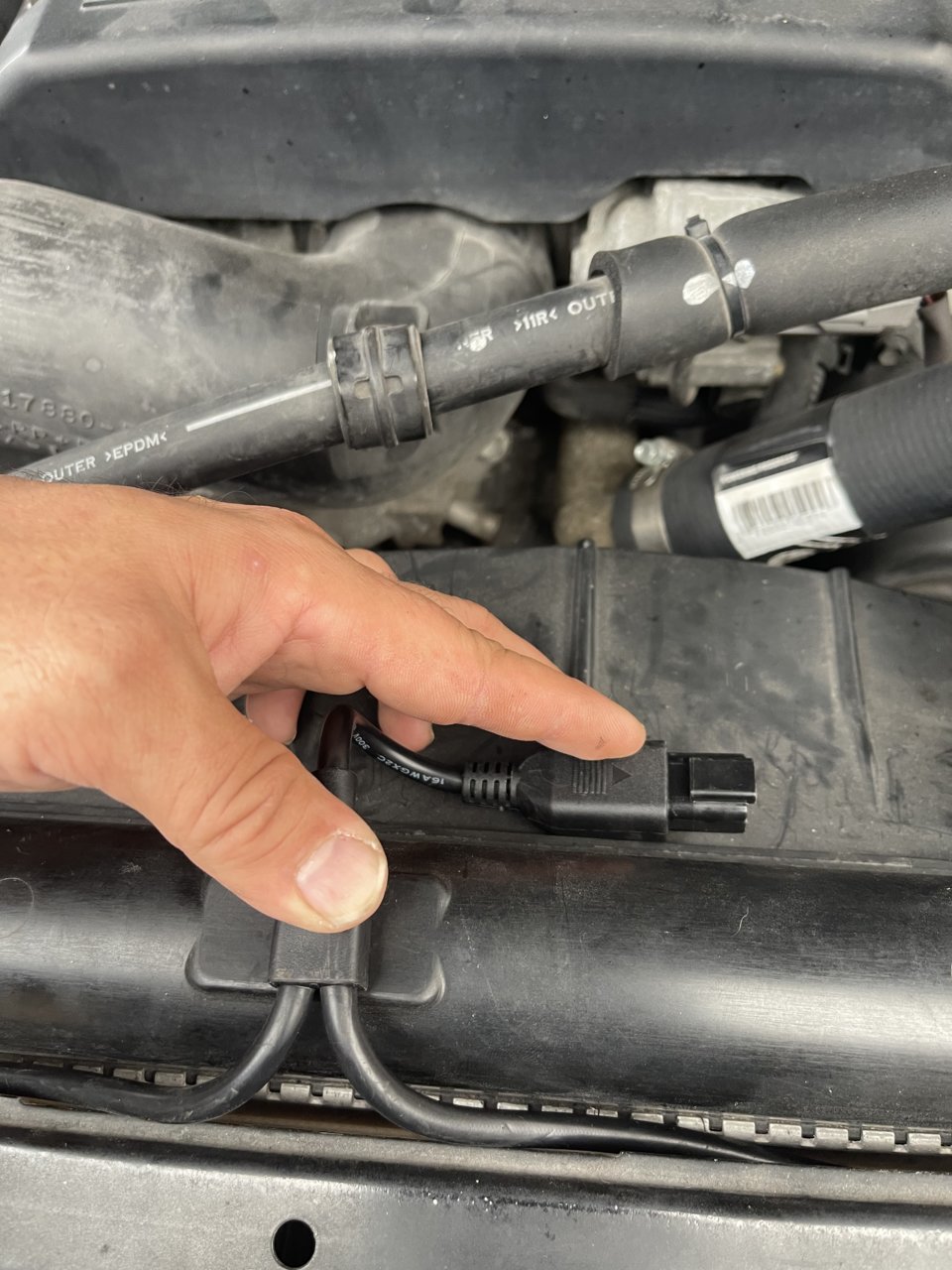

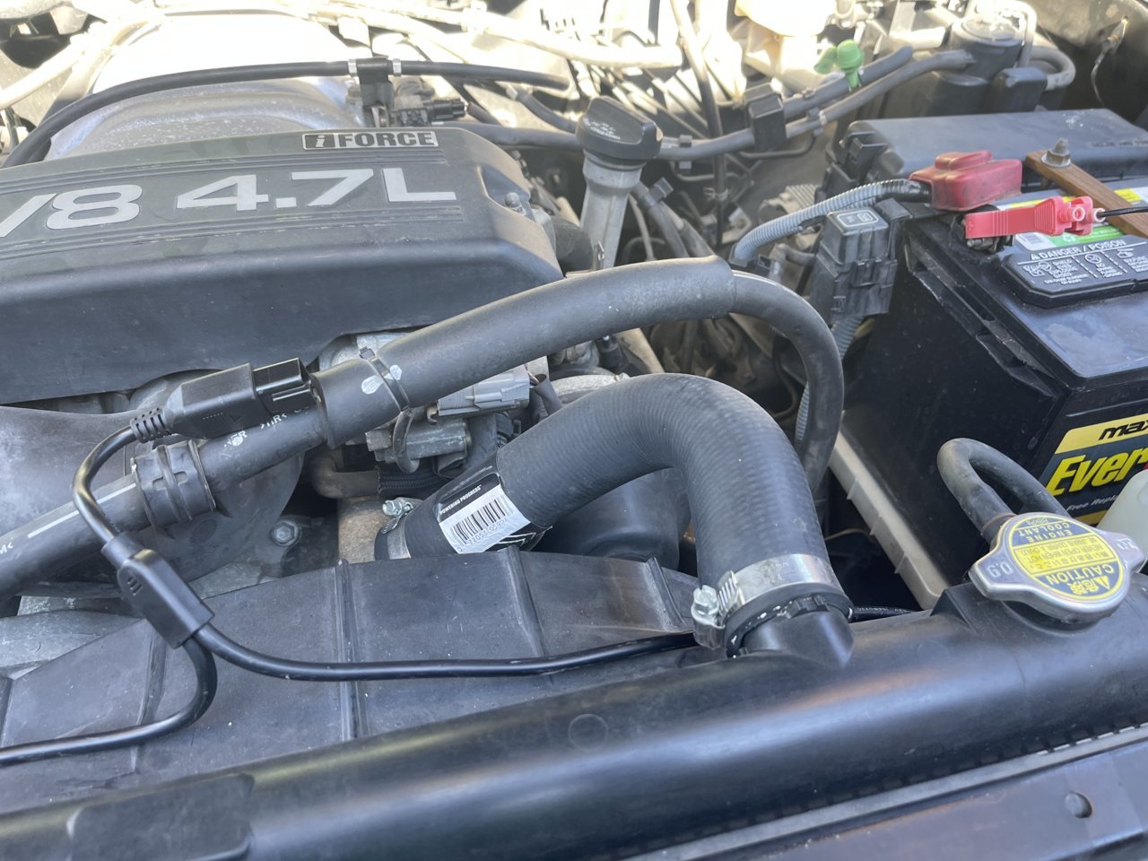

    The plastic tumor fits fair between the rad and rad support... i dont feel like its putting too much force on the top tank, its too snug to rattle, but i dont have to apply any force if i feed it in square.
    or i could double sided tape it to the pad on top of the rad. I think i like this more. ?double sided high heat foam tape? I dont see temps on the generic foam tape.
    the wire is rated to 105*C

    I got the kit with a gift card, the rest will be easy, but this center splitter grinds my gears.

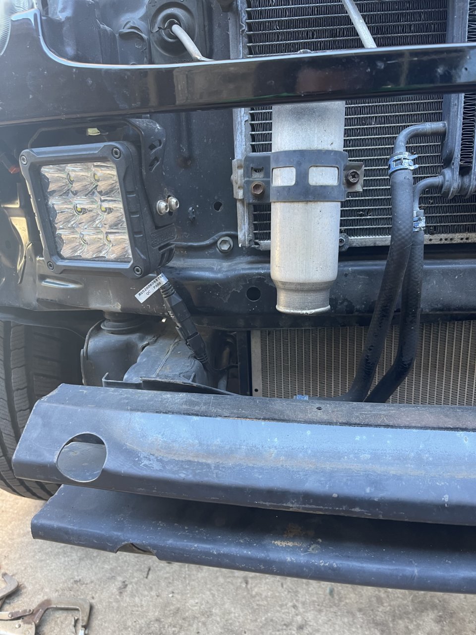

    I ran the power wires for my front light bar lights through an opening low on the drivers side in front of the battery, could run the wire through there and leave that hydra pigtail splitter thingy on the cool side of the rad near the horns mounting location?

    I'd have to hog out the holes to run across the lower crossmember, and light plugs have seals, but they'll be exposed. Above & in front of the rad hides the light plugs behind the headlight housings.

    Put a capture nut inside that hole in the rad support, and bolt it to that.

    i can zip tie it to the wires already there. Might add some plastic to the lip where the wires will touch. But nothing should vibrate. My home automation buddy said he didnt think the regular foam tape would have a problem with underhood temps.
