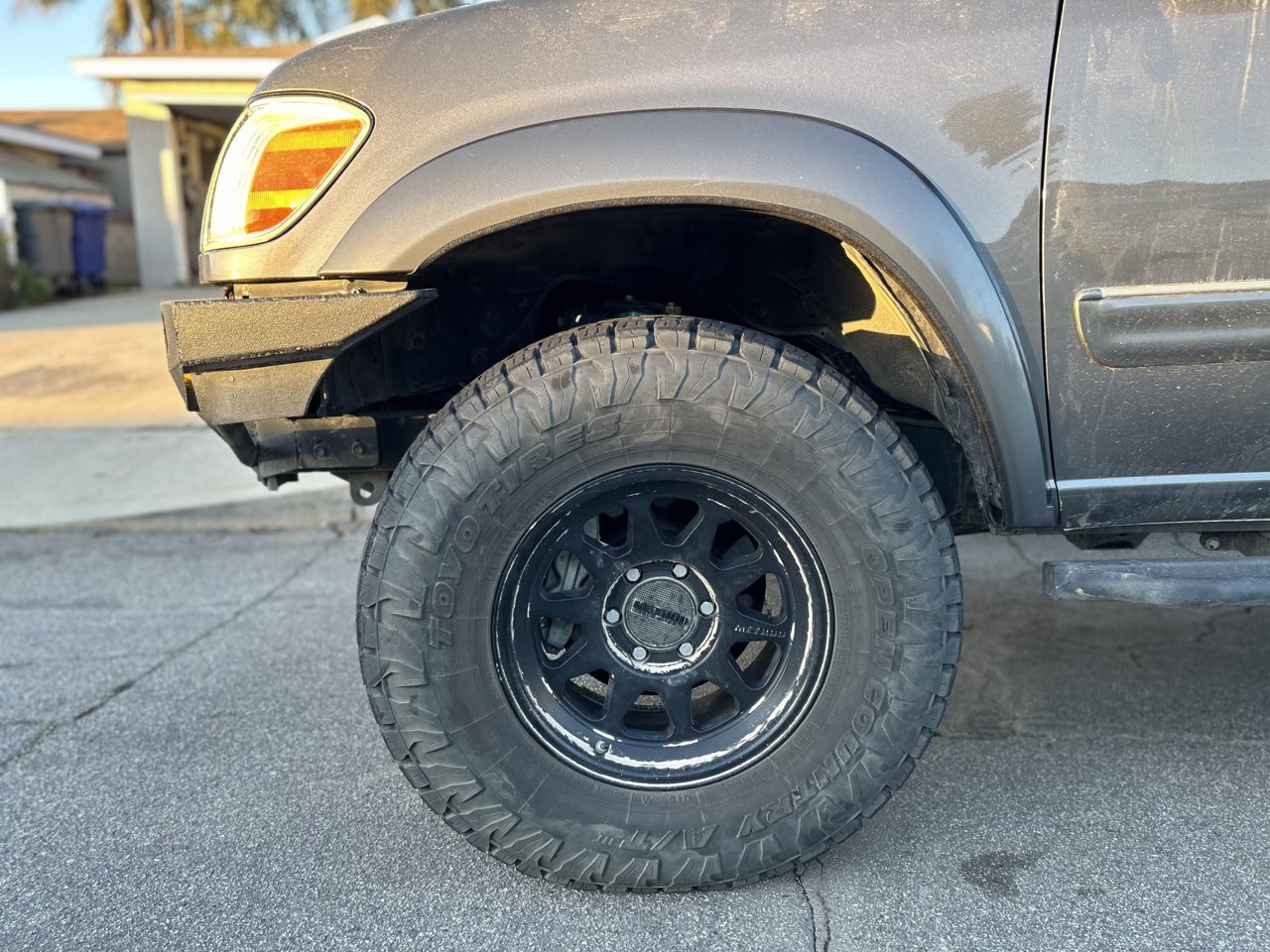

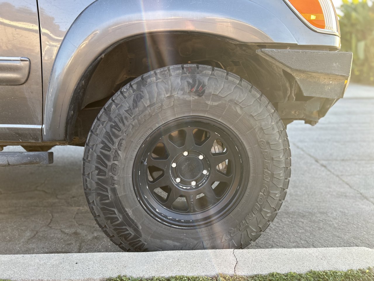

  19. Dec 7, 2022 at 4:33 PM
    alb1k
    Mar 6, 2021
    #60092
    6,564
    Left Coast
    05 2WD DC w/ attitude
    It's good
    Operation fender mod underway. Needs some more development. Gonna need to cut the bumper to improve the lines as well. Last pic is the untouched side.

  20. Dec 7, 2022 at 4:35 PM
    FrenchToasty
    Sep 15, 2019
    #36156
    18,702
    Mo
    The SoAz….. big surprise
    Bone stock
    Do you actually rub on that part of the bumper? It doesn’t look terrible
  21. Dec 7, 2022 at 4:38 PM
    Mr.bee

    great job, cause it took me a few minutes to see what you did.

    Buzz cut

    No, I don’t hit it. I was thinking a subtle cut. But, I’ll get the fenders dialed before doing anything with that. Note: when your wife asks how she looks in her new dress, avoid “not terrible”. Lol

    you should do a write up once complete, like the idea of this

    I can do that. I’ll take more progress pics. I’m figuring it out as I go, but it’s not for everyone, lol. In my setup and tire size, it will eliminate pushing fenders on the big hits on a turn. It better.

    My bad, I thought you quoted a different bad ass off roading picture. I’ve been up since 2am, apologizes
