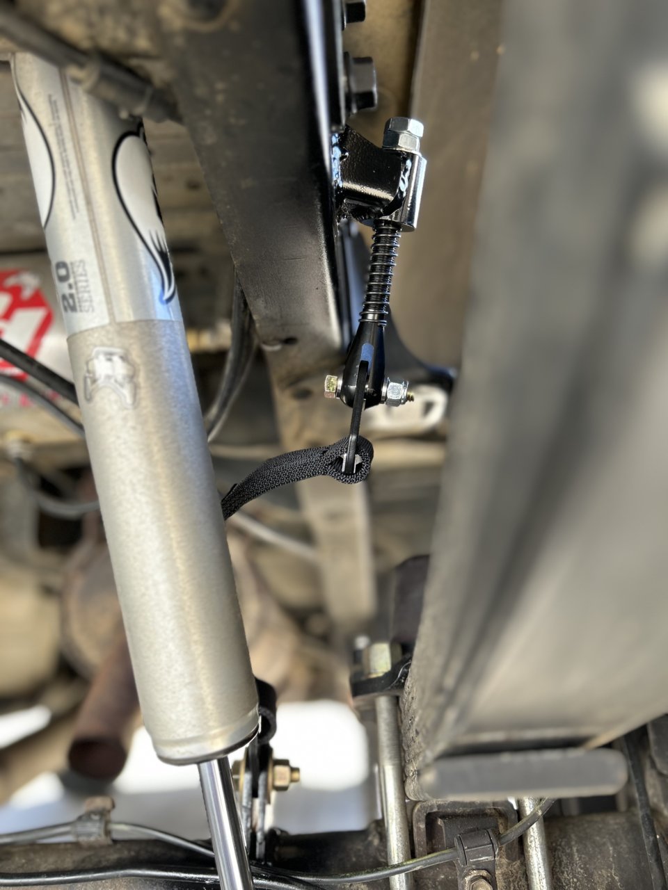

    I should’ve just started with that, but what do I know lol. The rears are like “hey fronts what’s the problem with you”?CDD8E360-C81A-4DB6-91C7-7DCF7F55CF93.jpg3B7ABC6A-97D4-41A4-A2DD-14DC7C41F5E2.jpg9629CF56-771E-4D2A-A9A6-631BEDAEDFE8.jpg3FA009F8-2B7C-408C-9A62-CA1408750852.jpg8E6AC7A2-6DAE-447E-A496-CDA92D178B06.jpg

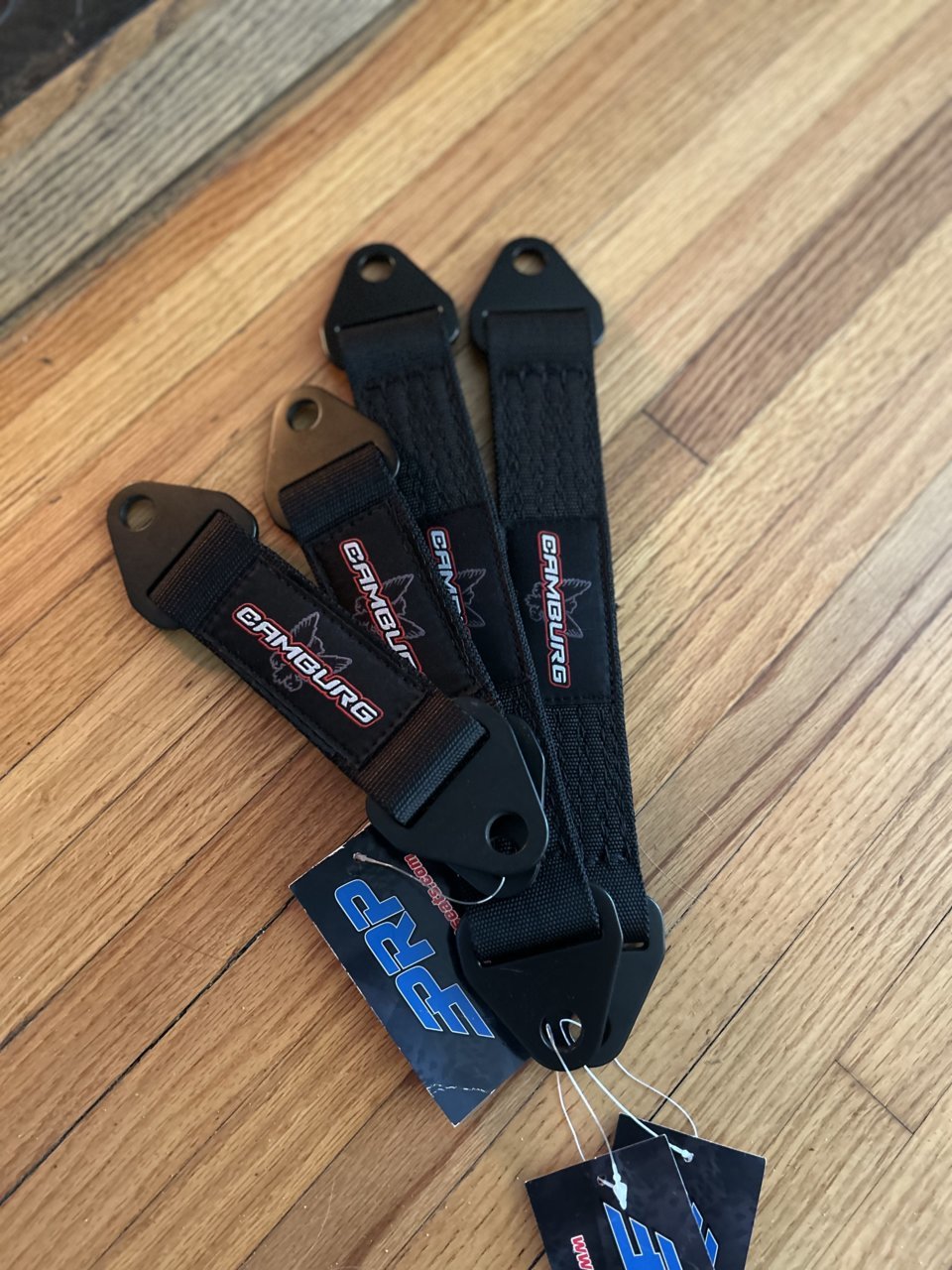

    I'm lazy right now. What are these rated at as far as tensile strength or whatever? Are these custom lengths or just off the shelf things?
    I don't know Jack shit about limit straps or whatever they're called.

    Those particular ones are rated for 10,000 pounds and are heat treated steel I can’t remember the type of steel, maybe 4130 .Yeah they come anywhere from like 6 inches to 40 or 50 inches. You measure your mounts at full extension and then subtract about 10% for stretch. The Camburg ones are made by PRP seats, and they did hardly stretch at all compared to the ones supplied by dirt king.

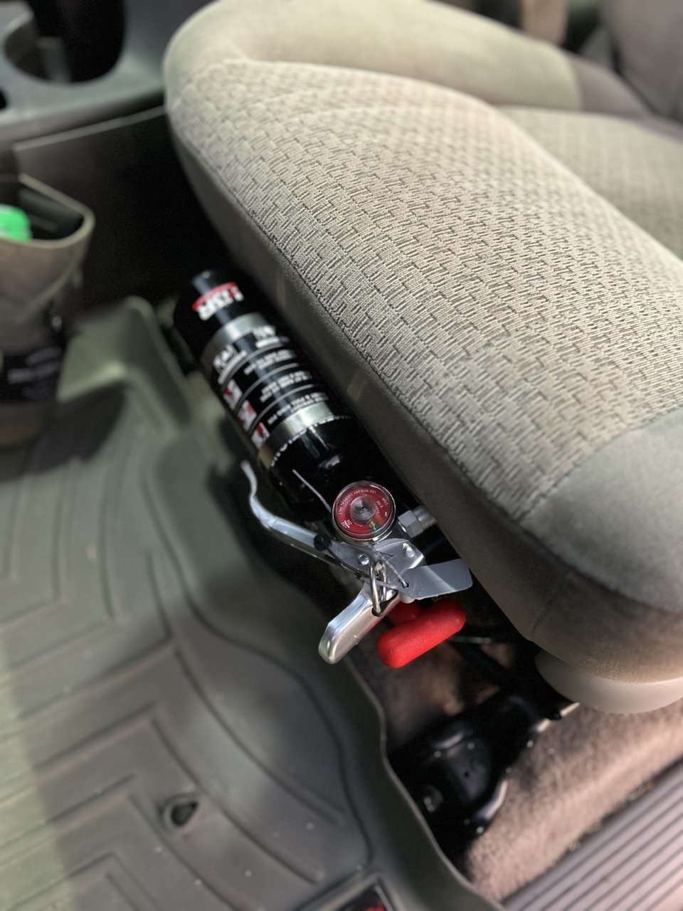

    Temporary mount until I fab a permanent one. The location is good though.

    Careful with your calfs!

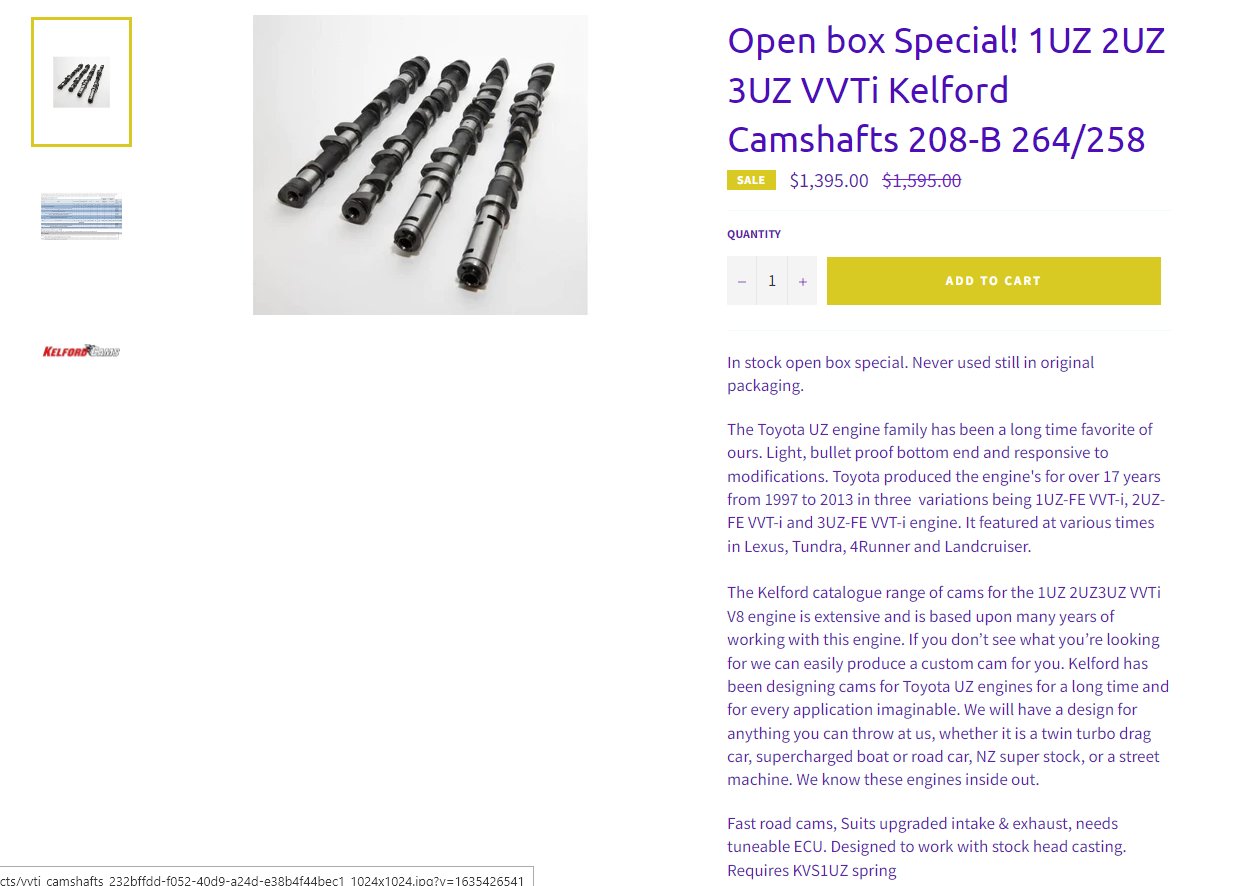

    I uhh made an impulse buy after selling my pop up camper....
    Biggest cams they make that will work without machining the heads.

    I gave it a few in and out tests. I don't even know it's there. But, just in case, maybe I wear shin guards backwards...

    I probably wouldn't have bought them this soon if it wasn't an open box deal. Next year I plan on getting a built short block from XAT and I think these cams would pair super well with it. Still trying to find a machine shop to make me an adapter plate to put m112 rotors in my m90, another one to port the blower, and somebody to thermal coat the rotors. I wanna make some serious power with this thing

    I keep toying with the idea of cams or the harrop TVS blower… but I really don’t need to go making this truck fast.. no matter what I do, my mr2 would run circles around it. And towing wise, it’s pretty damn good. 4.30 gears are likely my next step.. then trying to up the volumetric efficiency while n/a (which likely means cams) this engine has a lot to give with a proper tune and some intake side work based off the numbers it currently produces (VE speaking)
    Honestly it seems cams alone would REALLY wake this motor up if the bottom end could handle more rpm
    oscardog86 and FrenchToasty like this.
  26. Nov 17, 2022 at 9:42 PM
    empty_lord
    Feb 1, 2019
    #25441
    10,148
    Dan
    Indiana, Chicagoland
    05 rollover special
    I think the bottom end would be reliable with cams and springs up to 6k. Anything you set that, I’d worry.. mostly rods
    the 2gr people are pushing 8k rpm with cams and springs… reliably in racing and daily use
    stock is 6500

    Yeah, I’d put it behind the seat myself. You want as much legroom as possible if you ever get into a crash. It would be bad enough to get your legs broken from the dash getting pushed back, you don’t need a fire extinguisher impaling your calf from behind.
