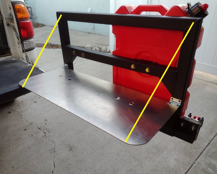

    I love the fold-down shelf element. That's super clever, as long as a drunk friend doesn't start cooking on it while a filled gas can is still attached :rofl:
    Not sure how much weight those hingest would hold, would it maybe be worthwhile to have a temporary tensioner line to help distribute the weight that's on the shelf, maybe a braided line from top to bottom or a folding cabinet hinge like where the yellow lines are, something detachable, maybe something that hooks into an existing hook/hole/provision on the table surface? I only say this because it doesn't look like a piano hinge for the bottom is an option, and it never hurts to distribute load across two/three fail points.

    Oh yea, i dont know if you saw in my first post, but i have braided line with crimps coming in the mail. Definitely gonna be adding that to help with handling more weight. Also that will let me swing the table out away from the tailgate if i want and still be able to handle the weight of beers, a stove or some food!
    Yea, definitely gonna make sure that gas can is removed before I cook anything! Also, might add a back to the table so it helps block wind when im cooking on the table. Thanks for the feedback!

    Totally! Frankly, you may have a viable, sellable add-on product on your hands here if you could get this done as a prototype, then patent and contract someone to build it. My only concern would be longevity of the main, single pivot point after extended use and how to address that. I'm really bad with figuring out fabrication stuff like that, so I usually end up reaching out to a friend of mine who does it for a living if I need input. Fabricators are a special breed, I'm definitely not one...

    Shiiiiit I'd buy it. Maybe... @oscardog86
    is this an add on to your existing bumper or???

    @Tundra2 Yea i just drilled a hole in my bumper and inserted a thick walled sleeve of tubing in the hole and welded it to the bumper. Then I ran a 1 inch thick Grade 8 Bolt through that to make the pivot. I tack welded the bolt in so it doesnt move when tightening the nut but I can cut the weld away if I ever need to remove the bolt.
    Also the sleeve that slips over the bumper, the part that the swing out is connected to has oil filled bushings that fit perfectly over the bolt to take out any play and also keep it swinging smoothly.
    We'll see how it all works out when I have the gas and water can installed and filled up. I went with a 2 gal gas can, and will get a 2 gal water can so shouldnt be too much weight. When its closed and the latch is clamped down it feels pretty strong and when i pull on the swing out the hole truck shakes, so should be good to go!

    I actually go the idea from some offroad company that used a 1 inch Grade 8 bolt and a sleeve inserted into the bumper. Seems the company isnt around anymore and I couldnt find their kits anywhere. Either the idea didnt work or the company is no longer around? I guess we'll find out how well it works but I think it should be fine. They were also marketing it as a tire swing out so mine has less weight than a big oversized tire.

    I think you're on point with adding a back. I bet another sheet of aluminum would be good to block wind and separate gas from back of stove. Especially if you setup a coleman you would have double. But I would still be a little nervous with a gas can that close.

    Yea I think adding a back will work really well. I hate when there is wind blowing on the stove and im trying to cook. I have a nice thin piece of scrap aluminum handy that will be perfect for a wind blocker.
    But I agree, Ill still be nervous cooking with a gas can attached so Ill always be removing that when it comes to cooking. Although the rotopax would work as good wind blockers all by themselves, but rather be safe than sorry.

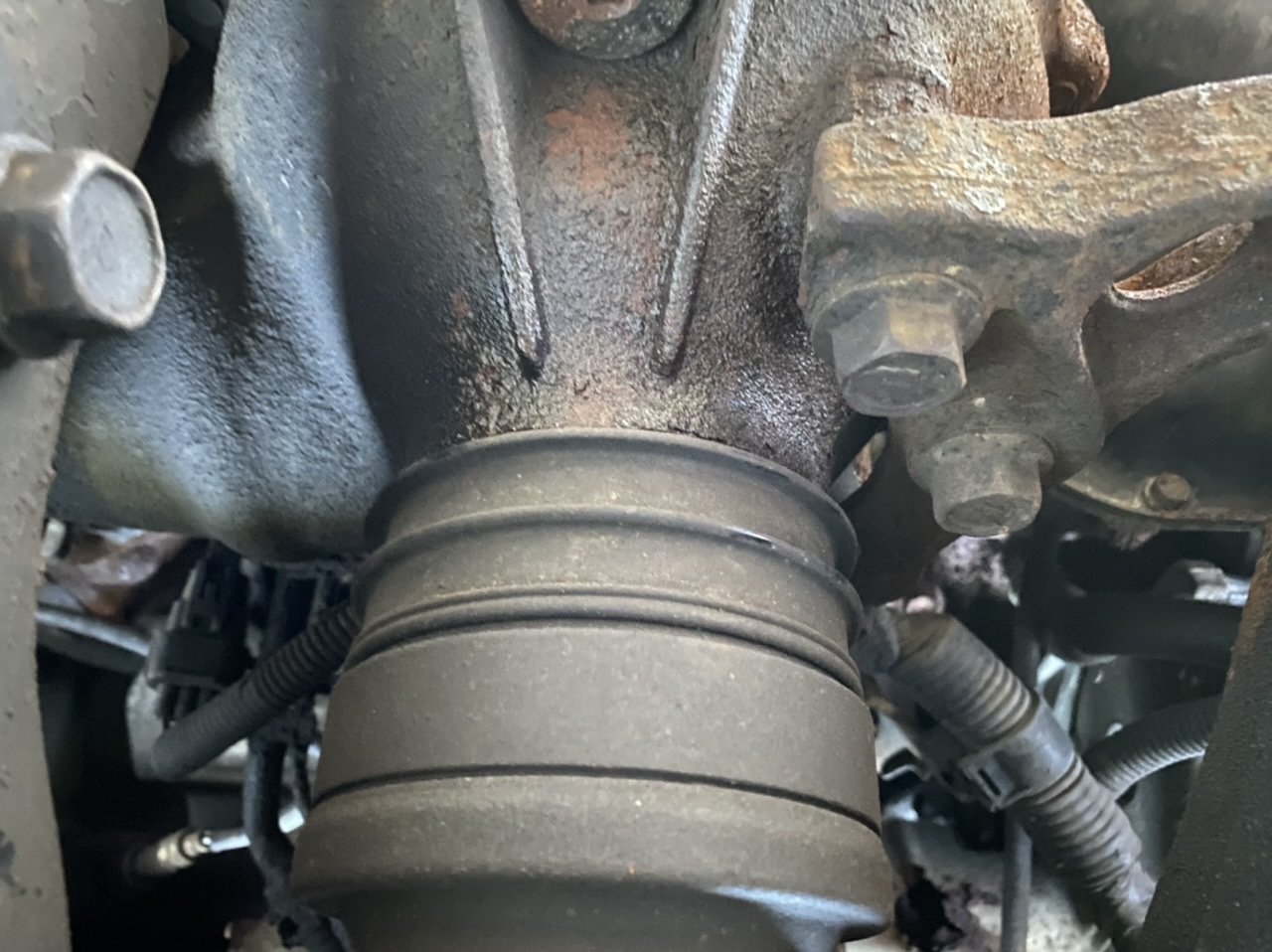

    So…rolled under the truck just now to check to make sure the bushings weren’t torn from the alignment and I see this….
    Now is it just my bad mojo or can a mechanic hit a CV boot to make this happen?
    I’m thinking just my bad luck…FML :(
    Do I need to replace a seal or the whole CV boot?

    Are you talking about how the diff looks wet with fluid or something else? The axle looks fine.

    Yep. Looks like diff fluid; that’s why I’m wondering if it’s a seal that integrated into the boot.
    edit: looking online it seems like a front diff seal that can be replaced? I’ll have to check the FSM and see what sort of labor is involved in ripping it apart.
    https://parts.toyotaofnashua.com/oe...9dHVuZHJhJnk9MjAwMiZ0PXNyNSZlPTQtN2wtdjgtZ2Fz

    If it's leaking diff fluid it would be an issue with that seal you mention, not the axle. We've discussed before how one of the axle seals can be tricky(passenger side) because it can be driven in too far, or too little.
    The actual job isn't that bad. Just pull the axle and tap the new seal in.
    We talked about it in this thread.
    https://www.tundras.com/threads/best-gen-ecgs-bushing-tool.59664/page-2#post-1599375

    Oh, good. It’s my drivers side and not the passengers. :)

    Perfect time to do the ECGS bushing then. The seal on that side is easy.

    Can you actually feel oil, a drip?
    I was thinking maybe it’s just overspray from a penetrant you used while doing all that work recently

    Nah, it’s definitely on the bottom side only. No overspray. Although I have two nice wet spots on the asphalt from the rust penetrant. Time to toss on the kitty litter.

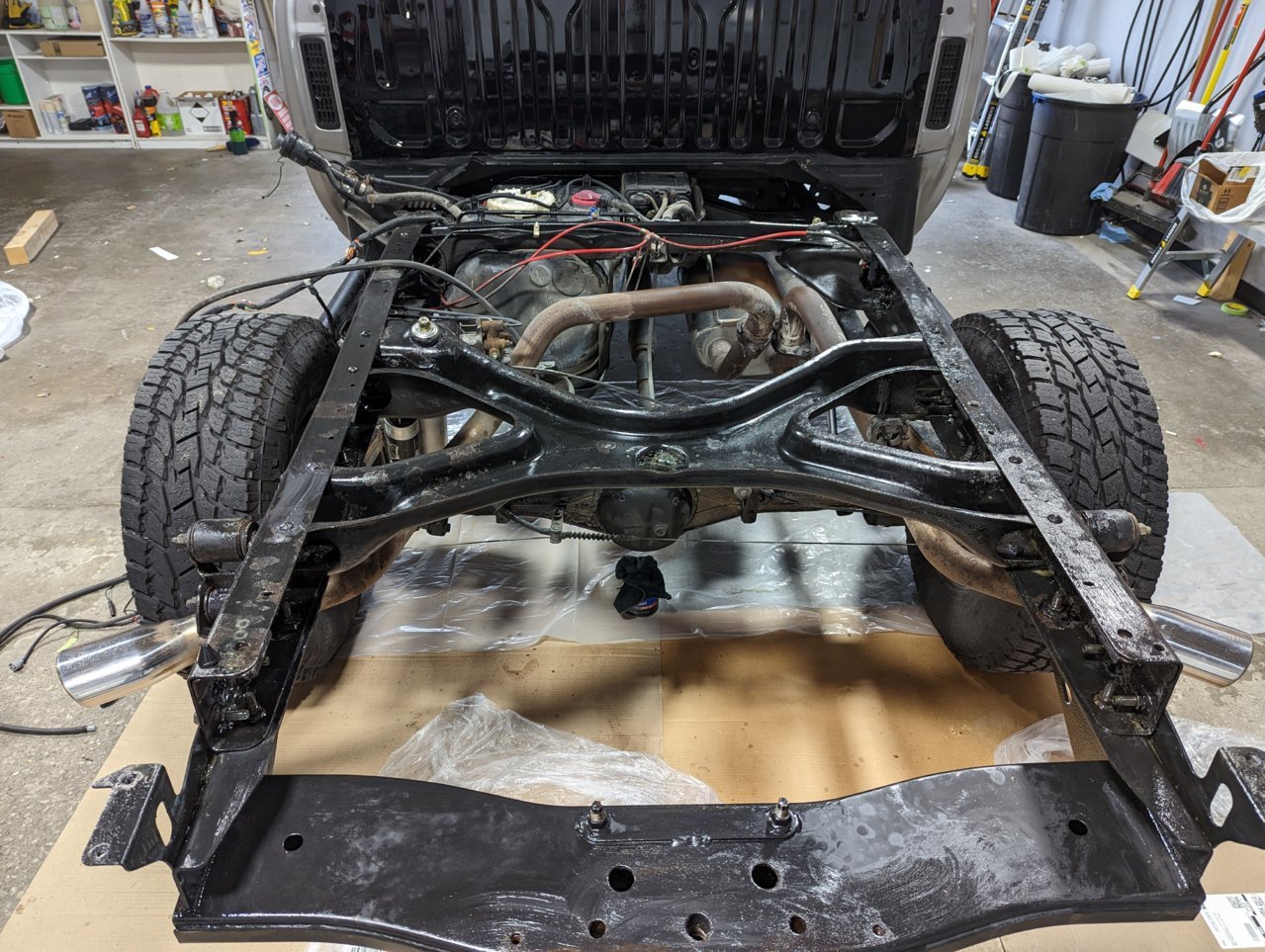

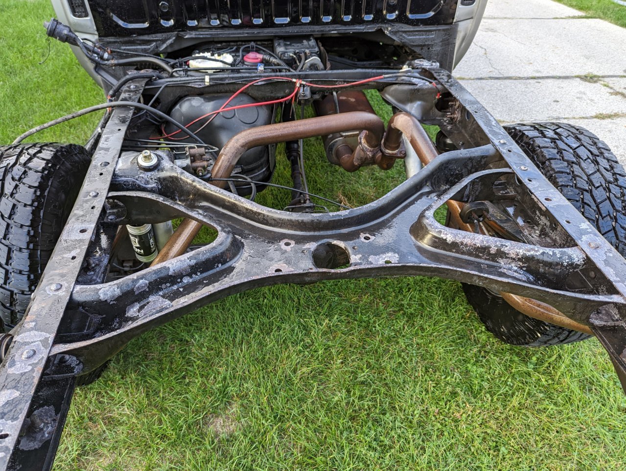

    Fuckin A crowbar!
    Forgot how fast it works, after applying and moving on shit was already starting to turn.
    This shit works faster than Ospho, my guess is it stronger as you need to rinse it off or it'll eat paint. Ospho you can leave on indefinitely.
    After grease...messy but satisfying
