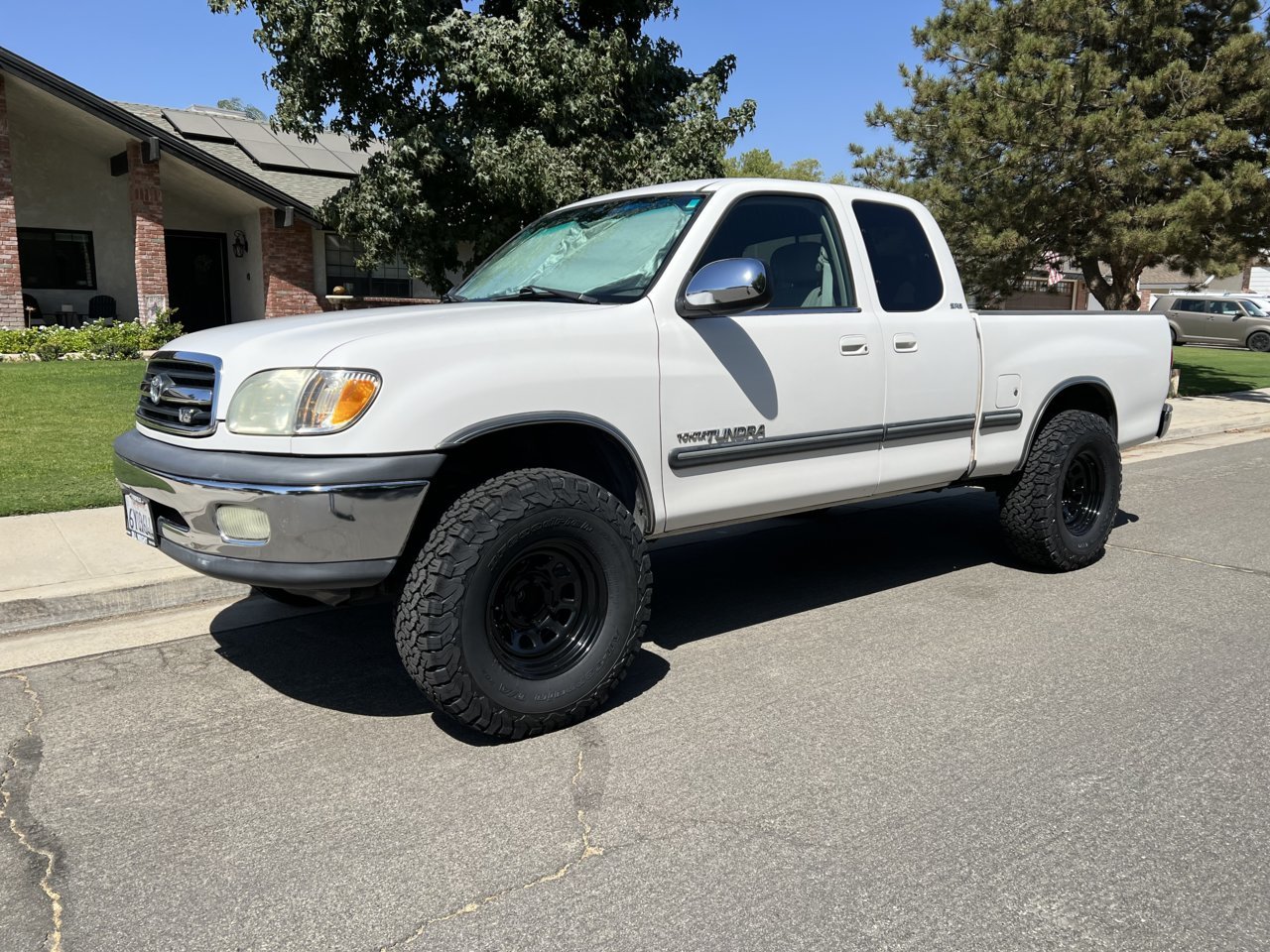

    Threw on some Bilstein 5100's to level out the front and had the new socks & shoes thrown on. Pro Comp 51s 16x8 + BF Goodrich KO2 A/T 285 75r16
    Future plan is to get some new coils and throw in an extra leaf or somethin along those lines to get a bit more lift so that the new 285s aren't so cramped. Thankfully the shop did some decent work on the trimming so i'm not experiencing any rubbing on the road.
    Unfortunately I did not take into account that the calipers would not clear the new wheels, so ended up buying some spacers from the shop I was at. Even MORE unfortunate was the fact that they only had 2" spacers in stock, so the tires are sticking out a lil TOO far for my liking. But just ordered some Spidertrax 1.25" spacers that should hopefully be here soon so that I can swap them out and have a somewhat normal looking truck :annoyed:
    Still got a lot of work to do, including finding some better fender flares since i'm not a fan of the thin chrome ones that are currently on it. Need to get her tinted too, this Bakersfield heat is a bit killer.

    Looks solid. Stock coils on that? 2nd notch on the 5100s?
    I was contemplating, if I went for new shoes, going 16 for more tire meat.

    Thanks mang. Yeah still stock coils for now. It's actually on the top notch, which thankfully is doable since i have the 4x2 access cab.
    I've always been a fan of more tire meat personally, i'm sure you wouldn't regret it. 16s with 285s has always been my go-to combo.
