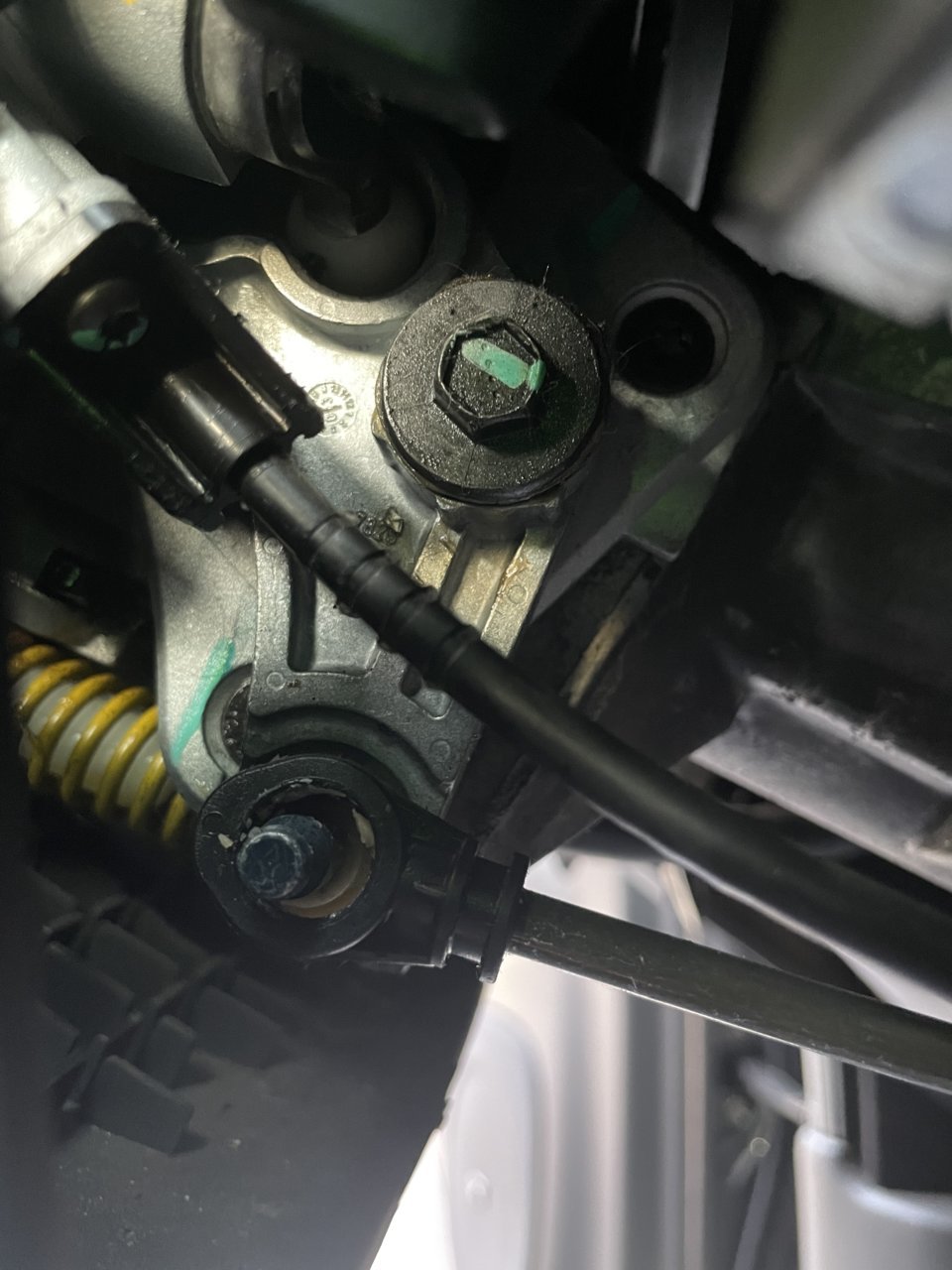

    So short back story. I’ve noticed slop in my shift lever and thought about doing the bushing replacement where the cable attaches to the lever. I read where some guys thought the lever play wasn’t from that so I put it on the back burner.
    Well tonight I go to play hockey and as I’m shifting once it hits neutral the lever goes limp and won’t shift. Lever moves up and down but no shifting taking place. I’m stuck in neutral. I feared the cable broke but disassembly shows the bushing completely gone. I ziptied the end to hold the cable in place till bushing arrives.

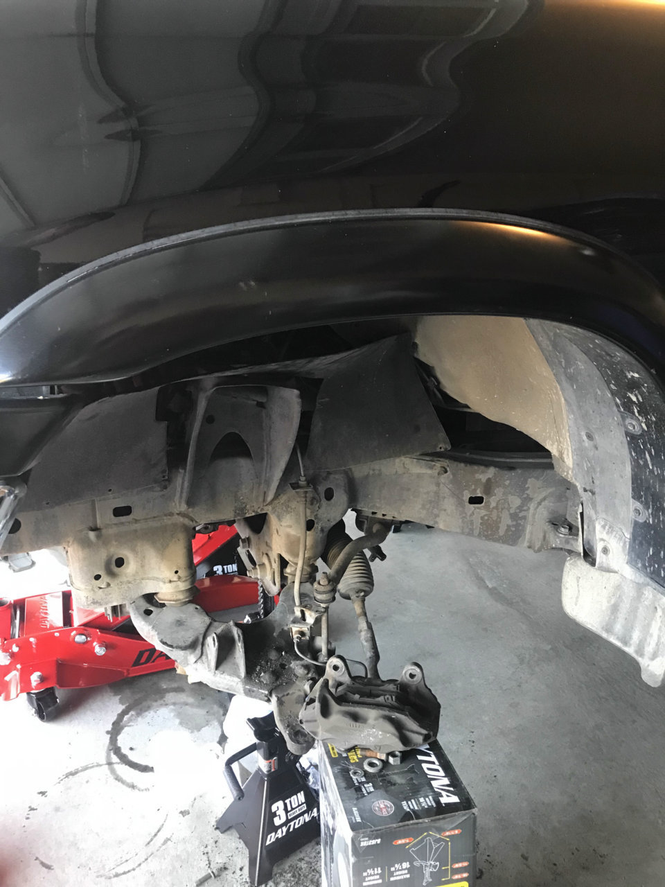

    Front end delete complete. Hoping this will improve highway ride quality.
