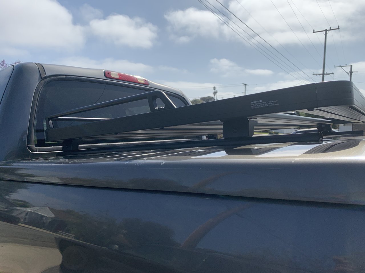

    Any risk of that going through the back window?

    Not really. I did set the uprights so that I can move the whole thing back something like 8 inches though. A failed strap job of gear would be a problem...

    I guess in a high speed crash there would be a problem as well. I'll have to think on that one.

    I was explaining the safety concern to my wife you brought up, she is not impressed with me. I don't know why I didn't see that. Anyway, she wants to know what truck gang thinks. It seems pretty clear to me (now, fak) that over bed needs the load shifted up, so in a crash it hits the cab and not the windshield, or flies into space. My glaring mistake is using 2" legs over the bed. Those 2" legs are for over a trailer, a cap/shell or roof. The Front Runner over bed legs are 6.5" from what I see on their site, but I'm going to call them anyway. There are also those full height setups, but I didn't go that direction.
    How on that?

    i dont think height is the problem, lower is better, might be the camera angle, but how tall could something be before it hits the cab/window when the tonneau is opened?

    No, we are talking about driving 60 MPH into the car in front of you and your spare tire taking heads off.

    Oh. I missed where you said you were gonna put a spare up there. A hard stop from 60 might carry the rack through with it.

    But I like everything else about low...aesthetics, parking structure clearance, aerodynamics. But this back window thing is a problem...

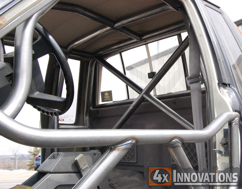

    Solid excuse for a roll cage. Because racecar.

    Tether the rack, or the rack and spare, to the bed using steel cable. You can anchor the bed-end of the cable wherever is convenient and sufficiently strong. Your cable length is determined by the position of the rack-end when the tonneau is 'open'. Think of it like steel cable limiting straps. Will it break the window in a head-on collision? Probably. But it'll keep the rack, and the rack's contents, out of the cab in a crash.
    I picture two smallish cables at the cab-end of the rack and two more further back to spread the load and add redundancy.

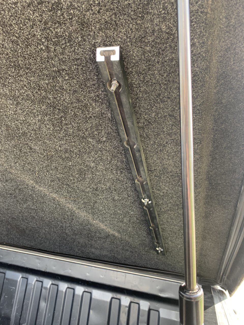

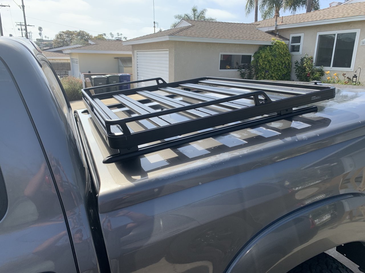

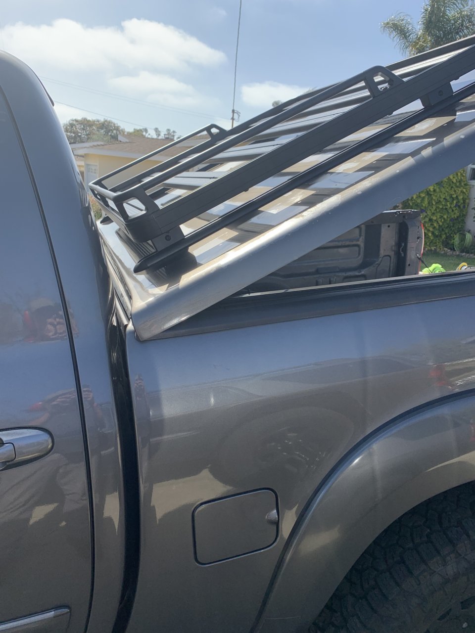

    Thinking about this over night, the two mistakes I made were too low and too narrow. Truck specific designs just build that in, I on the other hand, just farmed it.
    The height should be easy, just get taller legs. I can't make the rack wider, but I can get two load bars and stack the rack on them. Make the front load bar 6" wider and through bolt it to the rack with grade hardware. That's my stop bar in a crash. Mount my two baby 6" light bars on the ends as scene lights and pretend I planned it that way.
    Rear load bar at current rack width, also grade bolted

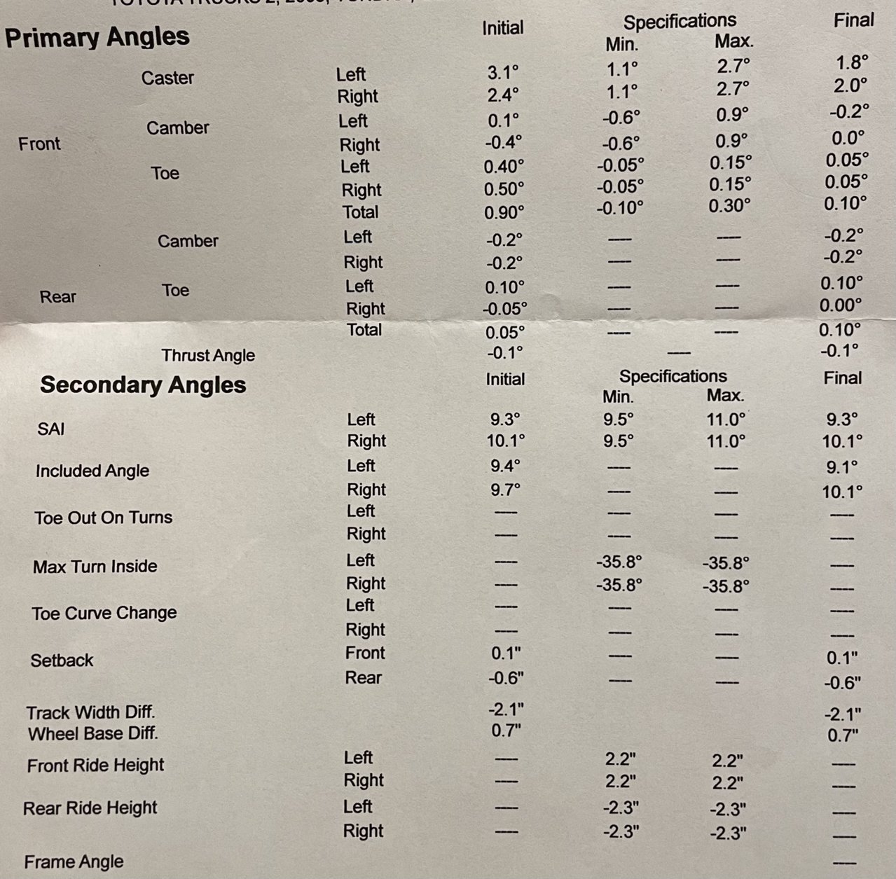

    Taking my truck in for a wheel rebalance and alignment adjustment. I know I’m looking for more caster…is 3 the sweet spot I need to ask for? Here’s my old alignment print.

    2.5 - 3 depending on who you ask.
    Toe should be .08 - .12
