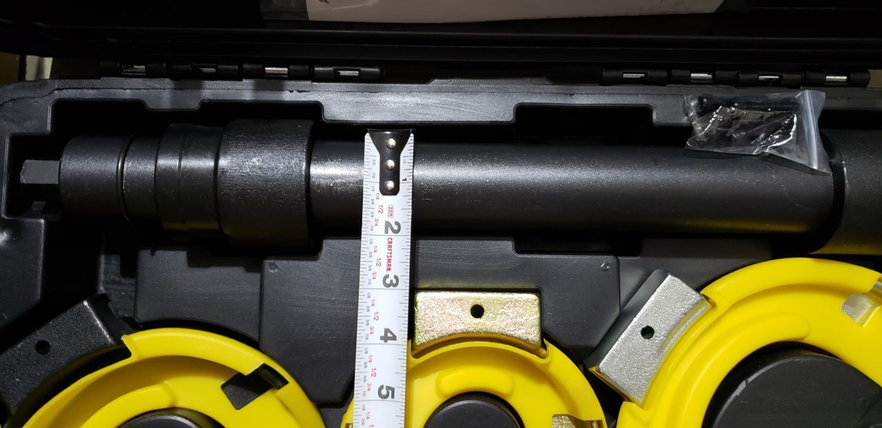

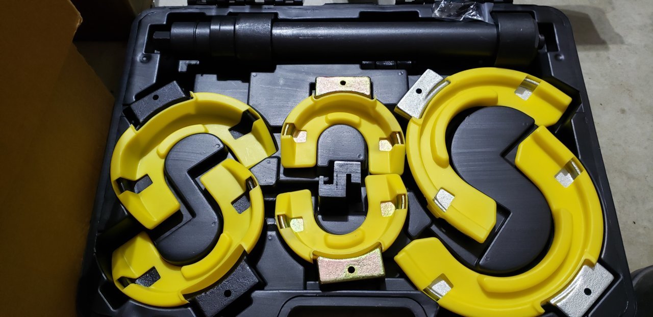

    This was dropped off on my porch today. Weighs a ton.
    Beefy as hell!

    Oh man. Compress something!

    Believe me I can't wait. I'm gonna see if I can find the spare 2 hours or so to swap the lower mounts on my fox's this weekend. I think if I measure threads, then measure height difference on the mounts, I should be able to reset them to the same height. I'll get aligned later, I don't drive it often.
    It will be nice to know my brake lines are in the clear again.

    I found out I wasted money on my spring compressor only after my father saw me using it so he told me I could have used his heavy duty ones he bought in the 70s.
    Like where were you when I was talking about it for the last month? :facepalm:

    I'm looking at this and thinking where are the Brembo rotors/calipers/pads to complement the upgrade?

    When I look at that I wonder the same thing. I did fade my brakes once and it was not awesome.

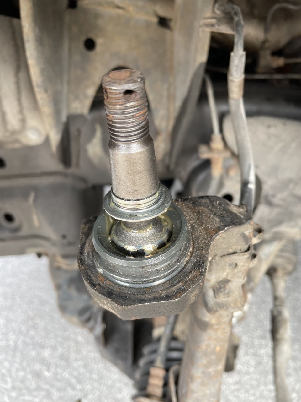

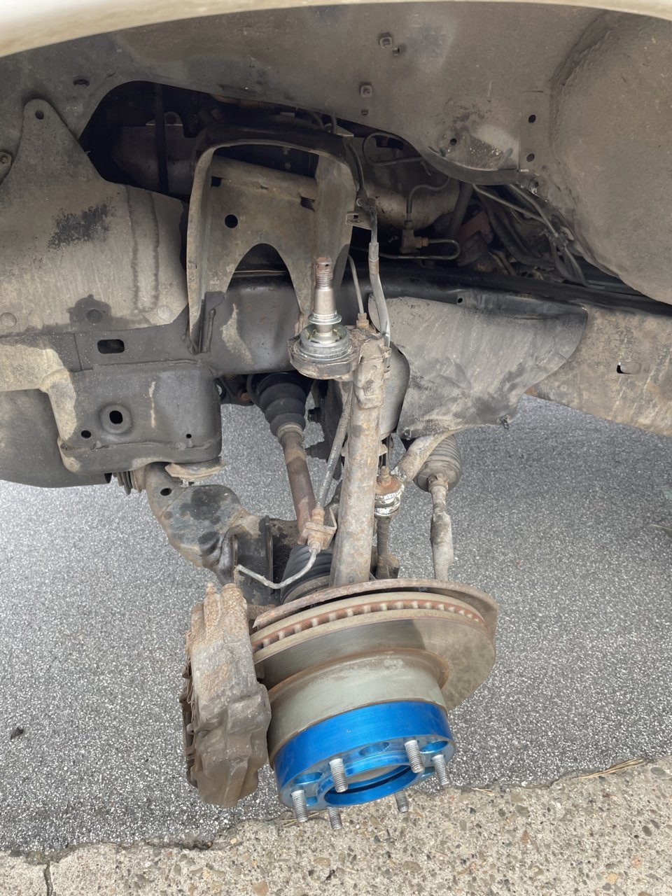

    Decided to get a little head start on the front suspension today on my lunch break.
    But saved this guy for tomorrow…hoping it doesn’t cause me too much trouble

    That guy sucks. I took it out with determination, not finesse.

    I have heard and read about it, i want to drink some beers and relax tonight rather then get pissed off lol

    Yep, super stout but using mine made me feel a lot more confident that I wasn’t going to die like the crappy small rental one did.

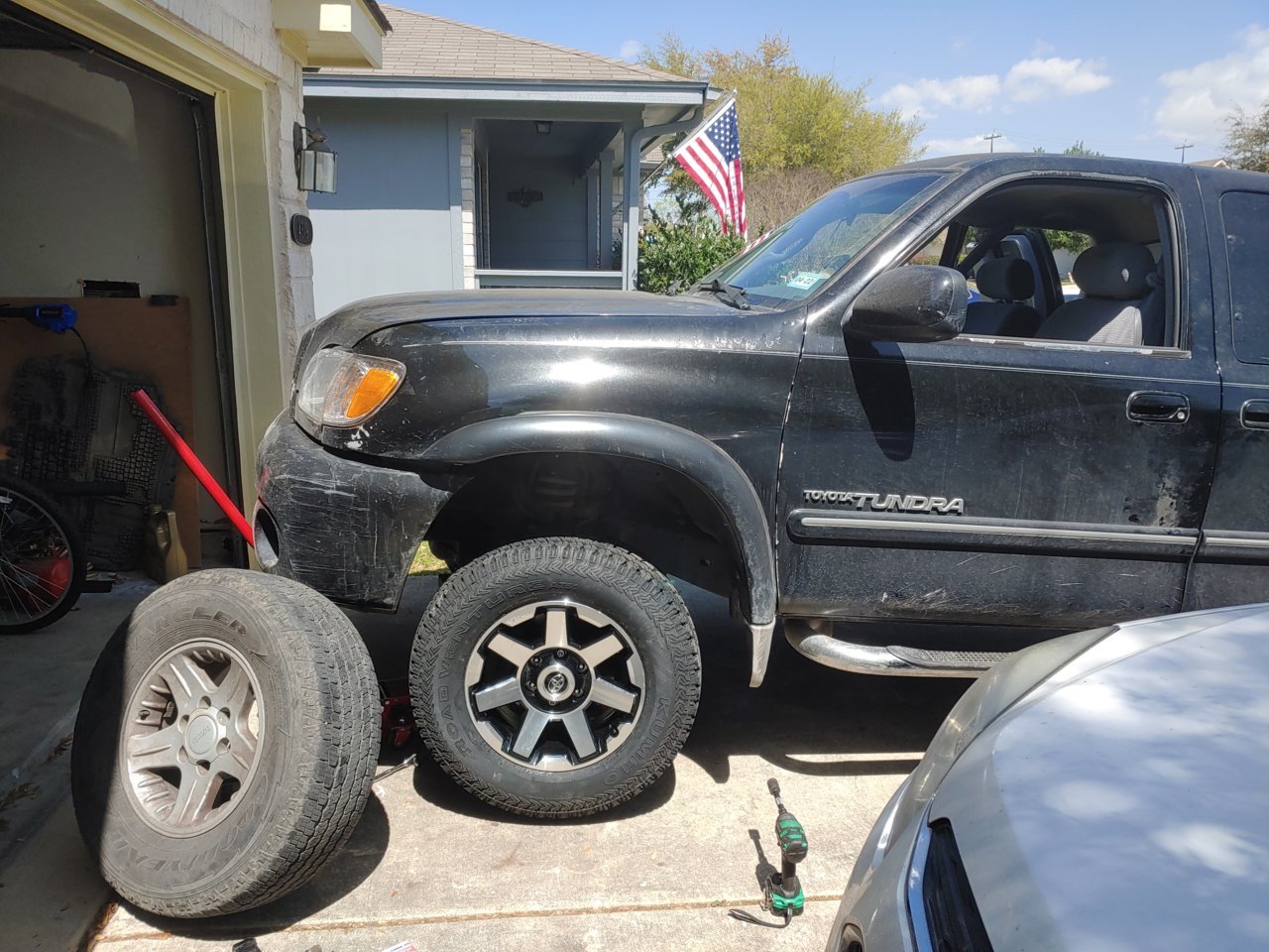

    Got some new old stock FJ wheels and fresh tires. Sadly all the new lug studs I did, all 24, are going to have to come out and I'm going to need extended lug studs. But it'll look good after I redo everythung I just did...0402221230.jpg

    Those aren’t FJ wheels, they are 4runner trail wheels, and whatever studs you put on previously must have been incorrect.
    That sucks to do all the work and have to redo it

    Can you just run extended lugs instead, sounds much easier than redoing the studs

    Thank you for repeating exactly what I said. Also thank you for reminding me that I get to redo everything I just did. Always nice to have some salt in them fresh ones ya know....
    For those who care and or want to know the solution to this error.... I put factory Tundra legnth doorman studs on M12x 1.5x 2 inches which work just fine with the factory wheels that came with the truck hmthat has a -06 ET, however the -15 ET kinda sorta was an oversight on my end. The studs I should have bought at M12x 1.5x 2.75 or 3 inchs

    And seeing as the Vexhile these came off of, from a dealership, was an FJ, listed by the OEM liquidator as FJ wheel, dismounted from and FJ...... I'd say they were FJ wheels. However yes they could have been off a 4runner as they shared the same lug pattern, and now they're Tundra wheels.

    Those rims, NEVER came from the factories on a FJ
