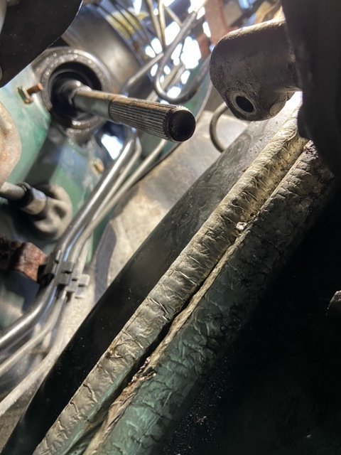

    Here's another picture of it from below.
    it must be telescopic, I'll take it off and see what the deal is. I am worried about others who have done this job and not know of this problem and maybe bolted the shaft on with not enough clearance over bolt holding the shaft on.

    Ok I took it off it's telescopic, bolted up the joint and banged it out again.
    beware all who have done this job, the shaft could of changed in length and left you with not enough room to make a stable connection on the steering flexjoint.

    I'm still baffled. The only issue I had was lining mine back up. Being off even one spline will f*ck up your steering wheel and drive you nuts. I'm studying your pics trying to remember what I did.

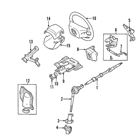

    So look at this diagram, part #2 is telescopic, meaning its actually two shafts that slide in one another.
    If you hammer on the end of that shaft it will shorten it.
    so the way around this, when reassembling is to bolt part # 3 first, then tap it down onto joint until it seats against the steering rack and then tighten part # 4.
