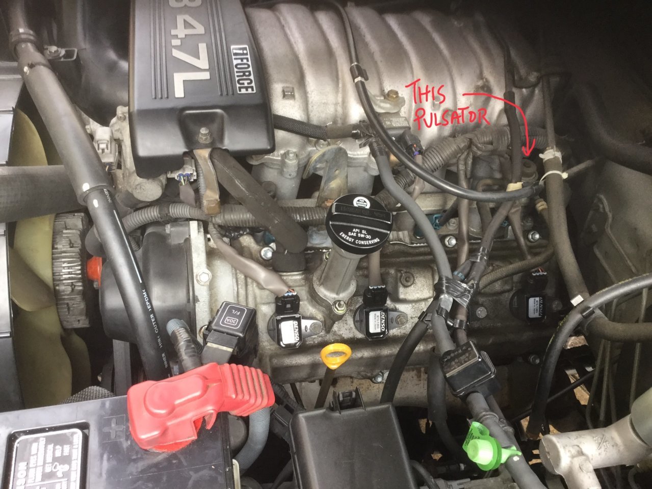

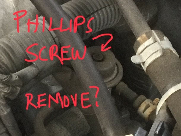

    Sun came back out and shined on me while tackling the fuel injector that was ‘stuck’. Was able to disconnect it doing finger yoga with some el cheapo pliers. Have piece of mind now. Will tackle the pulsator thingy next.
    @bmf4069
    Does your pulsator look like this? To remove you unscrew the top screw and it releases the entire assembly? Or, is there another nut under that cap? The exploded Toy diagrams are not detailed enough.
    Anyone else familiar?

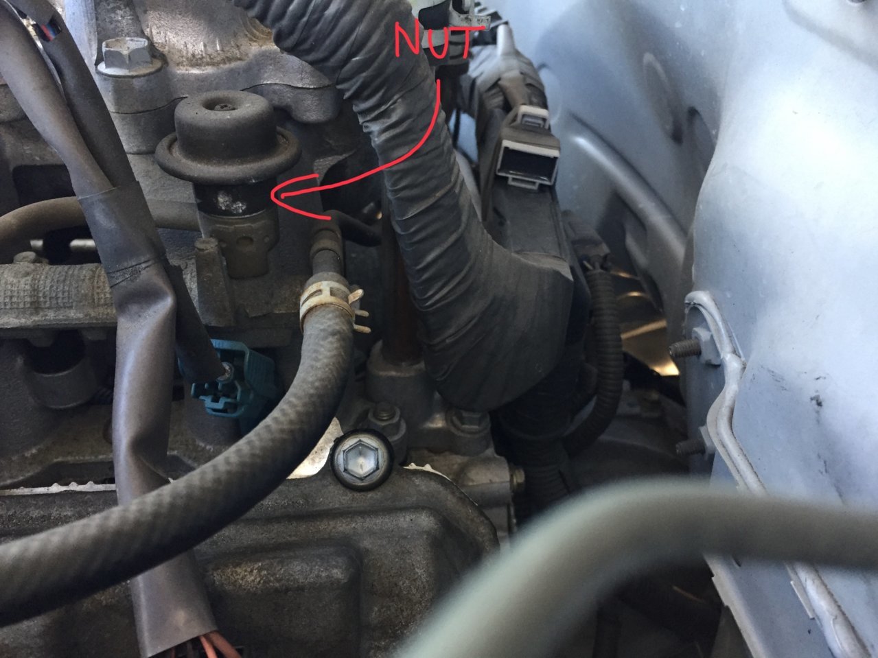

    Figured out there is a nut under the pulsator. Looks to be 22mm. Tight getting leverage without removing all the hoses. Trying to minimize removal of so much stuff.

    @Professional Hand Model only loosen the 22mm nut. The fuel line is in between the two washers and the pulsator sits on top. What are you about to do?

    Removing the fuel rails to install some upgraded 12 hole fuel injectors. Does the pulsator completely come off and out of the top of fuel rail?
    Looks like it does and will make the job way simpler. Trying to keep it simple and not have to cut the fuel line feeding the pulsator.

    Yeah, it removes completely. If you're undoing all that, it's only 6 bolts and 4 nuts to pull the whole thing off. Well, and remove the TB and a few misc pieces.

    I believe it can be done even with the throttle body intact. The banjo nuts (removal) on either side of the throttle body might make for a clean removal of the rail without removal of the TB.
    Researching the pulsator, the screw on top is an adjustment calibration screw that controls a diaphram which controls fuel pulse abnormalities. I’ll be leaving that alone for now.
