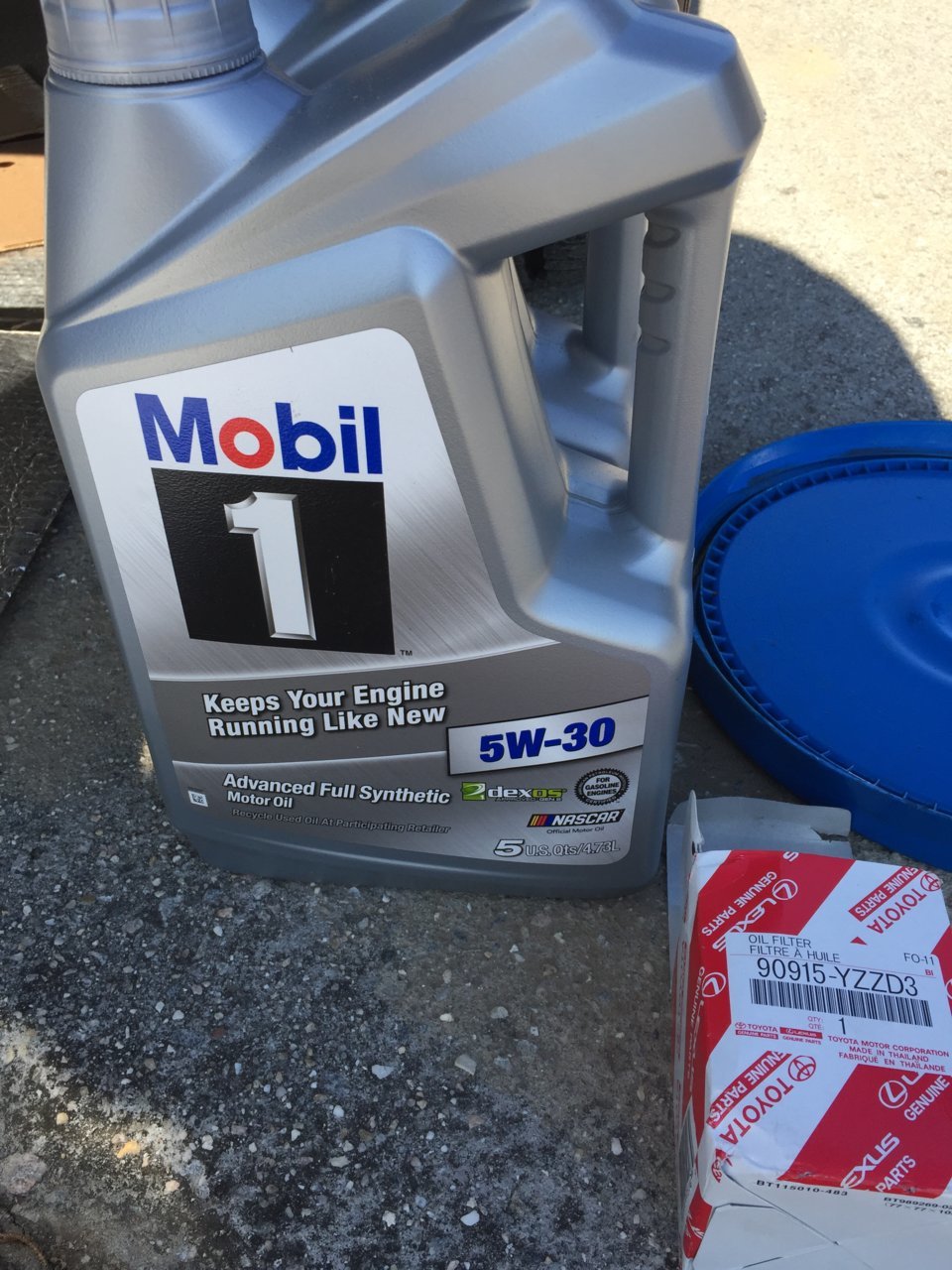

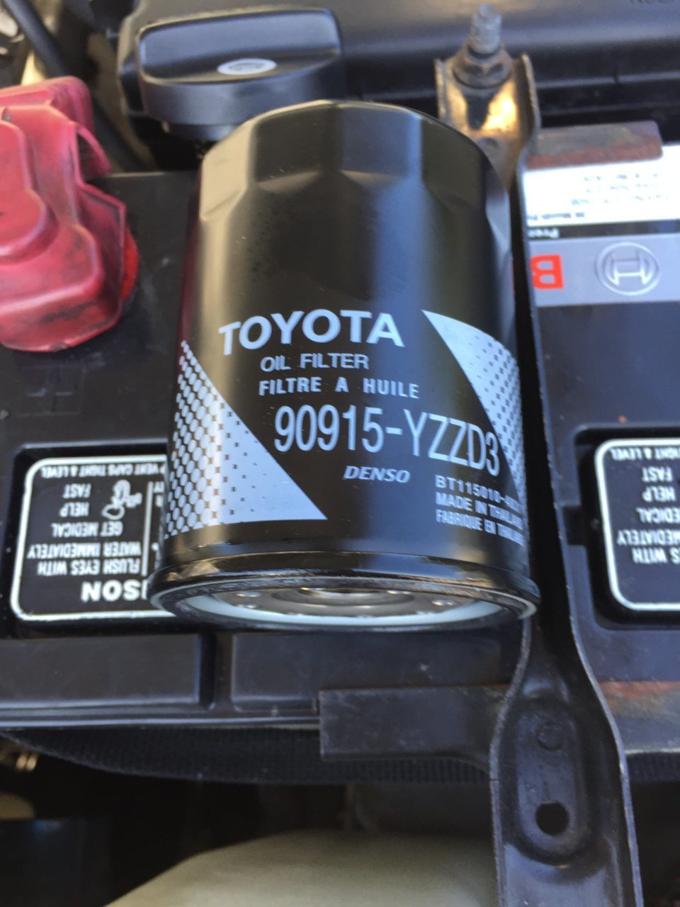

    Changed the Ol’ (oil) today. Round hea we call it Ol’. Getting to finally use my Toy Filters.
    Ol’ had 2,400 miles on it and the reason for changing was this article about switching to full synthetic for the first time. Basically, the synthetic oil cleans the gunk pretty well and clogs the filter with the debris. Mechanic says to change filter at 1,500 miles due to filter clog possibility.
    http://www.agcoauto.com/content/news/p2_articleid/122

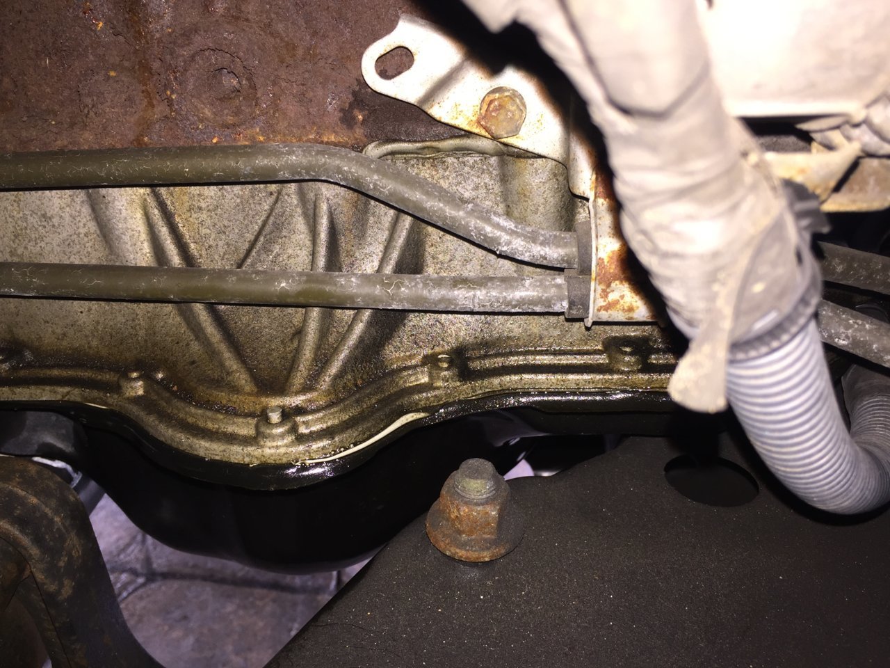

    Did notice some seepage around the oil pan gasket (factory fipg) see lowest pic. Will keep eye on things and may switch back to Syn Blend if becomes problematic on this second syn oil change.
    Driver side top of oil pan view looking down from battery zone area. Yoga performed to take picture.

    Coincidentally, I saw a guy yesterday complain about seepage from this same filter. Maybe it's a problem with the filter not the synthetic???
    I have the same filter on mine since the purge 10 days ago or so. I'll take a look this weekend.

    The removed filter was a Mobil1 and was loose(er) than when installed a few months ago. Guess it loosened a bit? It had some seepage from being loose. Not much.
    The new Toy filter had some seepage just on the drive home today and it was tight on there. Will test more tomorrow after I wiped it clean to be double sure. Tomorrows drive will tell a story about these Toy filters. Thanks for the heads up.
    The actually seepage that has my attention is around the lower oil drain pan seal below the engine. Nothing but a wipe of the rag seep and no drops on driveway in the 3-4 months since the last change.

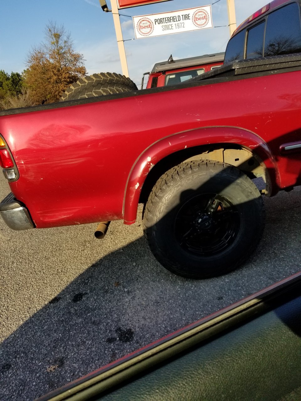

    16in M/T wheels with a 305 70 r16 tire 3in space lift front add a leaf in rear Led headlights upgrade OEM fog light delete replaced with 7in light bars in OEM locations Led interior lights and tag lights and cargo lights also Kenwood double din head unit self powered subwoofer under driver's seat
    Got a set of new tires put on went from a 305 70 16 to a 285 75 16 tires, was cheaper then going with a 305 again

    Better tire size for these trucks I think. Same diameter but .75 inches skinnier.

    right on. I like the AT tread with an MT sidewall myself.

    Yeah i like the 285s much smoother ride, i felt like the 305s where to heavy for the truck it wouldnt take off quick now with the 285s it takes off much quicker

    285/75/r16 is purrfect! You just upgraded by going smaller. Cheaper than a re-gear!

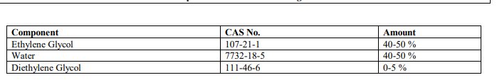

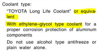

    Been doing research on Toyota coolant today. I just don't believe that the average Valvoline, Meineke, Pep Boys etc stock genuine Toyota coolant. I have to assume there are millions of Toyota vehicles operating fine with other brands of coolant.
    Found the spec sheet for Aisin's coolant. Confirmed it's Ethylene-Glycol just like the manual says we can run. I'm convinced it's the same formula as Toyota's for half the price. Hell, Aisin designed it specifically for Toyota vehicles and they are affiliated(or owned?) by Toyota.
    Both have Ethylene and Diethylene Glycol.

    Key word ‘equivalent’. My mechanics, when they replaced the 02’ radiator, used ‘equivalent’ yellow stuff. They specialize in Toyota/Nissan.
