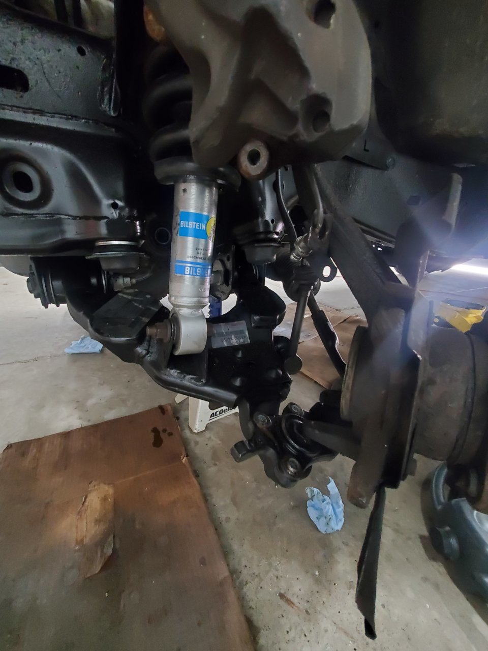

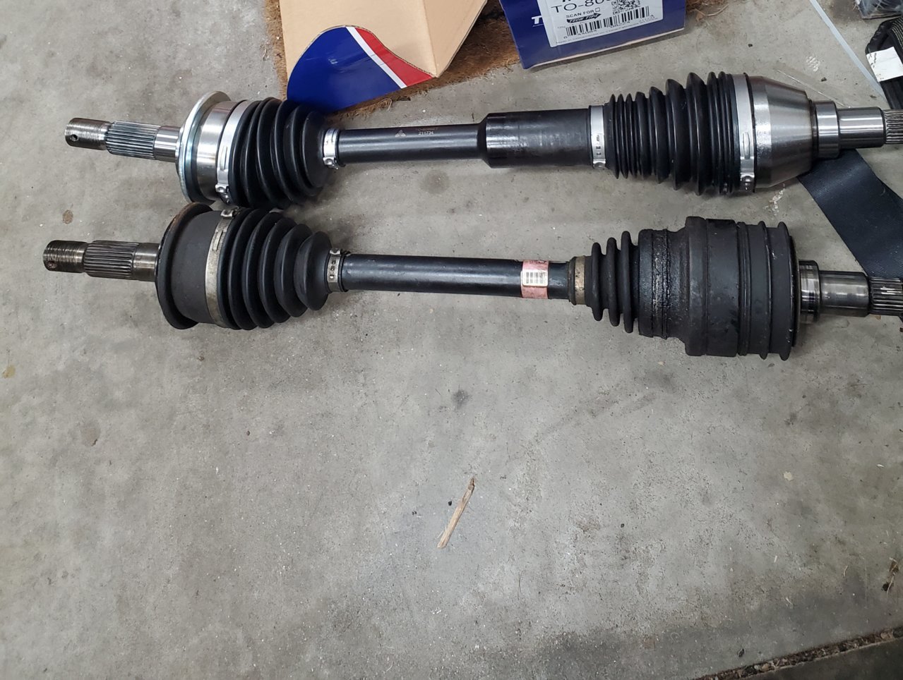

    Installed new axles, axle seals, ECGS bushing, brake pads and rotors over the weekend. Trying to be ready for the upcoming trip.
    Was originally planning to go with NAPA HD axles which are $248 each but was looking around on Rockauto and found Trakmotive axles that look 100 percent identical to the NAPA HD axles down to the pictures posted on the websites but they were $125 a piece. (After getting on RA now they appear to be branded as FVP model TO8088ET). Hanging on to OEM axles in case anything happens to these or maybe want to reboot through CVJ.
    Got a key ordered for the topper and planning to put on mid March or so as long as I get other maint work done since once the topper is on I can't work on the truck in my garage any more.
    Now I need to order the cheap OE style exhaust I found on Amazon and replace what I'm missing so this trip isn't miserable and that'll be about all the major stuff taken care of.

    Let us know how they hold up, those look like a great inexpensive option.

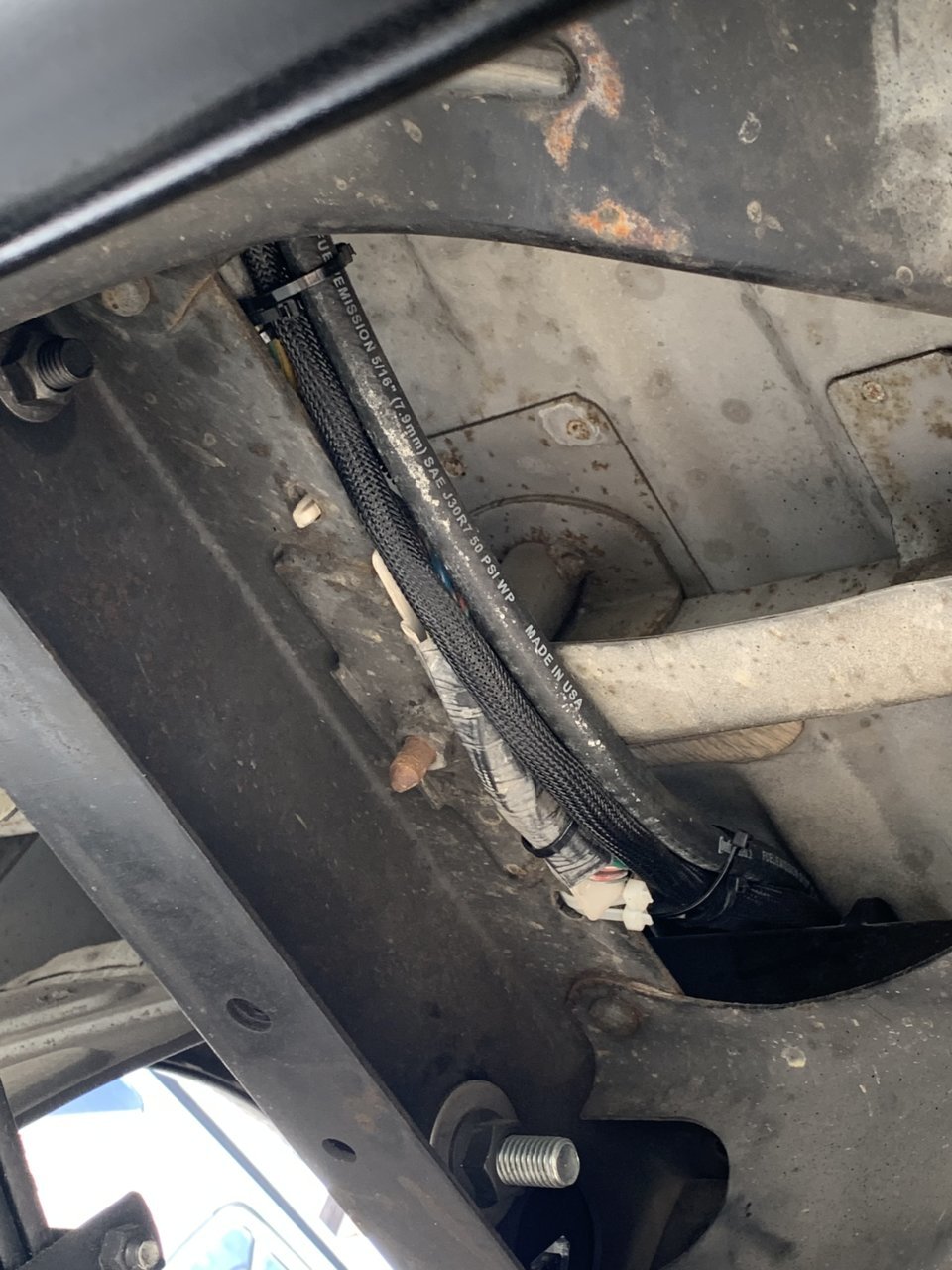

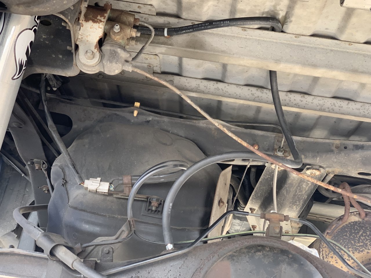

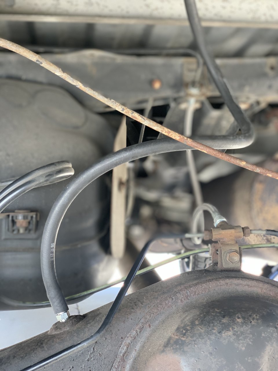

    Put the rear diff back in, had some time to kill so did the breather mod.
    I'm not saying anyone should remove their spare tire from under the truck, because like me - then you have to put it somewhere else.
    But if you do, there is so much room for activities!

    Where did you end up mounting the end of the tube?

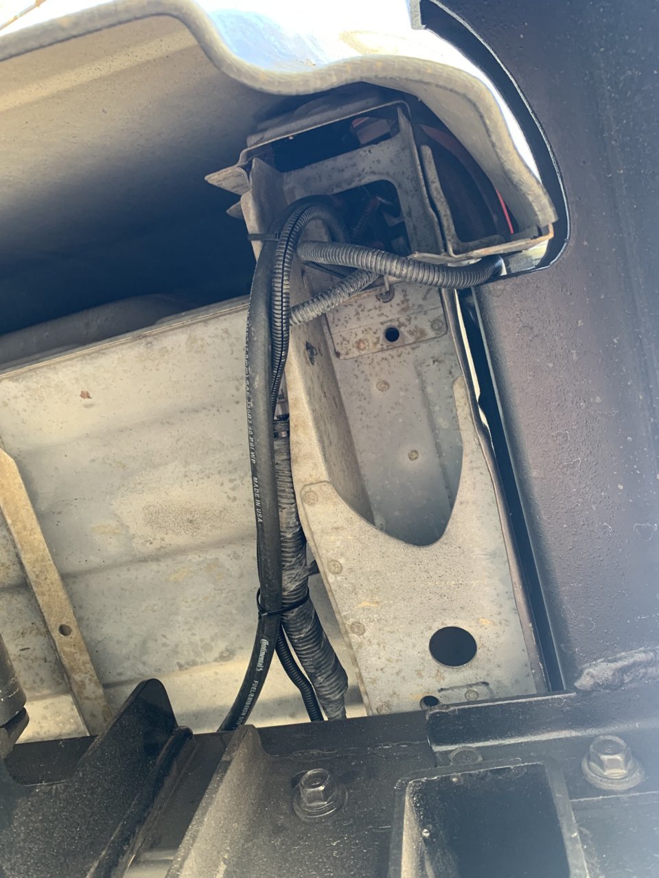

    I ran it up to the bed truss and along it, then back along of the top of the frame into the rear driver brake light area. It's where everyone I've seen puts it, and it makes sense. I didn't get pics of that - but I can

    Running between the bed and the truss, gives me some adjustment. And then just along the truss or support or whatever it is called to frame top and in the tail light area.

    Thanks! Was thinking might as well do this when I install the rear shocks

    It's a great mod, considering how much I spent on the diff, I like it more. I've looked at some posts and occasionally someone buys just enough hose, and finds it to be tight. I bought 25' of fuel line on Amazon (jumps from 10' to 25') so I could slack and route the hose where I wanted and cut at the end.
