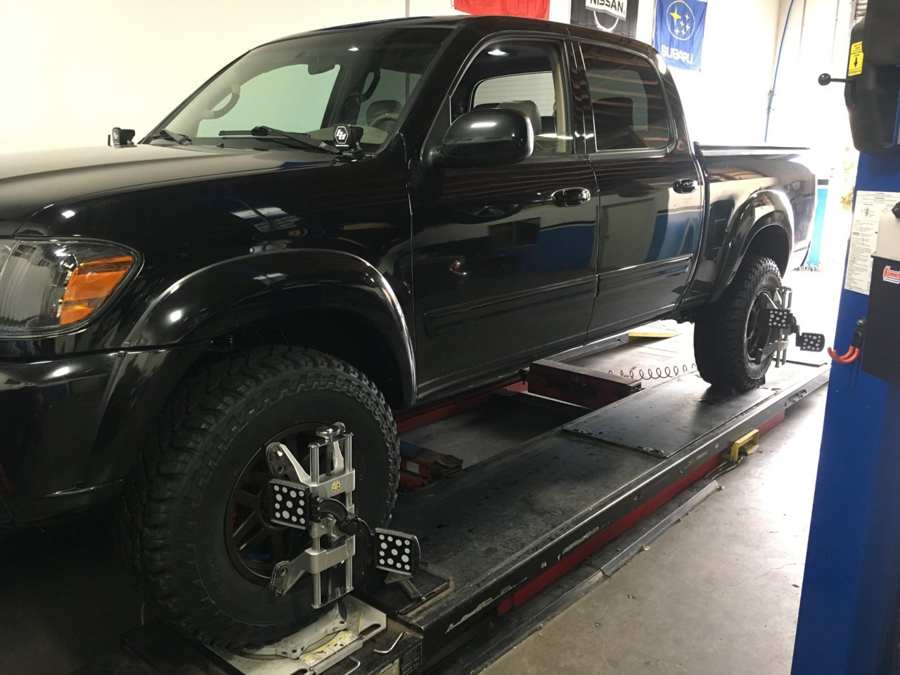

    I’ve only driven it a short distance to and from the alignment shop but it drives great. A tad bit firmer than the old oem’s but there’s no weight on it yet. I’m sure the ride will become softer once the skids and sliders get mounted.
    I was on 265/70(32’s).

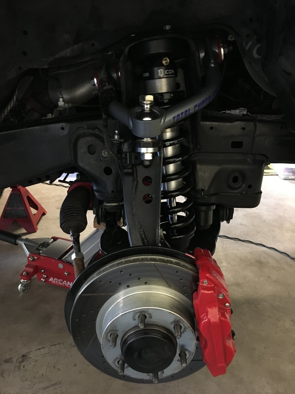

    Icon 2.5 et 700lb coilovers, Icon 2.5 CDCV rear shocks, Total Chaos uca’s, TC spindle gusset, TC steering bushings, oem lca bushings, oem wheel bearings, ORS high angle cv boots, Archive Garage Deaver leaf pack and U-bolt flip kit and superbumps front and rear.
    The lift amount is up there but nothing has settled yet. I’ll take measurements somewhere flat. And then again after a few hundred miles.
    285/75r17(34x11) Cooper ST/Maxx and the spare fits back under the truck perfectly.

    I recognize that shop. How much did Euro motors charge for an alignment?

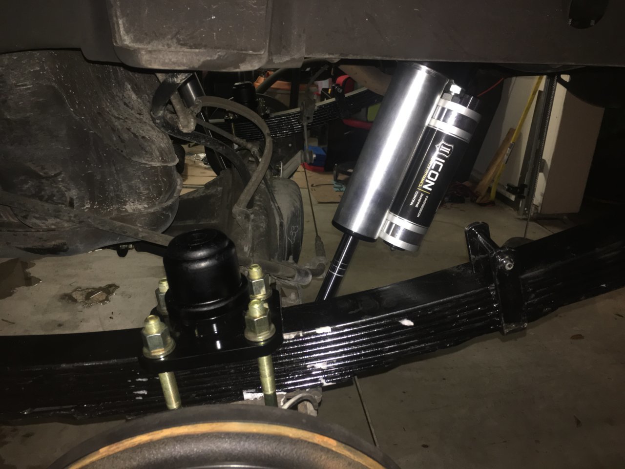

    What is the purpose of flipping the U bolts? What does that help with?

    They charged $114 with $10 off. I didn’t want to drive 65 on 49 for 6 or so miles to Auburn Service Center.
    That prevents dragging the u bolt nuts on rocks and makes more clearance under the axle. Prevents headaches. Plus they provide a spot for the superbumps.

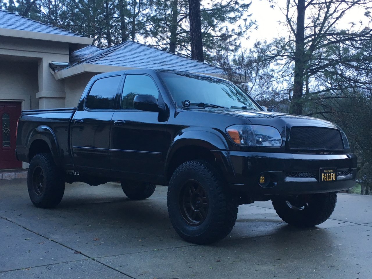

    Whats that measurement from ground to top of tire? Curious about the 285/75 on 16” v 17” wheel. Looks good and bet you are relieved and proud to have it done! Beer money mods are sweet.

    37.25 on drivers front. The tires are 34.1x11.1. I’m very happy it’s almost complete. A few more tweekes here and there but I’m happy with it.

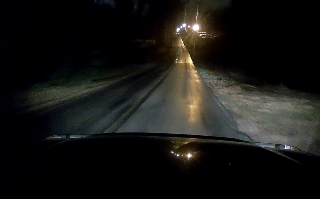

    Finally got around to reviewing some dash cam footage. For a cheap chinese camera the video quality isn't bad, even at night.
