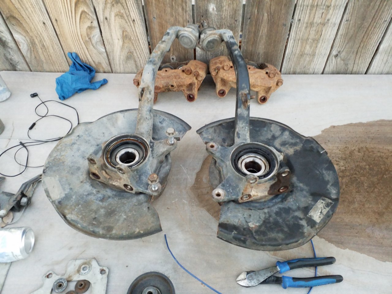

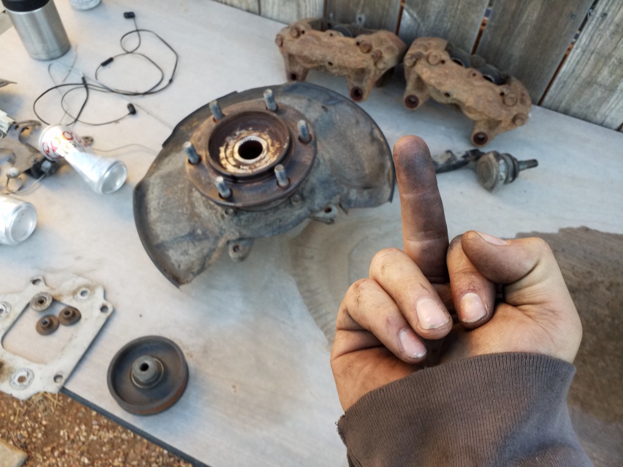

    You can get by for a while. I rode around with bad bearings for a good while.
    It is really a pita. I recalled back in thebTS days a few guys tried with 20 ton press and their press got laughed at.
    In my case I didn't wanna pay anybody the labor to pull the spindles, I only wanted to pay for what I couldn't do. Toyota wouldn't play that and Toyota wouldn't touch my truck(aftermarket upper arms). They did give me the number for the shop they outsource these to but it was too far.
    I found a shop that was willing to do the press work on each spindle for $200. I brought them loose spindles and replacement parts, next day I picked them up. They told me they've done that job lots of times. If you don't have any luck with calling mechanic shops, maybe check a few machine shops. They're probably better suited to this sort of thing if you're bringing in loose parts.

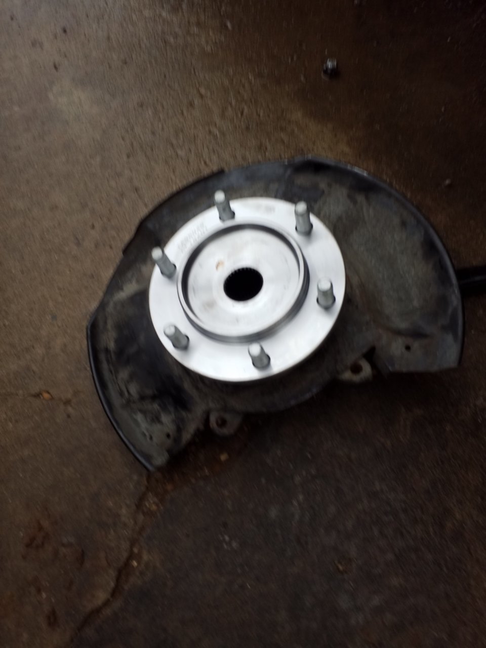

    This is what I did. Shop charged me $250 and didn't seem happy about having to do it. Hardest part was getting my UBJs out and tie rod ends not wanting to loosen so I cut em off. I went ahead and replaced the hubs to cause fuck it. You'll need a 1/2 drive torque wrench for your axle nut.
    I also asked toyota about bringing my rear axles to them to press my bearings and they also said they need the truck there. And $1100. No thanks, I'll do it myself........later.
