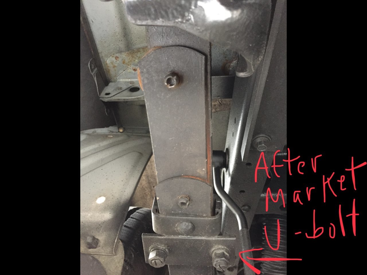

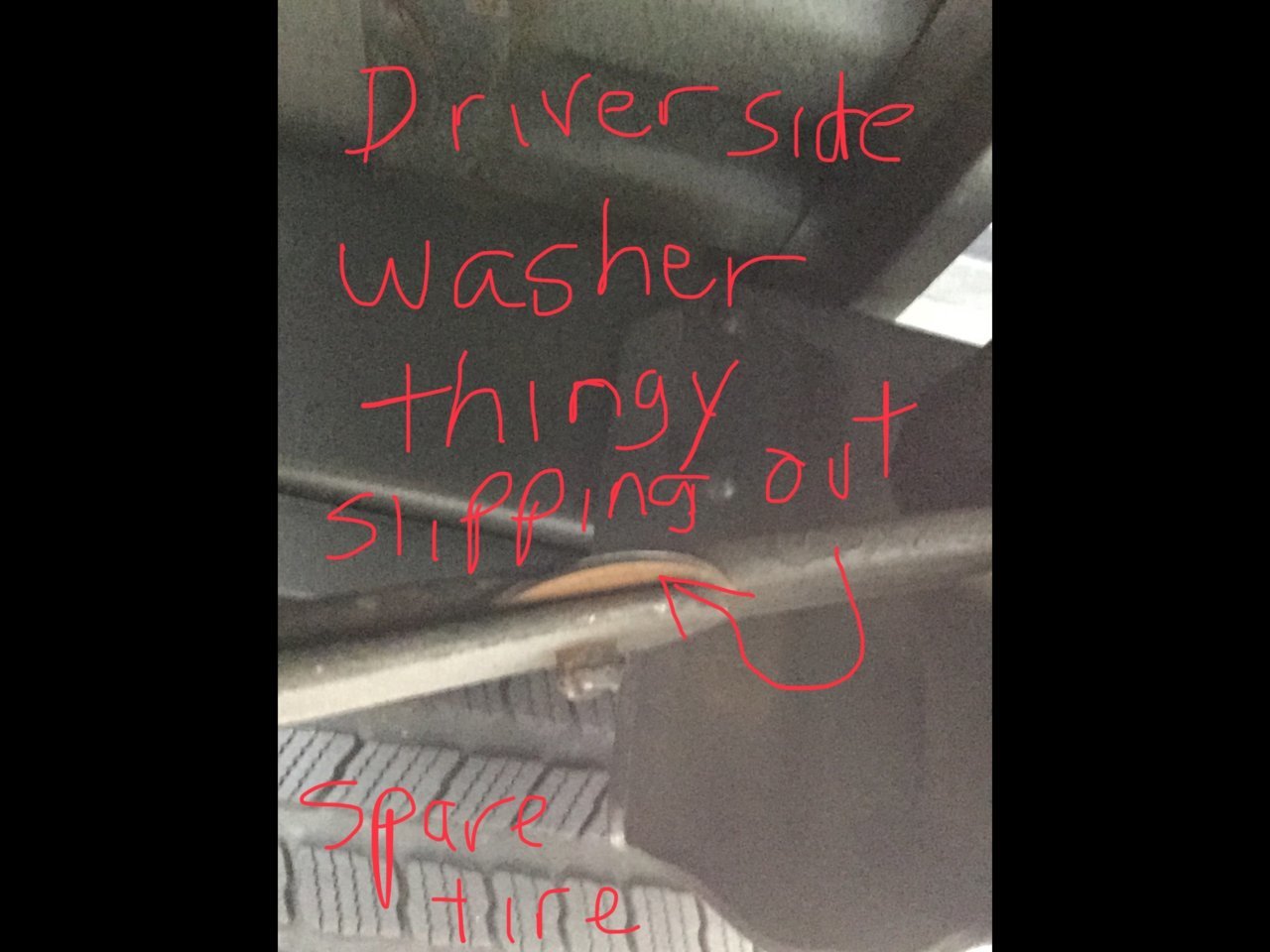

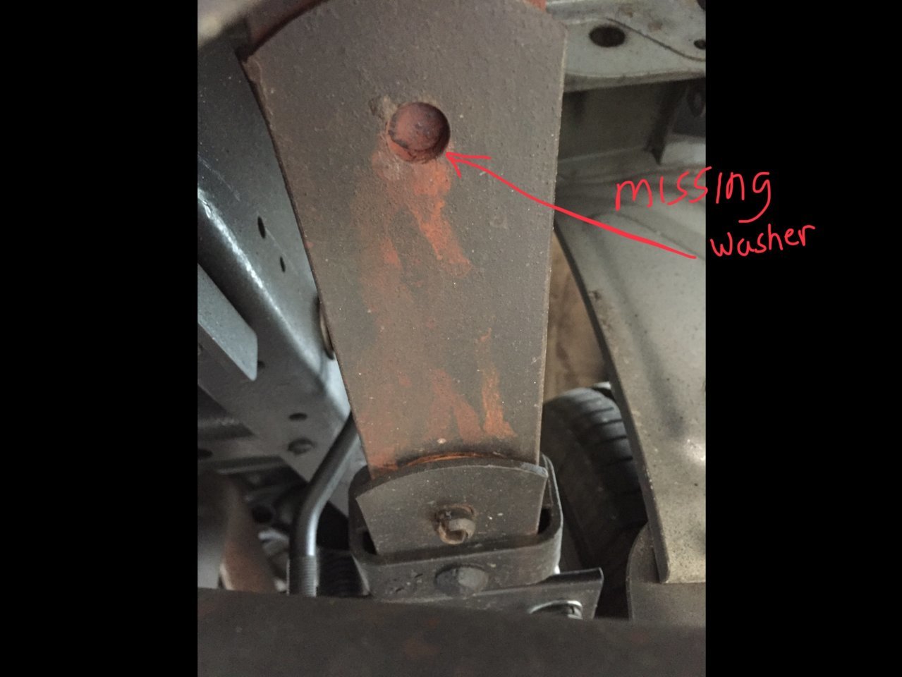

    Need advice.
    For a few years, I’ve had a clunk (goes ‘clunk clunk’ real fast) when turning slowly either direction as in neighborhood 90° turns (usually right but also happens going left). Sound eminating from rear corners. Confirmed by me riding in back bed and someone else driving recreating turn. For sure the noise sounds right under the spare tire area. Its not the spare as that has been eliminated as not the noise.
    Doesn’t happen everytime/all the time (usually happens not always). More pronounced when turning 90° into a shopping parking lot apron going up or down slight inclines.
    Thinking its my rear springs washers thingys. Here are pics of both sides rear springs rear portions and one of the washer thingys is missing. The other slipping out the side. See pics.
    ‘Clunk clunk’ is getting more pronounced sounding. Noise pre-dates any recent suspension work by 2-3 years. Just getting more pronounced. Washers wearing out? Need new springs? Thoughts?
    Drivers side (dis-regard recently added u-bolts as I added those to prevent splaying which has happened over the past few years).
    Passenger rear.

    Could it be a wheel bearing? Or. Do you have a rear sway bar? It could be one of the joints on the sway bar end links. If you have one.

    I do have a rear sway recently installed late 2018. Sound pre-dates sway install.
    Wheel bearing(s) is a possibility. Never had a vehicle with one go bad so have no reference sound to go by. Will be having those looked at by mechanic soon.

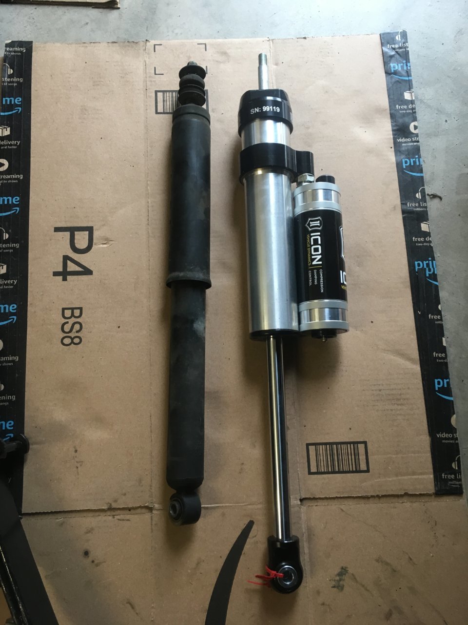

    @Casper421 which rear shocks are those peaking out at us? Icon?

    Icon 2.5:
    DAD40A8B-4096-4947-990C-2DD4860ADBCD.jpg 50A2CF50-26A6-413C-A82A-68FDF60A3CF0.jpg

    The eye bushings on each end of the leafs look worn, especially the rear eyes. Grabbed the springs end and tried to forcibly move them but no go due to the weight of truck. Maybe this could be a potential bad area on the springs too.
    Found some new OEM springs for $500/pair. I’ll be calling the 4wheel place soon. Thanks for your input.
