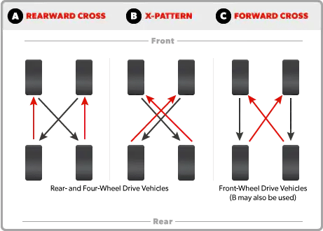

    rears forward, cross the fronts to the back on rwd.
    Fronts to rear, cross the rears on fwd.

    Thanks. Went with "B". For some reason I had it in my head that you couldn't do that but think that was from some directional tires I use to have on another vehicle.

    Yeah my Nokians are directional.

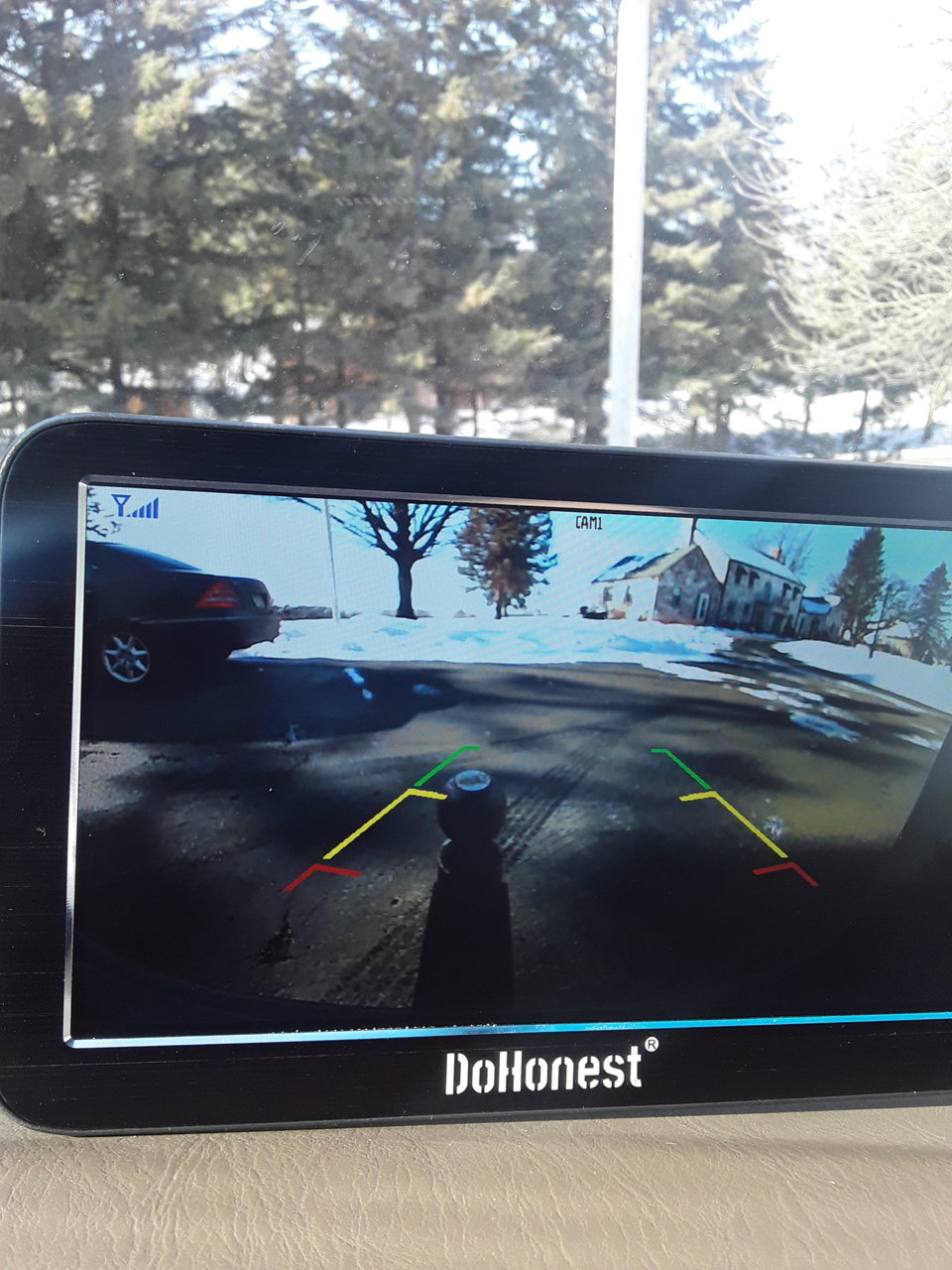

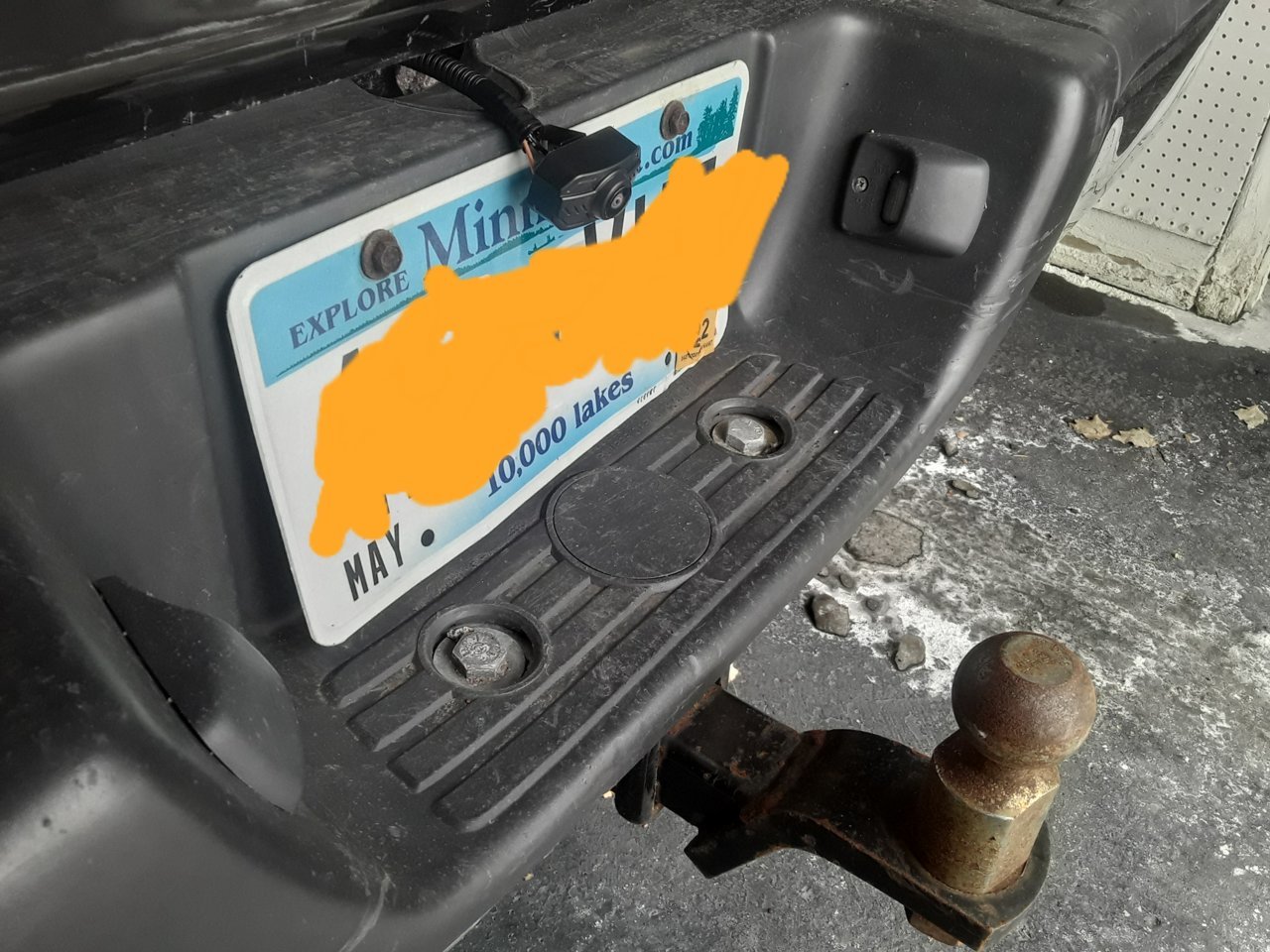

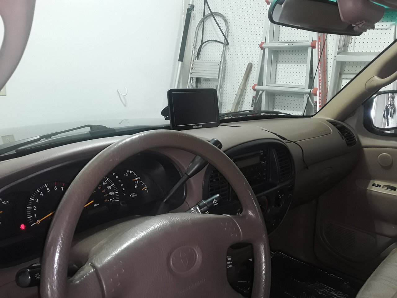

    Installed a back-up camera on my 2002.

    I would drill a hole in the license plate to mount it and make it look less inconspicuous.

    And less floppy.

    Wouldnt it be "less conspicuous"? haha

    I stand by my comment if you happen to notice the camera poking through the plate. haha

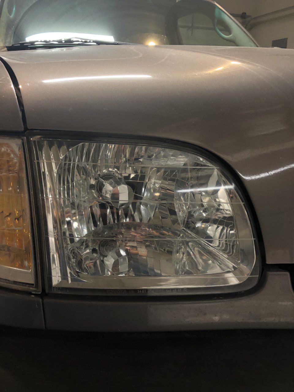

    @sn_85 Gave me motivation to do my headlights, they were so yellowed you could barely see the ballast in the headlight. Very happy with the results!

    Looks great!!! Which product did you use?

    I used the TurtleWax headlight restoration kit at Oriley’s for $11.

    I had my initial backup cam in that spot. It was wireless. It was shit. I got a better camera and installed it in the tailgate handle. That's a better spot for it IMHO.

    True, but given the camera the member has, I think the plate is the only place it can go.

    @savagefen is going to be in for a world of hurt if that spare tire ever needs to come down, unless the harness plugs into the back of the camera itself and is easy to separate!

    Not sure if that included some sort of clear coat but plastic safe clear coat over that should make it last longer.

    Cut a hole in the plate for the camera, and mount the plate on a custom rear bumper, and mount the spare in the bed. All problems solved

    I have two wires through the spare tire release spot myself, right now. Tailgate lock and tailgate handle mounted camera.
    The lock has a 2 position amp so I can separate it easily enough. But the camera disconnect is too short so it’s inside the tailgate.
    At some point I intend to cut and crimp a 4 position waterproof connector for the camera. But I’m also tempted to do it at the current intercept and then make a custom extension through the tailgate. Same basic setup but no actual cutting, just the terminal ends. I worry a little about how delicate the wire is.
