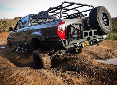

    I like this shot:

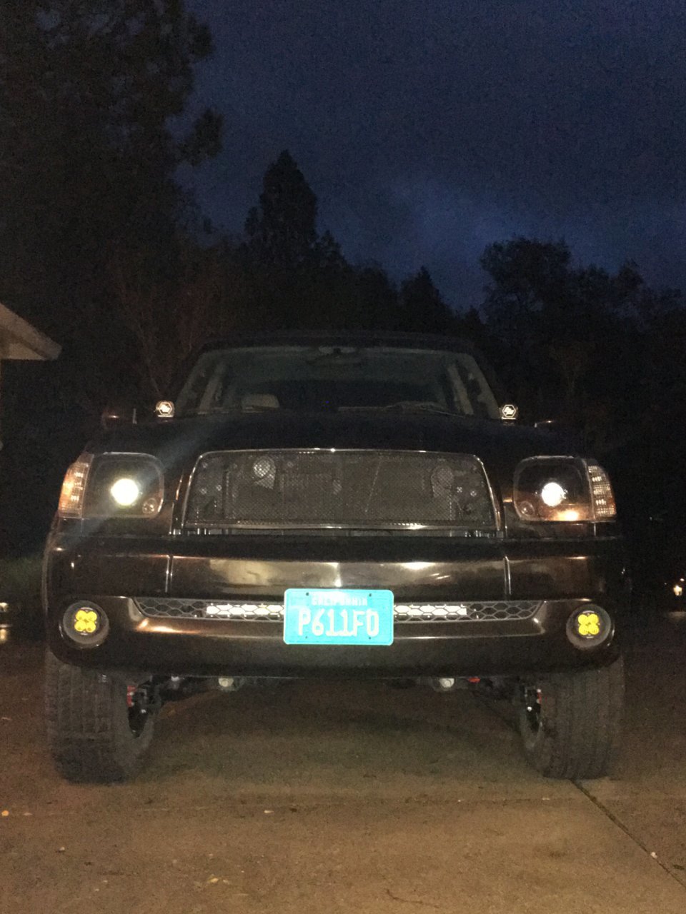

    Looking awesome. I agree about the wheels being a nice contrast. Love the yellow led fogs too. Are they half flood and half spot pattern or what? I just have yellow halogen bulbs in mine

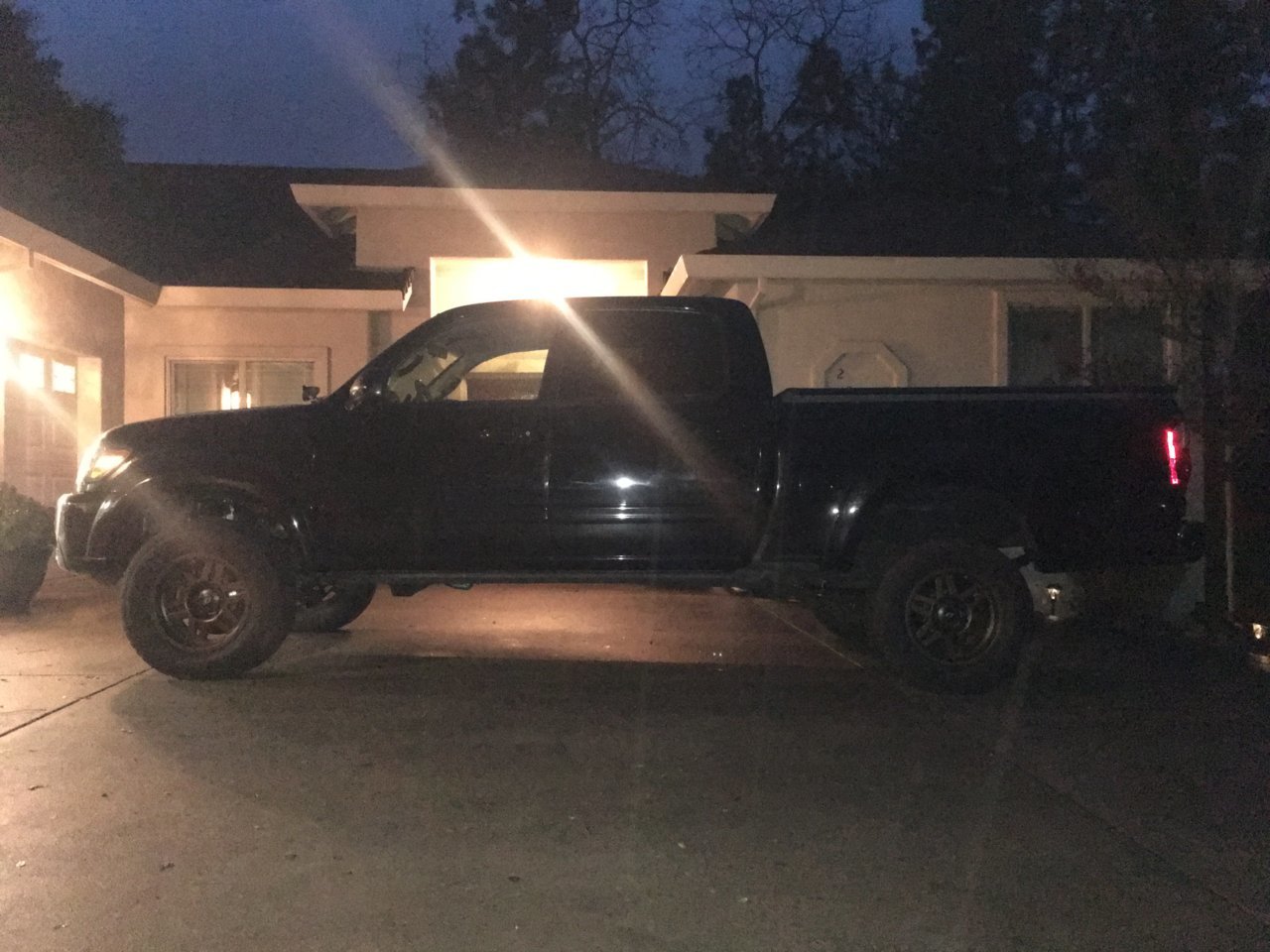

    I was bored one day.

    Those red calipers would look sharp behind teflon black wheels.

    Oh, I thought you meant the red tow hook.

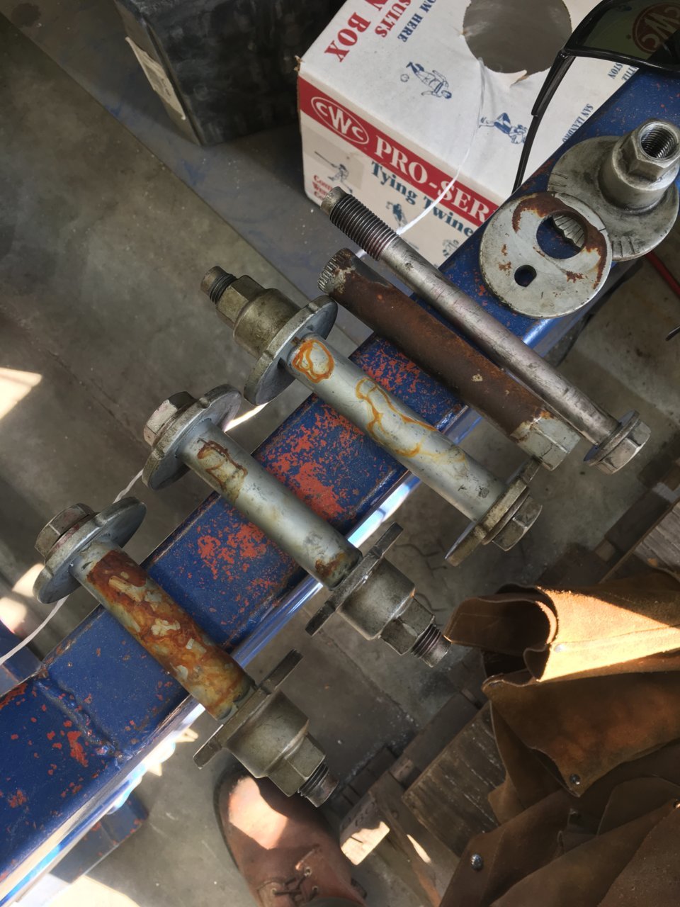

    I tackled the lower control arm (LCA) bushing replacement job this weekend, I used daystars poly bushings, their directions are very limited. This is not meant to be a comprehensive step by step guide, most folks with some mechanical aptitude can do this in a few hours with the right tools and parts.
    Driver's side alignment cams and mounting bolts came apart easy, passenger side were rusted in place and required a sawzall to cut em out with lots of new blades (8). The metal used in the old bushing and cams is very hard. Those of you with first gen trucks should exercise the alignment cams regularly or better yet, take em out and grease them regularly :) Cutting the pass side cams out added at least 4 hours and killed my schedule and now I have to wait until the new cams come in so I can replace them. Another word of advice order these ahead of time because it is very likely yours are rusted in place too which makes me wonder how and alignment tech can adjust them for camber and caster? :).
    In order to access the eccentric cams and mounting bolts on both sides, you will need to remove all of the bolts on the steering rack so that it moves freely, be careful of the hard lines connecting it to the pump, they are slightly flexible. Disconnect the sway bar and end links, front skid plate, lower shock bolts, tie rod ends and lower ball joints from the lower control arm. Once you disconnect these components be prepared to support the spring, shock and upper control arms because they will droop a lot and over extend the CV shaft joint.
    Once I removed the lower control with the lower ball joint still attached I was able to burn out the old bushings with a propane torch, do this outside, it creates a black rubbery mess and noxious smoke. Once the rubber bushing is burned out, you will see a metal sleeve still inserted in the ends of the arm, leave this in the tube. The daystar instructions were clear about this and it is needed for the new poly bushing to fit correctly. Greased up the new poly bushings and metal sleeves with the supplied silicone grease and they slid right in place. The flanges on the bushings go the outside edges of the tubes. The tubes on each end of the arms are different lengths too and it will be obvious to you which poly bushing goes in which tube. The eccentric cams and bolts will all be heavily greased and installed when I pick them up today from the toyota dealership. The last step is re-installing. The adjustment bolts on the cams go to the inside of each arm due to the rack being in the way and they will run into it once the rack is re-installed.
    Once everything is back in place tighten all bolts to the torque specs listed in your chiltons or factor manual. I usually go through the manual and write down each value on a piece of paper I carry so I can run through this process without going back to the manual for each value. Make sure the suspension is loaded before torquing any pivot joints like the lower shock bolt and Luca pivot points.

    Good info @mtntop those alignment cams are a pain for sure and mine were totally stripped on one side. One of the 4 was rusty and I live in California.
    Let us know how those poly bushings work for you, I was afraid of squeaks.

    Here were mine before a quick touch up on the wire wheel. A little rust on the passengers but definitely reuseable.

    The time included a trip to the big orange box, and Dewalt sawzall blades which advertise they last 2x longer means they last 3 minutes instead of 1.5 for the std before they dull out LOL
    I have a grinder with a cut off wheel, but the wheel was only a 4 inch and the distance to the cam sleeves inside the bushings is longer than that. You can cut through the cam sleeve on the end of the bushing but that also means you will be removing metal from the mounting tabs attached to the frame even if you try to spread the tab away from the bushing (tried it). I chose to cut through the bushing itself until I went through the cam sleeve which then fell out of the end. No need to cut through the whole bushing.
