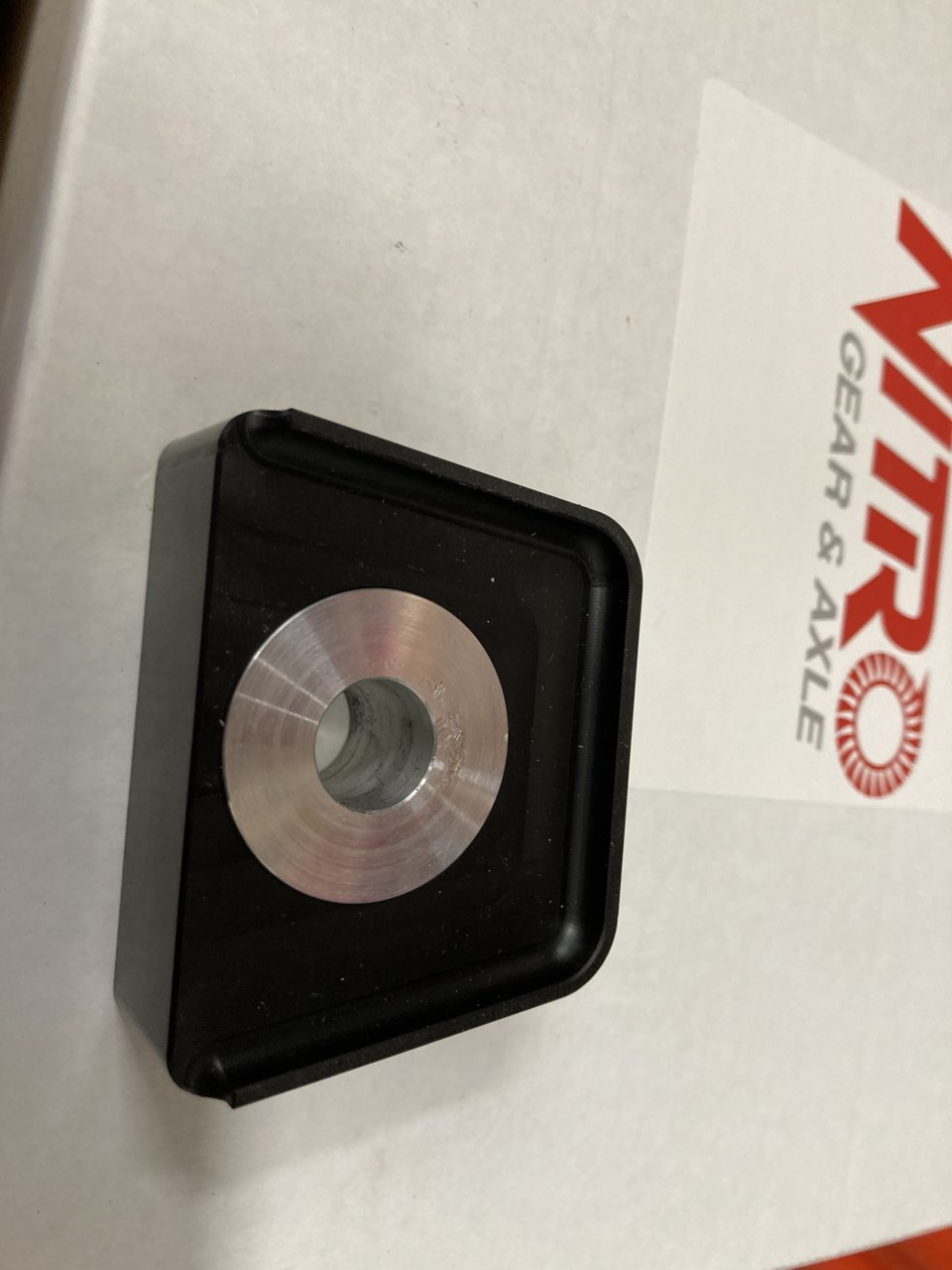

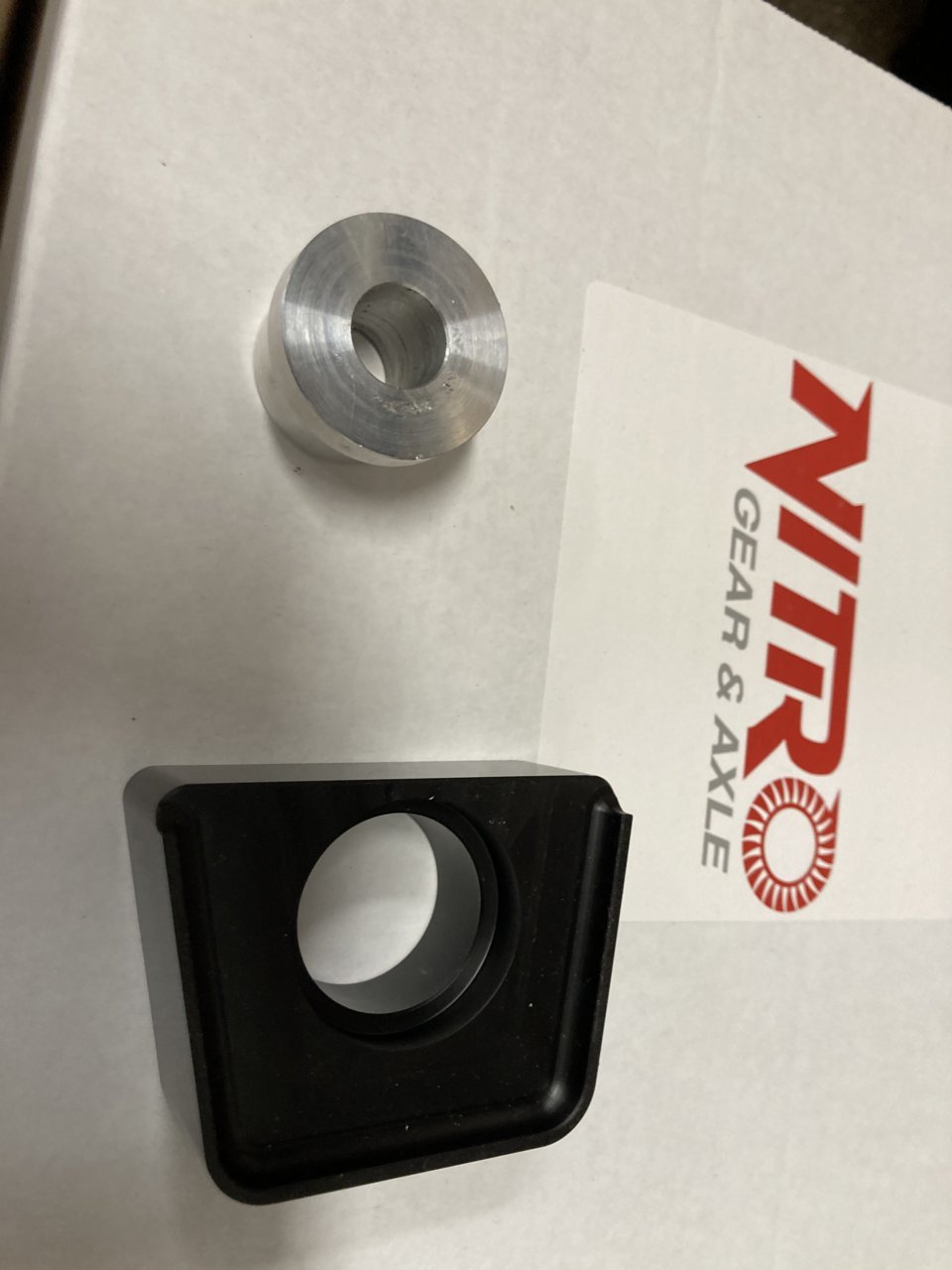

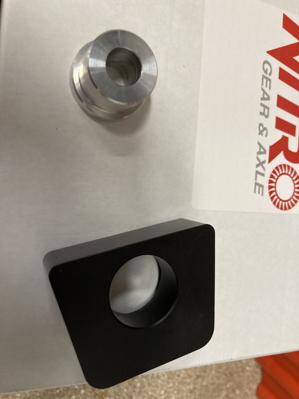

    I have some super nice aluminum / delerin rear seat risers which were hand-made by the same guy who made my SS shift knob which match the countors of the rear seat mounts. One pair of 1” and one of 1.5” and I don’t think I will end up using them. I will double check how nice they fit our Tundras sometime and probably send them to someone in this FGT circle down the road. They are beautiful. Somewhat disappointingly, both my wife and I prefer stock height.

    Delrin, as in the plastic? The plastic which was the downfall of Simplex back in the day, because all of their parts would crack with age, causing countless injuries and probably some deaths? :rofl:

    I may be wrong on material. It’s a hybrid version with an inner cylinder of aluminum for structure and an outer shell of hard plastic (I thought it was delerin since that is what he uses for shift knobs) for aesthetics matching the OEM curves. I can post a photo if you’re curious.

    Nah, we're good. I think Simplex's issue may've been with how thin they were making the plastic parts. But there was also controversy over using Delrin in the Corvair for the cooling fan, with problems glanced on in this article. Delrin is definitely still a thing today, DuPont makes it. I dunno if they've improved on it at all, but it has a miserable and problematic history not a lot of people are aware of. Maybe that's why they're still using it, or maybe DuPont made changes to stop it from weathering, greying, and offgassing, getting fragile.

    I’m unable to resist sharing photos of these. They are beautiful.

    Those are awesome.

    Yeah, I just don't trust Delrin. I've had too many bad experiences with Delrin material fatigue, I've seen it rampant both in '70s-80s moped and bike applications.
    It's one thing if it cracks at an inconvenient time on a shift knob, probably nothing will happen. If it cracks on a seat riser, bad things are inevitable, just like times when it's cracked on a rear derailleur body, or jockeys, or on a front derailleur clamp while someone was riding and - teeth or noggin on pavement.
    I can show you some pictures of multiple examples. Don't relive the 1970s and 1980s. We learned our lessons with using Delrin back then, the hard way. Those who fail to study history are doomed to repeat it. I'm actually shocked anyone would use it for this purpose unless it's been reformulated.
    Seriously. Plenty of info on the internet about Delrin and structural cracking/offgassing/fatigue. Google: Simplex Delrin Crack.

    The aluminum is where the bolt shank threads through. Then the aluminum collar seats the delerin. The Aluminum is 100% of the structure. The delerin is the window dressing. If it cracks away completely it makes no difference on the mechanics.

    Ah. I was thinking the Delrin part was the riser.

    I like your cautious approach. But I posted the photos so it would hopefully be clear how I thought the design was pretty slick. At least from a "I have no mech E background whatsoever" perspective.
