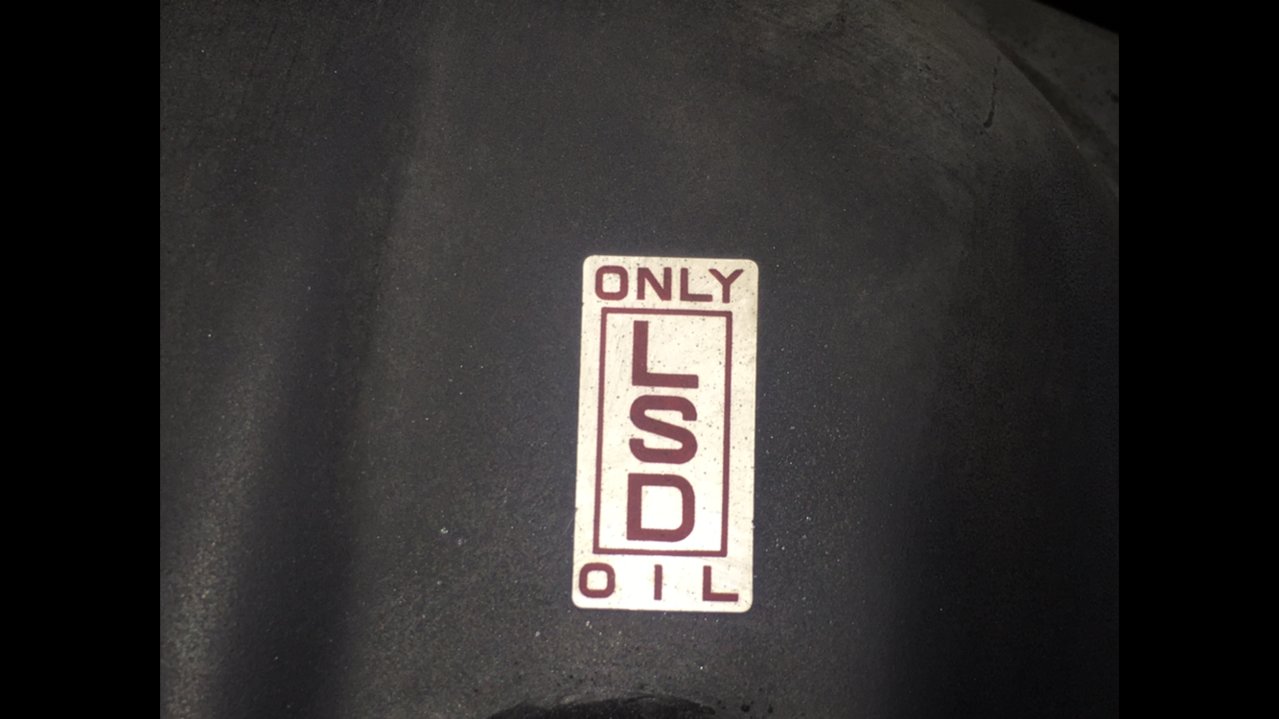

    Do you have the LSD in the rear?
    If you do, it’s 75w-90 and you need to add a LSD additive. I use Mobil 1 LS in the T-case, front and rear diffs.

    I assume you don’t have this sticker on the rear pumpkin?

  19. Jan 31, 2019 at 12:21 PM
    #3589
    trailbikerider
    trailbikerider New Member
    Jul 20, 2018
    #17219
    220
    Blake
    Kalamazoo, MI
    2006 Tundra DC SR5

    05 Tundra
    I have the LSD sticker on mine.
    I'd like to change my Rear diff fluid before my King of hammers trip next week.
