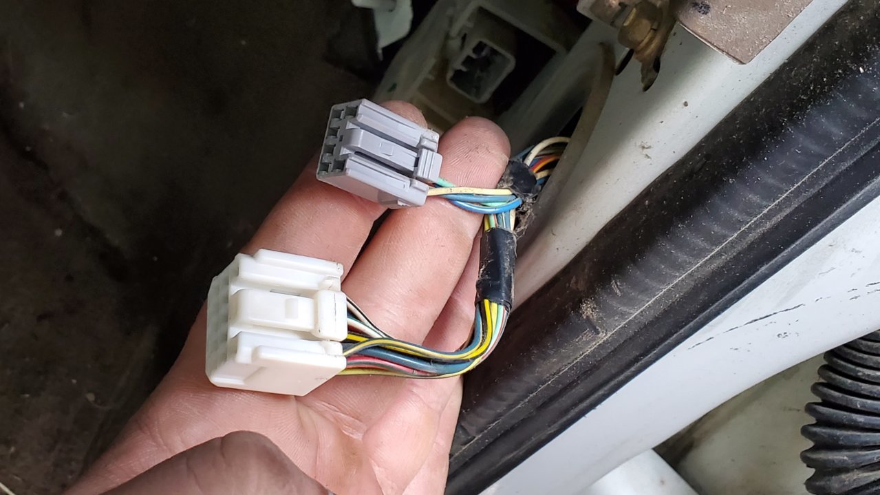

    Might take another trip to TN tomorrow to go to that junkyard.
    Specifically looking for doors, and complete tailgate.
    I need door hinges too. Anyone have any advice for removing the wiring from the body of the donor truck? Would like to practice doing it the right way if there is a right way.
    Also, if I find good, non broken manual window doors, can I convert them to power window? Is it possible?

    05 rollover special
    the doors are exactly the same. you just need to wire up the power windows. or if your lucky like me, the trucks already wired and you just need the door harnesses

    If you have to pull anywhere, it's still attached. Take screwdrivers, 8, 10, 12mm sockets, a sharp utility and and good wire cutters and precision or small wire cutters (to cut tape and plastics - not wires)

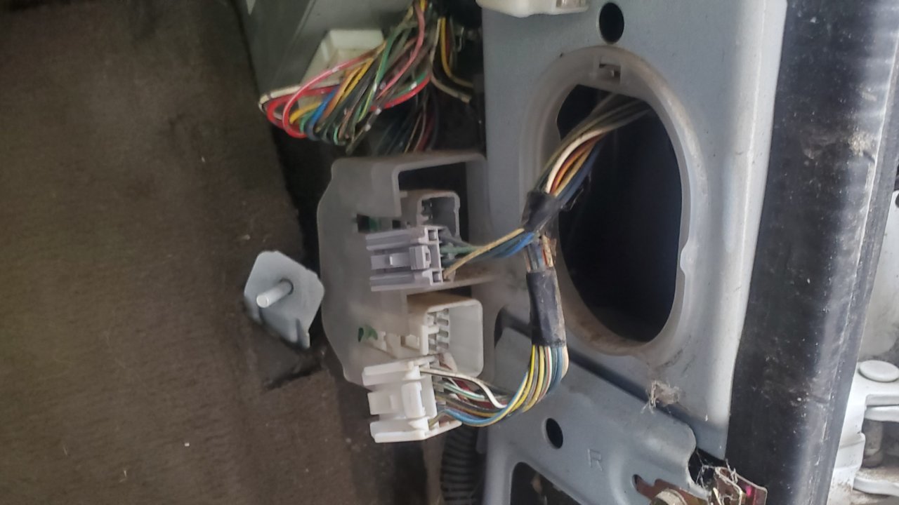

    Crackie already has power windows. I was mainly asking because I don't know how to unclip the door harness if there is a clip. What is involved with that?
    Don't want to create unnecessary splices
    It's a you pull so thanks for the reccomendations. Any advice on door harness clips reccomended

    No I mean If you have to tug on wires, they are attached to something that needs to be released.

    Unclip in the kick panel and take the door boot with the harness and everything downstream.

    Perfect. This is exactly what I was looking for. Thanks Dave!

    just unplug the harness from tbehind the kick panels

    door harness connections are behind the kick panels. 2 screws and unclip. I’m assuming your existing door harnesses are good? If not, double check the connectors. My 00 had a different plug than my 01 parts truck.

    Crackies door harness works, but I've never had the door panel off to inspect for rubs or splices. Will have to verify. Thanks for the heads up on different connectors. Did you have to swap harnesses or did you repin the connector?

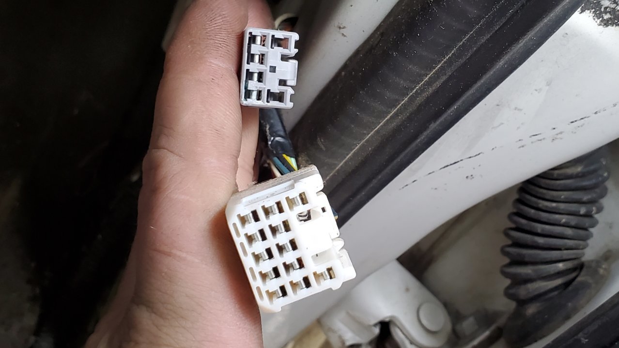

    3 other people are going with me so I will not be driving crackie unfortunately. I did pull the pass side kick panel off to check the plugs. Squaw en route
    I didn't pull the driver side, but I assume they use the same connector?
    Now, if I find a different year than 2000... can I Swap door harnesses and make it work, or would I have to repin the donor door, and pin these plugs on?

    I just swapped the 00 harness to the 01 door. All the other connectors were the same.

    10-4. Tedious, but not difficult?
