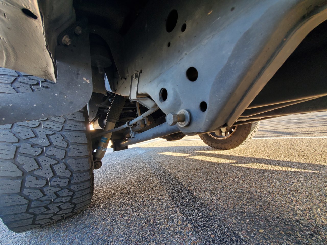

    I think my rear driver Bilstein 5100 blew. I'm getting swaying at high speeds and feels unstable, almost like a low tire pressure feeling. I don't see any broken links or suspension/steering pieces. I measured the rear and its half inch lower than before so something gives. Anyone ever had a blown rear shock? Or drove with one.

    blown shock wont cause the truck to sit lower. broken spring will

    Springs look good. Looks like my lateral bar threw a nut right off lol. I Still can't explain my height difference though.
    Voss likes this.
  22. Dec 27, 2021 at 3:56 PM
    empty_lord

    yea... dont drive that till you get a bolt. the spring may be in a slight bind since the axles shifted back

    Have you had it removed recently or was it factory tight?

    I replaced them like 7-8 months ago. Bolts were tight all around. Strange that that side gave up.

    Good time to have a come a long and some webbing...pull the axle forward to get that bolt in - or a replacement bolt.
