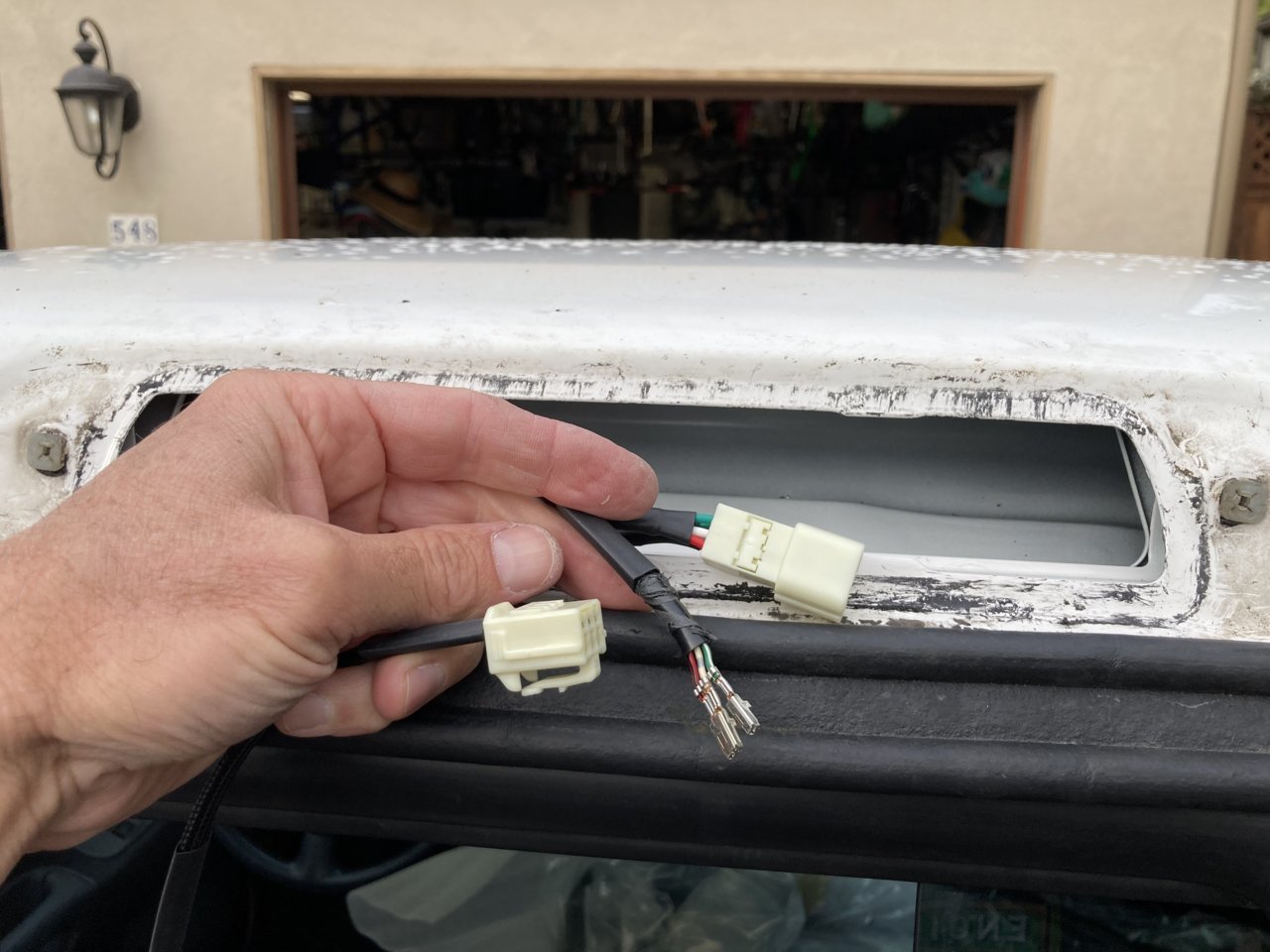

    Got my CHMSL replaced w new OEM unit, VLED bulbs and full wires to the bottom of the B pillar for Dome, cargo, brake and ground disconnect. It was way easier being able to stand / kneel in the bed.

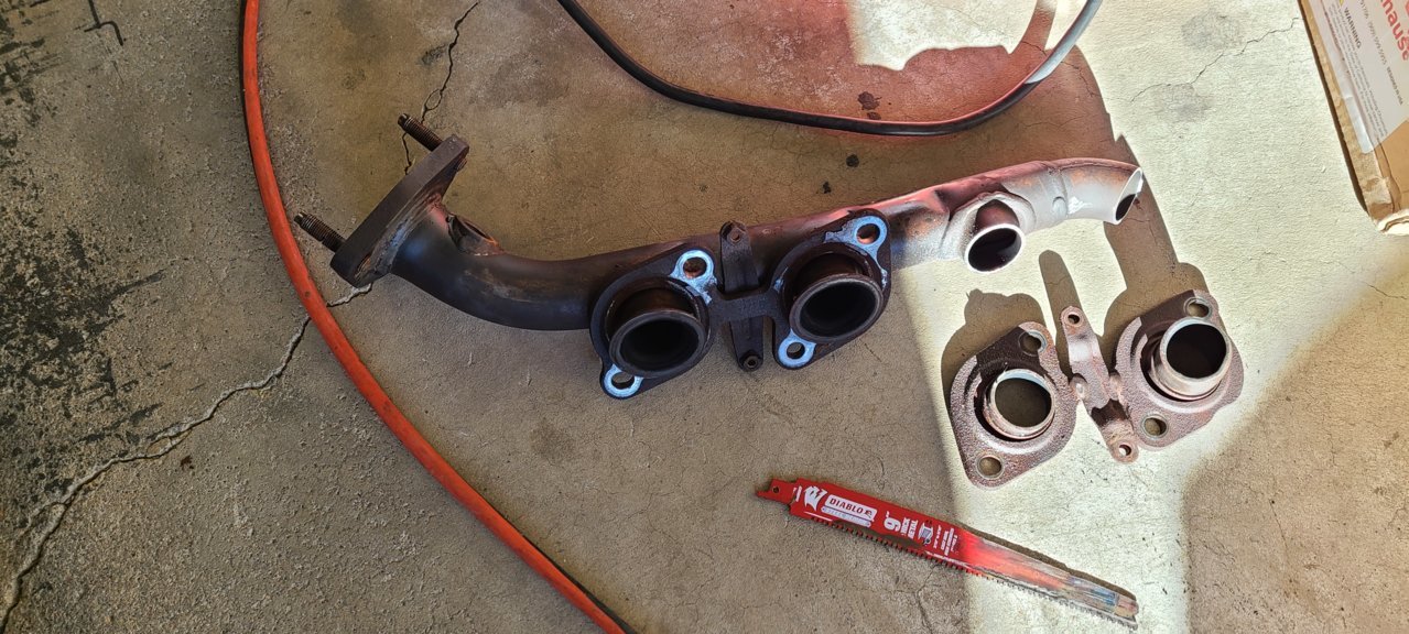

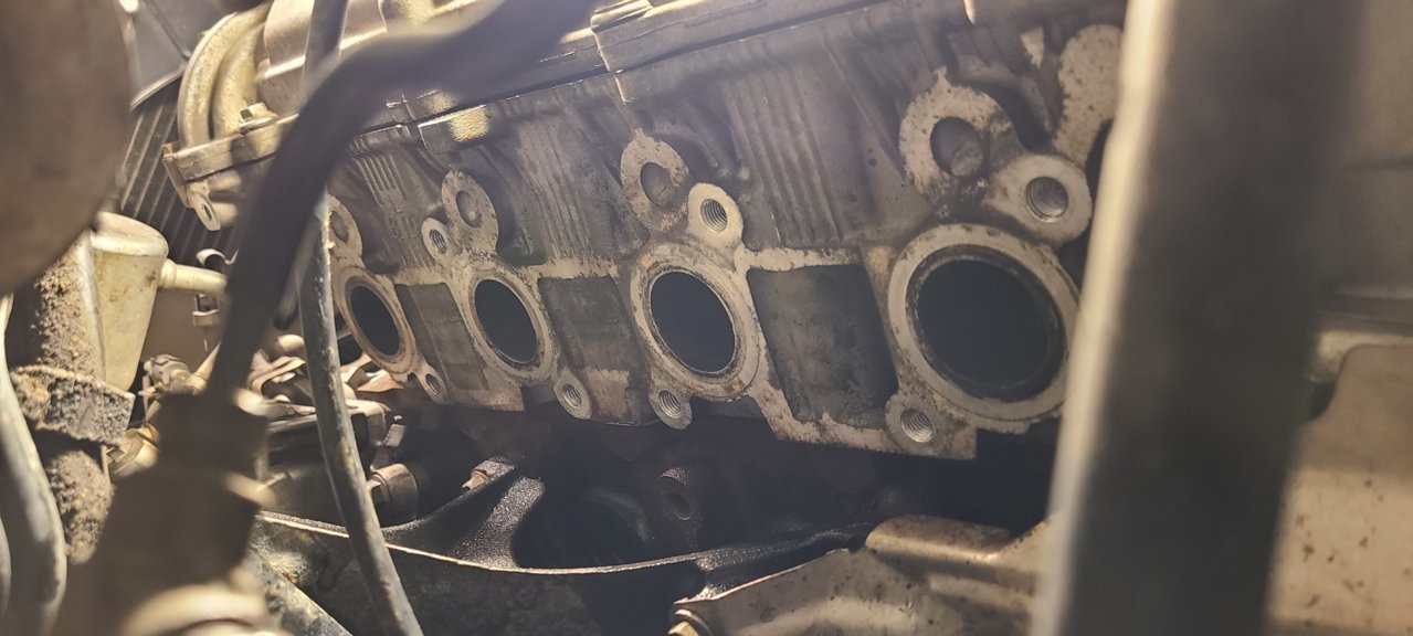

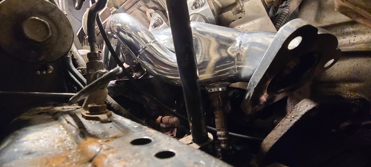

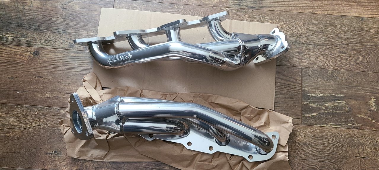

    I finished installing the shorty headers. What a pain in the ass! The last bolt on the passenger side wouldn't come out and I had to cut into the header. I also had to cut off all of the collector bolts and y-pipe bolts as they were rusted into blobs. The header cut like butter with the Diablo blade. If I were to do it again, I might just cut both headers off - then you have easy, straight-on access to all bolts. Putting in the new headers was easy because there is plenty of room around the pipes.

    nice i helped a buddy do his early gen tunny a couole years ago and we cut them off. internet searchs say remove motor mounts buy jacking enging up from oil pan or making special tools for nut removal by 2x4 jams from under truck. nobody gots time for that. buddy was good with sawsaw action but its tight but doable.

    Yeah, I did not remove the motor mounts. It seemed like removing those extra 6 bolts per side would offset any time gained on the 2 manifold bolts per side that they are blocking. I have heard all of the experts recommend it, so it is probably the way to go. Anyone know how high you can lift the engine with the mounts off - like 1 inch, or not at all? But for sure I would just cut those f'er's off next time. I just measured the OEM manifold pipes, and they are 14 gauge - around 0.08xx". As I said, they cut easily, like 10 seconds per tube to rip through them. That would have saved me hours.
    For sure I can feel the extra torque! It is not life changing, but it's there. The truck is just quicker and more responsive than before. This was a cool upgrade that I would recommend to anyone with leaky manifolds, or to anyone who just want a little more grunt.

    Was it not a case where you could creatively toss a swivel socket or two on and blast it with a couple of hits on an impact?

    Yes, that is exactly what I did. I have some swivels and also wobbly extensions. I didn't need the impact though, just a 1/2" breaker bar. I did try the impact on the one bolt that would not budge, and it still did not budge, and the impact kind of dented/damaged the swivel.
