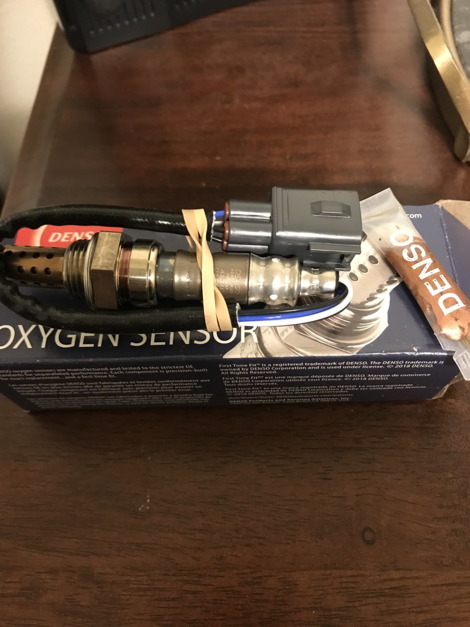

    Got a check engine light code P0031:Heater Control Circuit Low (Bank 1 Sensor 1). Replaced with Denso part # 234-4169, tested and read 15.7 ohms. Old original sensor came out pretty easy. No more check engine light.
