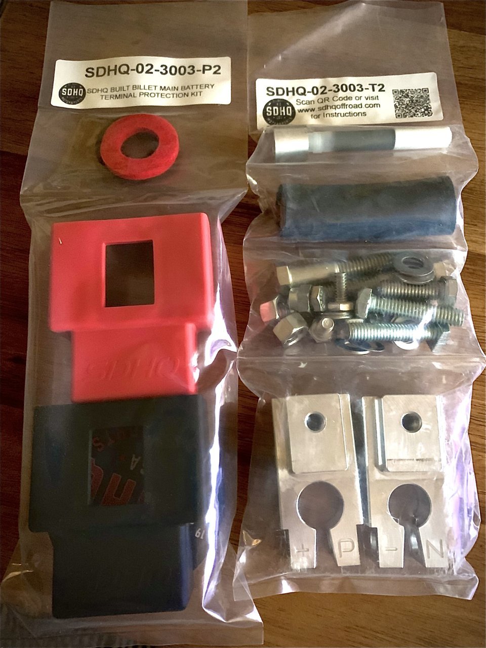

    It's good
    Wiring upgrade include this?

    na, i like the OEM style terminals. the mess of fuses you see will hopefully be cleaned up in a few months when david gets the headlight harness made up for my truck and his. it will condense my headlights and horns to one wire on the battery.

    That sounds sweet. I don't care for the OEM terminals, but I also don't have the super clean ride you do. One of the things I've been thinking about lately is a modest rear bed chop, for instance. But I have to tend to my frame first.

    If I was going to add a lot more electronics I’d go with a fancy post. But this truck at most will have that one harness and eventually a switch pro. That’s easy enough to run off a stock terminal… plus I get them for free. And I’m cheap with things like that. Lol

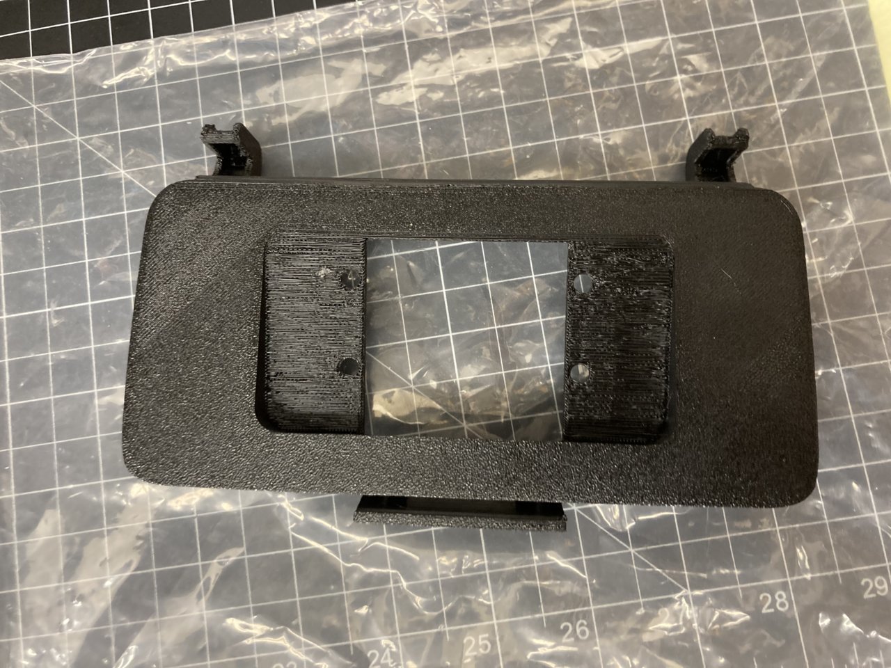

    There’s a dude on Insta that sells sunglasses holders 3D printed to bolt the switch pro to, I have one waiting.

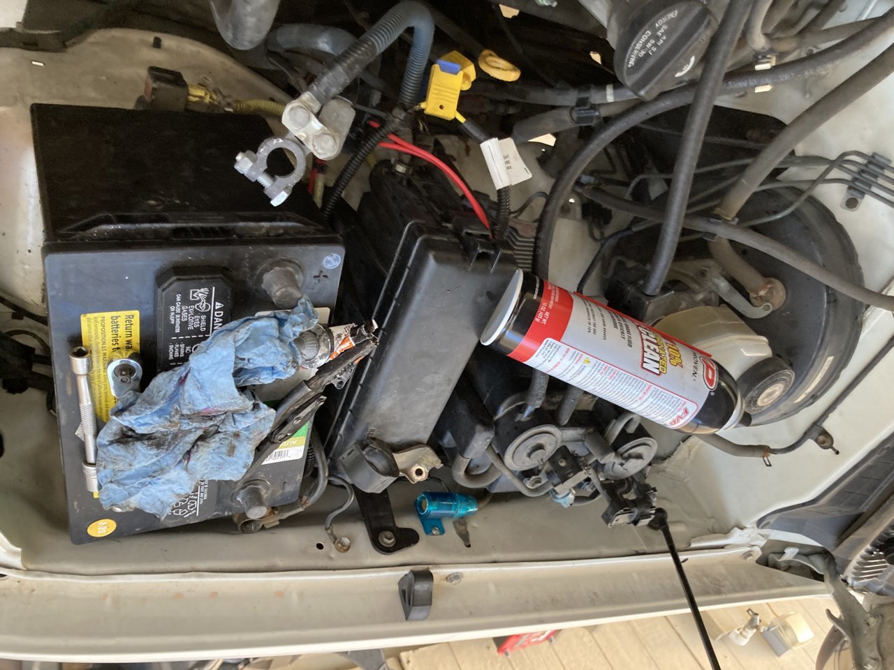

    Side Q though, there is an aux post in the fuse box which my truck had the tow harness +12v leads off of. Same side as the + post of the battery. Depending on slack in the fuses that might be an option? Your fuse box looks the same as mine at least with the cap on it? Unless that post was the reason why my friend the PO kept burning out batteries?

    Me too. Looks like this for anyone wondering.

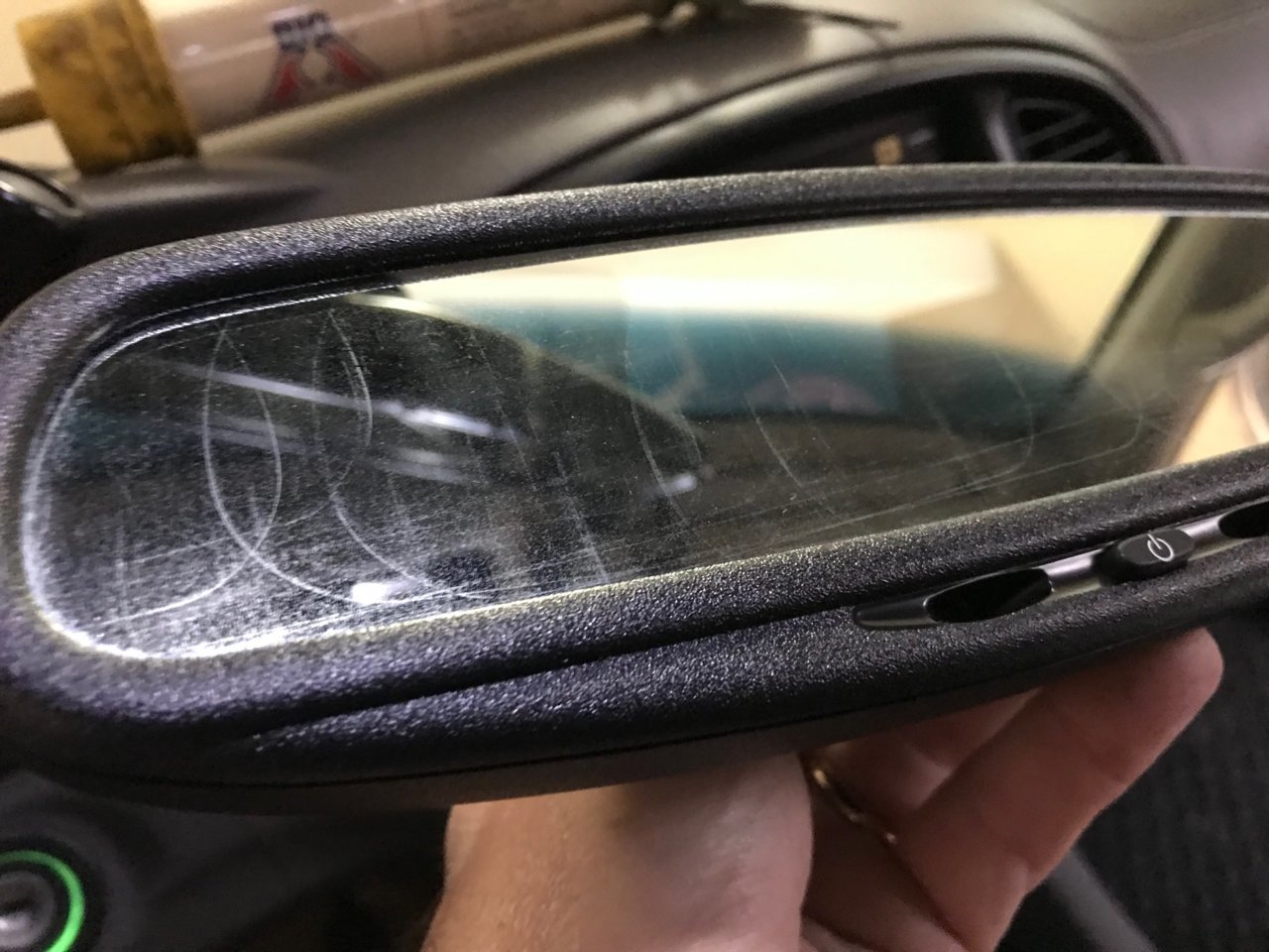

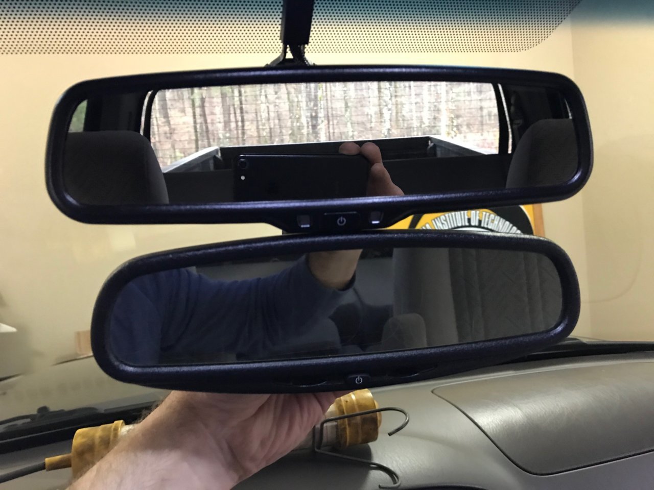

    My OEM mirror started looking bad a couple of years back, glad to have replaced it as well..

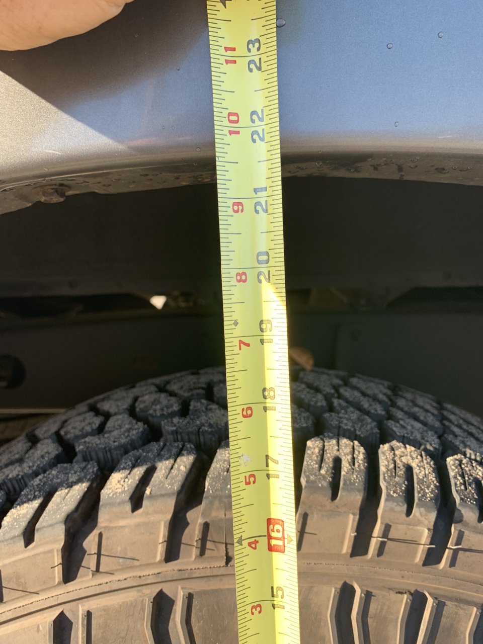

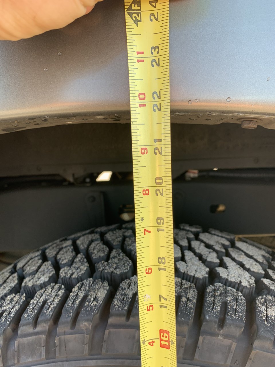

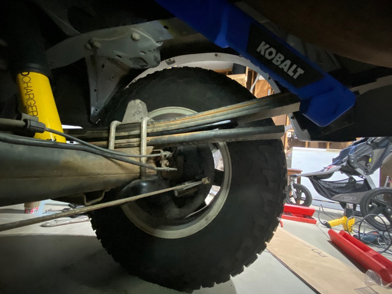

    Haven’t driven yet. Going to get the other half on today. What was the original height of our trucks in the back? Just deciding whether or not to put the pinion angle shims in.

    The main line into the fuse box? The way the fuses are on mine there’s no room.

    Since you are under there, I believe it is 9 1/2” from the top of the axle tube to the frame.

    It’s generally good form to only use new u bolts. They are long because they are generic, cut off the excess once your torqued down. FC4CEB31-6CA5-46E0-90CE-46EC36E094EA.gif

    I think I was 1/2 lower than stock here. A little over 21 1/2

    Yea going to do this today.

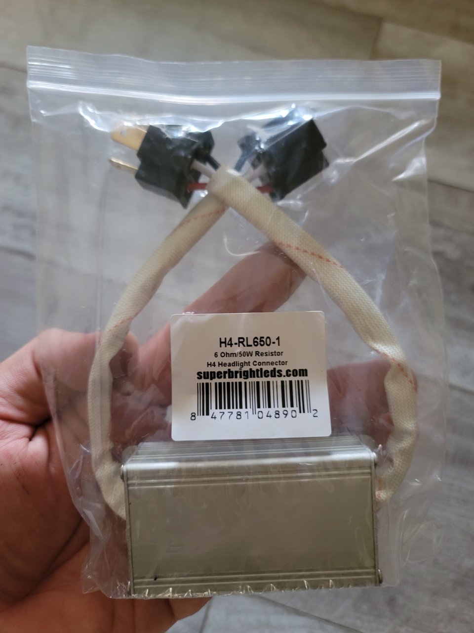

    Finally got around to install my Superbright led Resistor on my passenger side led blub. Now my high beam indicator works and my fog lights come on/off normally. I ordered 2 Resistors because I wasn't sure if I needed one for each side. Only needed one.
    Also I remember reading that if your using led blubs you should use a special harness to power them. Is this true?

    No need for a special harness on LEDs. If you didn’t want to run a resistor the any time fog light mod fixed the light issue

    Got it I thought I read something about the oem wires are not thick enough for LED.

    That would be true for 100w halogen bulbs. LED draw WAY less power, so the stock wires are more than Adequate
