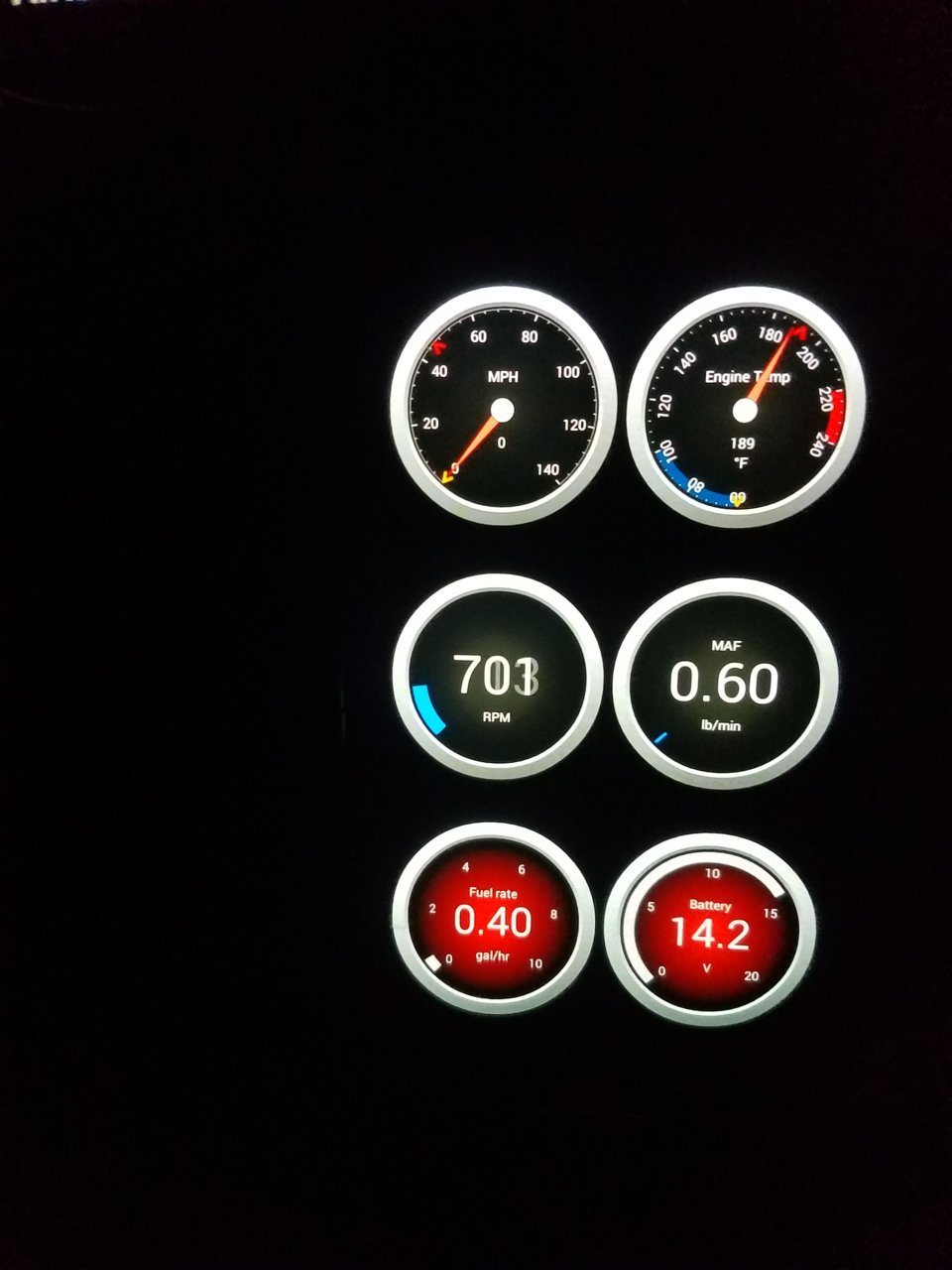

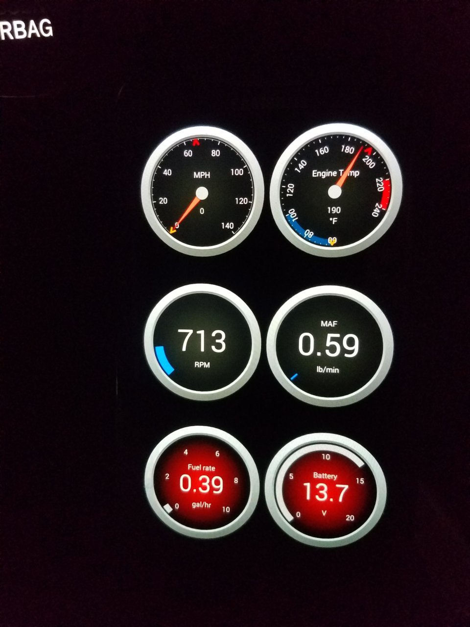

    I did the GM diode mod this evening. My idle voltage went from 13.7 vdc to 14.2 vdc. It peaks around 14.4 vdc. I'll take it.20211115_182014.jpg 20211115_213241.jpg

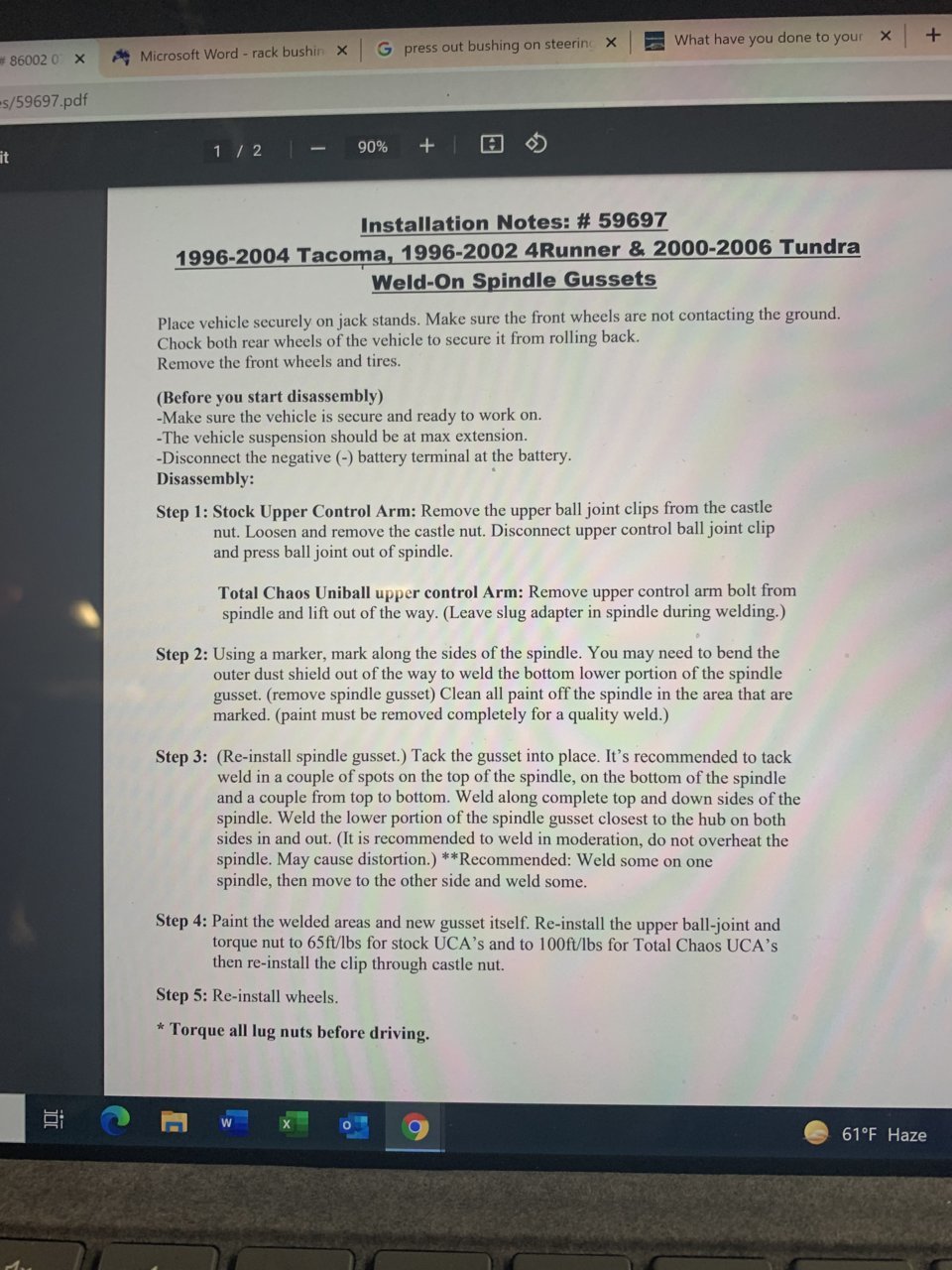

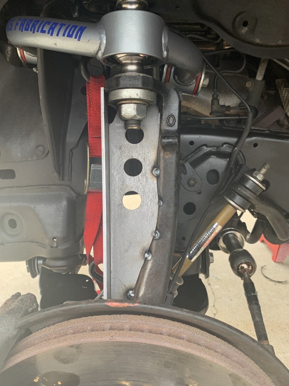

    I got the TCs. Ordered them a while back waiting for a time to install them. The diver's side fits well - it's just tacked for now.

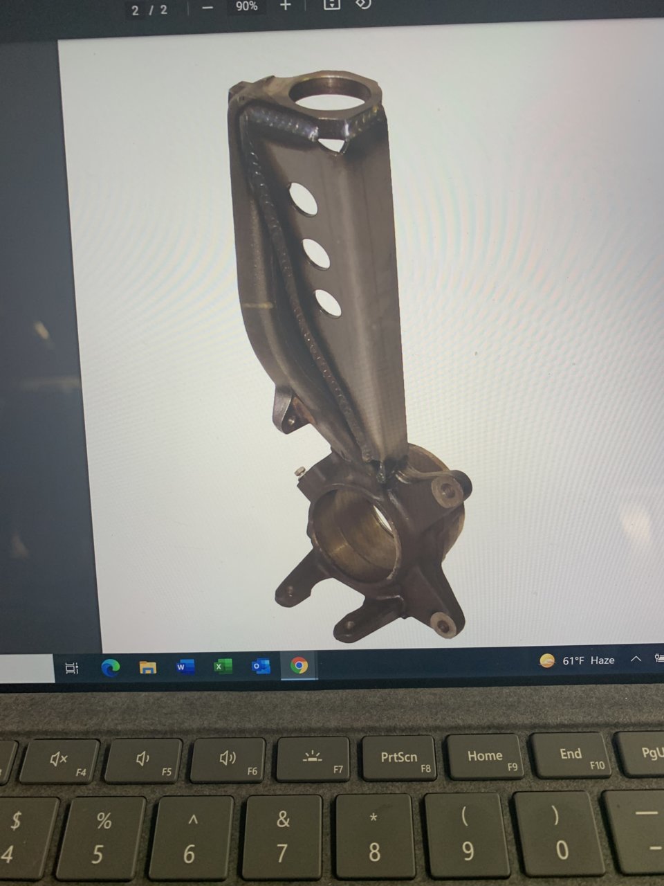

    If my dyslexia hasn’t attacked, they go this way…

    Whats involved to weld these gussets in? Like what needs to be removed to properly get to the spindles to weld them in? Im thinking of giving this a go down the road and just curious how much of a pain it is to do. Thanks!

    @oscardog86 when I did mine I pulled the spindles right off the truck. You need to be able to grind the area clean of paint and get in there at funny angles to weld them.
    Some say you should pull the hubs and bearings to avoid cooking them but if you do short passes and give plenty of cool down time between they should be fine to leave in.

    Agreed with everything @Darkness said. I’m doing mine on truck, but am very thoughtful of temps. Off truck is preferred, and if I wasn’t exhausted, would do that.

    The second one is the backside.

    When you have 700lb coils, the mere weight of these is not a concern (to me). Flame on
