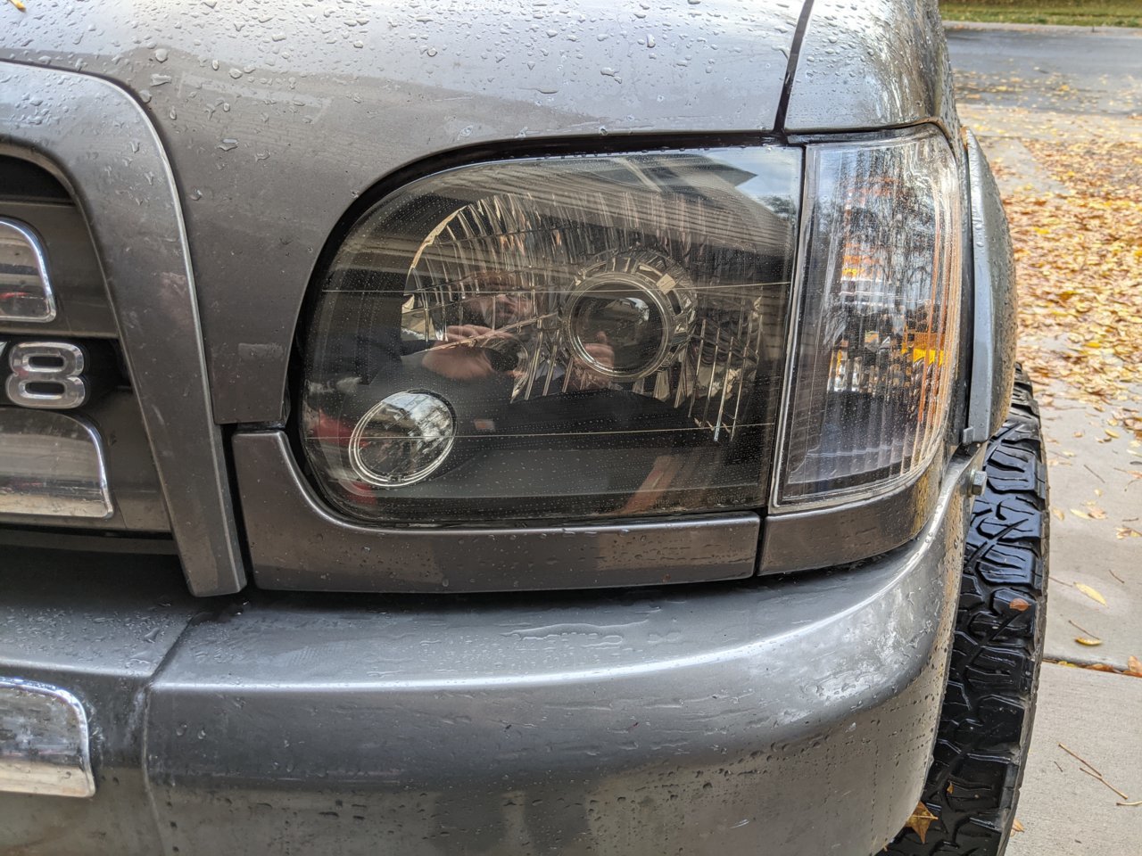

    Driving home last night I realized my new headlights are similar to what I had before with the h1 projectors, but just with better light quality. The cutoff line is more pronounced. I'm not sure if this is an h1 vs D2 style bulb deal or a 2.5" vs 3" projector deal. I'm happy I upgraded to the D2 style projector, and I'm impressed with how the budget h1 setup gave me maybe 75% of what the D2 setup gave me.
    Long story short... If you are on a budget and want to retrofit some headlights. You can go with cheaper h1 projectors and fiddle with them a bit and get some awesome light output and quality that will make factory headlights seem like candles. If you want to spend twice as much you can have even better quality, but you might not even notice the difference between the two options unless you have the budget h1 setup first.
    Slightly related: what are my budget h1 headlights worth? I was going to try and sell them locally. I doubt I'll have any luck, but there's hope some 05/06 tundra or sequoia aficionado snags them. What's a fair price for the just headlights without bulbs or electronics?
    Hit me up if you have any specific questions. This thread should answer any questions you might run into if you aren't extremely familiar with the process.

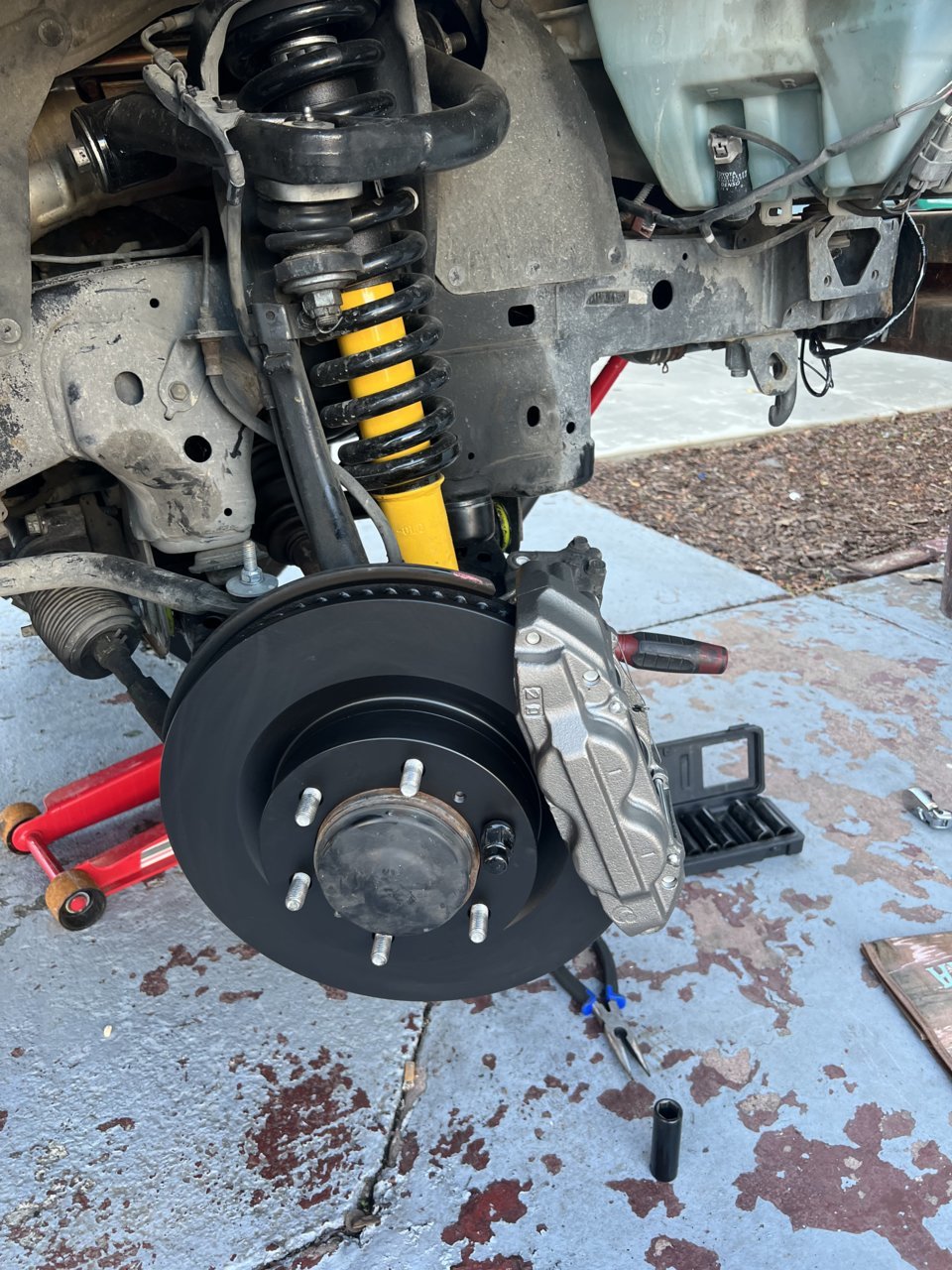

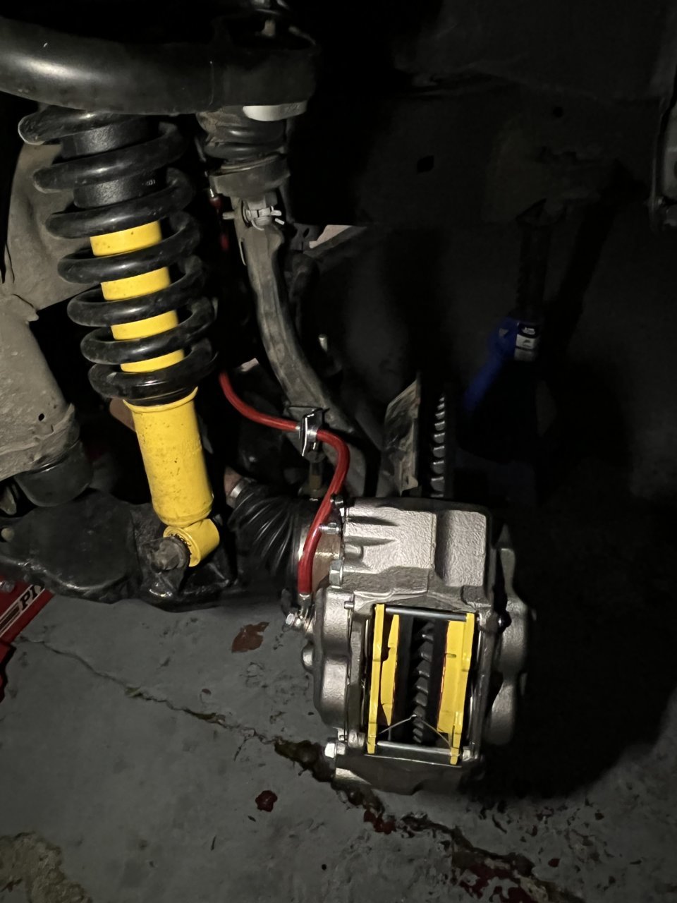

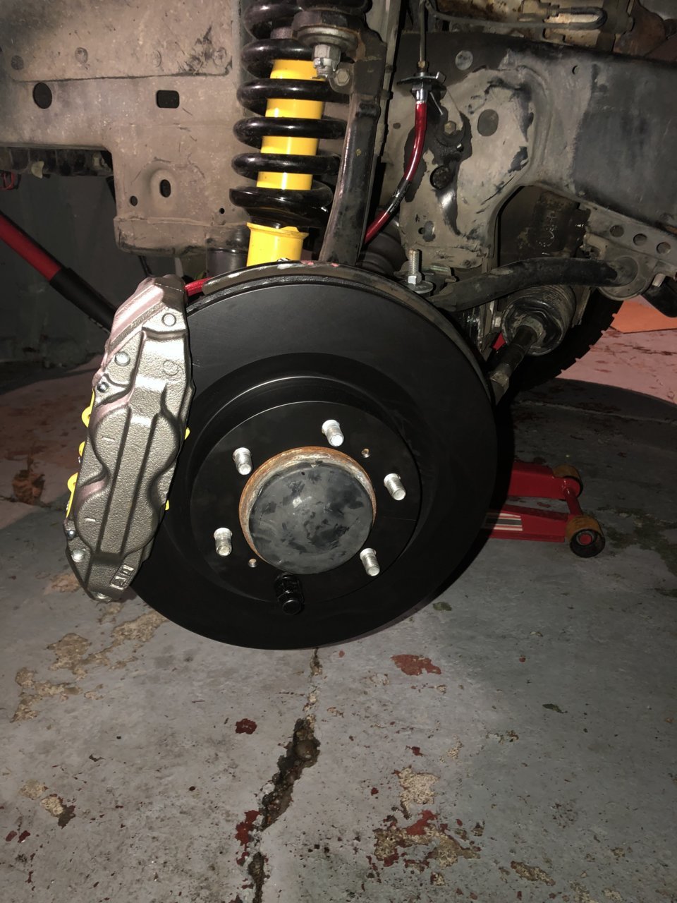

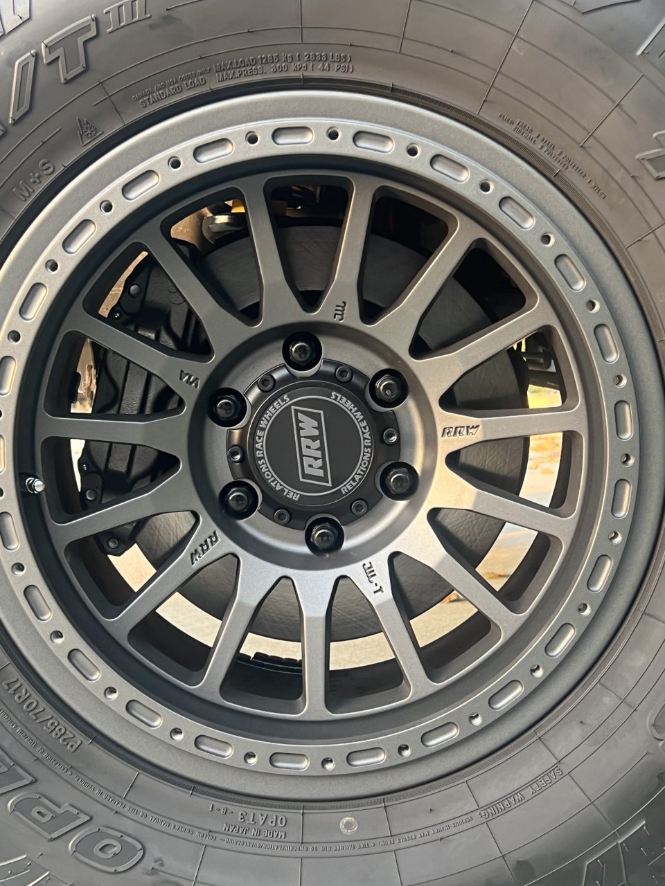

    Today I decided to go ahead and do the GX460 brake upgrade. I’ve had the parts sitting for a few weeks and I’m going back to pismo beach dunes this weekend so why not…
    went pretty smooth on the passenger side. Driver side had a leak where the brake hose meets the caliper due to the surface not being flat. Small imperfection. Rebuilt calipers… scrambled to the parts store to find the last 2 pack of crush washers. Got the air out of the system test drive and I hear horrible metal on metal. Dust shields were to blame. I bent them back a little problem solved. I read on it before but I decided to skip on going back and looking info up. Just went for it. Well she stops and I’m done for the night. Good times. Celebrated with tacos and a cold one.
    I went with oem rebuilds. Didn’t want new castings. Had machined locally in Oakland CA
    EBC rotors and yellow stuff brake pads.
    crown performance brake lines. They are really nice and seem like top quality.
