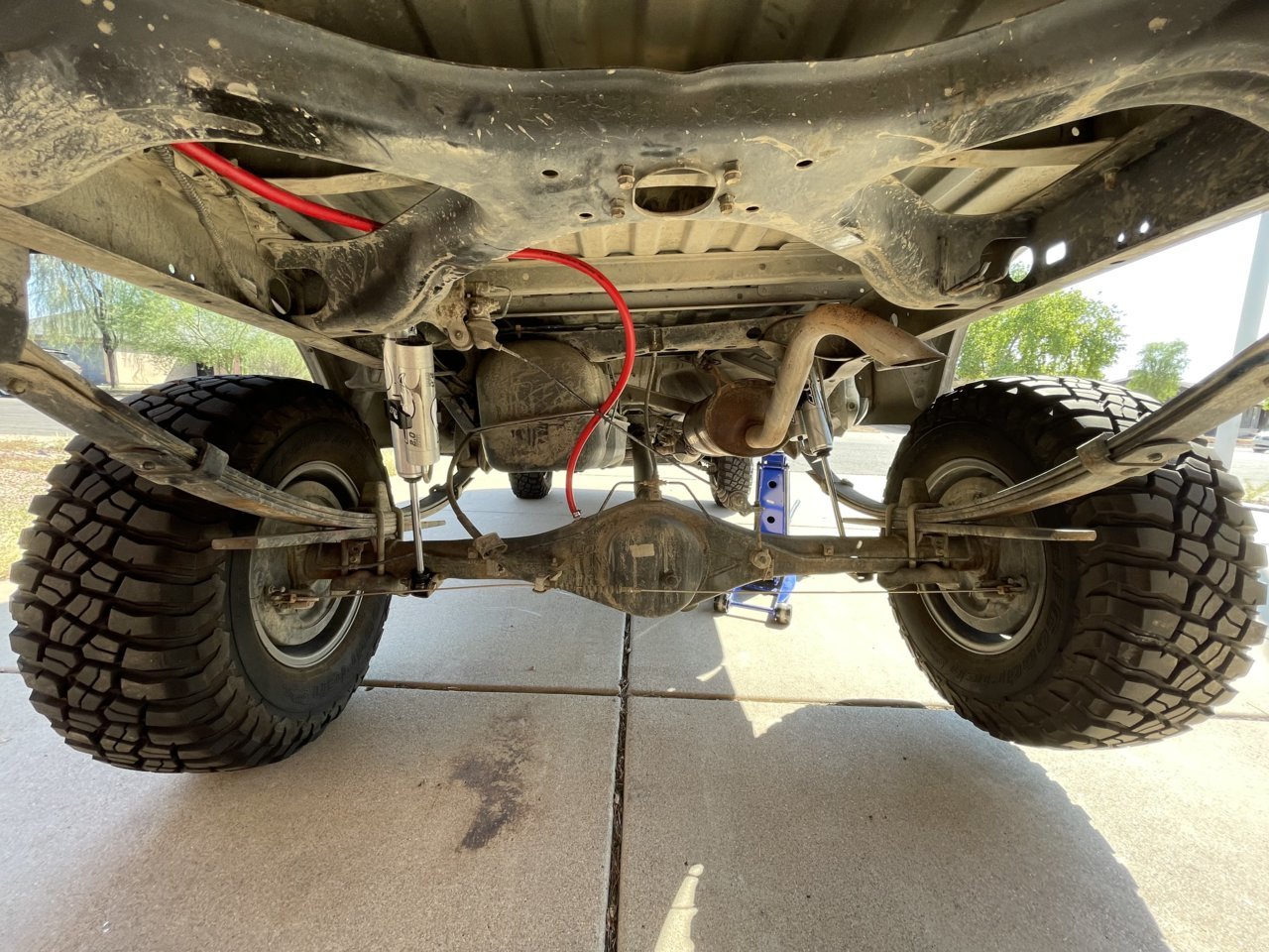

    All this bump stop and leaf talk made me shell out some more money before T2S. Ordered some Timbren ABSOSRs and new ubolts for the rear.

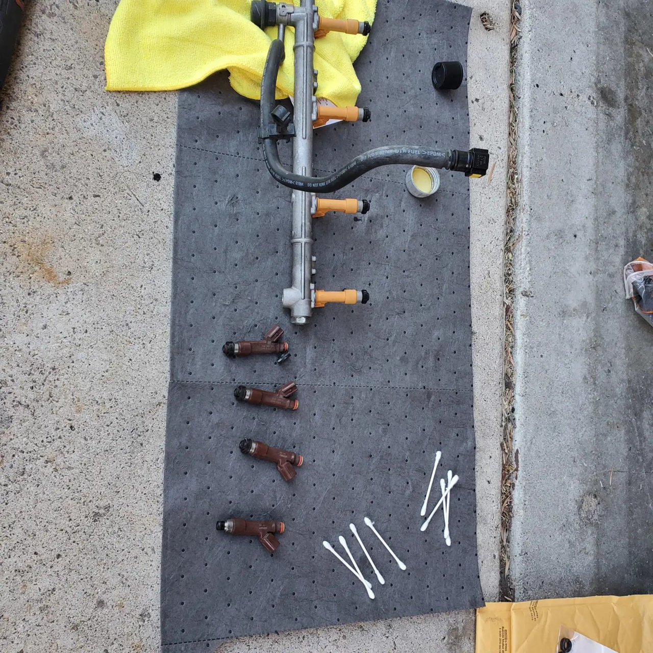

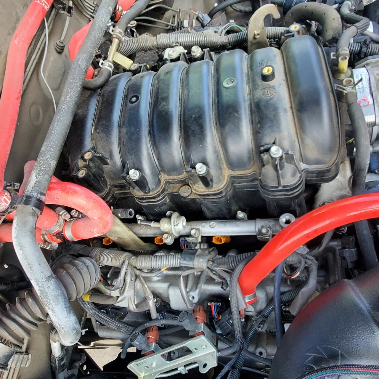

    DD 12 hole injectors done in under 2 hrs with preping and cleaning.

    What cc injectors did you go with again?

    Those look like rx8 injectors honestly

    Are you running e85 or boost? Any idea of your stft/ltft (short & long term fuel trims)?
    Thats a pretty significant jump from stock 250cc iirc.

    270cc would be my guess
    But 270 was blues from DD if I remember right?

    Not boosted yet, lol. Wanted to be ready. Plus I wanted to see how well they work NA with tuned ECM plus Aeromotive pump combination.

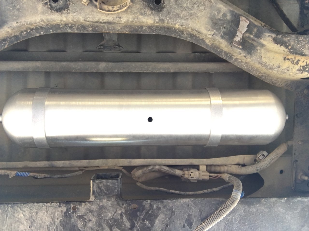

    Ordered a 4” seamless air tank, wasn’t actually in stock, so I had to go with a 5” tank. It doesn’t fit in the frame rails like I had hoped; possibly due to the lip on my slider frame brackets.
    Second choice was possible spare tire cross member; to low hanging fruit.
    Final option that should work well, mount to the under side of the bed behind the tire cross and infront of the bumper, win!
    I also ordered a water separator to be schmancy. Also need to figure out what ports are 3/8 and which ones are 1/4 FIP, those two are the worst to eyeball and be correct.
    Also, I’m not sure if I want to make a two or 4 legged air up hose system……..
    As of now I’m thinking of mounting the female chuck on my rear bumper right in front of the driver brake light 24F22118-AF8A-4FF1-925E-548168DB1C29.jpg

    Whats this cool set up for?

    Bags bro!!!
    Jk, for my air compressor setup/ on board air, maybe get super silly and do a train horn; front and rear tooters
