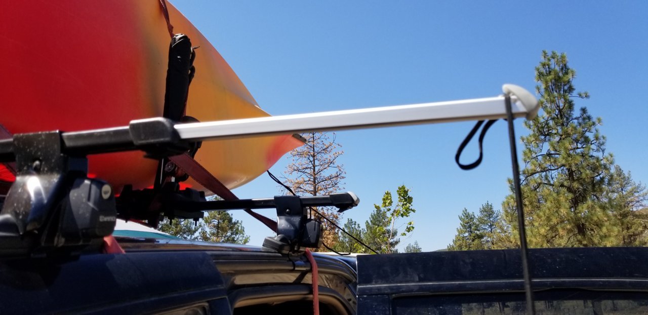

    Smart idea. You could use that to hang a light and illuminate a whole area. On my Inno, I got two of these bars that come out from the inside of the roof bars. I've thought about hanging a shower bag from them, but it'll probably be too much weight at full extension.
    They've proven to be very handy for drying clothes and hanging stuff like sunglasses and hats. I hung a light from them over the weekend and cooked underneath it.

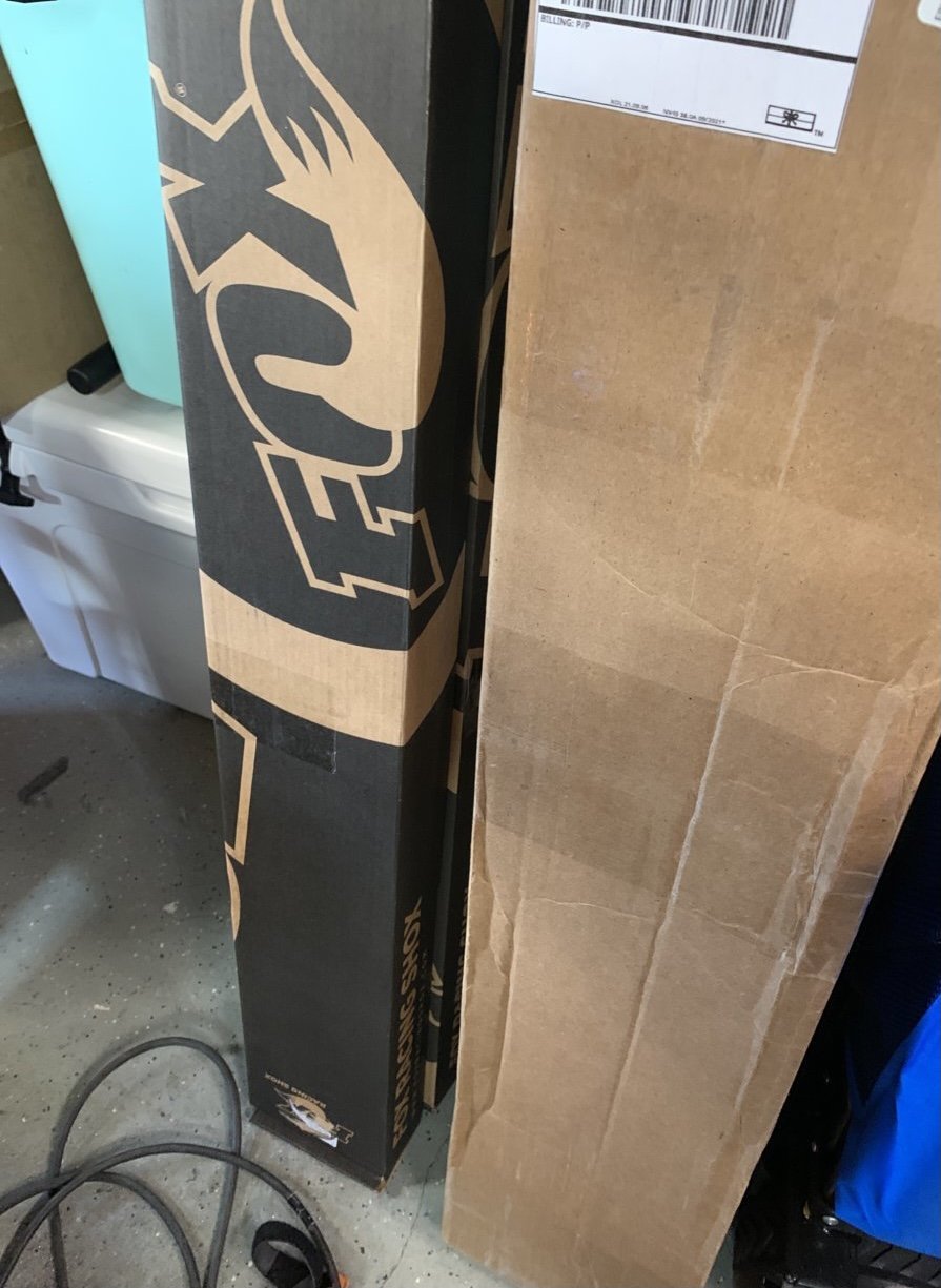

    It's good
    Still boxed…

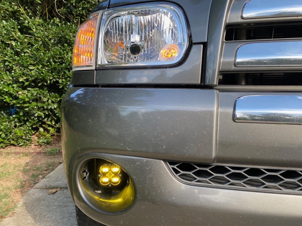

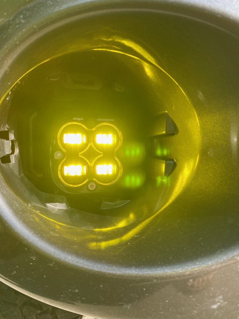

    Test fitting the squadron SAEs. They are such nice lights. Hopefully fog light blanks should be here next week and I'll be able to get those bolted on. Looks like I should be able to get a longer bolt and drill a hole in the back of the fog light blank to mount the stud. Then I'll route the wire through another hole as several others have suggested. I like the idea of reinforcing the bolt mount from the back with some aluminum flat bar, but not sure that is required. Will experiment.

    Good luck @Openbaffle .
    You'll need some way to keep the light in place so it doesn't move around and pop out. I had that happen on a trail and luckily the connectors are stout. That's why in the pics above I settled on using the bracket that came with the lights and just cut the blanks so that the light fit flush against it and fit in the slot in the bumper. The bracket is fastened to the light for adjustment and the bolt went through the hole in the bumper to hold it in place.

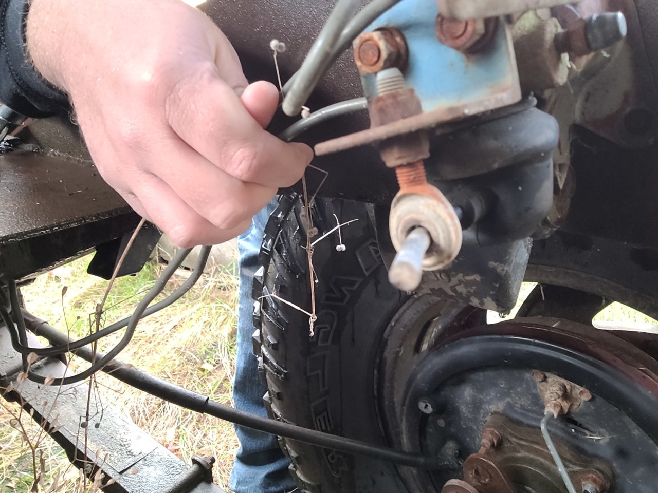

    Not on Tundra yet but on Taco I cut my rod and its ran through an adjustable mount, made a huge difference being able to change that when you start messing with the rear suspension especially.
    Bad shot and shit is neglected but you get point. Credit to BeefedTaco down in SD for figuring this out years ago.

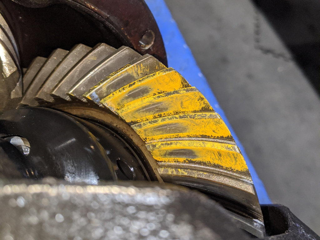

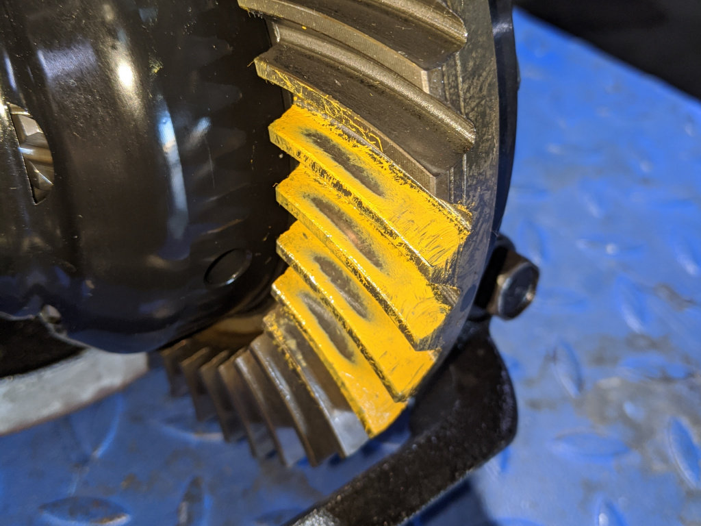

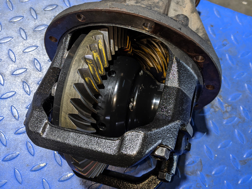

    Put together my 2nd diff finally. I've had the shims for the powertrax grip pro (torsen) LSD for a couple weeks now. Also did a solid pinion spacer and new OEM pinion seal.
    Drive side pattern:
    Coast side pattern:

    Looks a bit deep on the coast. Drive side looks better balanced. Good move grabbing a solid collar.

    Coast usually shows up looking like the backlash is too tight. This is due to the helical style cut of the gear teeth. It's mostly useful for double checking pinion depth.
    This is the gear set that came in this 3rd member so the pinion depth was correct. I just had to re-shim to set backlash with the LSD replacing the open.
