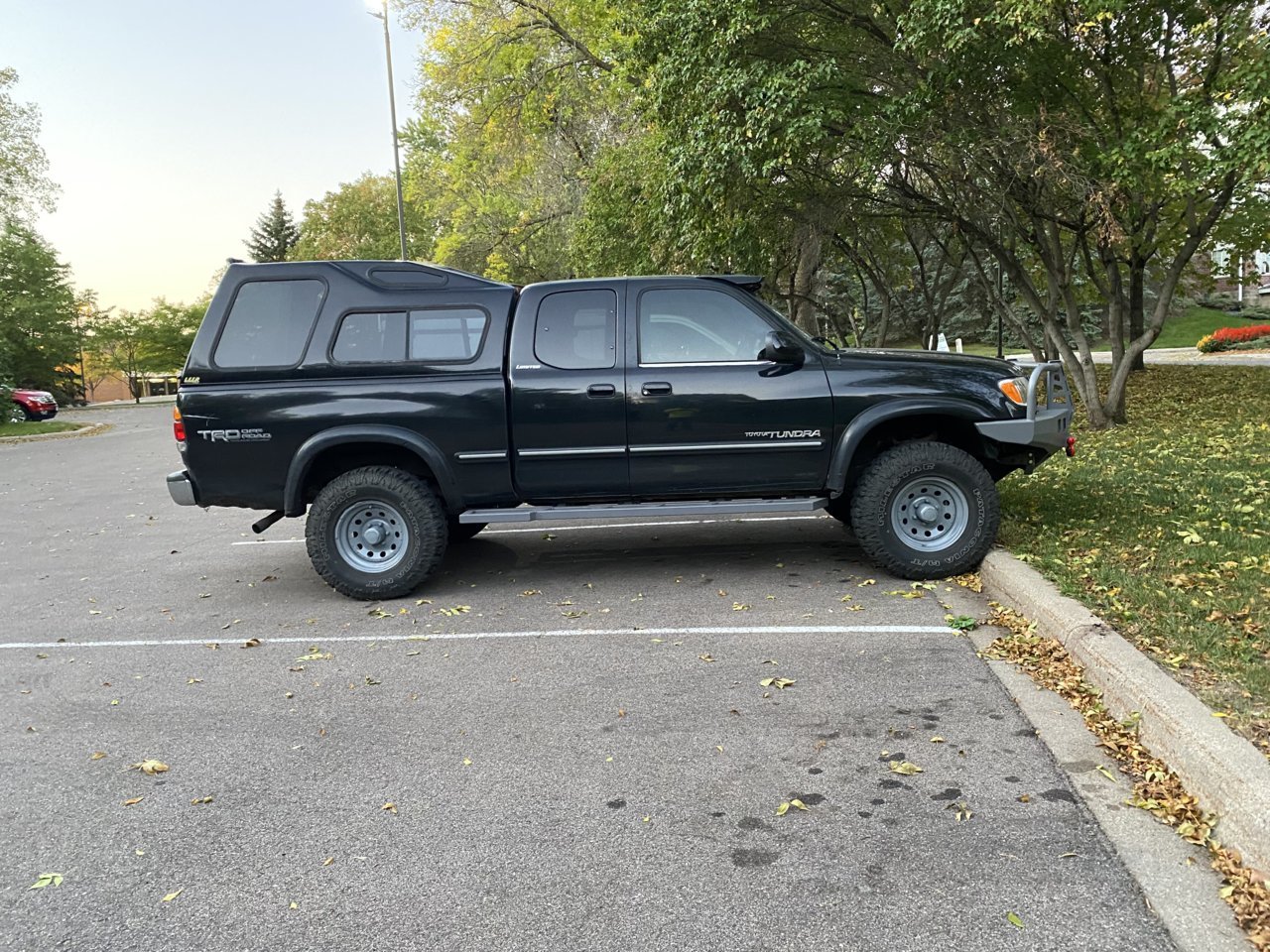

    I spy something different?

    New wheels? I know you've had that topper a while now.

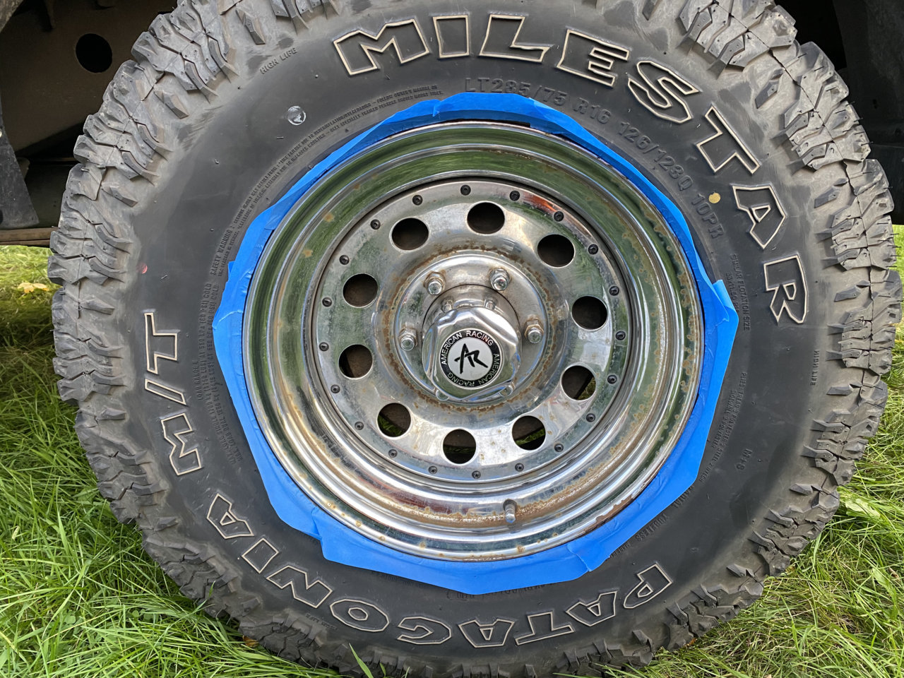

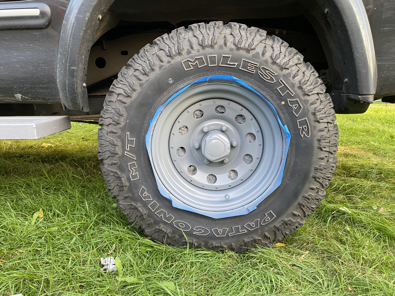

    Same wheels, new finish.

    Nice. What paint did you use?

    Rustoleum Enamel. I was trying to match the color of my bumper and sliders, and it is close, but didn't quite match.

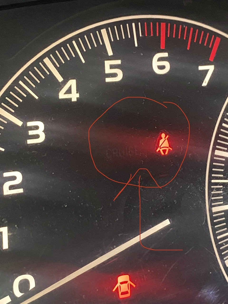

    Can either of you take a picture of the cruise control light on your sequoia instrument cluster? Apparently the sequoia is different than every other tundra cluster. I looked at it with the lights off and a flashlight and I see every light except cruise. Also found lights I didn't know I had :)

    Its green, it says cruise and i think its on the right of the dash. On an ‘04 sequoia. I’ll try to get a pic if i sober up.

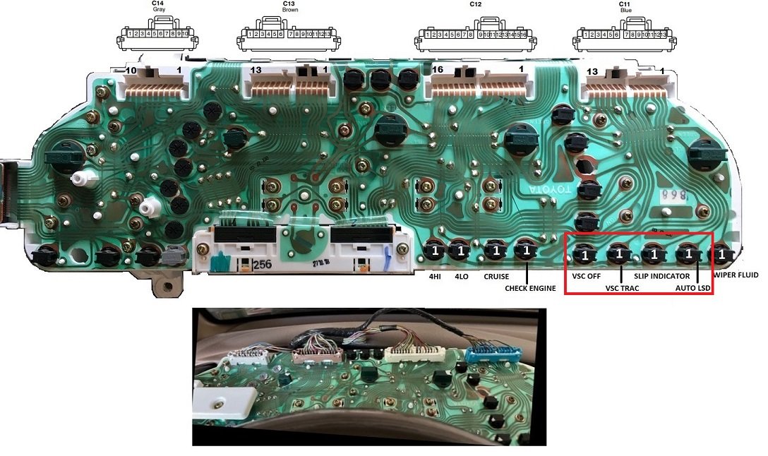

    Went thru the same thing when switching over to LED's. The red circled items below are not available on my 04 and determined that by following the copper trace from bulb to plugin and there was no conductor.

    I'll have to look to see if that wiper fluid bulb exists on mine. It never worked from the day I bought my truck new.

    Check to see if you have the float switch first. Should be right next to the pump on the reservoir.
    According to @Roman, and his infinite part link wisdom, my V6 should have it, but it doesn't. No float sensor = No light on cluster.

    My diagrams for the 02 v8 show the sensor being on the underside of the wiper fluid tank. I have to remove it to get to it I think.

    You can take a splash guard off on the pass side in the wheel well. I did that instead of removing the tank. To get to some of the bolts you'd have to take the splash guard off anyway.
    I checked my V6 about a year ago or so. No float sensor on mine, and no plug to add it.

    According to the 2002 EWD, washer indicator is C11 connector/pin 5. Your ABS light is C11/pin 6, so washer indicator then should be next to ABS light.

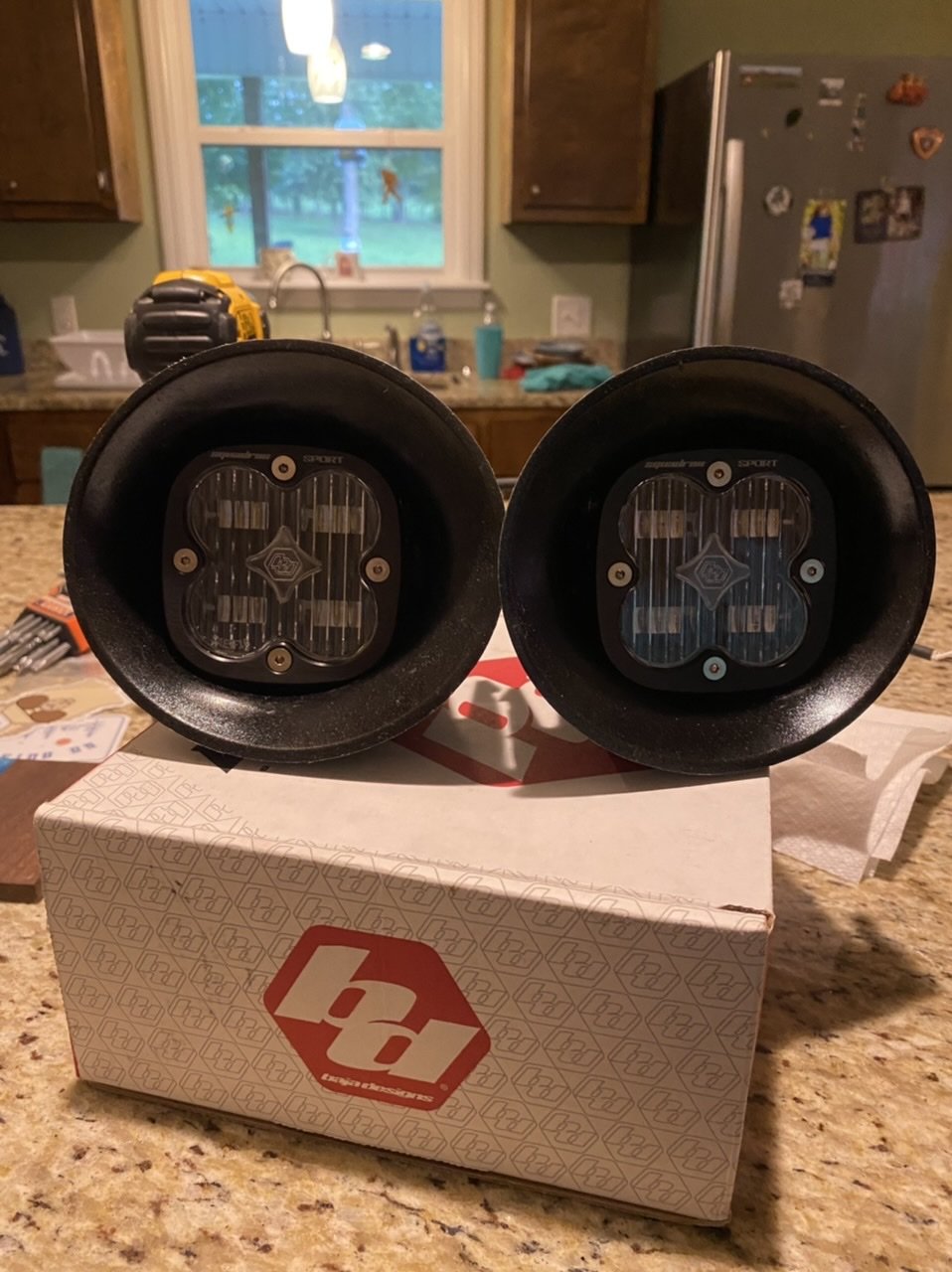

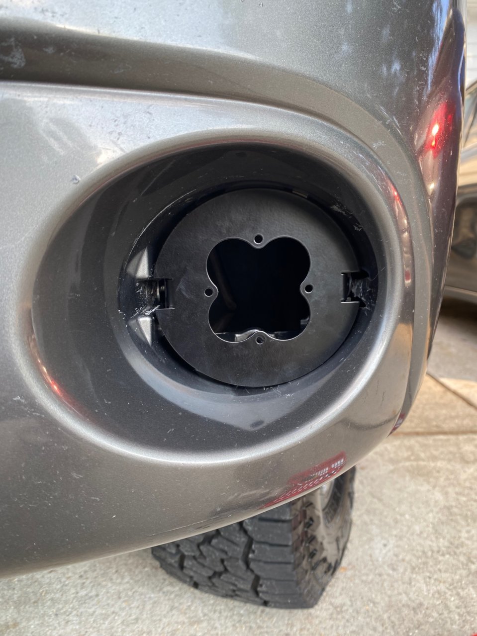

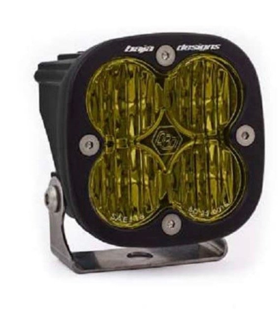

    Trying to fit a square peg in a round hole but I really want these Baja yellow fogs to work on my stock bumper. I have a buddy that is going to help me 3D print some plates to fill the gap and then try and mount the plates to the lights and bolt the lights onto the bumper with the existing stainless hardware. I do not like at all how the metal 2nd Gen Tundra/Tacoma brackets look or work. I know some have mounted them to fog blanks. Getting a bit annoyed and open to ideas. Maybe this is stupid.

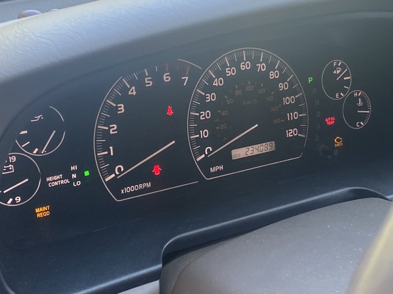

    @rock climber
    hey man this help you at all? This is on 07 limited sequoia
    This what your needing?From an 07 limited btw

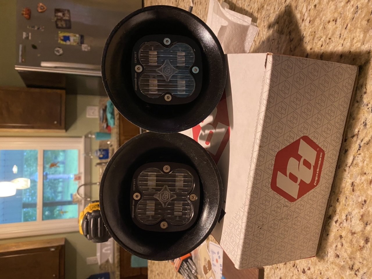

    The oem blanks make for a pretty good and solid setup.

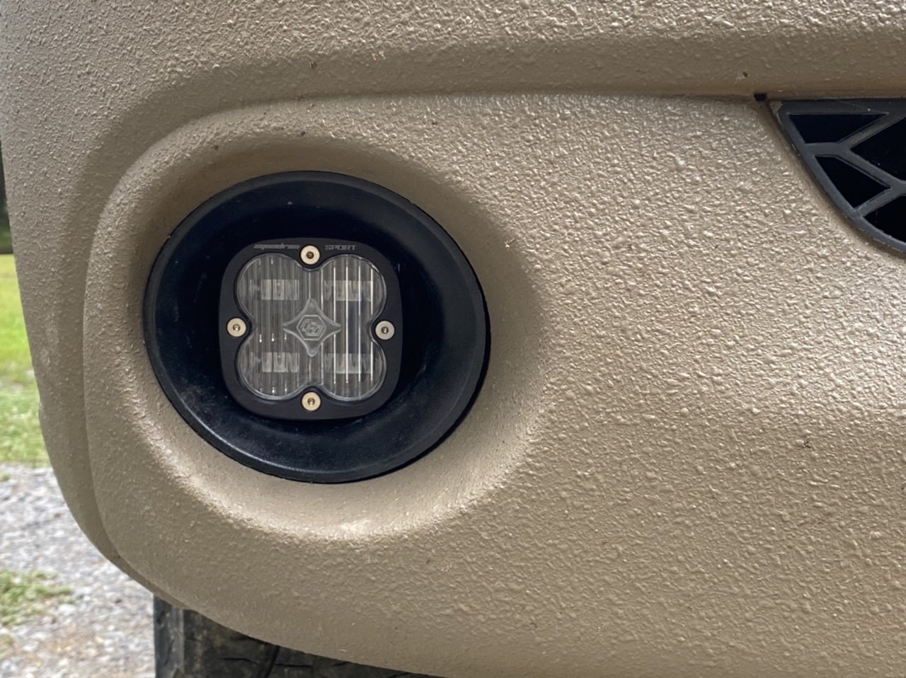

    @Openbaffle here is what I did with the fog light blanks. I managed to work the bolt through the oem fog light adjustment hole in the bottom of the bumper. Then put on a washer, lock washer, and nut to hold them in place.

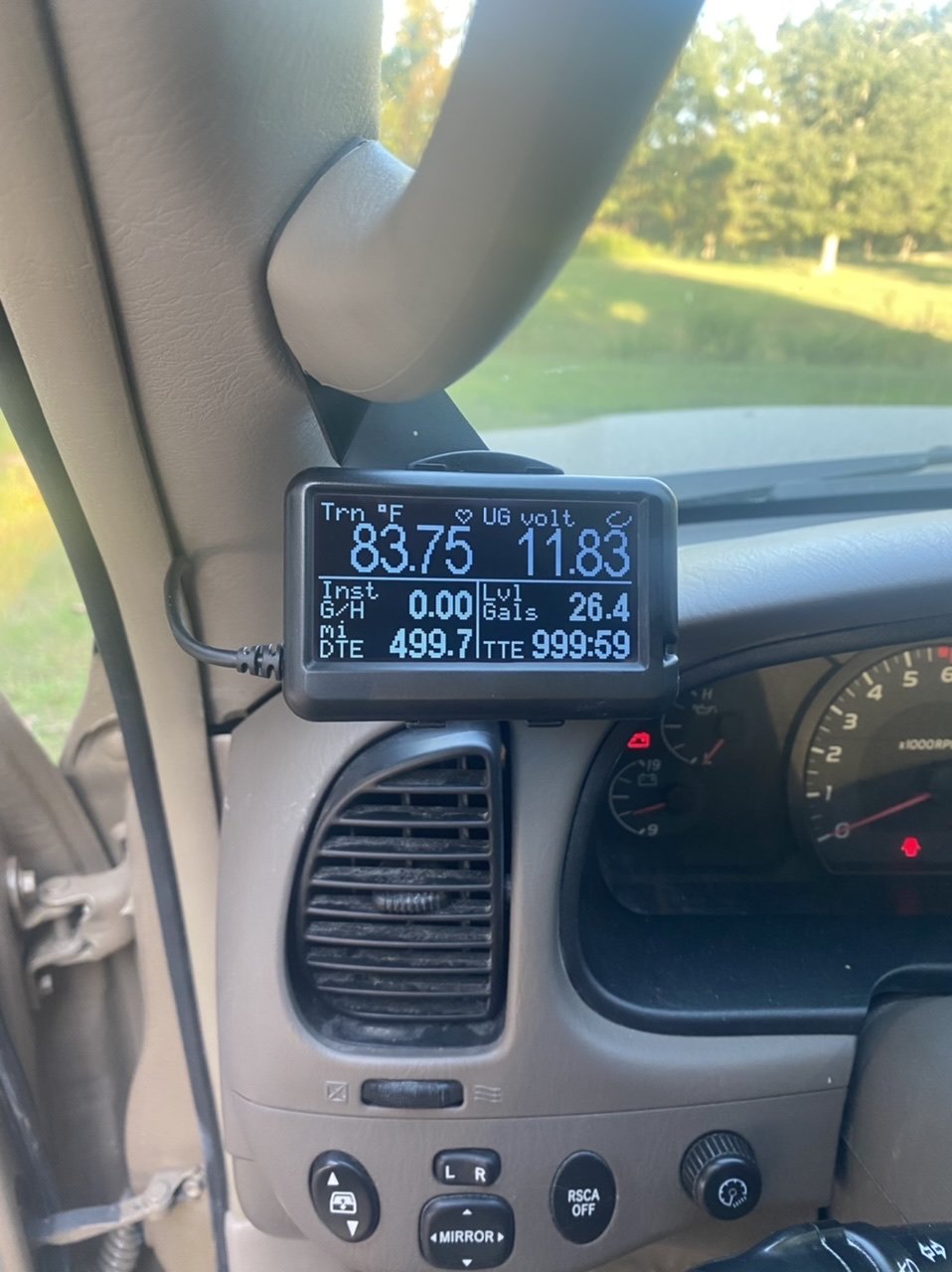

    dude I tried my mount today just to see what happens. Appears to be all good. Only difference is I went with the ultra gauge over the scangauge for aesthetic reasons

    So I could have gotten it to work, it was a tight fit going around the square rubber on the grab handle. My thing is where the mount sits on the A pillar isn’t flat, so the reveal left is ugly looking.99A7F625-91B8-406A-A393-E3C5EE0EF8DC.jpg

    I didn’t look at mine close that gap is there on mine now that you point it out. I cheated a little bit and took a pocket knife to the handle and shaved a little bit to get it up on there. I see that gap now. I guess I’ll wait and see what spiker says when they respond to the email.
    I just looked up the tundra mount, I’m not sure I like it any better lol. :monocle:
