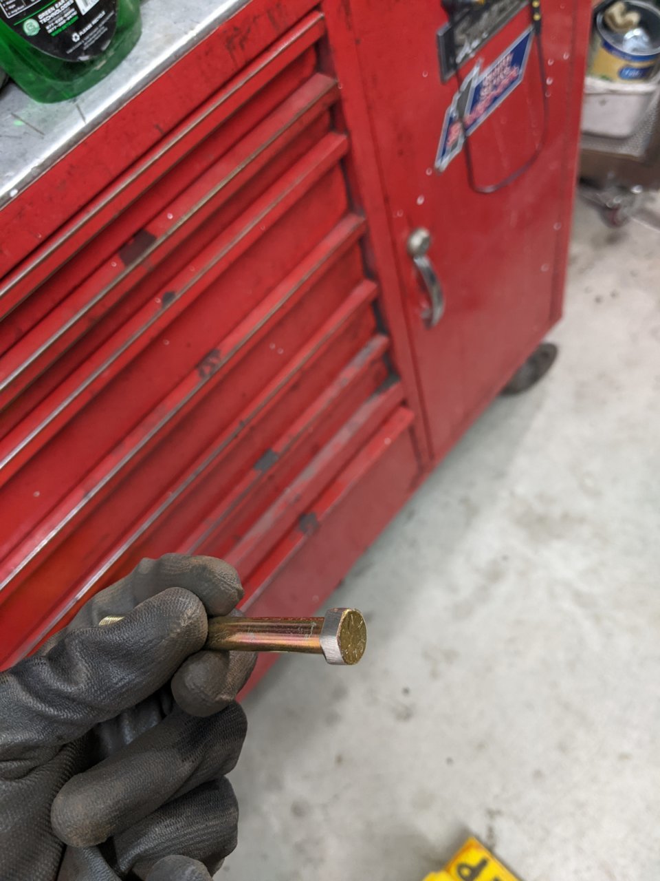

    oscardog86, abcinv, RUSTYNUTS and 7 others like this.

    I thought the breather was a one-way valve only to relieve pressure? i.e. not possible for water to enter the axle. Does anyone have links showing a case where water managed to get inside where a blown axle seal or similar was 100% not a potential entry point?

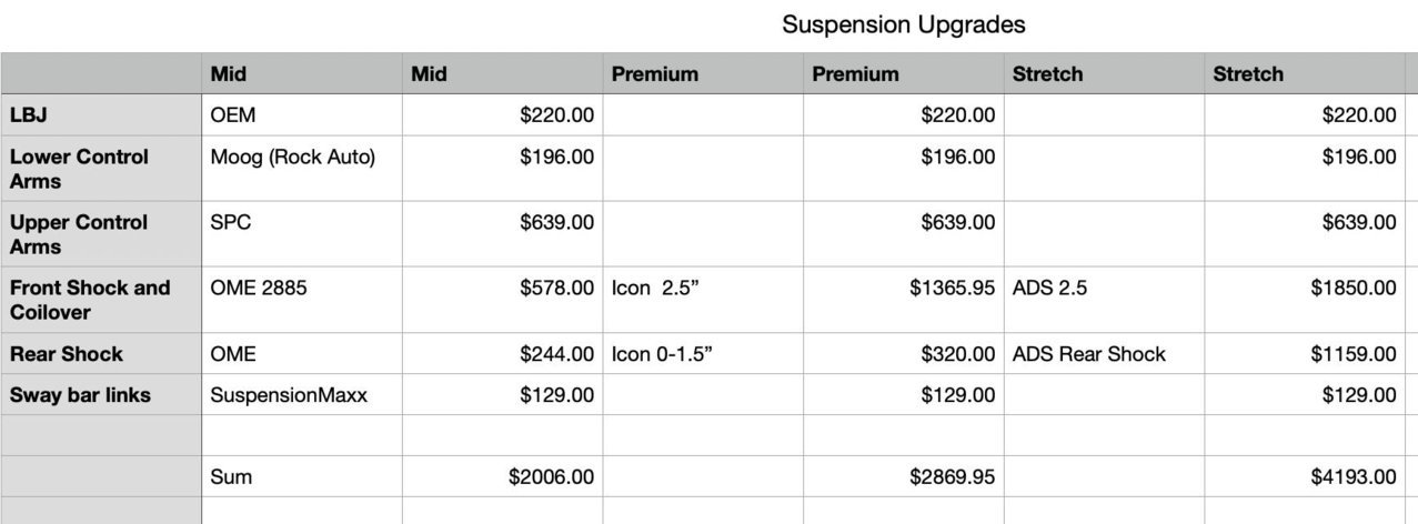

    Suspension upgrade research. I need to replace much if not all of it and have been procrastinating. Non OE shocks and springs all around that are completely worn out and my LCAs are seized and won't move. So not sure how crazy to go.
    Also ordered a nicer torque wrench today. Excited about that.

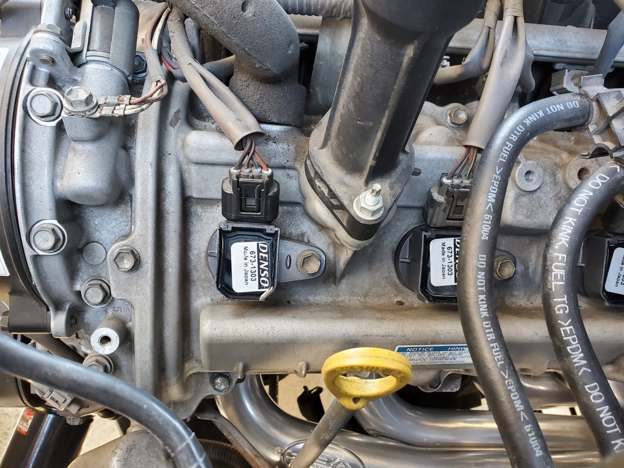

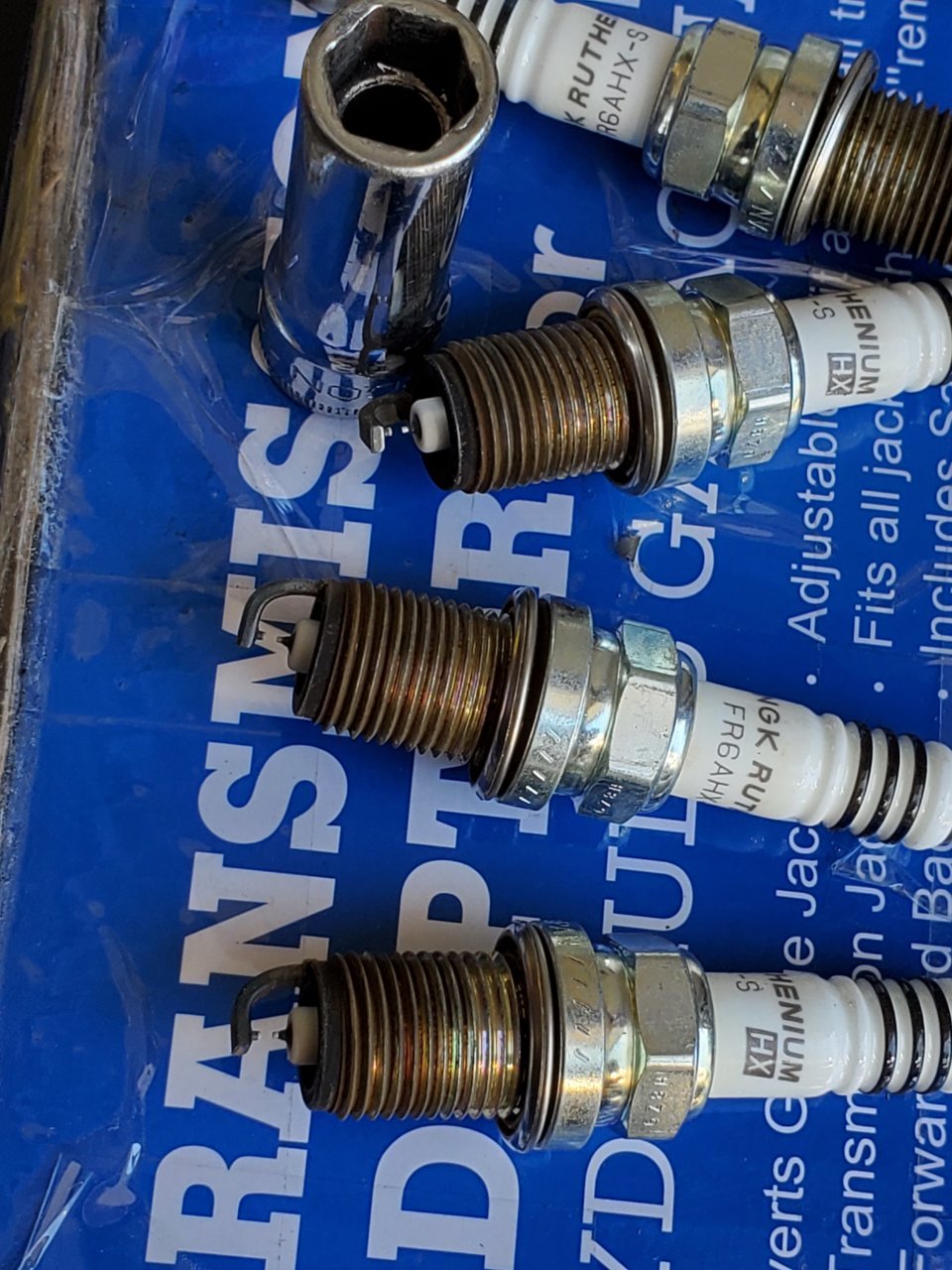

    Trying out these new colder plugs and OE Denso coils. Old ones in pics only had about 10k. Coils are Original (15 years and still strong) but decided new is always better
