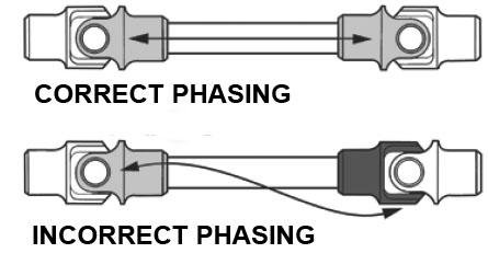

    Have you checked on the condition of your carrier bearing? Possible your driveshaft is out of phase?driveshaft01-2.jpg

    I just had the carrier bearing replaced and the dirveshaft balanced. That part should be good.
    I'll try out 4wd tomorrow and let you know.
    I'll give this a shot. I'll have to track down some weight. If it is the slip joint, what's the fix?
