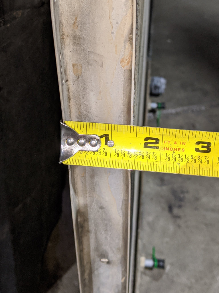

    Flushed the cooling system with 3 gallons of distilled water.
    Replaced thermostat (170°) and gasket. Since it was aftermarket the bleed valve was in the wrong place, so I drilled a 1/16" hole in the correct one.
    Replaced radiator with Koyo (same core size as OEM (1.4375").
    Added a bottle of Redline water wetter and 3 gallons of Toyota 'pink' coolant I already had in the garage for a few years.
    Old crusty t-stat:
    Old radiator, 15+ years of build up on it.
    OEM core measurement:
    Koyo core measurement:
    Also adjusted my headlights tonight since I didn't after leveling the truck last week.

    Was the radiator you send back a Denso? Price on the Koyo?
    Keep us posted on the Koyo temperature performance after a few runs.

    Yeah, thats an LS swapped 240sx drift car with modified knuckles for more angle. The camber is necessary for tire wear and contact patch at angle. It belongs to another guy in the shop.
    Radiator was some cheapo off ebay. They didn't list the core thickness so I bought it to see. And then returned it lol.
    Koyo is from rock auto, $136 + tax/shipping (and -5% discount) ended up being just under $170.

    Currently holding steady at 185-187° at idle with AC on in 75° temps.
    If it was gonna be 106° like earlier this week I'd be able to have a better idea of how it would handle idle heat soak lol. Only supposed to be 90'ish today.
    I do have a motorad 170° thermostat instead of a stock temp one now.

    With an ambient temp of about 106 today, these are my numbers at idle with the A/C on, was idling for about 15 minutes waiting for my kid. Pretty sure my radiator is original, planning on a preventative replacement in the near future. These numbers don't have me worried considering the climate and circumstances.

    I wish I had taken before temps of my truck.
    Still holding at 185-187° with 90° ambient temps (w/AC).
    Truck is an ice box even after idling 10-15 minutes.
