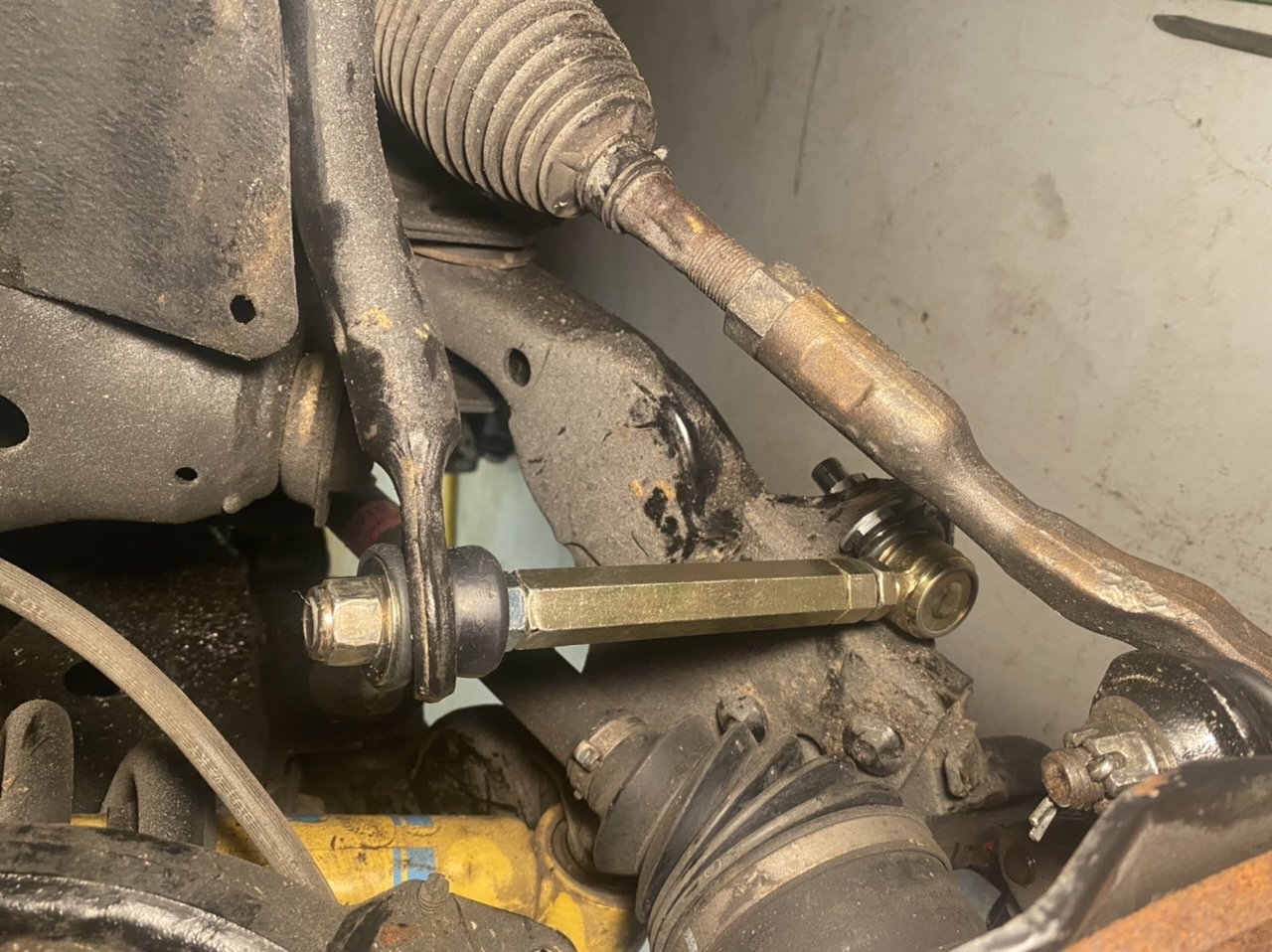

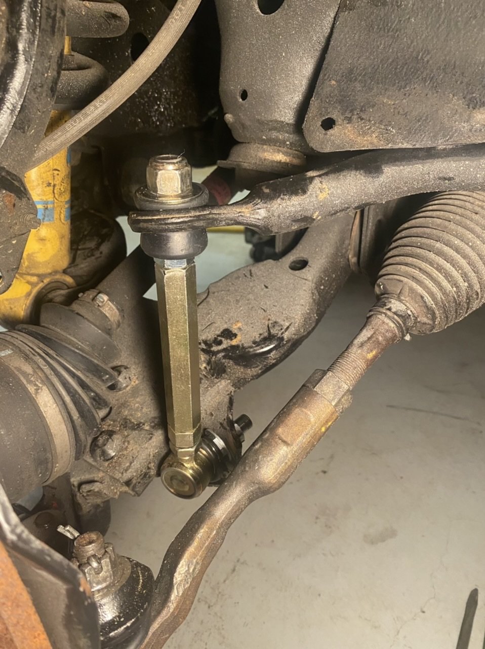

    New oem lower ball joints and overland custom designs sway bar links.
    *still a lot of fluid film last year left. Just gonna need a light touch up coat for the winter

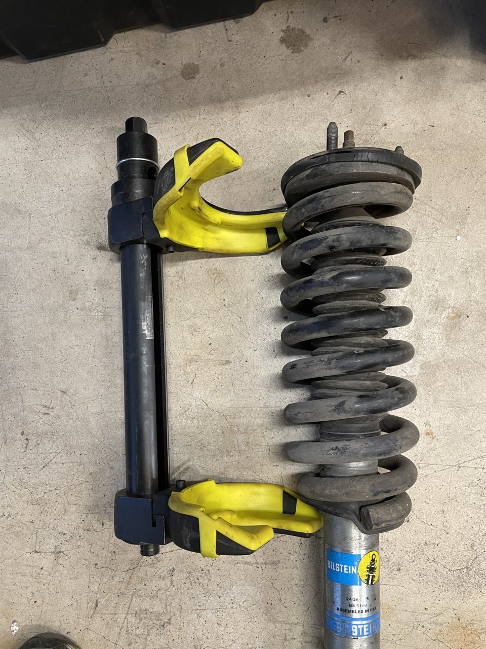

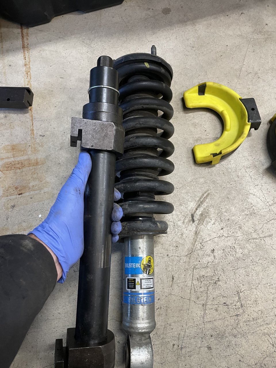

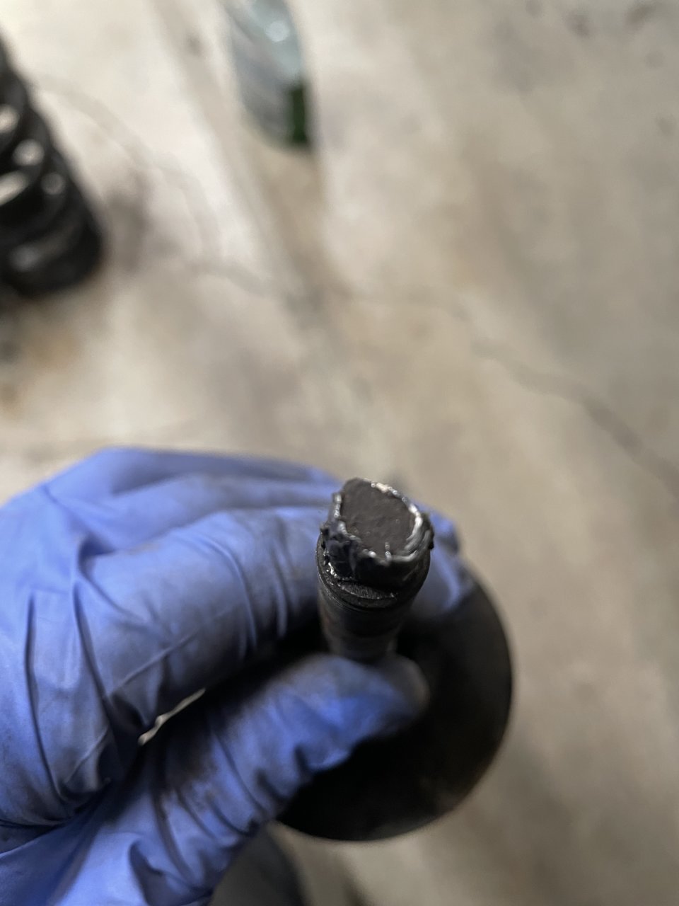

    Trying to swap out from coil springs. That stupid shock rod on the bilstein 5100 won’t stay still. Keeps slipping out of my channel locks. No Allen key hole.

    Are you able to weld an extension to the end of the rod temporarily to give you some leverage?

    No. No welder and I’m not one. I wanna reuse the shock though so I don’t wanna notch the rod. Maybe I’ll wait till the am. I put some pb blaster on it already.

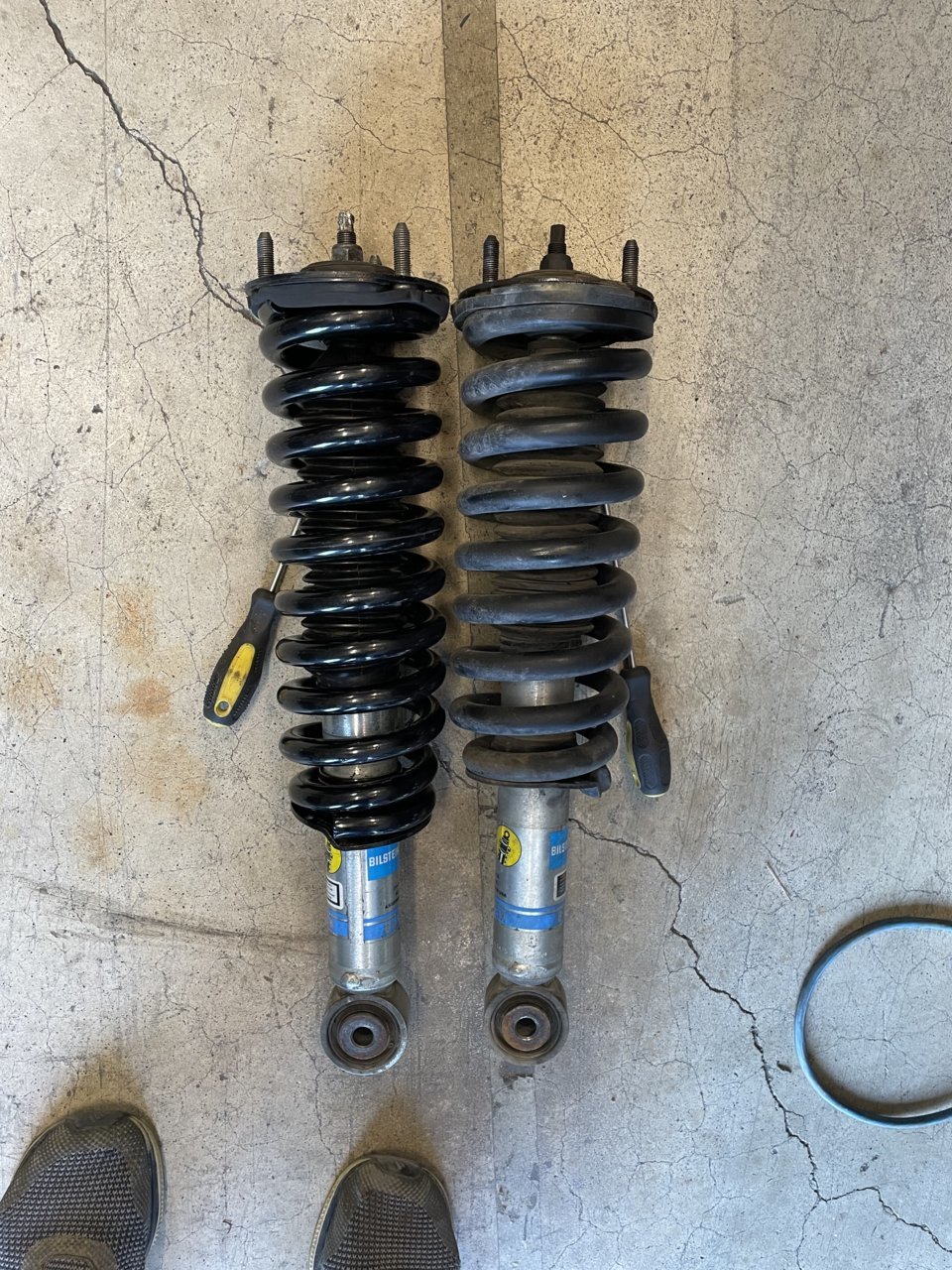

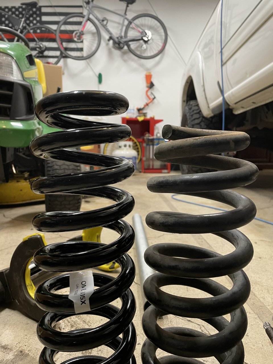

    So I was able to put the strut rod end in my vice and got the nut off. But what a pain in the ass!

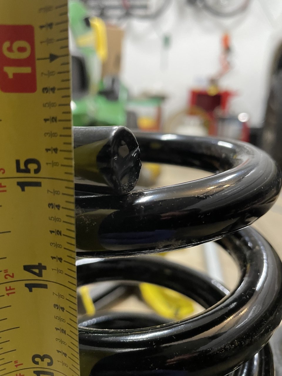

    I will reassemble tomorrow and cleaning everything up. I took some pre measurements as well. I’m on stock UCAs so I don’t wanna lift anymore than I have. I believe the general consensus is the very bottom notch with these 2885s. My current measurements were:
    Front hubs to fender
    21 3/8” driver
    21 1/2” pass
    Rear
    22 1/2” driver
    23” pass
    some pics to keep @bmf4069 at half chub. Check out my spring compressor. As thick as the strut lol! Not worried with this guy.
    Also took some measurements of the OME coils vs the stocks for you curious guys.

  12. Sep 7, 2021 at 7:28 AM

    Glad it worked out for you. I was going to suggest a vice with the end of the rod wrapped in a thin piece of rubber (like a jar opener) after the welding suggestion.

    Ok OME 2885 coils installed. Seems to ride smoother actually but initially I thought they would be a stiffer ride. I had the 5100s on the 3rd clip and went to the bottom with these 885s and pretty much kept the same height so that’s nice.

    #25441
    10,139

    The smooth ride is the best part of the 885s. Only an tiny bit stiffer than straight up stock. But extra height.

    yeah, after realizing that the coil is much longer and not as compressed as the stock one was it makes sense that the ride is smoother. Now it's on to rear leafs in the next month or so.

    I'm glad you posted this. I'm going to have to rethink my swaybar end link replacement choice. I have another company's set bookmarked but I'll have to compare now.

    I went with Maxxsuspension ones but honestly can't tell any difference. They are definitely more stout and more expensive so hopefully they last longer.

    I just need something longer than OEM due to lift. It may be Maxx I have bookmarked but that's at home on my laptop.

    almost bought the suspension maxx links like others mentioned. Overland custom designs has 2 different styles, the ball joints style and a uniball style. They’ve got an account here. That’s how I found out about them
