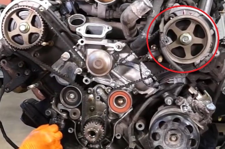

    For me it was less a hassle to remove the LH timing belt cover. RH cover access to certain bolts is more trouble IMHO.
    This was a 3 part series that was super helpful when preparing for TB change. This might not help much since the engine was out but at the 10:45 mark he takes off LH cover!

    Yep. I just checked my driver side and removed the 4 10mm bolts and pulled the plastic cover back a little to see the belt. I also turned the truck over 1 or 2 times to check different parts of the belt.

    That video is helpful. How soft is that plastic cover? Can I undo two 10mm bolts to see in, or am i going after that 3rd one lower down too?

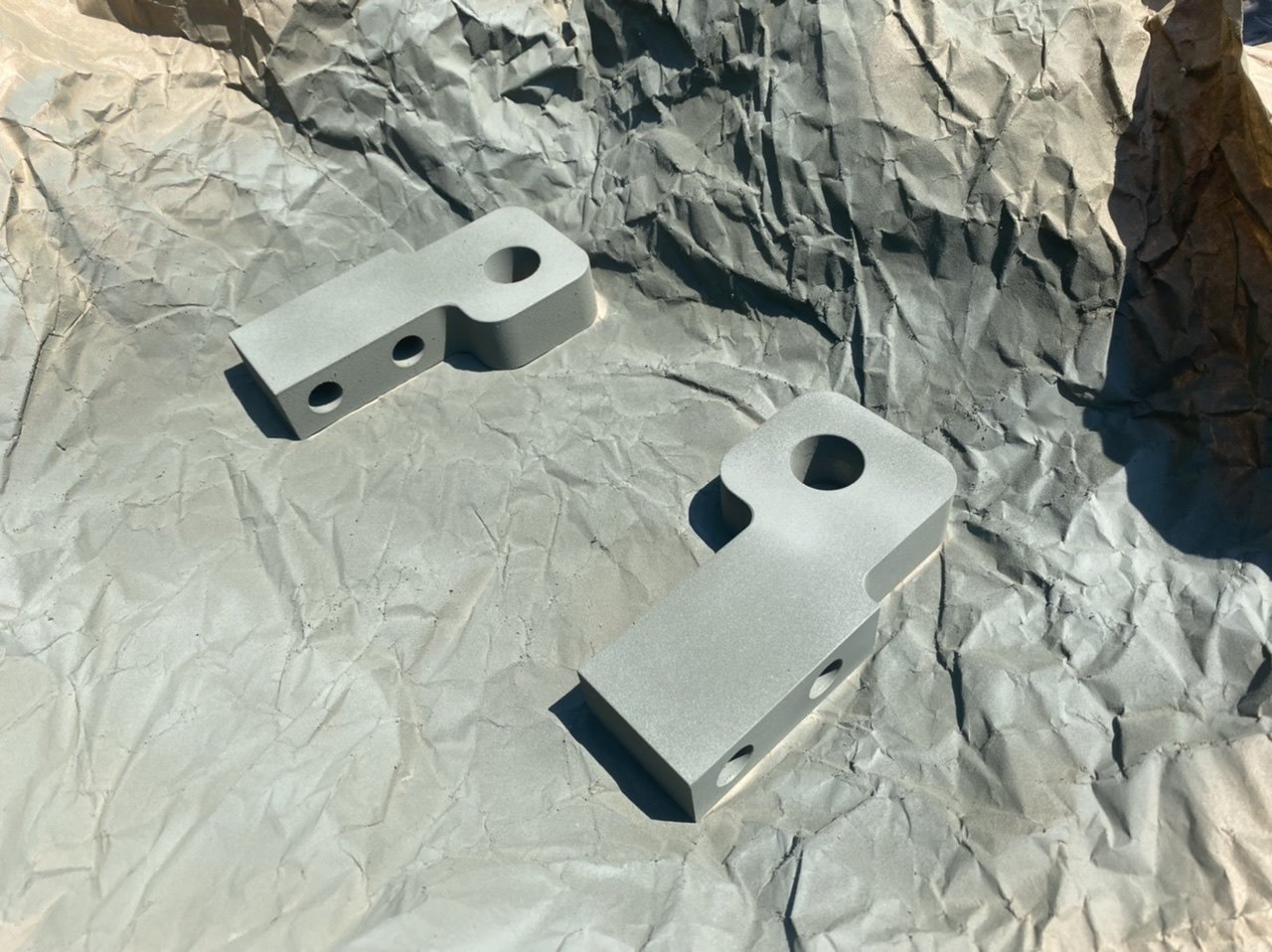

    Just shot some primer78A33D93-E8AB-4CBE-BEC4-21420D3B1A0F.jpgB678F233-E73E-431D-86F5-13D97C190071.jpg

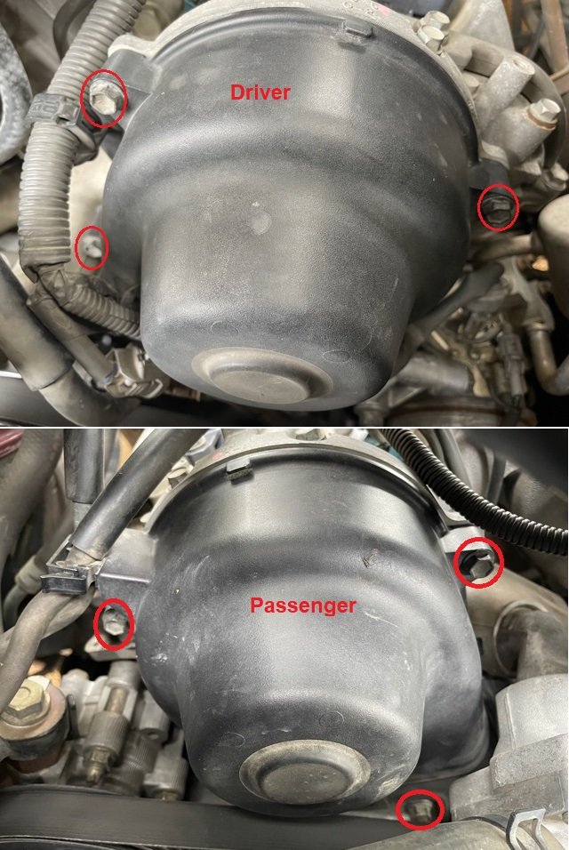

    Personally, whichever side you choose to do, you can be the better judge of which is the easier. The bottom right nut on passenger side is not easiest to get to but you be the judge....to each their own ! As for the cover, it's fairly sturdy plastic.
