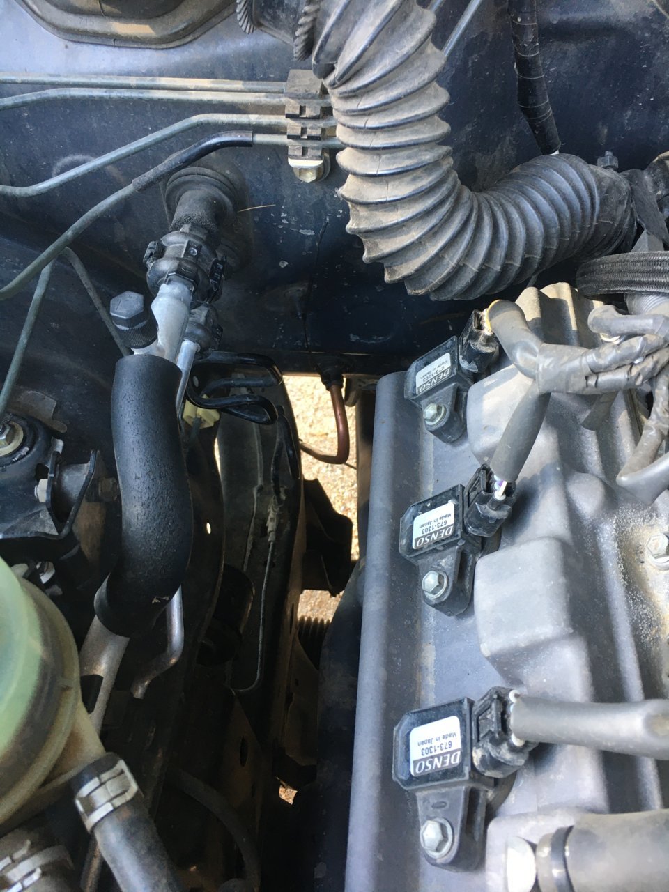

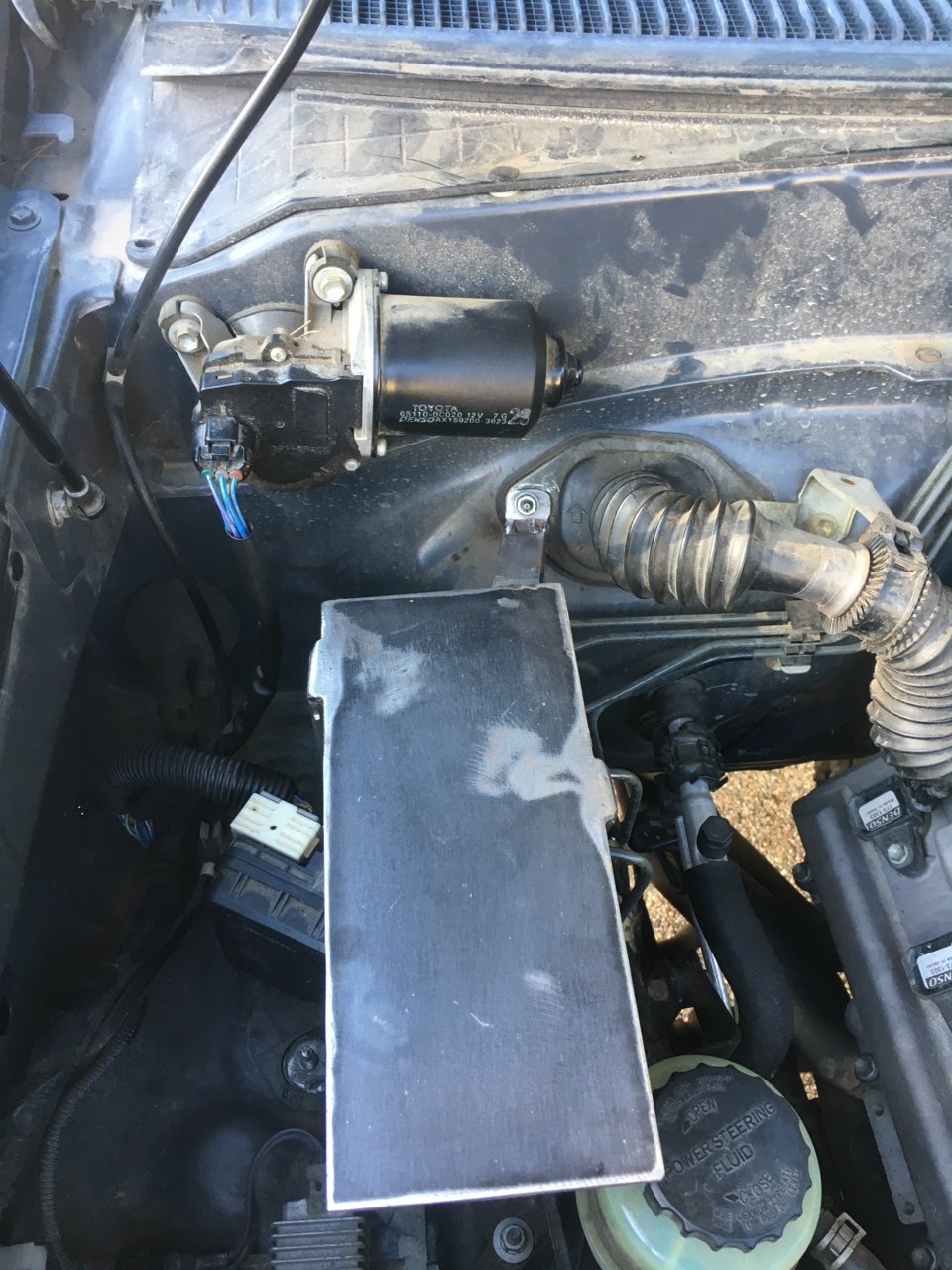

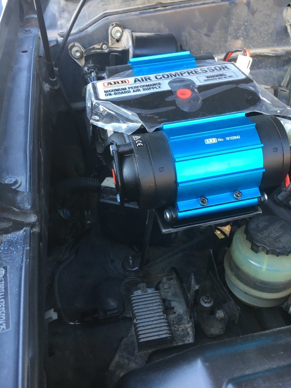

    The SoAz….. big surprise
    Bone stock
    Also, our frame rails look perfect to get a long air tank mounted into!
  2. Sep 2, 2021 at 4:58 PM
    daveeasa
    Dec 2, 2020
    #55605
    4,181
    David
    Give me some hot air you toasty Frenchman.

  4. Sep 2, 2021 at 6:40 PM
    empty_lord
    Feb 1, 2019
    #25441
    10,125
    Dan
    Indiana, Chicagoland
    05 rollover special
    Reg and access cabs are different I’m afraid

  5. Sep 2, 2021 at 7:01 PM
    daveeasa
    Dec 2, 2020
    #55605
    4,181
    David
    I did spy some bolt holes and heaps of space. Seems doable. Maybe a totally different bracket I suppose? It’s a great spot for a compressor

  6. Sep 2, 2021 at 7:10 PM
    empty_lord
    Feb 1, 2019
    #25441
    10,125
    Dan
    05 rollover special
    I’m not sure the complete body differences. But I think our overall engine bay height is shorter. Which would mean anything he installs there likely will contact out hoods

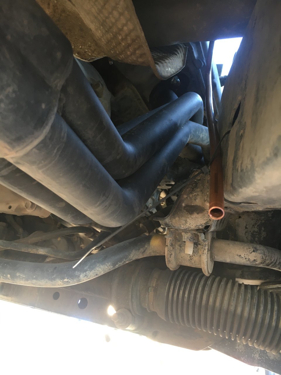

  13. Sep 2, 2021 at 8:00 PM
    NUDRAT
    NUDRAT 6 lug life
    Dec 7, 2018
    #22736
    3,317
    SW CT
    Between 'Ridgelines'
    Won't copper cause steel (your frame) to corrode? Be a shame if so.
  14. Sep 2, 2021 at 8:08 PM
    FrenchToasty
    Sep 15, 2019
    #36156
    18,354
    Mo
    Bone stock
    i was going to throw some heat shrink where it touches only for noise reduction.
    I couldn’t imagine it rusting more than constant water dripping onto metal. Not to rub it in, but we don’t rust here

  16. Sep 2, 2021 at 9:24 PM
    NUDRAT
    NUDRAT 6 lug life
    Dec 7, 2018
    #22736
    3,317
    SW CT
    127.pdf (grabberman.com)
    Galvanic Reaction.
    Galvanic Reaction: Incompatible Metals Responsible for Corrosion - Monarch Metal
    Most commonly, galvanic corrosion can be seen in plumbing systems where a copper pipe is directly connected to a steel or iron pipe. Once in contact both metals can undergo galvanic corrosion because of the electric or galvanic current that takes place at the anode and cathode of the pair of metals.

    From my experience copper gets the damage from that. I've seen many a pinhole and yards of green pipe from landscapers using galvy nipples to add sprinklers on copper water systems. Never seen the galvy damaged from it. His frame should be painted and if he shields the copper it should be fine.

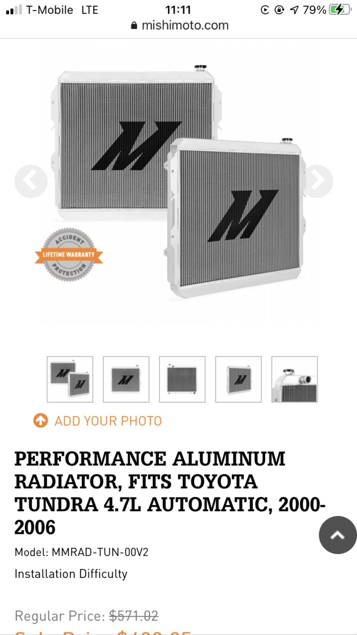

    I thought the Mishimoto doesn't have a trans cooler? That would be a hard pass for me.

  23. Sep 3, 2021 at 1:06 PM
    assassin10000
    assassin10000 New Member
    Oct 27, 2020
    #54157
    2,199
    Andrew
    Northern CA
    '05 SR5 AC
  24. Sep 3, 2021 at 1:09 PM
    FirstGenVol
    Dec 13, 2018
    #22934
    14,151
    East TN
    2002 AC TRD 4x4 V8
    Perhaps they changed it since @empty_lord mentioned it a few times. If so, that would be great.

  27. Sep 3, 2021 at 2:15 PM
    jImmegart
    jImmegart Second Youngest tundra owner in the west!
    Apr 8, 2019
    #28798
    930
    Jonah
    California
    2003 Tundra TRD Sport
    FN Counter steer type X w/ 285/70r17 Geolanders JBA y-pipe and pro street 6000 muffler 2.5 king coilovers w/ total chaos uca and custom 2.0 king rears Skidrow front plate TRD Sport package W/ Factory rear swaybar and LSD
    Isnt the trans cooler externally mounted?
  28. Sep 3, 2021 at 2:17 PM
    FirstGenVol
    Dec 13, 2018
    #22934
    14,151
    East TN
    2002 AC TRD 4x4 V8
    Yes but the radiators in our truck still help I guess. There are trans lines that run into the bottom of the radiator.
  29. Sep 3, 2021 at 2:18 PM
    Tundra2
    Tundra2 Zoinked
    Feb 10, 2019
    #25875
    12,415
    Noah
    Western Kentucky
    It runs through the radiator as a warmer before it goes to the cooler behind the grille.
    That's how the lines are on the RC anyways. I plan to bypass all that like I did on the V6.

  30. Sep 3, 2021 at 2:51 PM
    Sirfive
    Sirfive Master Procrastinator
    Jan 24, 2021
    #58078
    4,835
    SATX
    ‘02 Limited AC TRD
    Bassani cat-back
    The trans line in radiators isnt really a cooler. A little, but its meant to get trans fluid up to temp.
