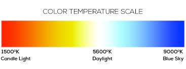

    65k is the weird color I believe, stick with 5 or 5500k

    2500-3000k is gas lanterns yellow, 8000 is nuclear blurple laser photon color. 3500-4500 is a brighter whiter light. 5000-6000 is brighter and starting to get a blue hue to them. Above 6000 the colors start to get psychedelic and belong in those Carolina squat mobiles. Maybe they are aiming them at the sky to communicate with aliens on their wavelength?

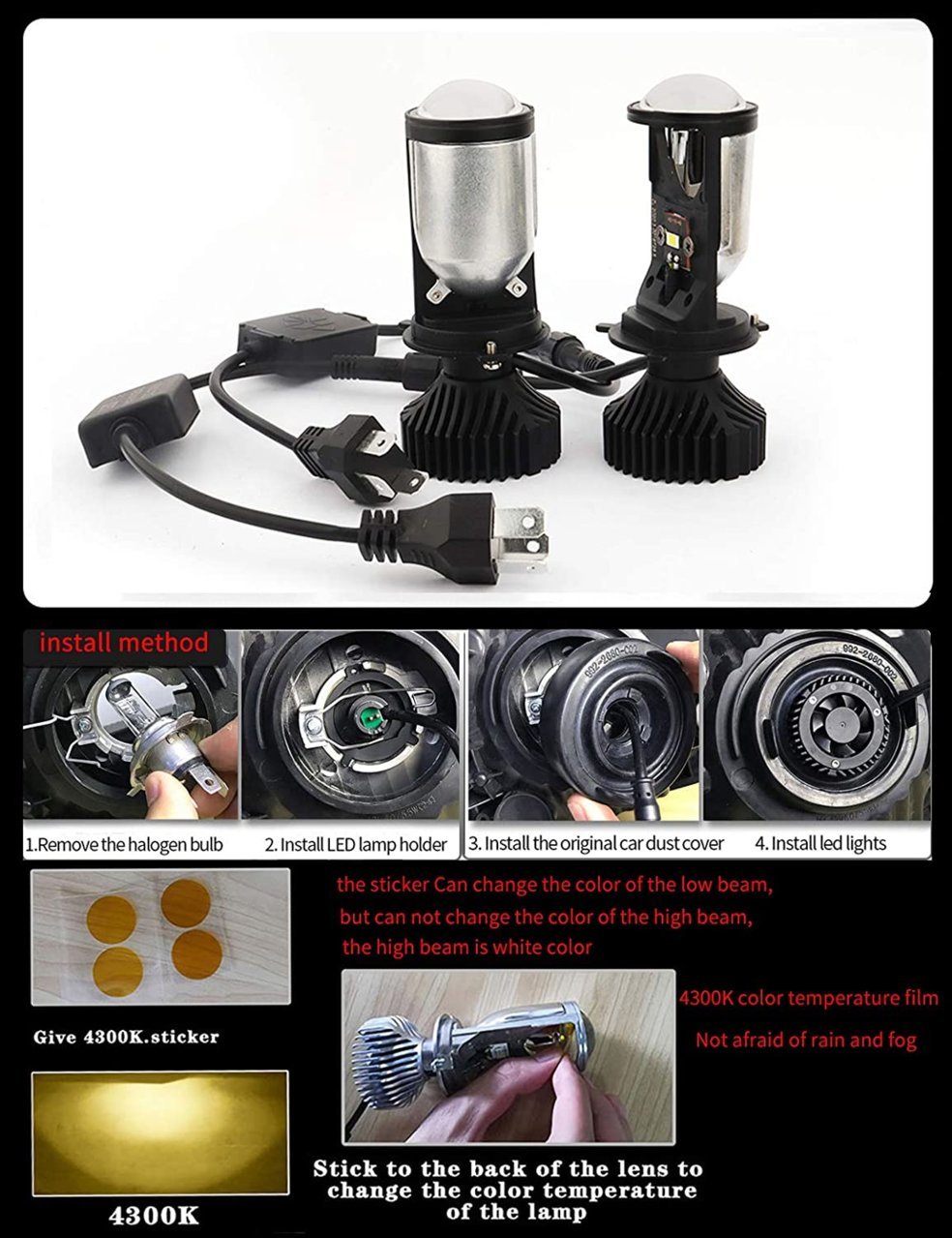

    I've been eyeballing those for a while, but have two concerns. They are 6500k color which to too blue for me. Also, 4500k to 5000k is the sweet spot for actual visibility, as the color gets higher on the scale it actually gets dimmer. https://www.youtube.com/watch?v=8v4QgnPLjVU
    Second is in colder climates like Colorado, the led's don't get warm and melt snow off the headlights. That's why morimoto came out with led bulbs that blow the heat onto the headlight, but these don't have that feature.
    I just ordered the full D2S HID retrofit kit for those reasons.

    Some of those lights come with a small sticker you can put on the project that changes the color. Maybe you can find just the sticker.

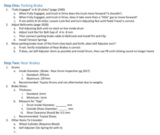

    These brakes can be incredibly frustrating. The fronts are too simple to fail aside from a sticking caliper. If the MC, booster and ABS are fine, which they probably are, then those rears are where the issues lie. If the rears are dialed in, the fronts behave much better. Good luck with this!

    I would like to replace some of the rear components this year, at least the springs and star wheel's. They are not self adjusting like they should. The shoes have a lot of life left.
    That said, I recently jacked up the rear tires and adjusted the shoes until I could both hear and feel the shoes dragging when I spin the tires. I don't know what else I could do back there. I've tried moving the LSPV all the way up and down, and each place in between and I can't tell a difference.
    I can confirm that after I drive the rear drums are HOT. If there is anything else I should do back there I'm all ears at this point.

    How's the parking brake adjustment? The parking brake adjusts the lower part of the pad, the starwheel the upper. If your parking brake isn't working, it's a sign that there's some adjustment needed there.

    The parking brake actually works very well. I took some of the slack out last year using that turnbuckle under the cab.
    @jpink is working on a brake troubleshooting guide. I think my bell cranks may need adjustment.
    He made this.
