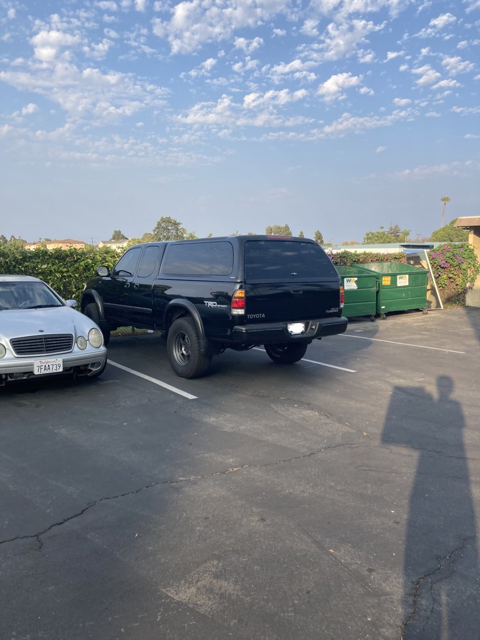

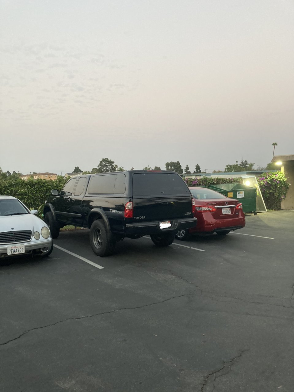

    Got these Depo 05-06 tails today. Quality and fitment are pretty good, though the driver side tail doesn't fit quite as good as passenger. I originally wanted to keep stock harness because of the 3rd brakelight and reverse camera splice but not sure if its these repro’s or factory but the factory harness nor bulbs would fit in the new tails. So It gave me the opportunity to rewire the 3rd and camera with new harnesses.
    F9062A77-D03C-4638-A6B3-96005BB3BC83.jpg EE9385AA-5658-40A8-8CDB-2E95A66F7DB3.jpg 27C4984D-1029-40CB-ABCF-5224D119D526.jpg 98056F43-46B9-4FE7-8022-0B5620A4C0A4.jpg
    definitely gives it a more modern look which I like, just dont like them not being OEM. Maybe if I come across some money Ill buy oem ones but for now they’ll do.
    7.5/10

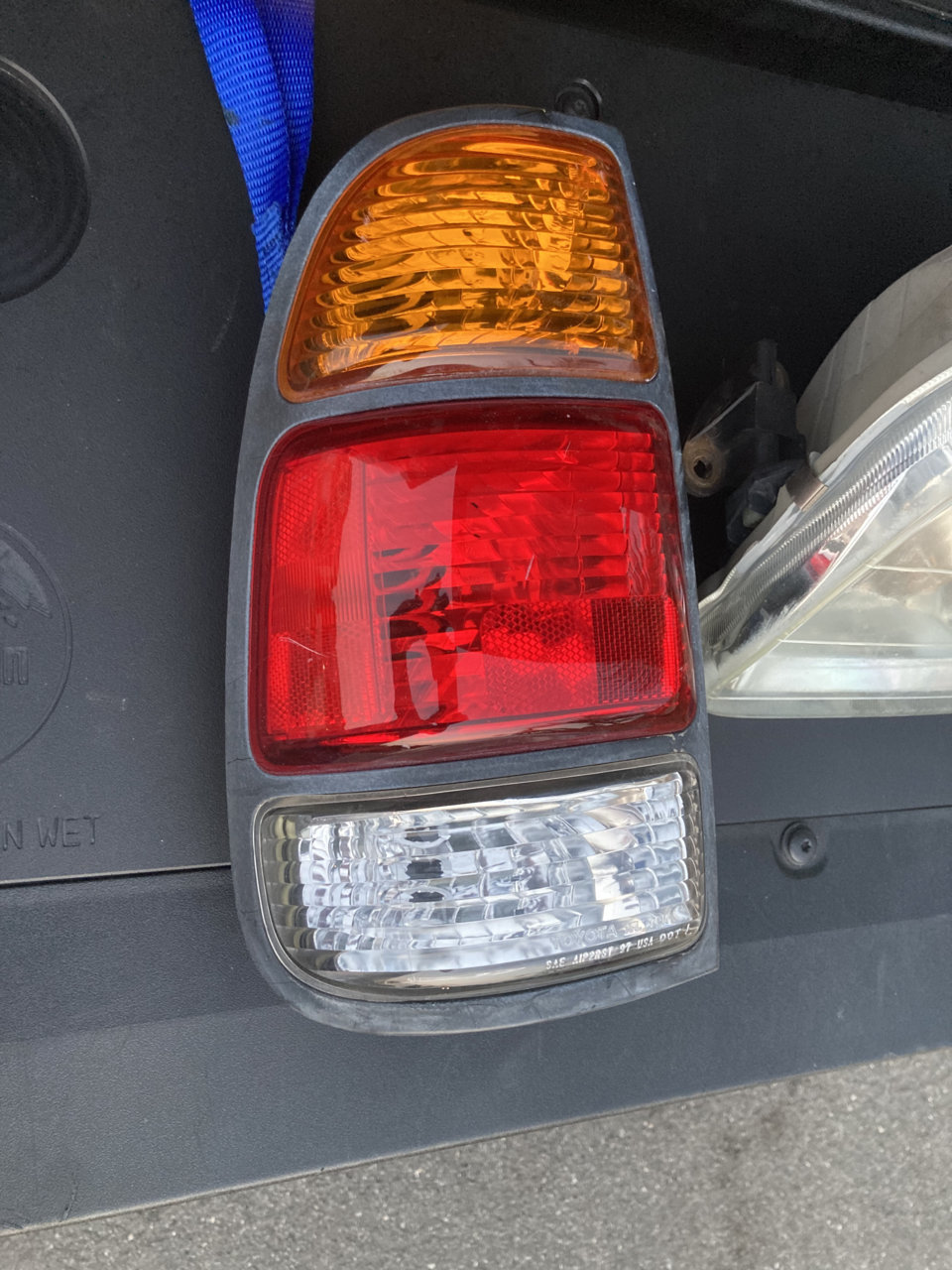

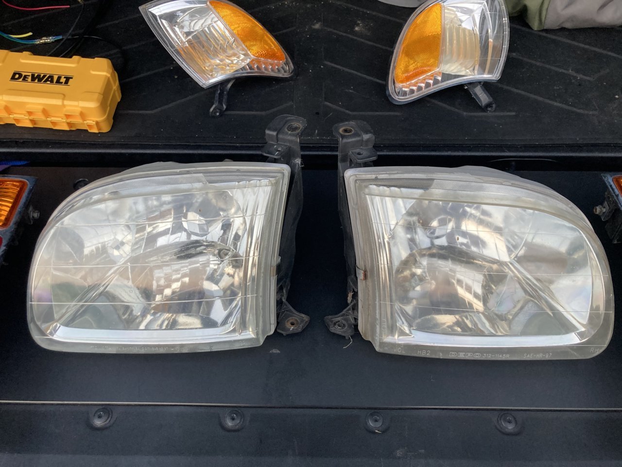

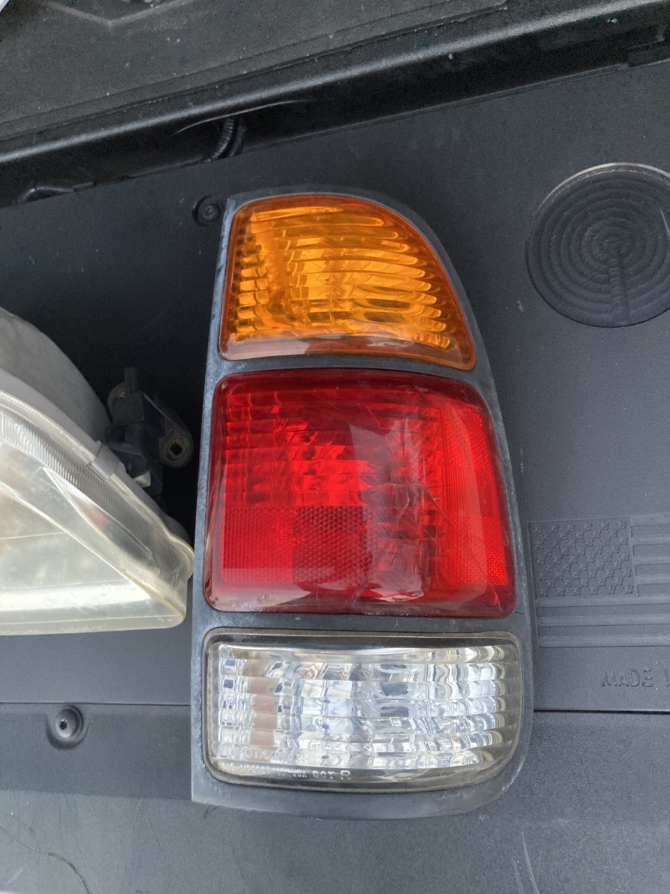

    Nice! I’m in exactly the same boat. Pulled all 6 today. One is a Depo, small hit to the driver side fender while the other guy owned it. The others are all OEM. Dunno what my plan is.
    5D301566-061E-4146-9EE1-1136B6CF836C.jpg F521EA0F-CCE0-41B9-8622-10FB344D5751.jpg B5C00086-066F-4CAF-A278-9C71B6FD40FD.jpg

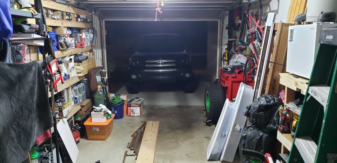

    Got to see that weird led light in action in my garage. Fawking blinded myself again looking at it. I never learn. Its pretty damn bright in here, no dark spots other than the shadow my door is casting.
    Here is the box if anybody is interested.

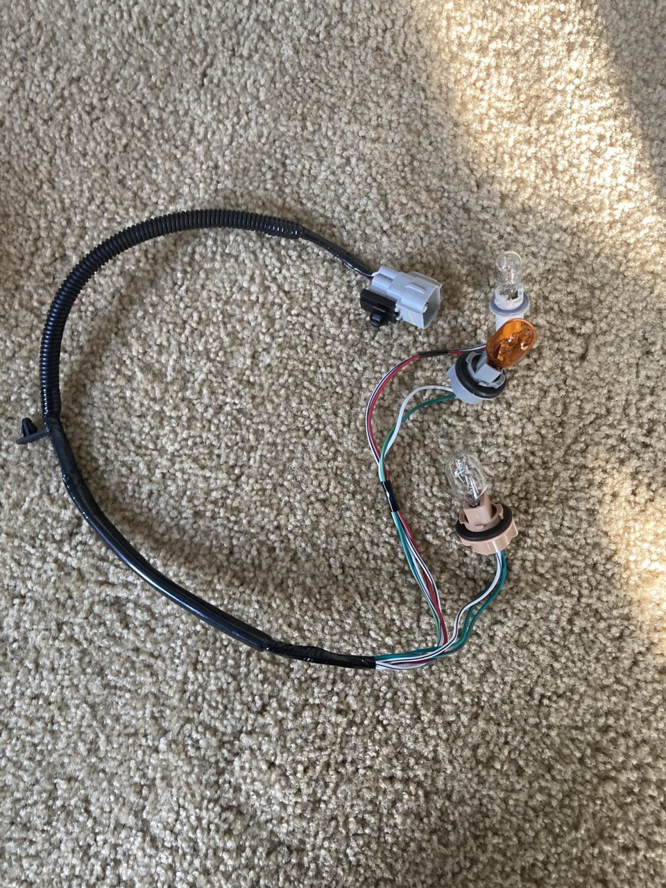

    Im not sure. Technically they are plug n play, but you have to pull the old tail light harness, which uses the same connector. Maybe oem tails use the same size bulbs and are interchangeable but mine was not.

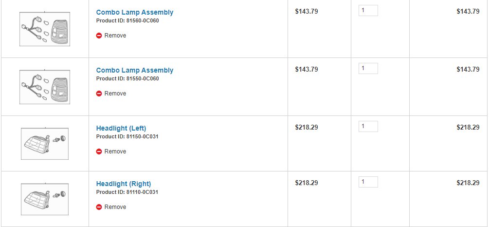

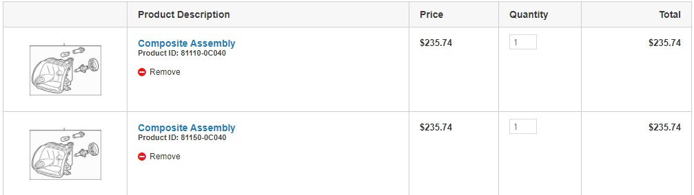

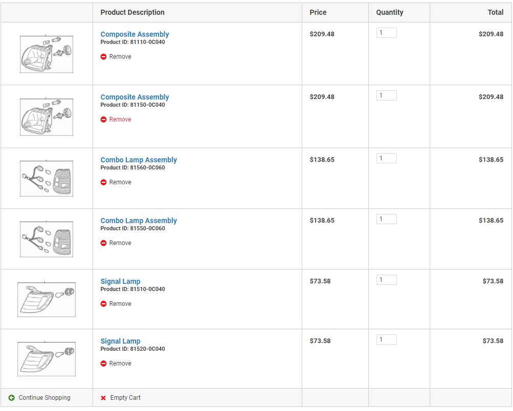

    OK, if going to 2005 heads and tails, I think these are the correct tails but I think the headlights are DC, still hunting for RC/AC '05 headlights.
    I'm guessing probably these labeled "Composite Assembly"?

    What year is your truck? AC/DC headlights and tail lights are not interchangeable.

    Yep, understood. I'm 2002 but Dan said to go 2005-2006 on headlights and taillights. I'll have wires to deal with I believe, that part I can handle. From the photos it looks like things should bolt up OK if I do indeed have the correct AC/RC headlight parts here:

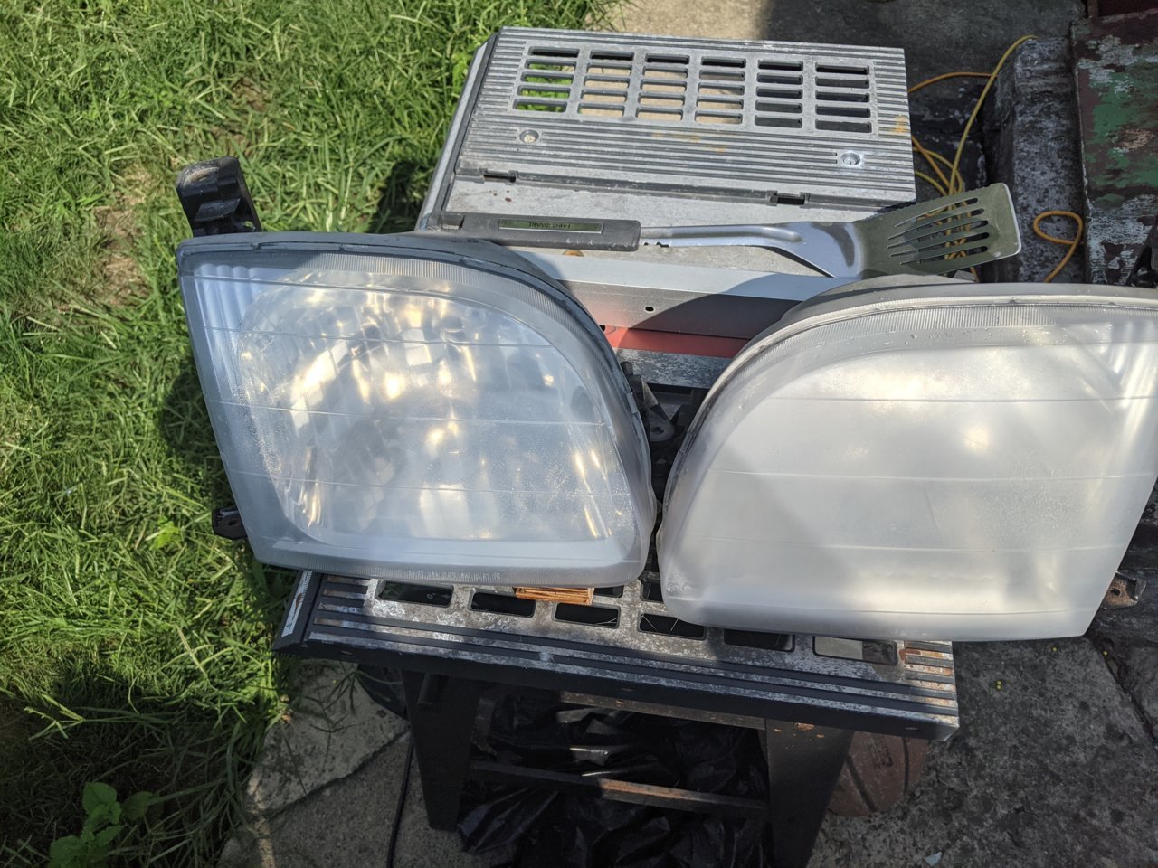

    Wet sanded the cloudy clear on my headlamps.
    Here's one compared to before.
    Not perfect but I gave up for now. I did the other one after this picture and it came out slightly better. But I need my truck so I put them both back in for now.

    The headlights might interchange but offer no benefit that I am aware of so may not be worth doing, especially if you have to fit them. The bulbs are the same so there won't be any issues with wiring. If the headlights in that picture are correct, those are DC lights. You can tell by the little running light in the corner (194 bulb).

    These are all the light numbers I have for my truck, which is an AC w/DRL. I specifically had to order this stuff recently, I just swapped out my headlights last month, caught a deal around Memorial day for around $225/ea. Yes, it's the full assembly, new lights and everything.
    81150-0C040 (DRIVER headlight assy, DRL, late model Access Cab)
    81110-0C040 (PASSENGER headlight assy, DRL, late model Access Cab)
    90159-60603 (Headlamp mud guard screw for $1, 1 per side, AC/RC only)
    90119-06830 (Headlamp assembly bolt for $1, 1 per side, DC only)
    81570-OC010 => 3rd brake light complete assembly
    81572-OC010 => 3rd brake light gasket (between lens and basket, not basket and body)
    81571-OC010 => 3rd brake light lens cover
