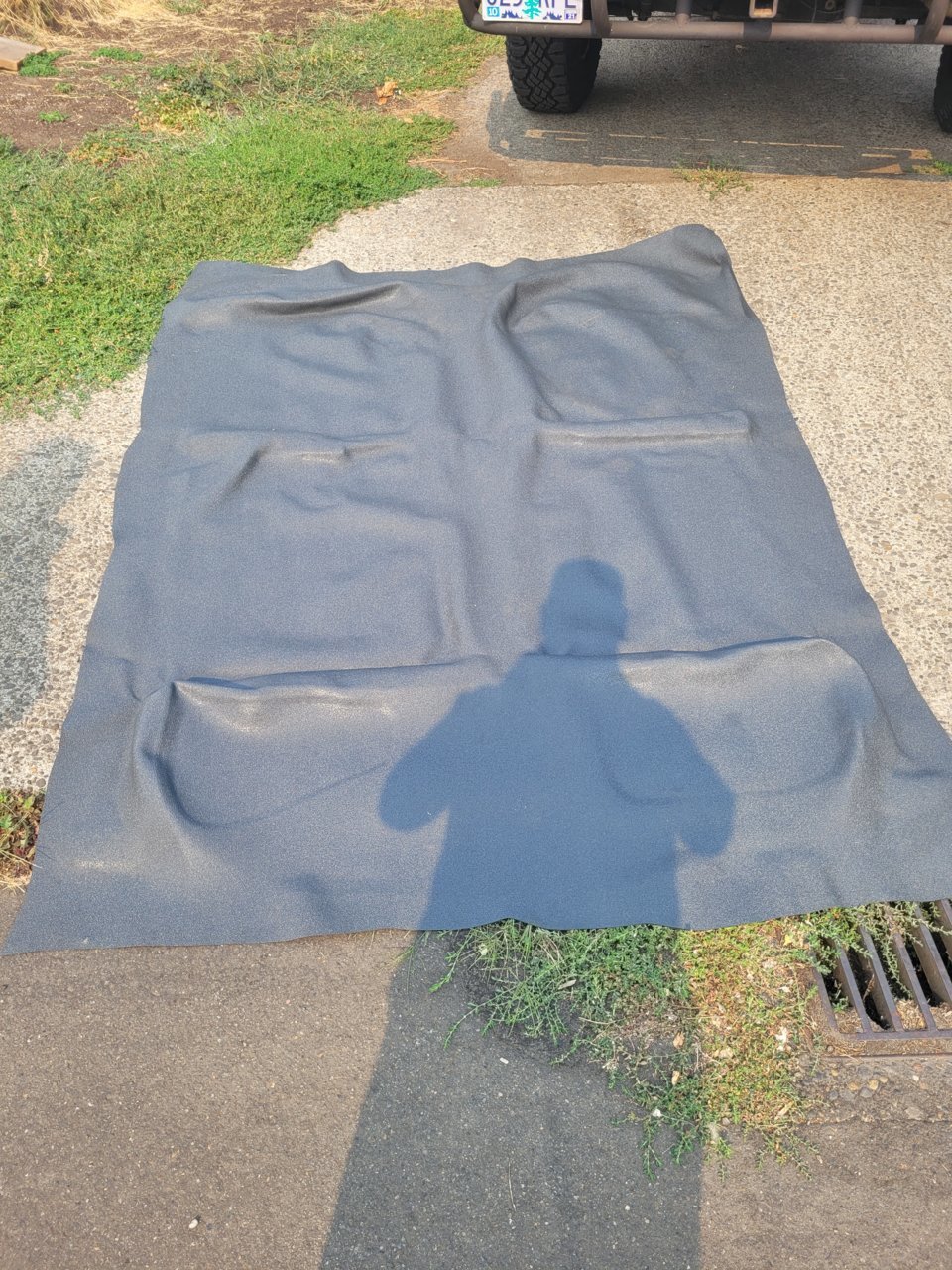

    To stay on topic of the thread.....Today I stripped my carpet. Tomorrow you will see why.

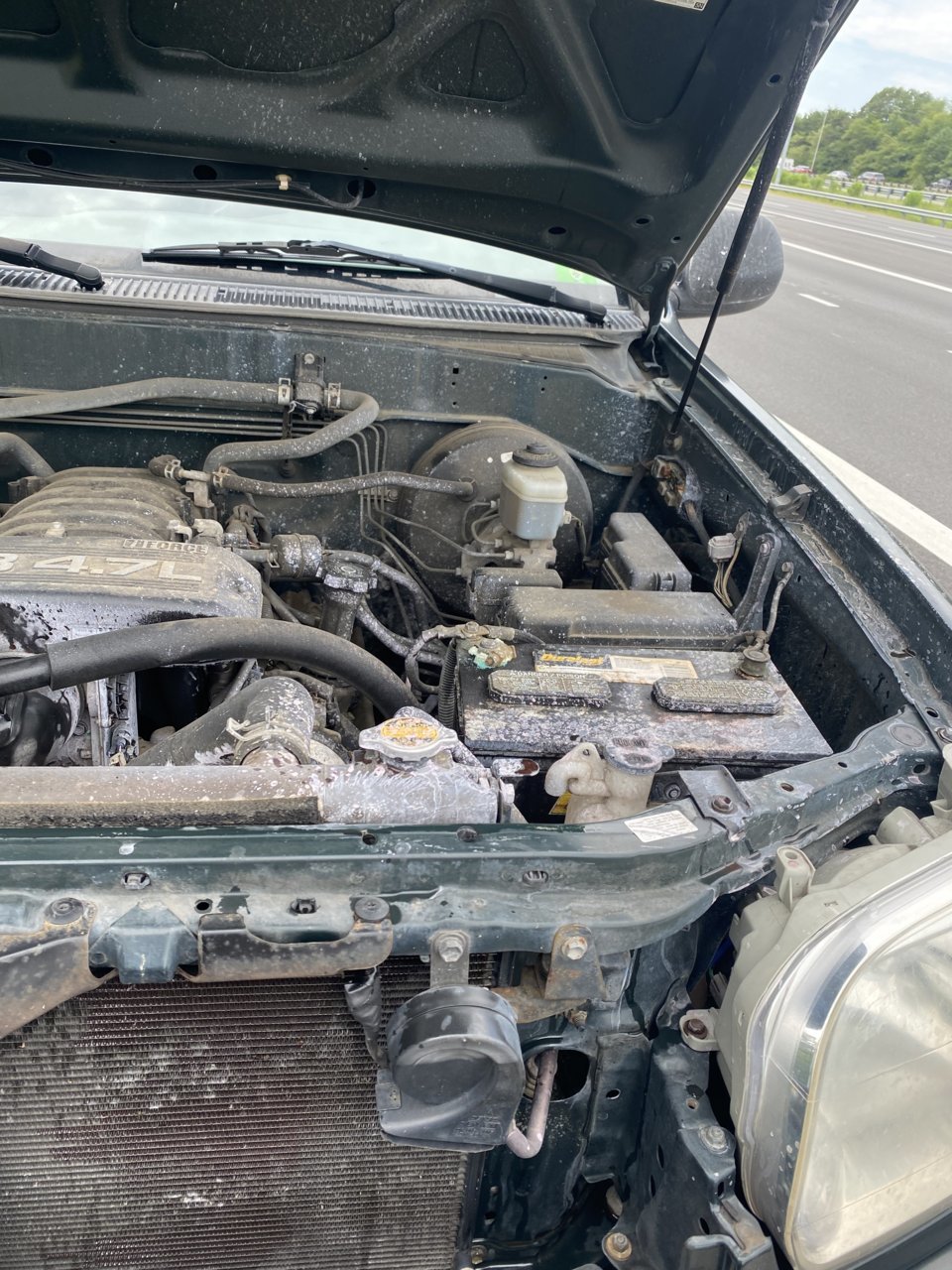

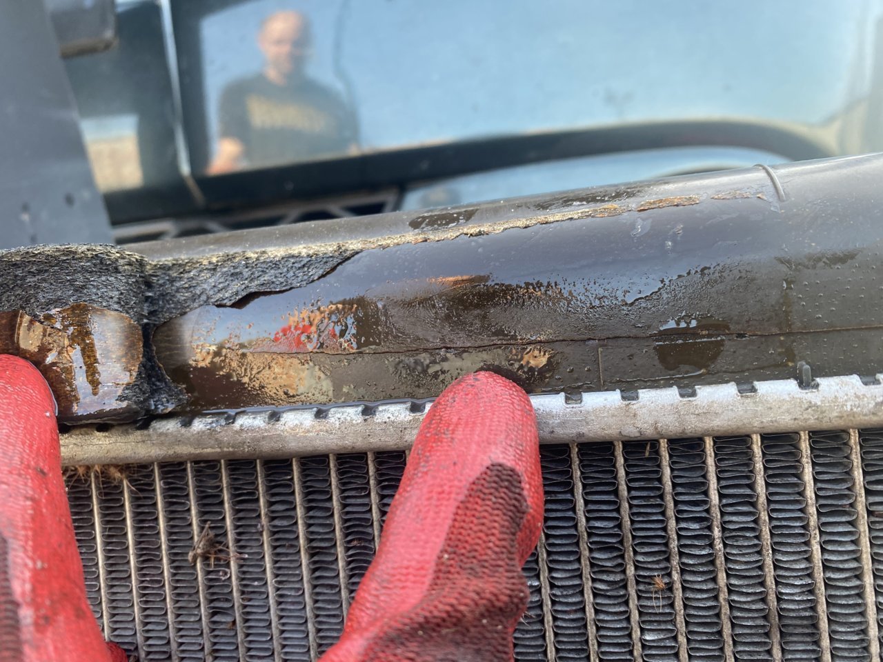

    You sure your cap isn’t just old and worn out? Or can you see obvious separation on the top cap or something?

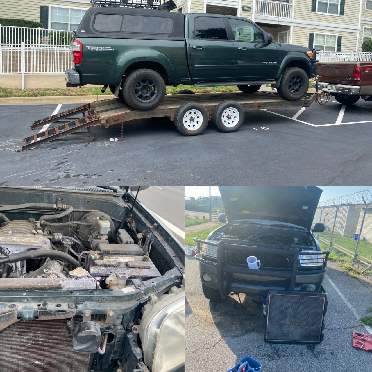

    It was just that ugly dark brown color, I did inspect the cap it didn’t look too rough. New radiator (denso) from Napa, had to drive to MD to get it so I could replace before the sun got too high today. New cap & thermostat as well. Planning to do fan clutch in the near future before pulling that tandem axle trailer to get my next project (09 Camry). While removing the radiator I moved a small bit of foam aside and found the crack. Buttoned everything back up and inspected trans fluid lines, everything looked a great red color. I’m hoping to do a drain and fill later this evening when it cools off a bit if the war department doesn’t give me the stink eye. Truck made it back home through bumper to bumper traffic for an hour and a half so I’ll call it good until new hoses and fan clutch arrive.
