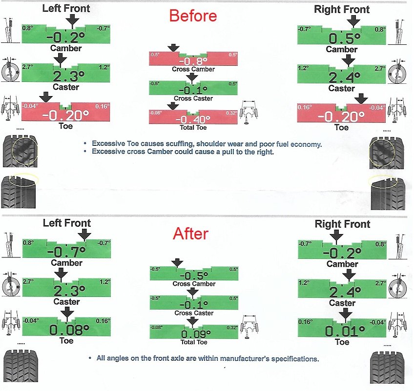

    Put on new Toyo Open Country H/T 265/65R 17. Bought same kind when first buying the truck in 09. This makes the 3rd set and been very pleased how they ride. Alignment was a tad off but unnoticeable to me.
    The manager that test drove after said it had a very slight pull to right. We'll see after things settle in. Thoughts on alignment numbers ?

    Slight pull is due to cross camber.

    Thanks, is that something he could have adjusted out ? Had about a 5 mile stretch of back country road, fairly well kept and straight. There was very little pull to right when letting go of steering wheel.

    Possibly.
    Take pics of the position of your adjusters in the lower control arms and I could better tell.

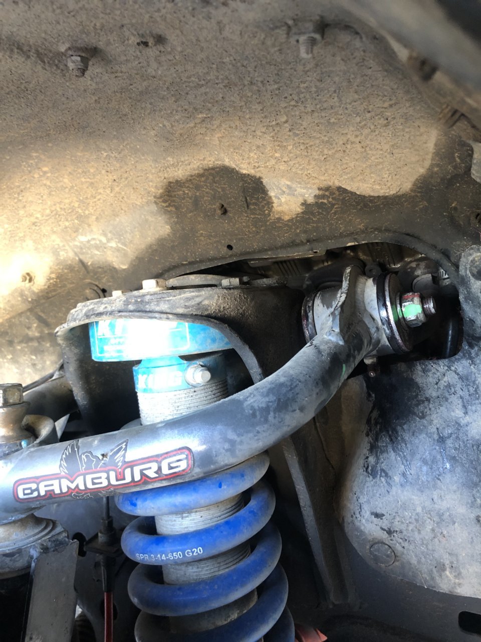

    Today I greased my UCAs… finally. Been on my to do list for a while. Apparently they should be greased every 3-6 months and even more so if going off-road. Hopefully this eliminates the squeaking from the front suspension.

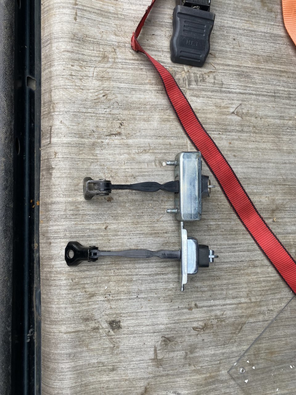

    Replaced passenger side front door check and drivers side rear door check to keep the boss happy. She keeps complaining about it shutting on her when loading the munchkin, will add a more detailed write up to the door check problems thread later this evening after I get the offspring down for bed.

    Did you just hook up the grease gun or did you loosen the bolts to the UCA?

    Anyone looked at a 2nd gen door check to see if it fits? I'm wondering if they have heavier doors and a better hold.

    Took the bolt off before greasing.
