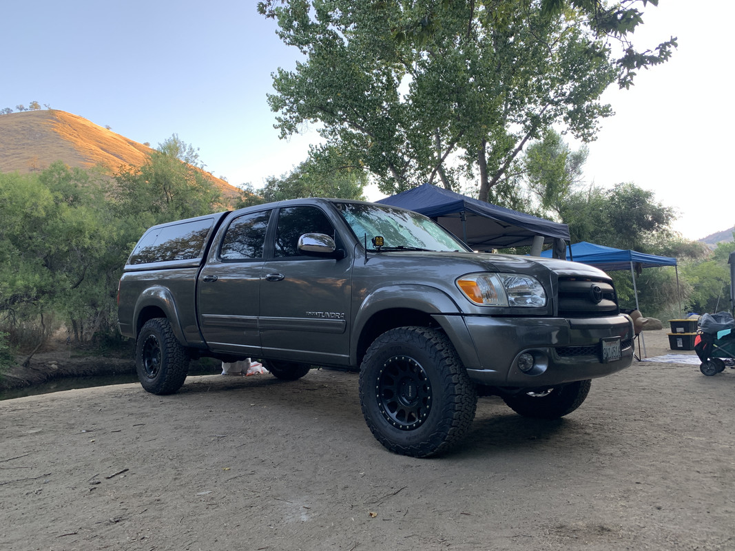

    What coolant temps is everyone getting.
    Just took a road trip to go camping 800 miles round trip, so I bought a scan gauge to read live data.
    I was reading about 197-8 average and 202 degrees was the hottest it got going up some heavy Hill climbs. It was 101 degrees outside. Currently at 168k with 2.5 lift, on ko2 33’s 17’s and camper shell, loaded with 4 people and about 500 lbs of gear with the ac on second setting.
    Average speed was 75 mph and I took it easy on the hill climbs going about 50-55mph.
    Still on the original radiator. Fan clutch feels solid when I try and freely spin it. Changed the thermostat (auto zone brand, should have went oem) and did a coolant flush about 6k miles ago.
    Everything felt healthy but wanted to see others. Saw a post about @empty_lord reading 184 degrees while towing on a 100 degree day with a new radiator.
    @Darkness showed similar temps on a previous post ranging from 195-200 on 100 degree day.
    Voss, Filthyphil, oscardog86 and 2 others like this.

    Jerry, I can't tell you exactly what mine is running at but under the conditions you described I'd say you're fine.
