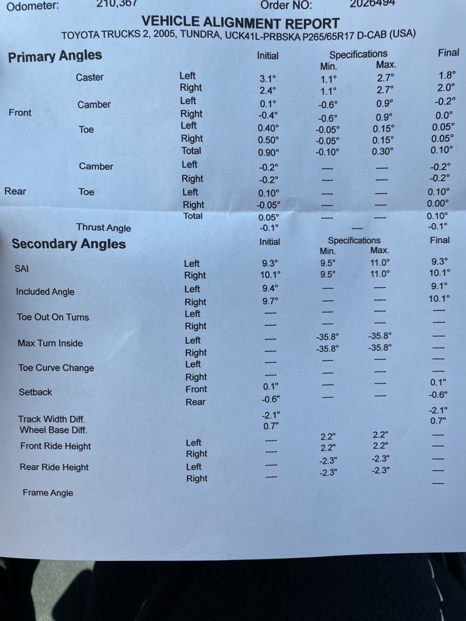

    Truck seems to not have that wheel hop at 40-50 and just got the alignment done. I knew I was way off but oh well it’s fixed and ready to go.
    Final specs look ok?

    If they can do a bit more caster I'd go up to 2.5. Are you lifted with stock UCA's?

    Why’s that? Yes I’ve got a little lift from the 5100s and stock UCAs

    More caster = better steering feel/feedback. It'll be less light feeling at fwy speeds.
    Also brings the tires more towards the front bumper. I'm currently at -0.5 camber and 2.5 caster.

    Gotcha. Well it’s a pain to get an appt and get the alignment done with having the kids but next time I need one I’ll ask for more caster.

    Your lifted right? 2.0 castor is kinda low for a lift. But if it’s not rubbing your fine there

    My cambers closer to -1.0 and I don’t much care for that’. BUT castors 2.9 and I have no rub and it drives fine… just rotate the tires frequently and I can probably avoid the camber wear

    Yeah 3rd notch on 5100s. Still clearance between UCA and tires and no rubbing anywhere so I’m ok with it so far. Haven’t done the fwy yet though
