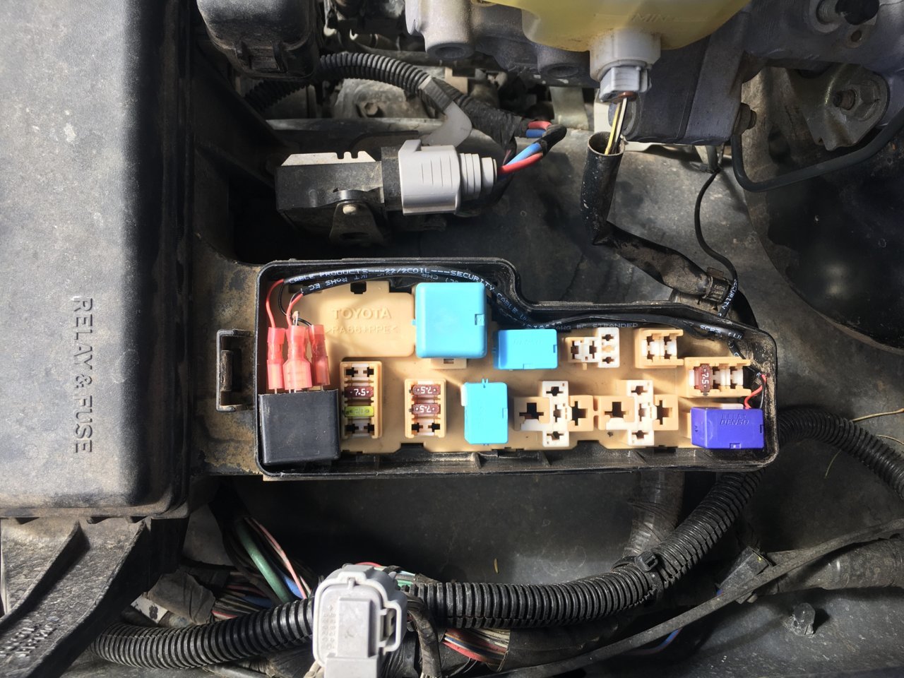

    @Cummins3500 this is basically all I had to install and hide it in the loom on the way to the maf

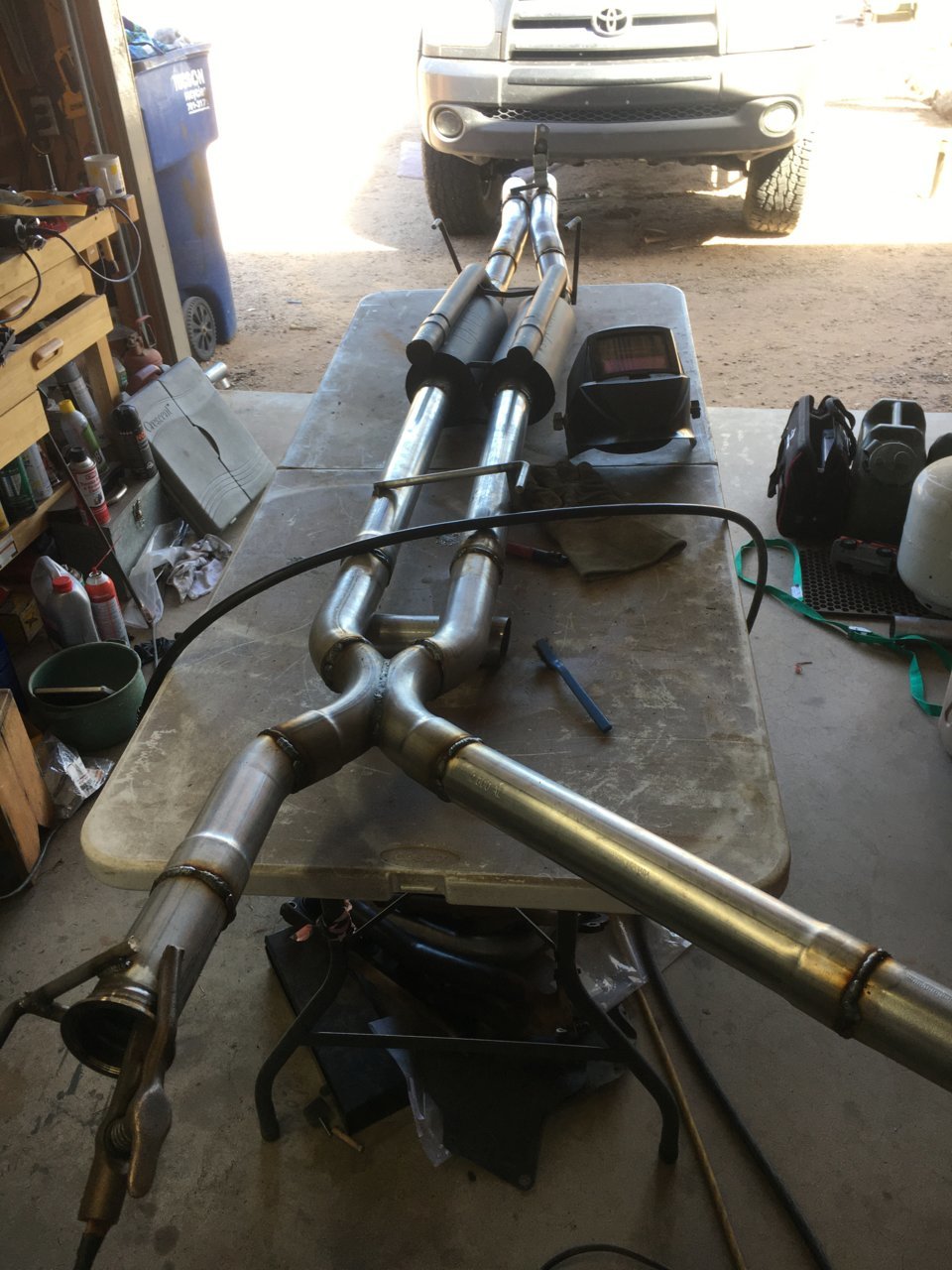

    @TRDGen i went full custom off of the long tubes, the borlas don’t do much muffling haha.
    I’d also like to tune the exhaust back pressure some, I feel like my dual 2.5 needs a little restriction for more BP

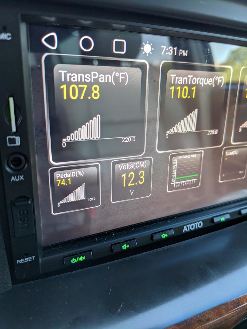

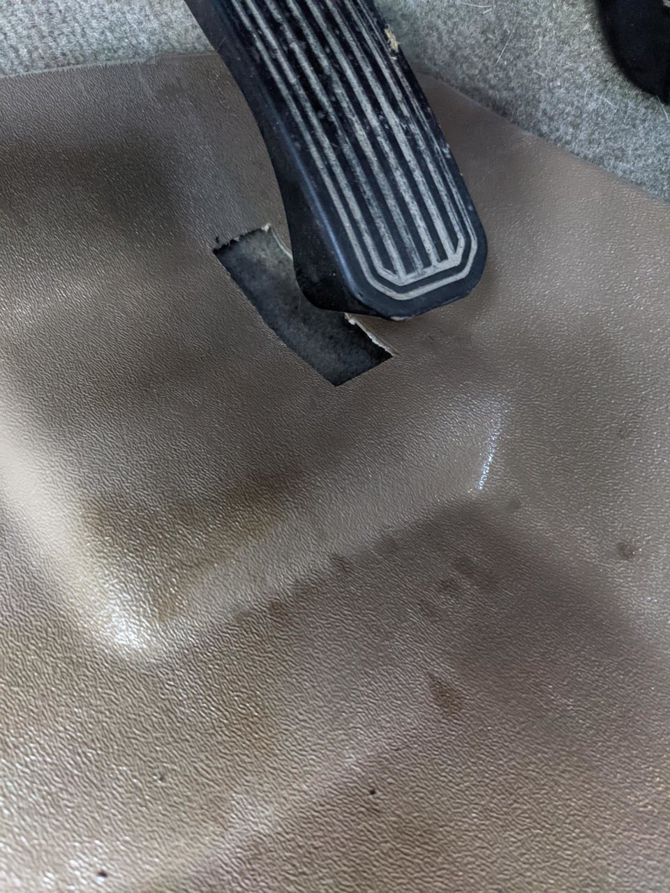

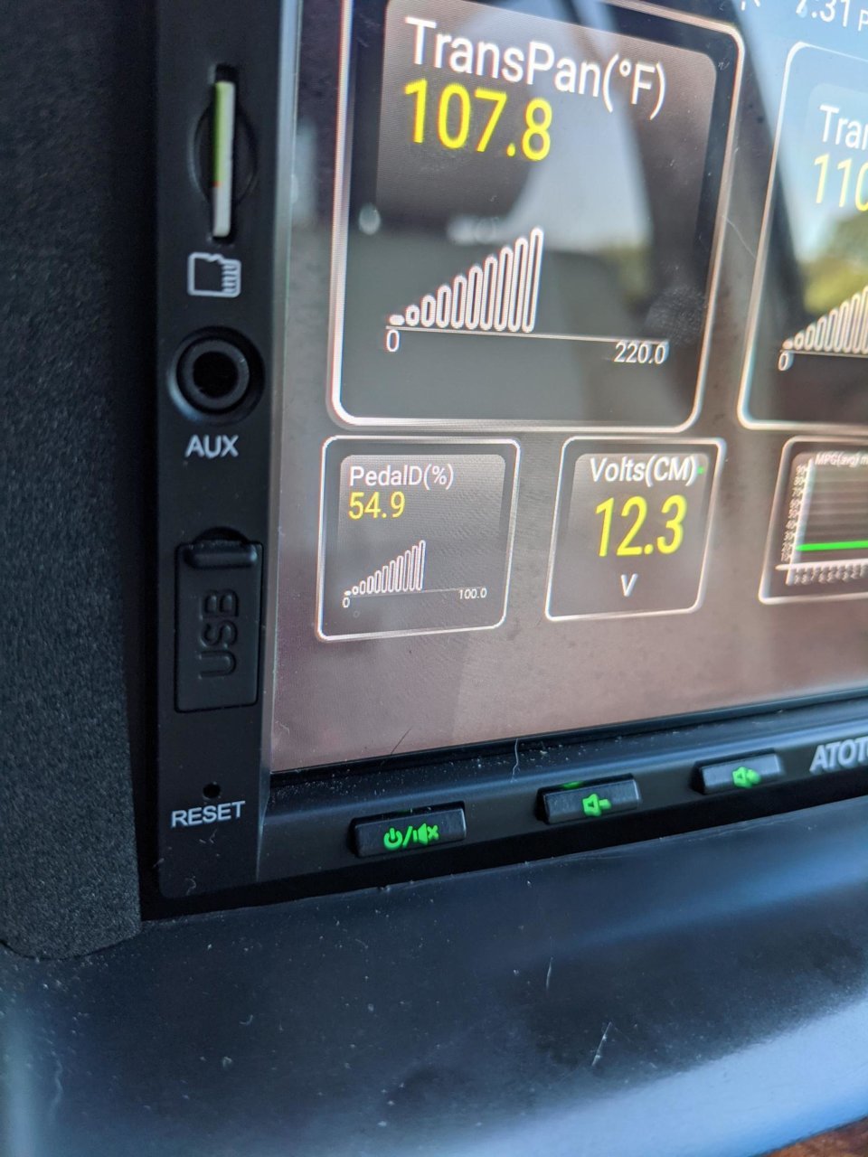

    I took the river dust off.
    I had a suspicion that my weathertech floor mat was interfering with my gas pedal.

    I actually thought the same. But checking mine it wasn’t. The throttle % is % max voltage. It’s not corresponding to throttle opening. Mine maxes at 84%

    With my floor mat in I was only able to press the throttle to 54%. With the mat removed it goes to 74%. The weird little hump on the back and bottom of the pedal made contact with the mat. Your floor mats may be different too.
    Both of those pedal ID sensor screenshots were with my foot lightly pressing the pedal to the floor.

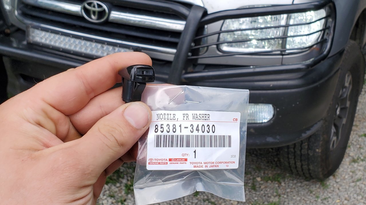

    I hope this is for some sort of cooling alcohol/distilled water misting shenanigans. It has come up a couple times in different threads in the last week or so.
