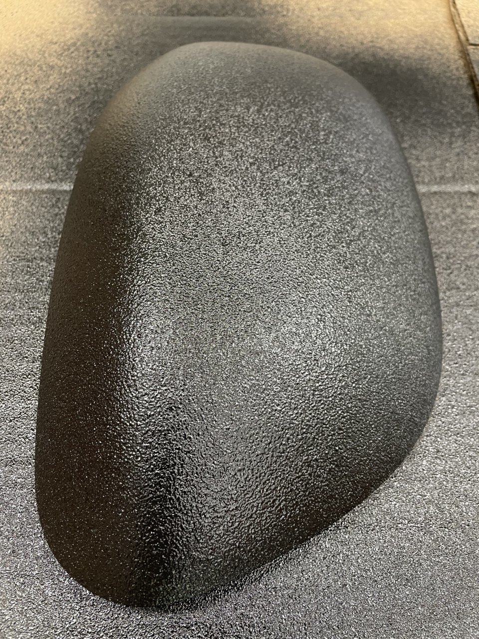

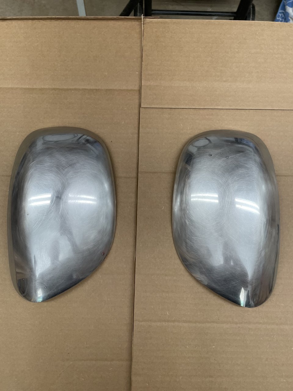

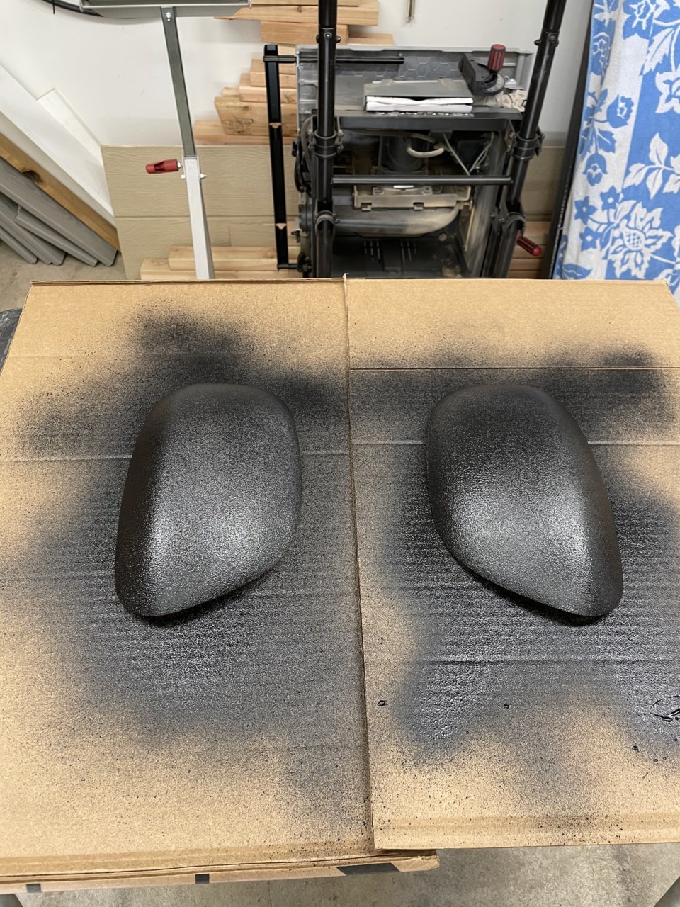

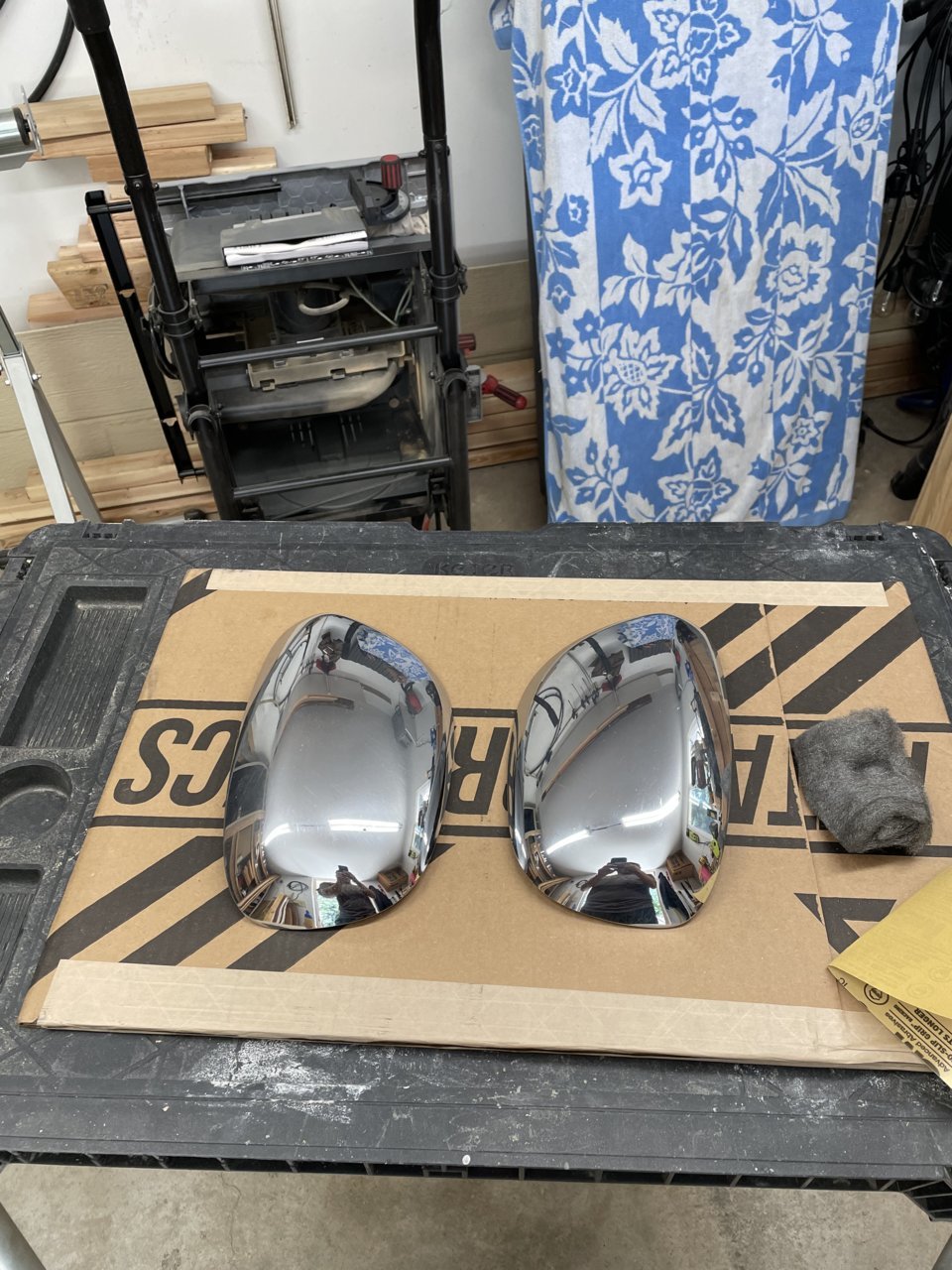

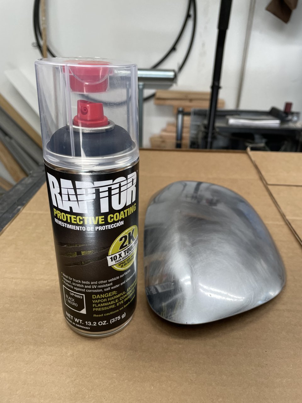

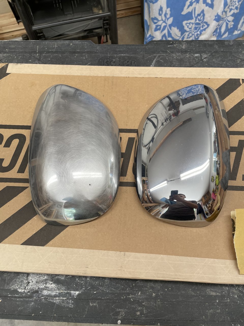

    Decided to go back to my original mirrors from the dodge style flip-outs since they shake and are crappily made. Hate the chrome so the mirror caps are getting a treating of black raptor liner. Was lucky to get the caps off without breaking any clips too! C9D7F241-091A-4D46-B15D-4F8E80F8E6FF.jpg
    Scuffed with 220 grit
    5C5FDF5B-9707-4E90-85F4-DB3B53005F11.jpg 61B5C3FD-49DF-4E77-AF06-2A88683D4AE6.jpg
    First coat

    Do the caps come off from the outside with a pry tool or do you tackle from the inside?
    oscardog86 likes this.
  17. Jul 3, 2021 at 12:51 PM
    CodyP
    CodyP Such a n00b
    Oct 27, 2018
    #21047
    3,148
    Cody
    CDA, ID
    2006 Tundra 4x4 DC
    Inside. 6 clips. Basically just push the mirror around to find them. One was hard and had to be unclipped from the outside
